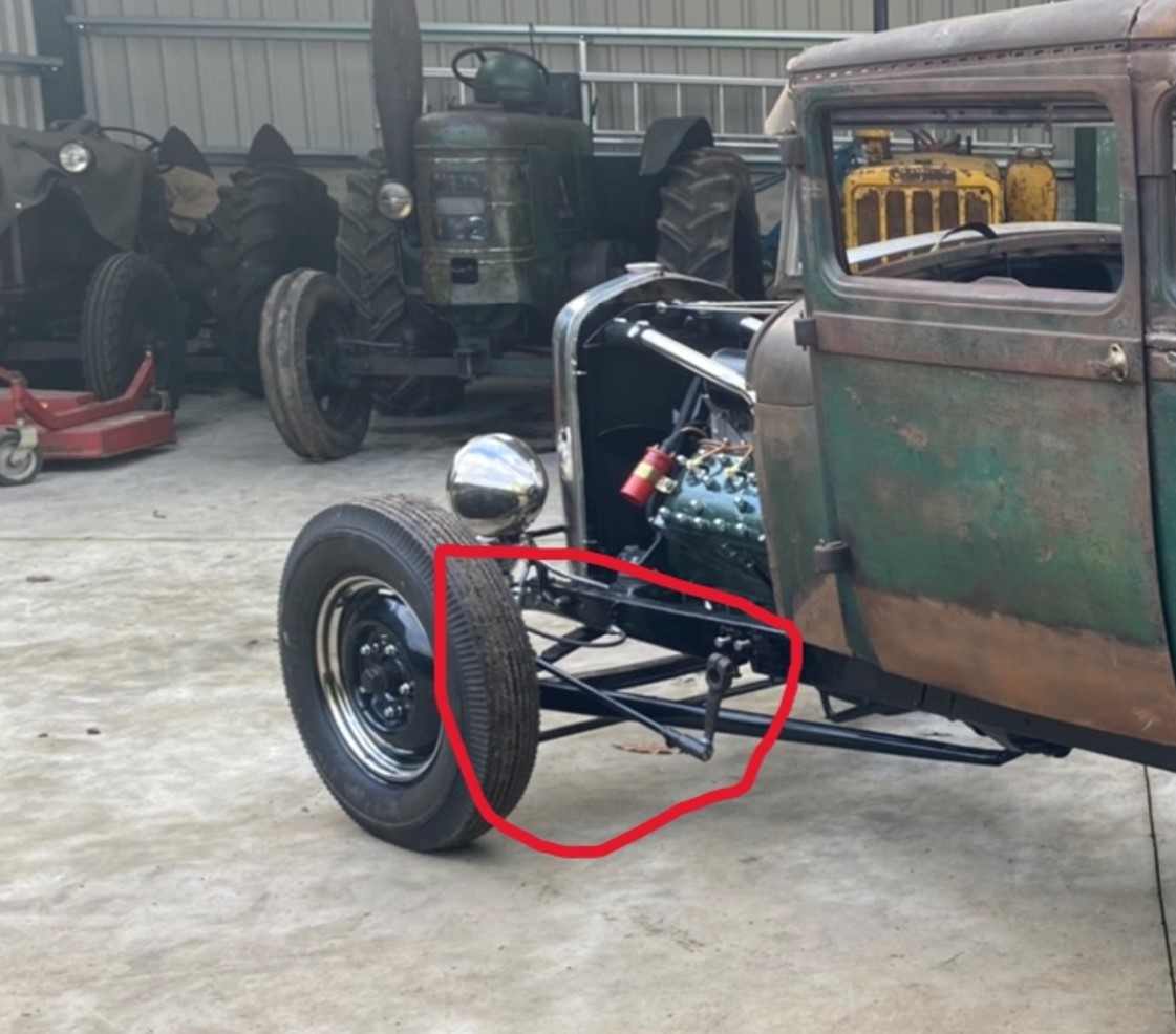

    Thanks folks. I made a tiny bit more progress this weekend (but you all know how long these 'little' jobs can take)....
    Tail lights marked out and fitted:
    Made a front spreader bar and started fabricating a headlight bar:
    Then I ran out of acetylene so had to give up with the headlight bar, burnt out my cordless drill doing the tail lights with a 3" holesaw, then cut my thumb with the grinder, whilst extending my radiator stay bars......... so I went inside for a beer!
    I'm going to be running stock model A headlights, but I want to get them as low as possible. I think where I have the cups set now (over the frame rails) is ok for height, but a bit too narrow and I can go a bit wider. More on that when I have more gas.

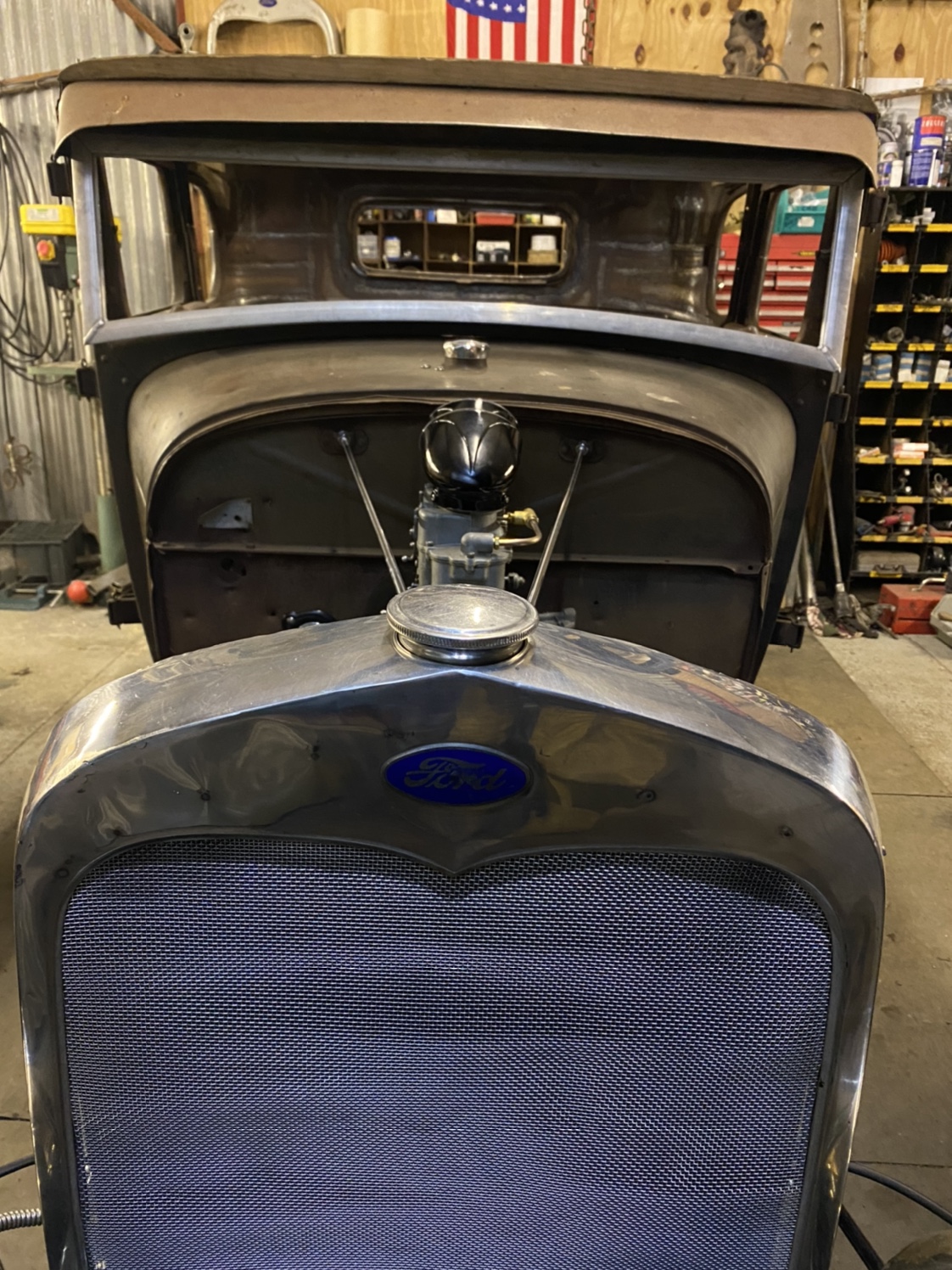

    What is causing that weird effect in front of the radiator?
    Stogy likes this.
  8. cfmvw
    Joined: Aug 24, 2015
    Posts: 1,295
    cfmvw
    That's a zebra insert:)
    Stogy and loudbang like this.
  9. Little Terry
    Joined: Oct 17, 2007
    Posts: 818
    Little Terry
    It’s a fine stainless steel square pattern mesh. Must be some effect of the light and my **** phone camera. It’s not as weird as it looks! [emoji16]

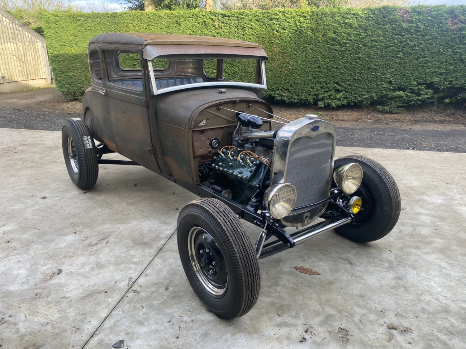

    Little Terry
    So, it’s time for the controversial headlight position! I thought I knew all along where I wanted the lights to sit. I put them quite low and tight to the radiator shell.
    Maybe it’s the fact they are so large, maybe I have them too low……
    I’m not quite sure I’ve got it right. What do you guys think??? (By the way, I realise they are pointing a little skyward in these shots)
    I cut up a model A headlight bar and put a slight bend in it. The stands are just tacked and clamped at the moment, so maybe I will just leave it as it is and stare at it for a few days. Normally, though if something looks right, it does so right away. [emoji848]

  14. Little Terry
    Posts: 818
    Little Terry
    Yes, it may be the bar that looks odd. I’m going to try raising the lights an inch and maybe a touch wider if I can get away with it.

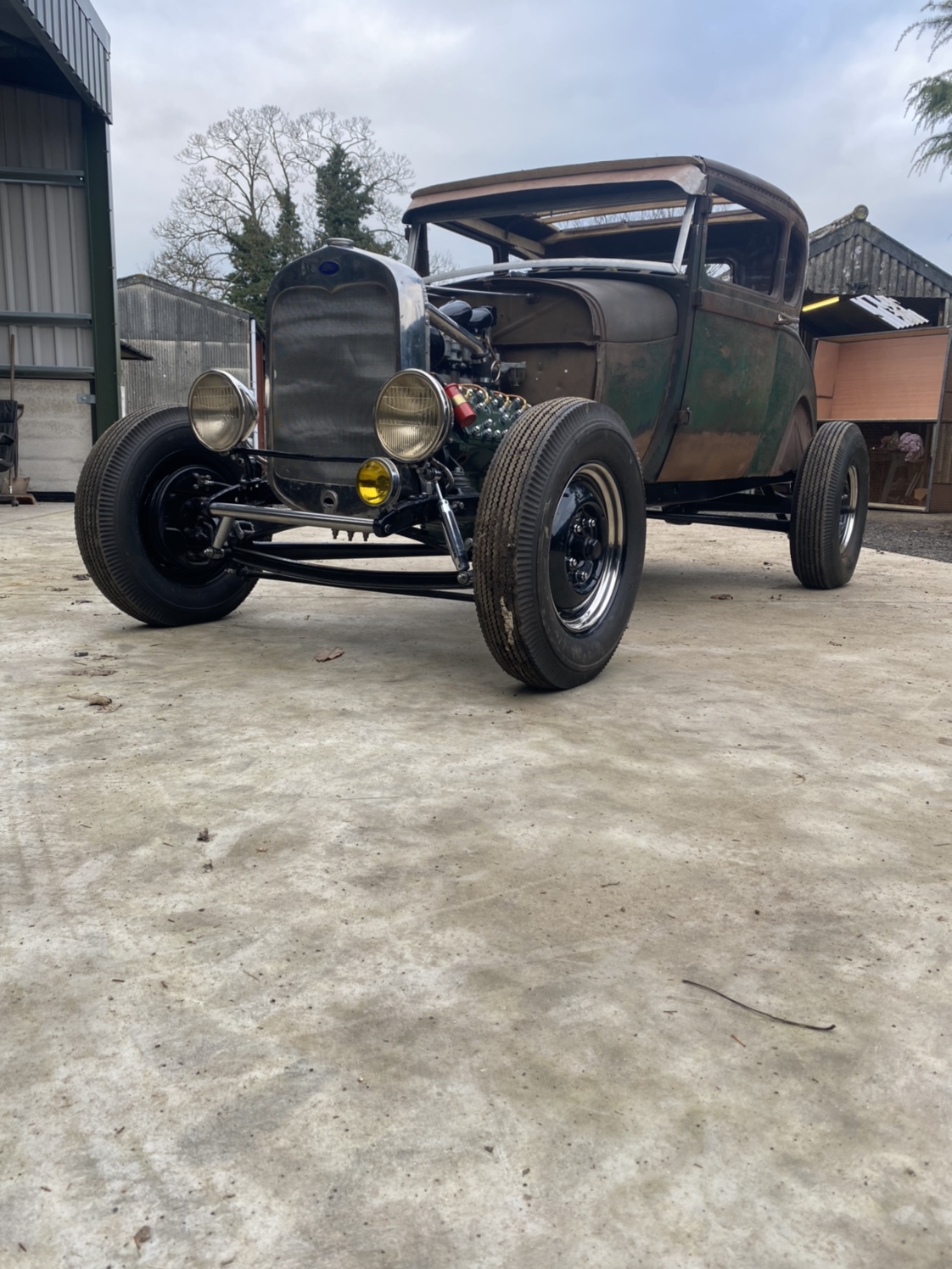

  15. Little Terry
    Posts: 818
    Little Terry
    Lots of faffing about this evening and I think I’m happy with it now. I ended up raising them so that the top of the lamp was half way up the radiator shell. I also moved them back a smidge. (Looking at the pics it’s hard to see much difference).
    I kind of wanted to keep the big model A lights as I like the period look and the big flat lenses. My other option is to use a pair of lucas FT57 lamps, to keep with the Fordson tractor theme. I have some here, but they are more like spot lamps, so may not really be practical. They are 7” so I may try them for size at a later date.
    Anyway, the headlights staying like this for now….

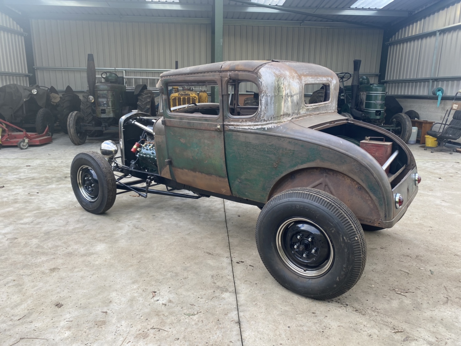

  19. Little Terry
    Posts: 818
    Little Terry
    I pushed it outside today whilst I swept out the workshop. I’m happy with it so far….

  23. manitouguy
    Joined: Jul 28, 2019
    Posts: 59
    manitouguy
    Very nice work, I am enjoying reading through this thread – question – other than a dropped front axle and some springs possibly removed at the rear what more have you done to get the stance the way it is? From your earlier photos it doesn’t look like you stepped the Frame?
    loudbang and Little Terry like this.
  24. Little Terry
    Posts: 818
    Little Terry
    Thanks.
    To get the rear end lower, the spring has been fitted behind the axle. This involves stretching the ch***is (by around 7” I think) and allows the spring perches to be positioned 4” lower than stock.
    The frame and spring mounts had already been modified when I bought the project so I am unsure what the exact measurements are.
    I am sure there is plenty of info regarding this technique on the H.A.M.B.
    I also plan on fine tuning the ride hieght and stiffness by removing some spring leaves front and rear. I think the springs are way too stiff at the moment.
