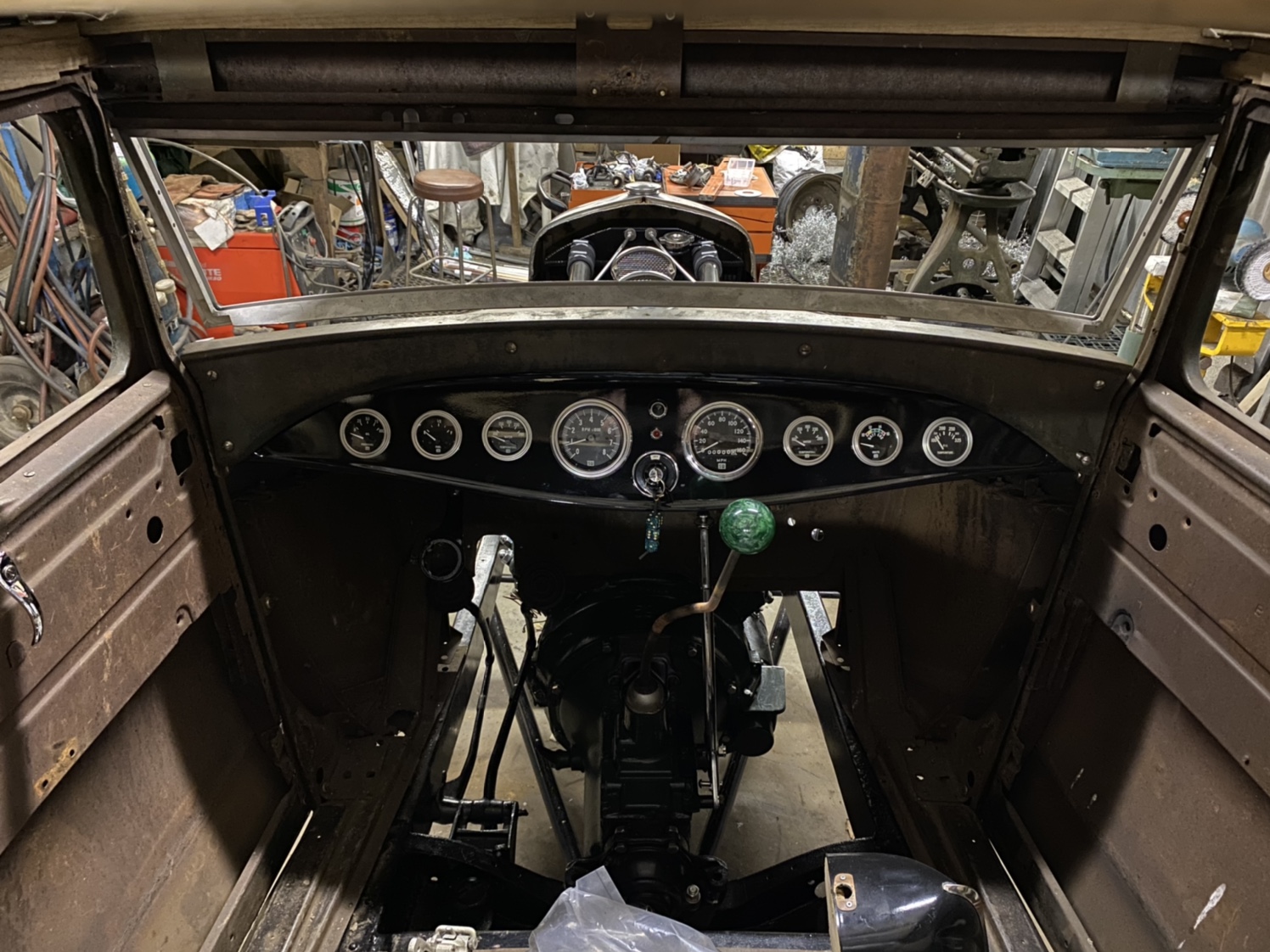

    I have got the dash fitted up with the gauges now.
    I made up some aluminium spacer rings to lift the tachometer and speedo off the dash a little.

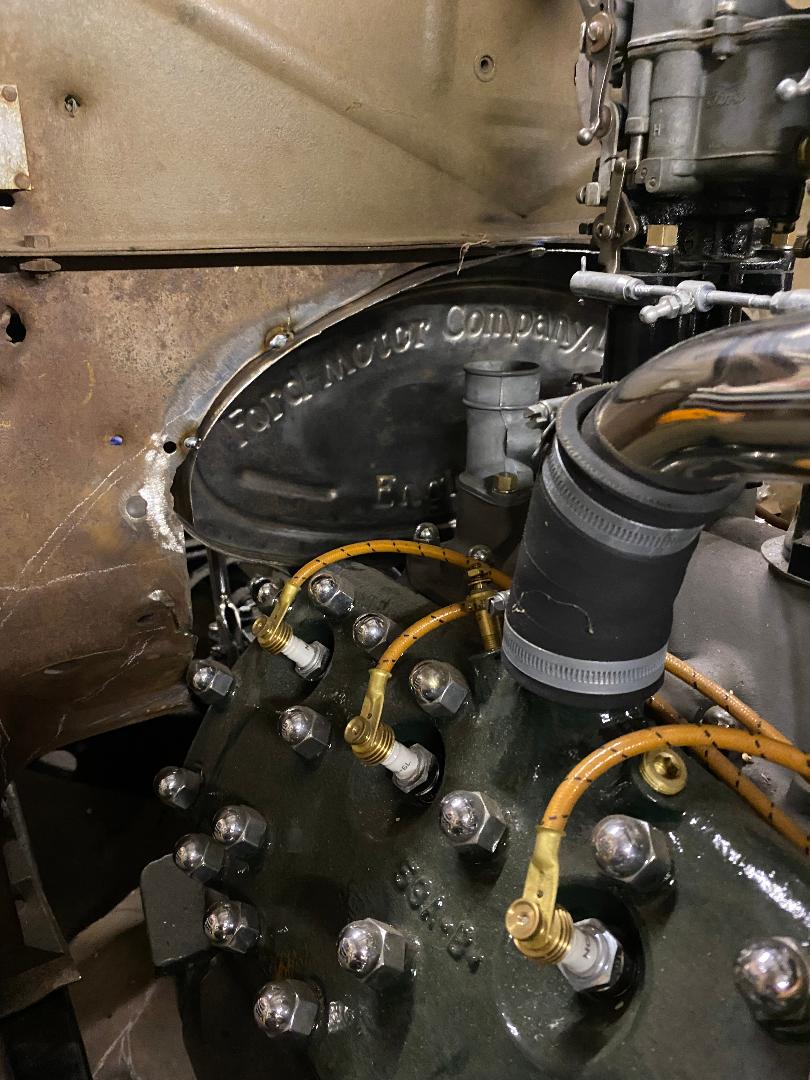

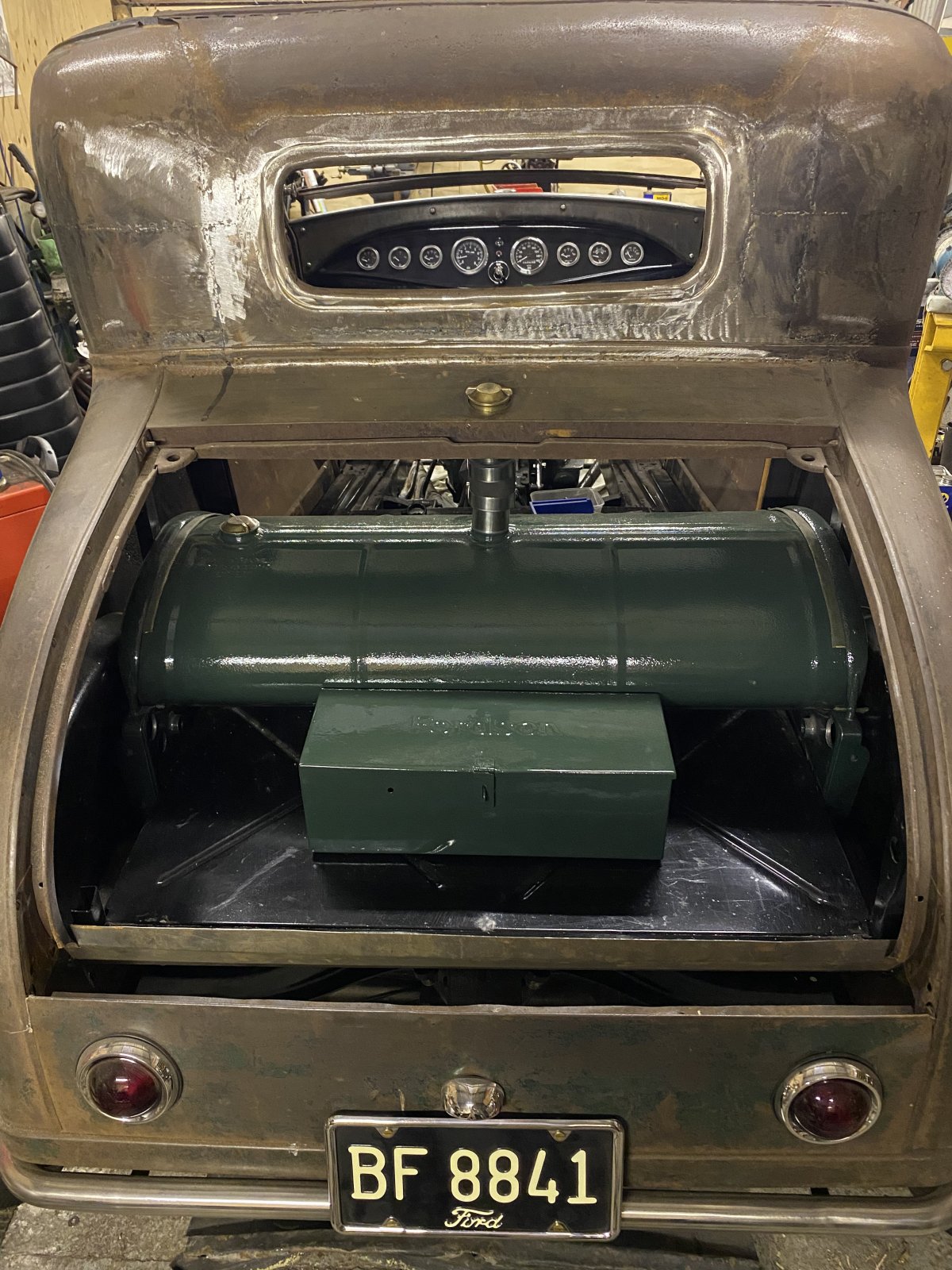

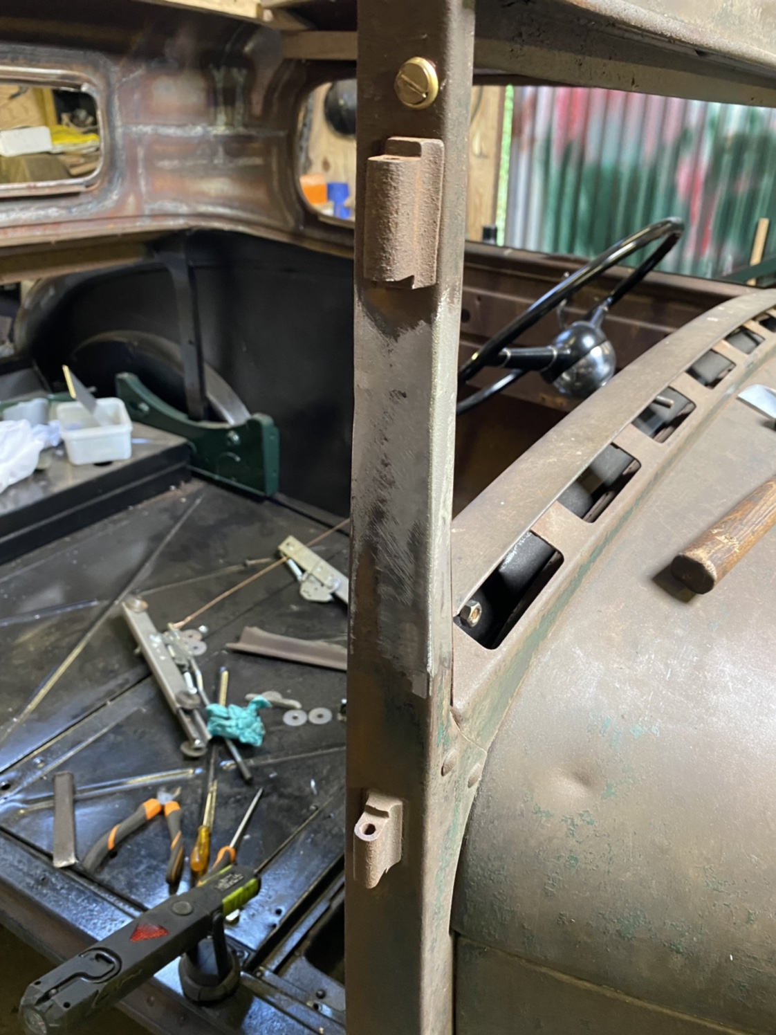

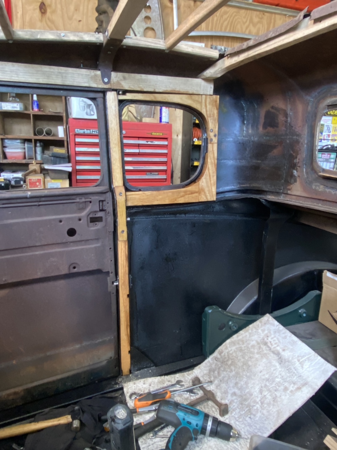

    I have taken bit of a step backwards this week with the coupe. I really wasn’t happy with the body position - the rear wheels were well forward in the arches, making it look a bit awkward, but also making it much harder if I ever want to run fenders in the future. It also meant stretching the hood if fitted. I decided to relocate the body in the stock position but this meant moving it forwards a good inch and a half. Bulkhead collided with back of the motor. I decided to cut the bulkhead to recess the motor into the front of the body, allowing me to gain the bit of space I needed.
    Then I cut the end out of a s**** Fordson tractor tank (the same as the style I am using for my gas tank) and will use it to fill the void. It needs lots of welding and t******* when the body is back off the frame, but this shows the general idea.
    What it looks like from inside the cab….
    The same fuel tank has also donated one of its br*** filler necks to fit an external gas cap. It just needs a 2” hole cut out and soldered in to place.

    Love the tank end recess, I think I would flip that so it could be read from the motor side, that would have a few folk scratching there heads .. Its a bit of fun that is .. and a unique personal touch. Thats what its all about .
  6. Little Terry
    Joined: Oct 17, 2007
    Posts: 808
    Little Terry
    Thanks Ian. Yes flipping it had crossed my mind. The inside of the tank (that’s facing the motor) is quite pitted, too so it would look better the other way round. As always, it will add several hours to the job! [emoji1]

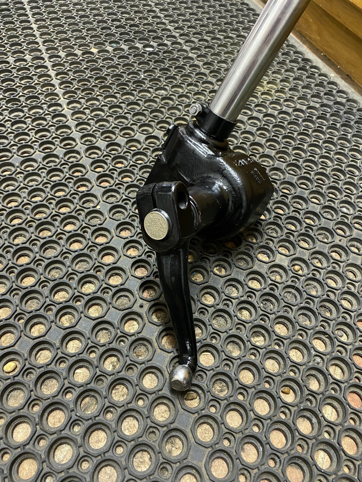

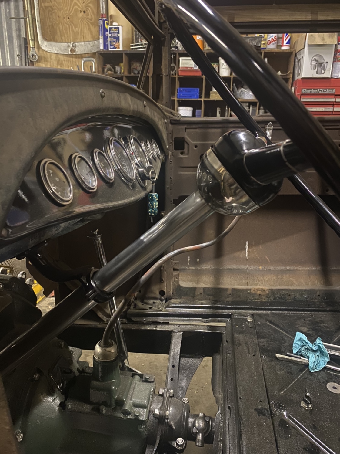

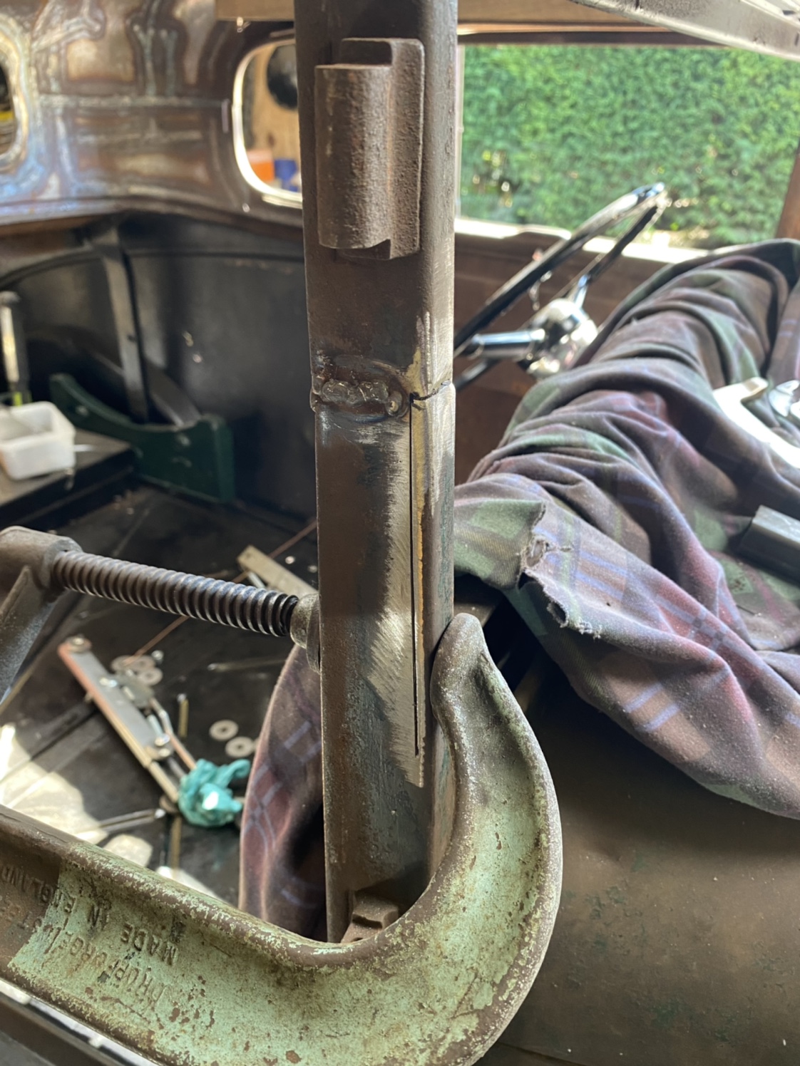

    144BB4BA-74D6-4CBA-9DBD-69765C34345B.jpeg DA568166-B560-4546-8488-AC6A4F8B5030.jpeg DA836781-2A23-42A8-8D49-309AB377AFE2.jpeg Got my steering box and column finished off.

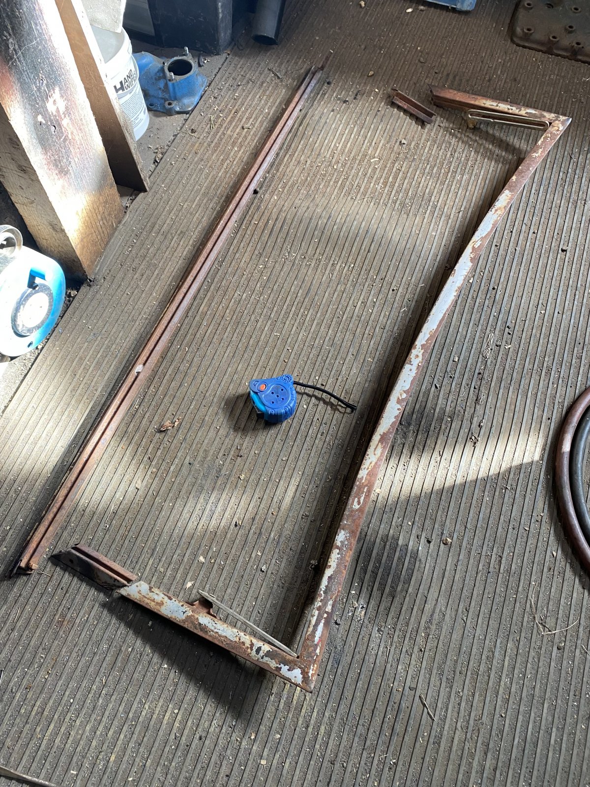

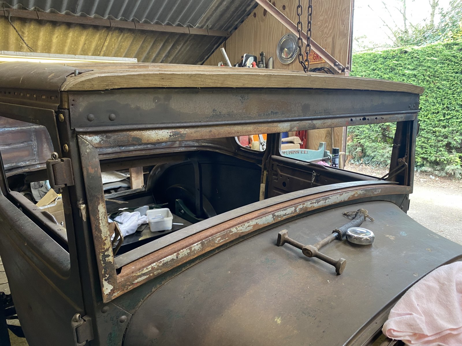

    I also removed the ally screen surround and chopped down an old steel one.
    049F5BD2-449D-4AF1-9A75-D1D681ACC941.jpeg 76912A3E-6F4D-4B4D-B08D-F871839AE956.jpeg

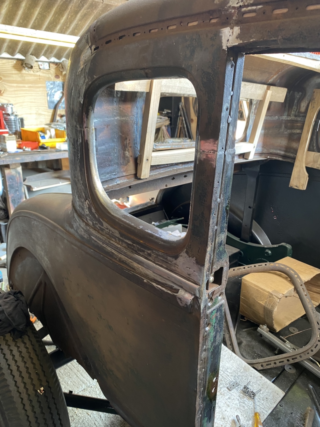

    There has been a bit more progress on this…
    IMG_3996.JPG IMG_4018.JPG IMG_4023.JPG BA4E15A9-D451-42F7-A5DA-13CDB6BD8F17.jpg 8B51F17E-8665-4452-AF35-6FEC3EB056A3.jpg IMG_4082.JPG IMG_4084.JPG

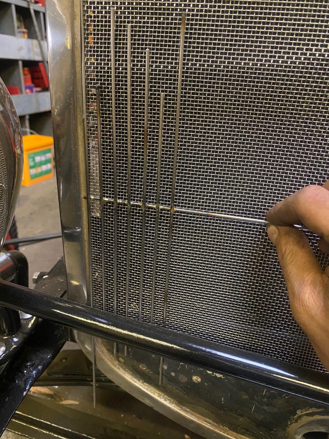

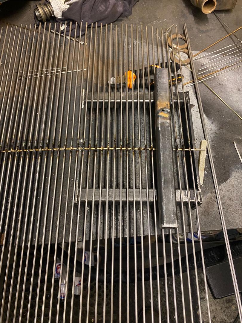

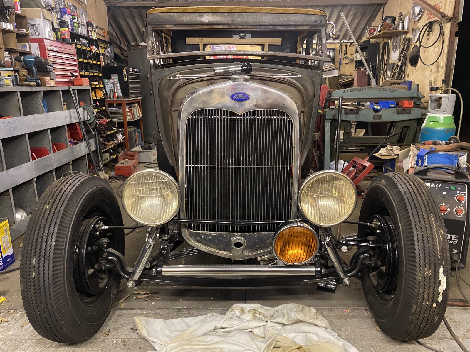

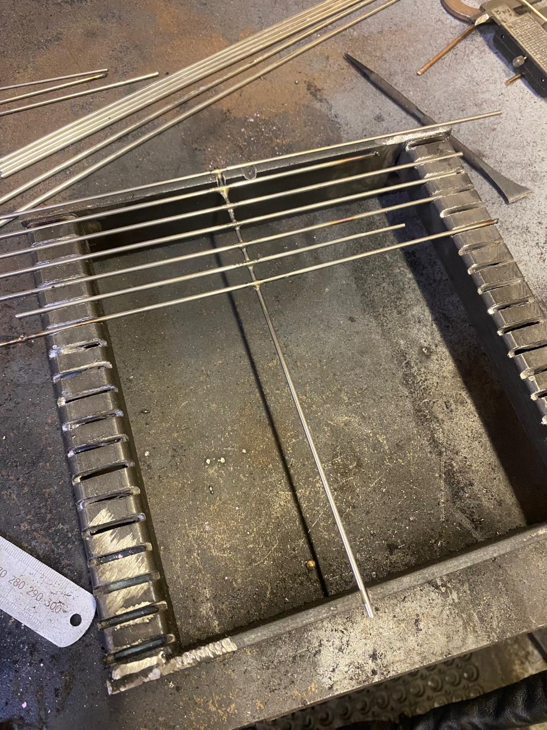

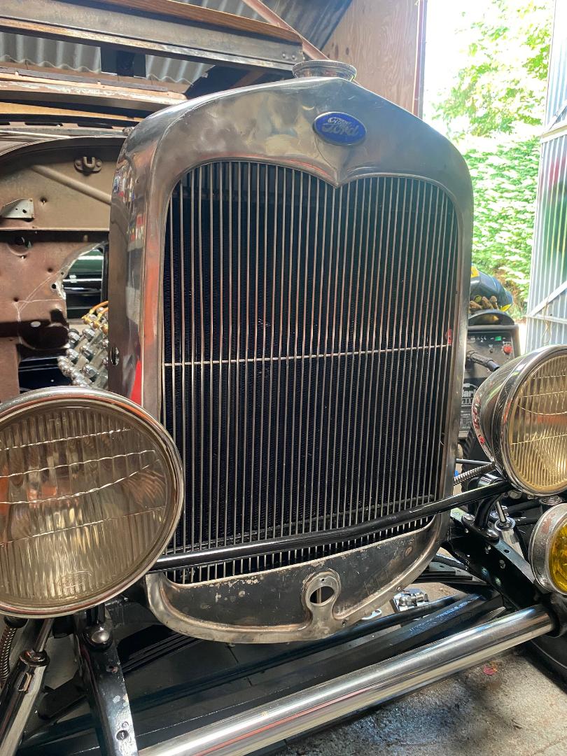

    grille4.jpg grille3.jpg grille3.jpg grille1.jpg grille7.jpg I have been doing a bit of work on the coupe since getting the sprint car to Pendine in May, but lots of little jobs here and there that don't really add up to much. One thing I wasn't happy with was the mesh I had used to hide the chinese radiator. I like the idea of a stainless insert of some sort, but couldn't find any mesh that had a close enough spacing and didn't look too much like, well, mesh I suppose.
    So I made a rough and ready jig to hold some 3.2mm stainless filler rod at 8mm spacings and silver soldered a cross brace and frame round it. A set of stainless studs brazed to the inside of the shell allowed me to bolt it in place. I am quite happy with the overall effect, although you can still see the radiator, the grille draws the eye enough I think.
    Deutscher, cederholm, Jrs50 and 13 others like this.

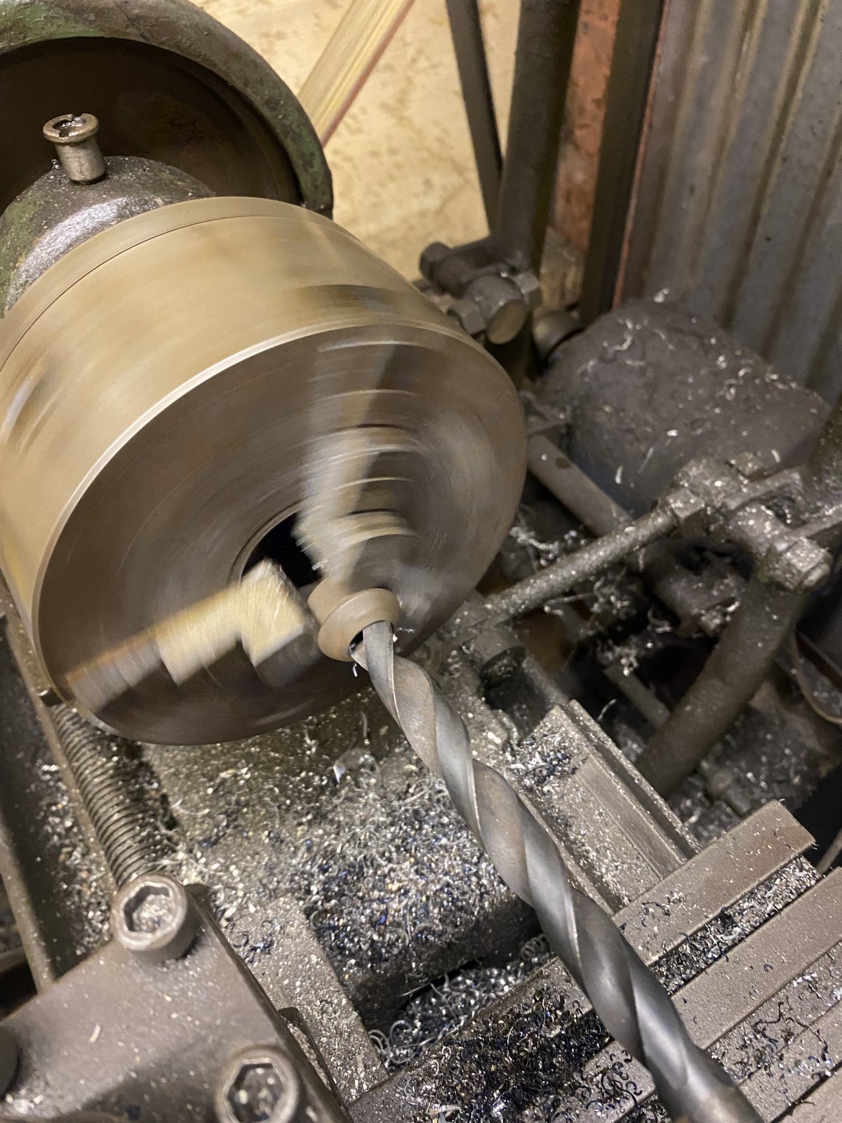

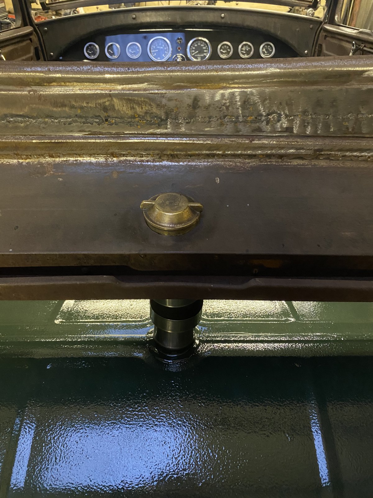

    I have also been playing with the fuel filler and decided to use a nice br*** Ford Tractor fuel cap that I had collected up from somewhere, somewhen.
    I machined one cap to adapt a piece of 2.1/4" stainless pipe to the top of the tank and then fitted a female fitting to another piece. they will be joined by a short section of rubber hose, when I can find some that has enough flex in it.

    Good idea. Hides the rad well. Great job on jig as well. Looks like its all coming together.
    Stogy, nunattax and Little Terry like this.

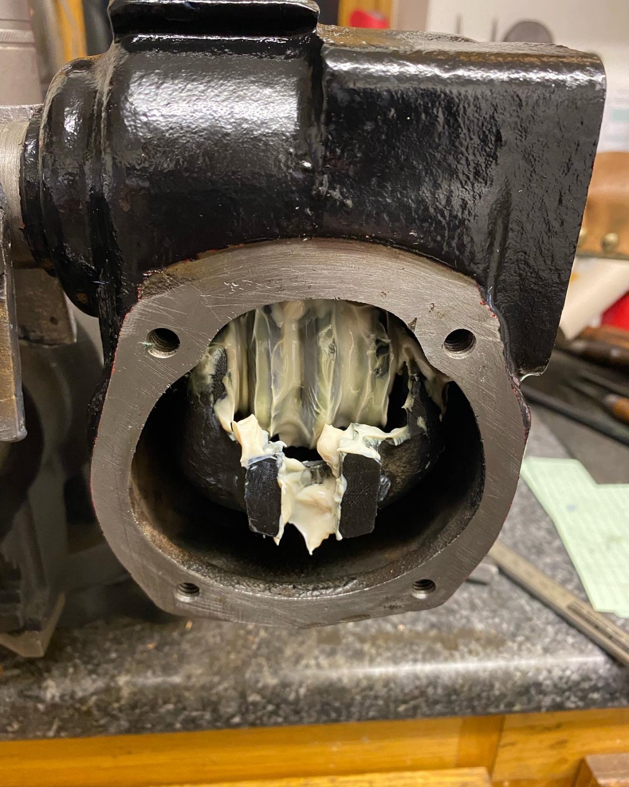

    Had to go backwards on the steering box, because of clearance issues, so I have an F1 in bits for rebuild at the moment.

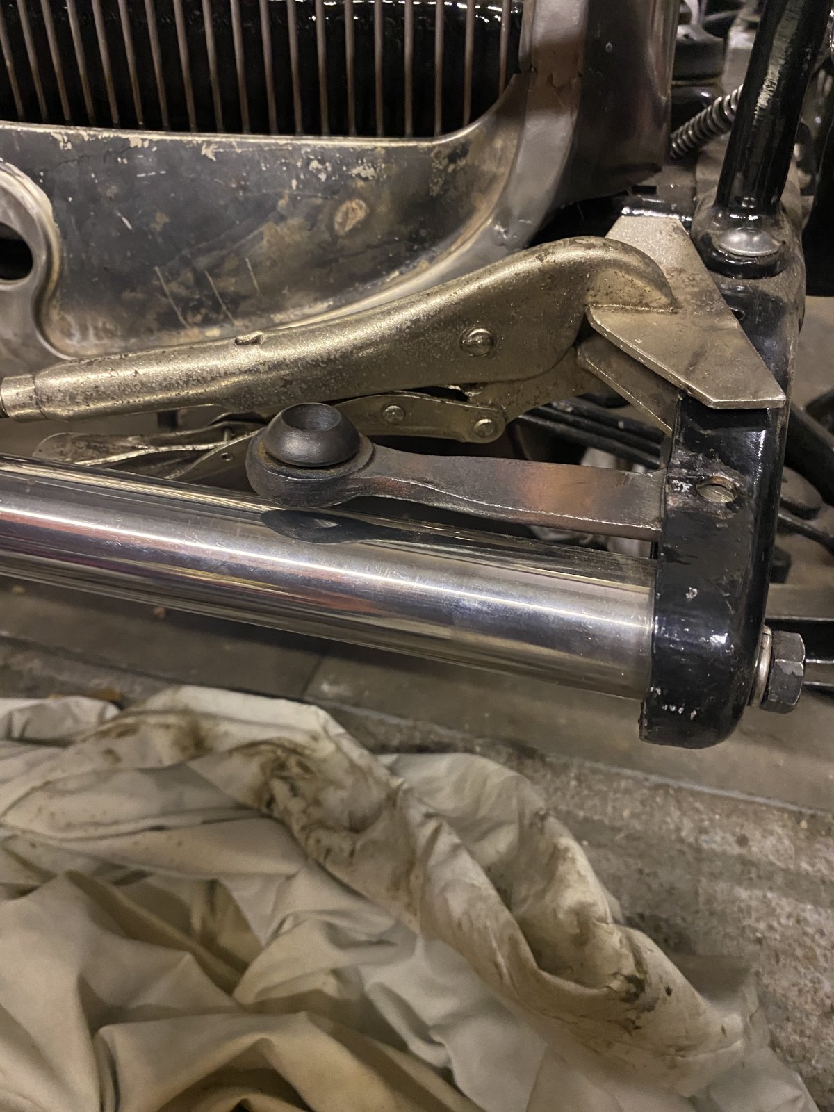

    I got the tank connected up last night and bolted my toolbox down. Also been making a bracket to hold a fog lamp… I used a wheel nut with the centre drilled out, stuck into an old 3/8” ring spanner - it needs a bit of finishing and the base that is riveted to the lamp shell is loose, so it looks a bit 'droopy' in the picture.
    3C30ED17-7E84-4DA4-8762-1F1E25CD8740.jpeg 3E321D21-5908-4DAA-B60C-120583A3D64C.jpeg 9AC2787C-3545-4B34-9D8E-3F6B0156EF40.jpeg
    I also got the firewal recess flipped and tacked into place.
    There are a few more things I want to do while the body is on, then the next move is to lift it off and have a closer look at plumbing and wiring. Clutch linkage still needs to be addressed, too.

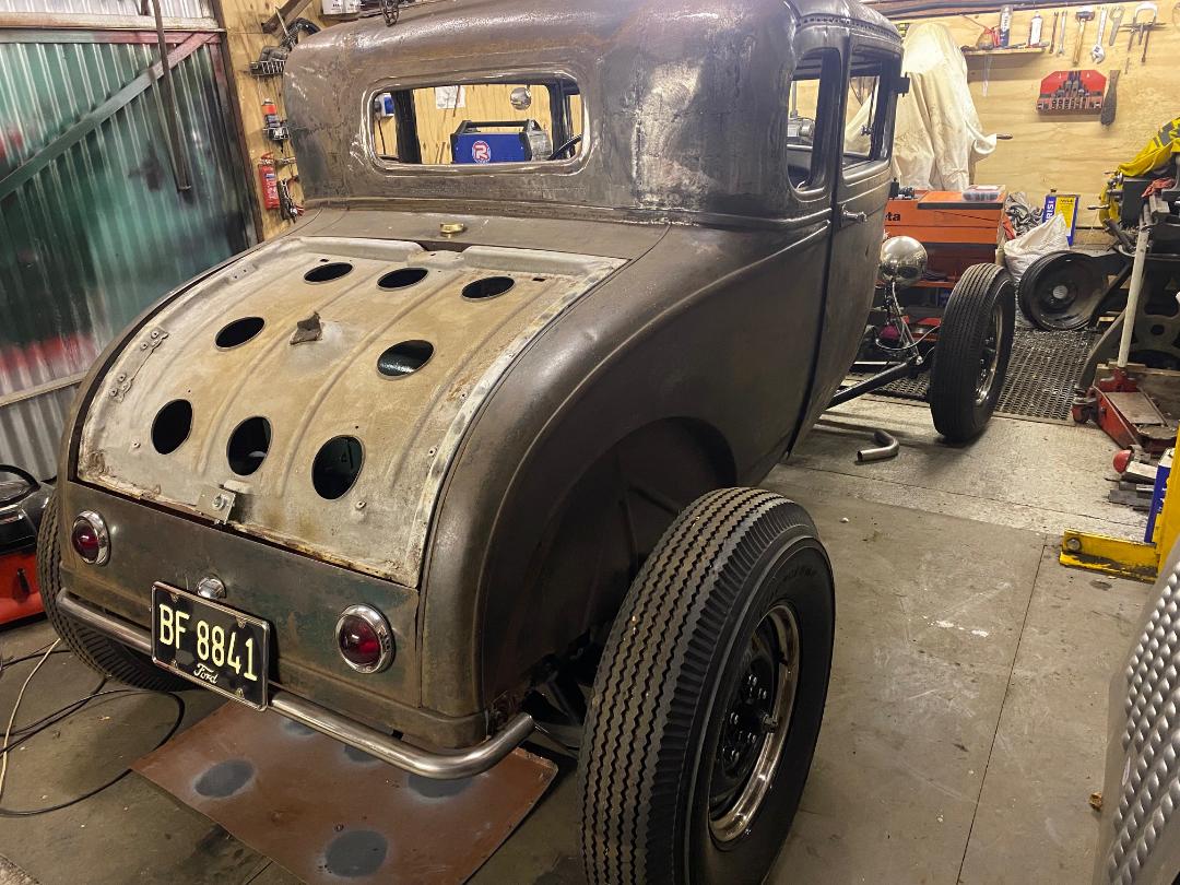

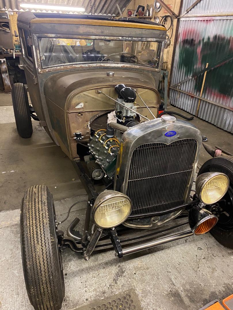

    I have got the F1 steering box in place now, seat mounted, screen in and have finished off a few other little bits on the body, including a slam panel for the trunk (thanks to an ignorant courier, my stock one got squashed on it's way here). I have the trunk skin and hinge/latch arrangement to sort out next. I plan to make the hinges and in one of the pics below you can see the louvred skin that I need to try and wrestle into shape.
    Still lots of little bits to do before I lift the body off again (some of which are things I have already done, but am not completely happy with). Here are a few pics of how it sits right now.

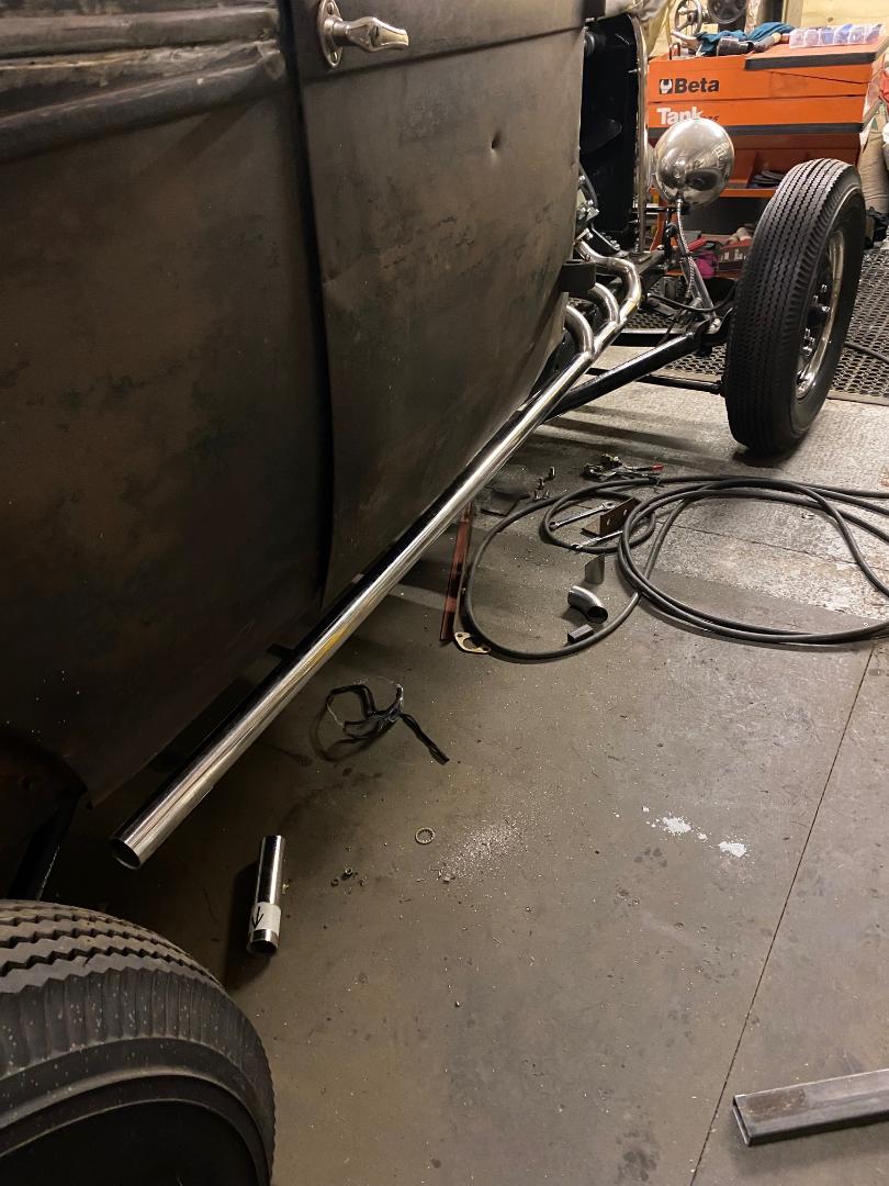

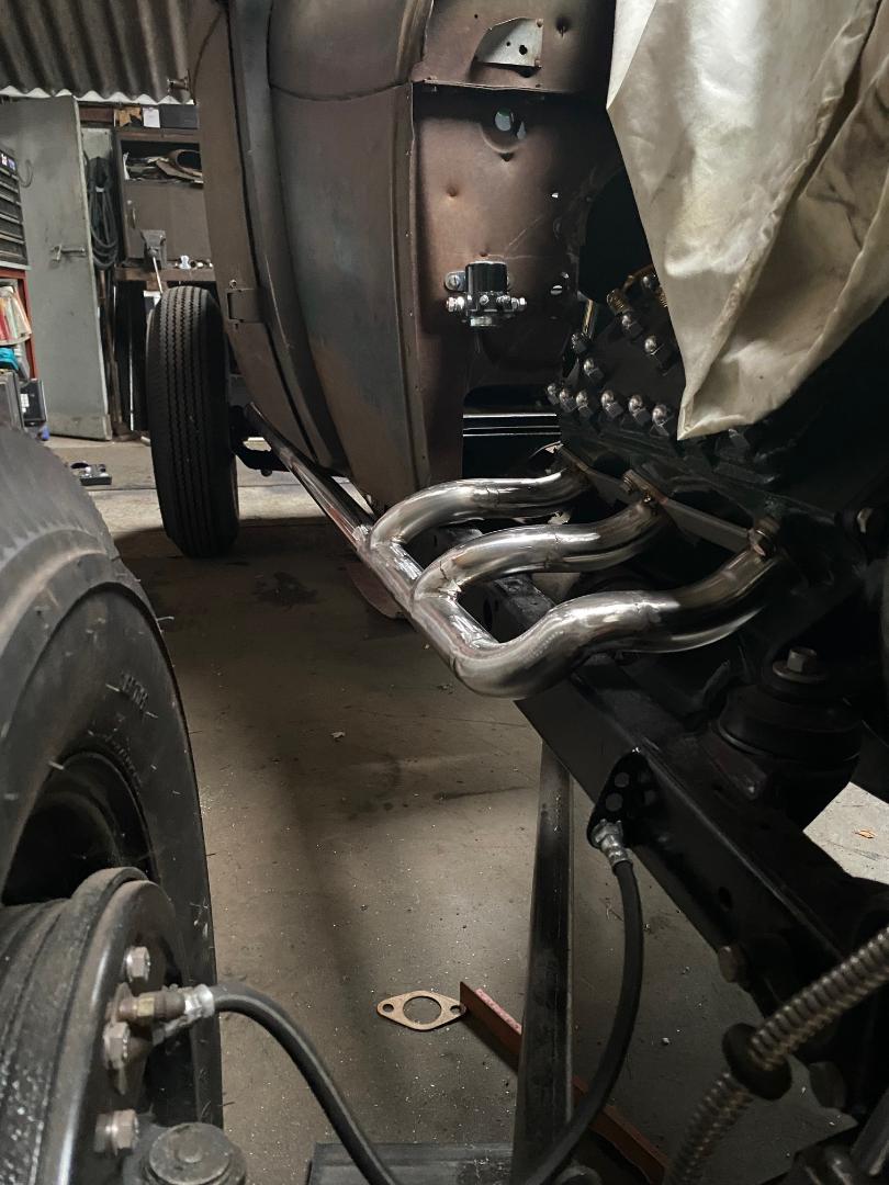

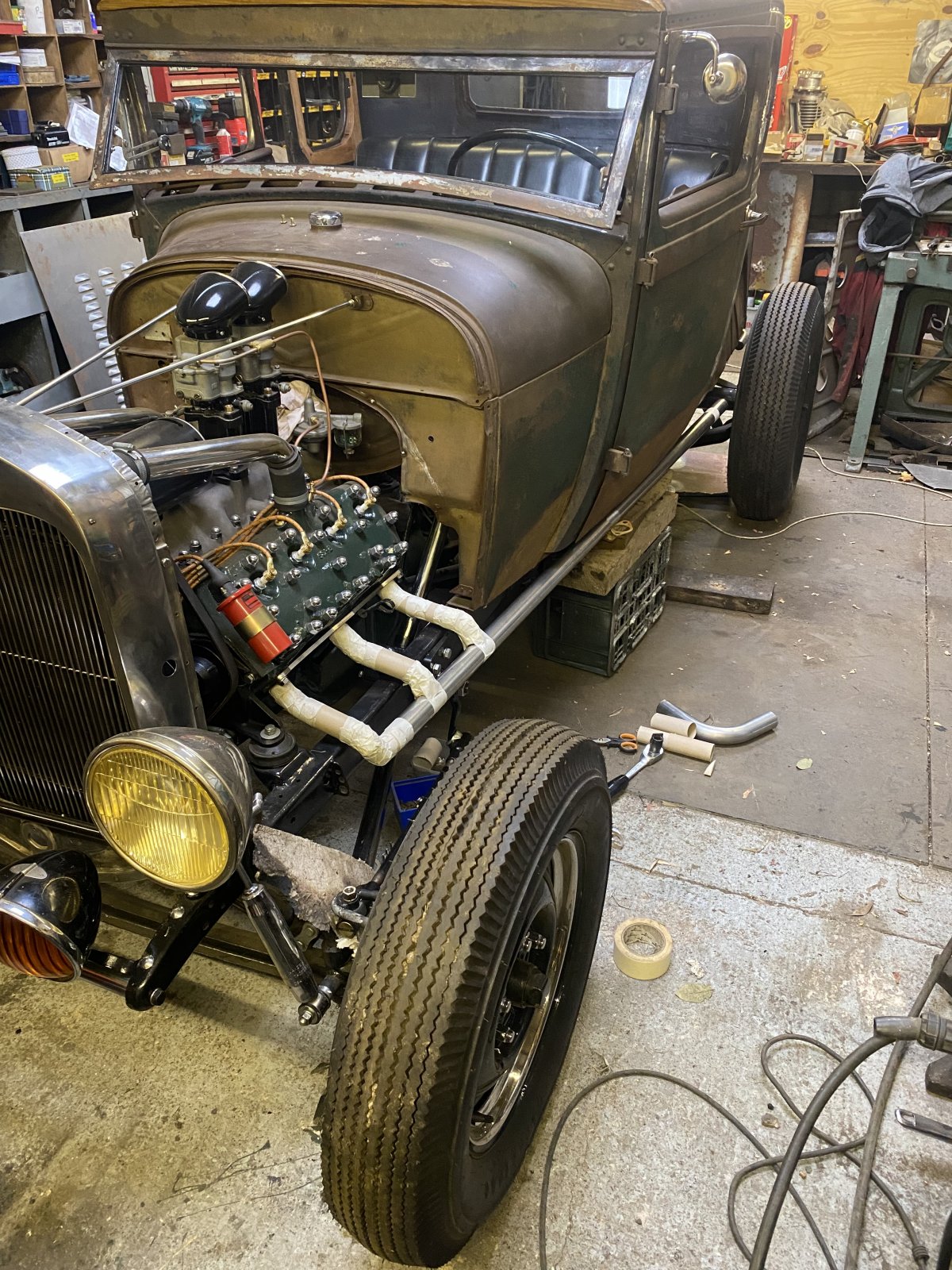

    8BF90EE7-0370-4C83-AEAD-156CB34F3E83.jpeg 78D6C853-7775-4421-B774-6087227F2631.jpeg 30C09597-4171-4383-9B1C-048D0D4D9167.jpeg I’ve started working on my headers/exhaust. There have been lots of ideas since I started the project, but it feels like I need something fairly eye-catching and wide to fill out the front end of the car have settled on this (although I have been known to do a U-turn on occasions).
    All the bog roll centres that I have saved up have come in handy. I have done the easy bit, now I have just got to make it in steel!
    cederholm, Tim and tr_rodder like this.
  28. Little Terry
    Posts: 808
    Little Terry

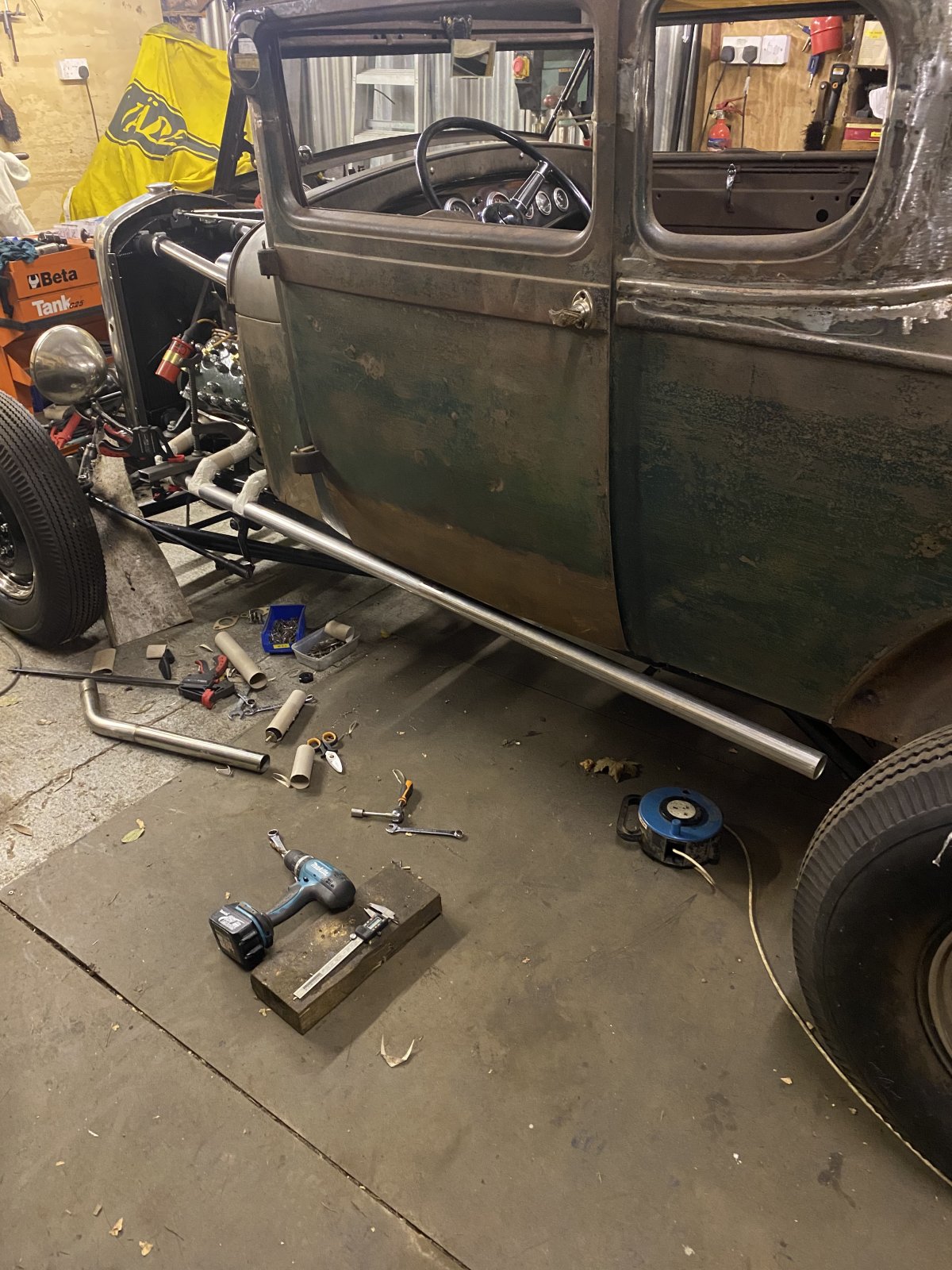

    Many hours of cutting and grinding later (and still plenty to go).... headers2.jpg headers1.jpg
