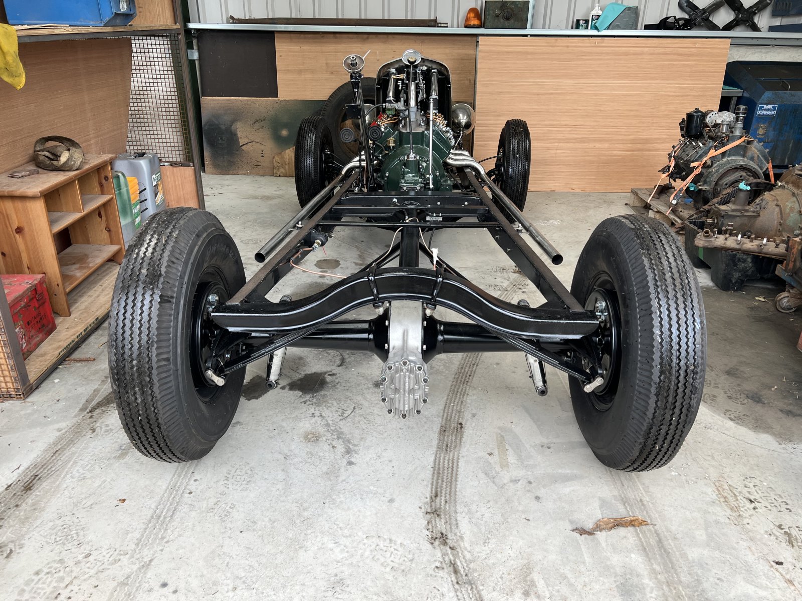

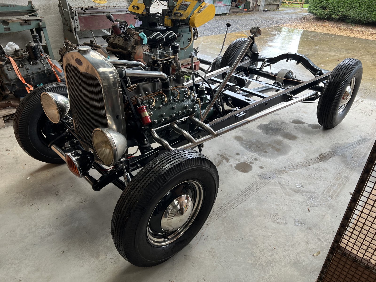

    Thanks folks. I hope to get the rolling ch***is pushed out into the daylight at the weekend and start prepping the underside of the body, so that it can go back on for the final time.

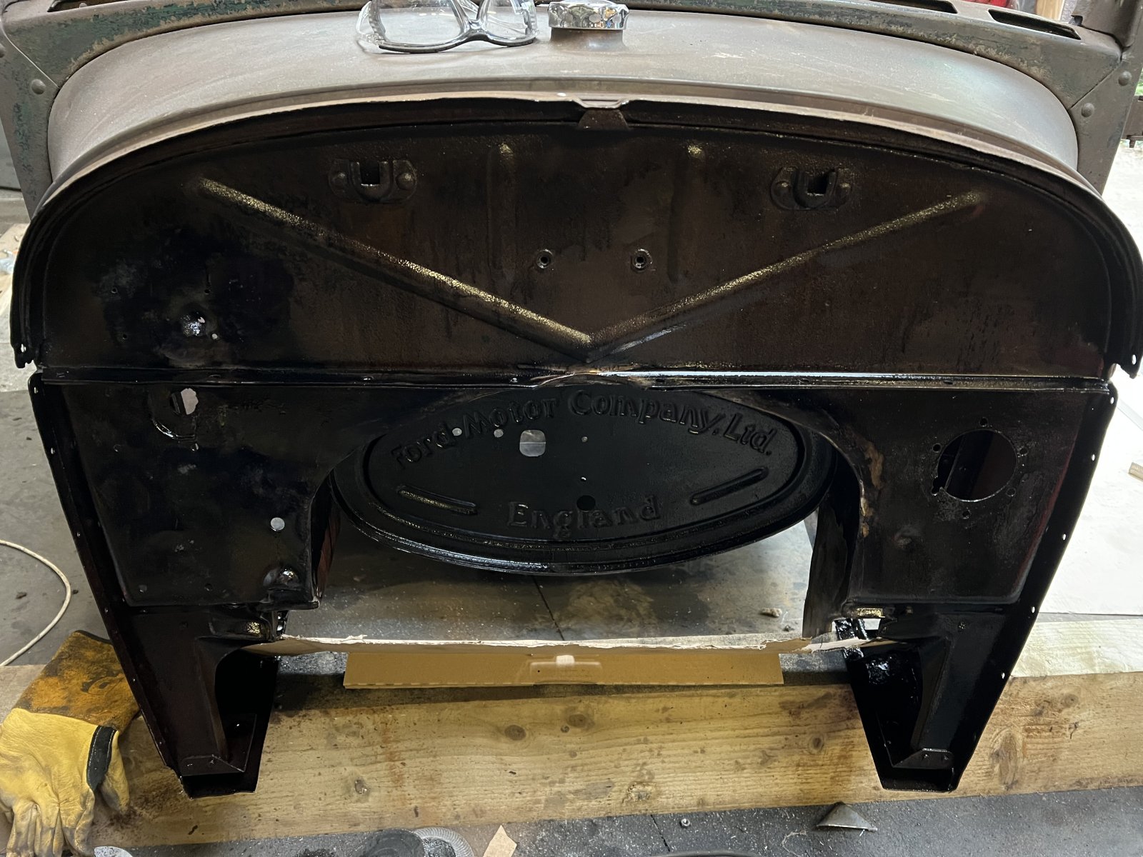

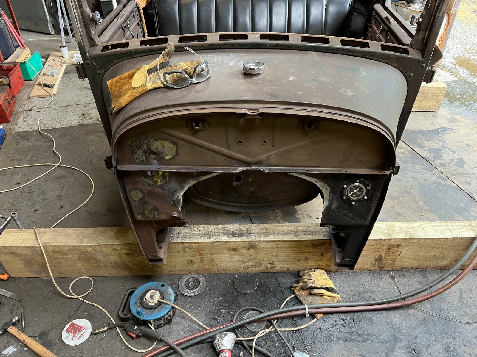

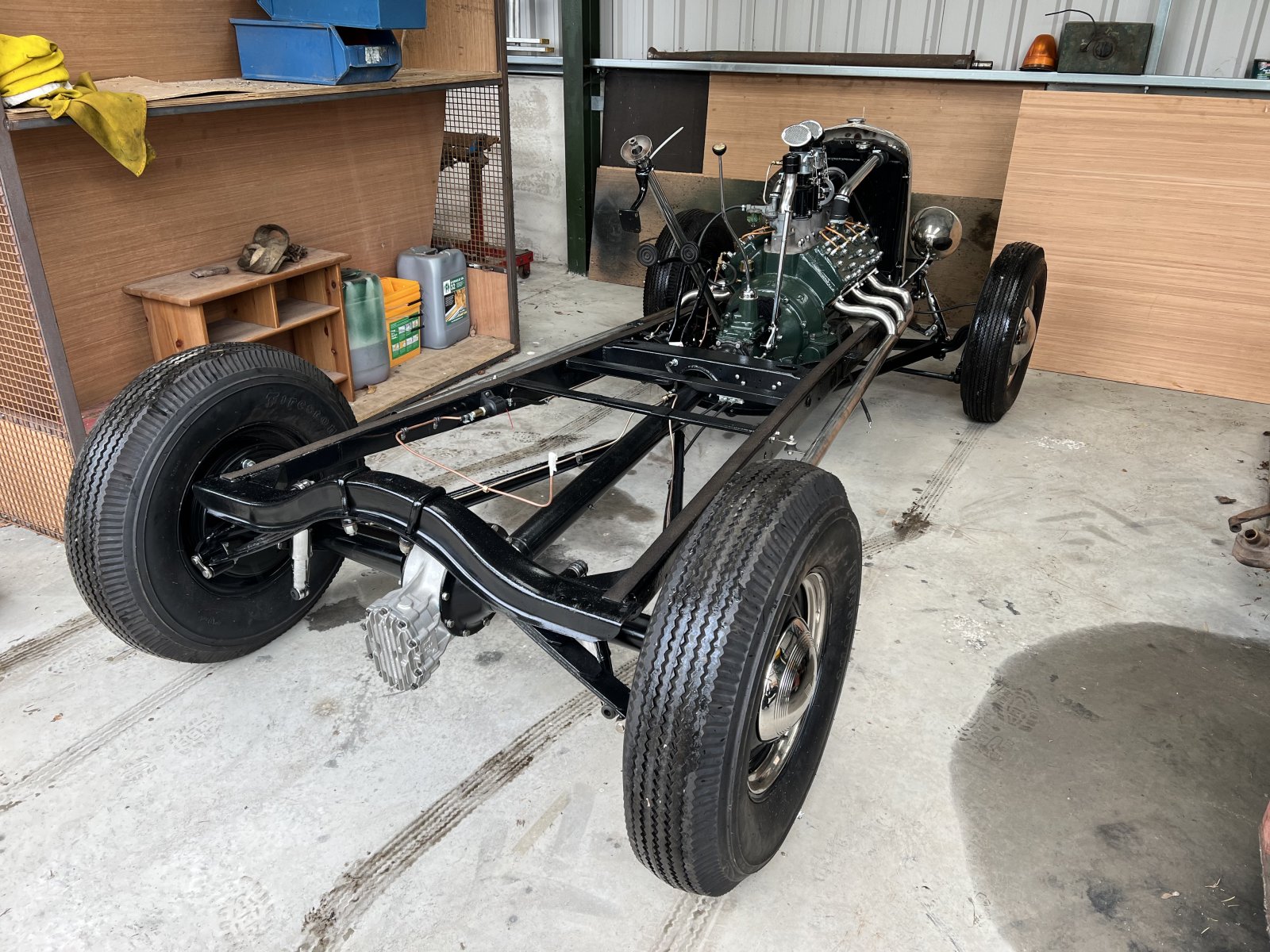

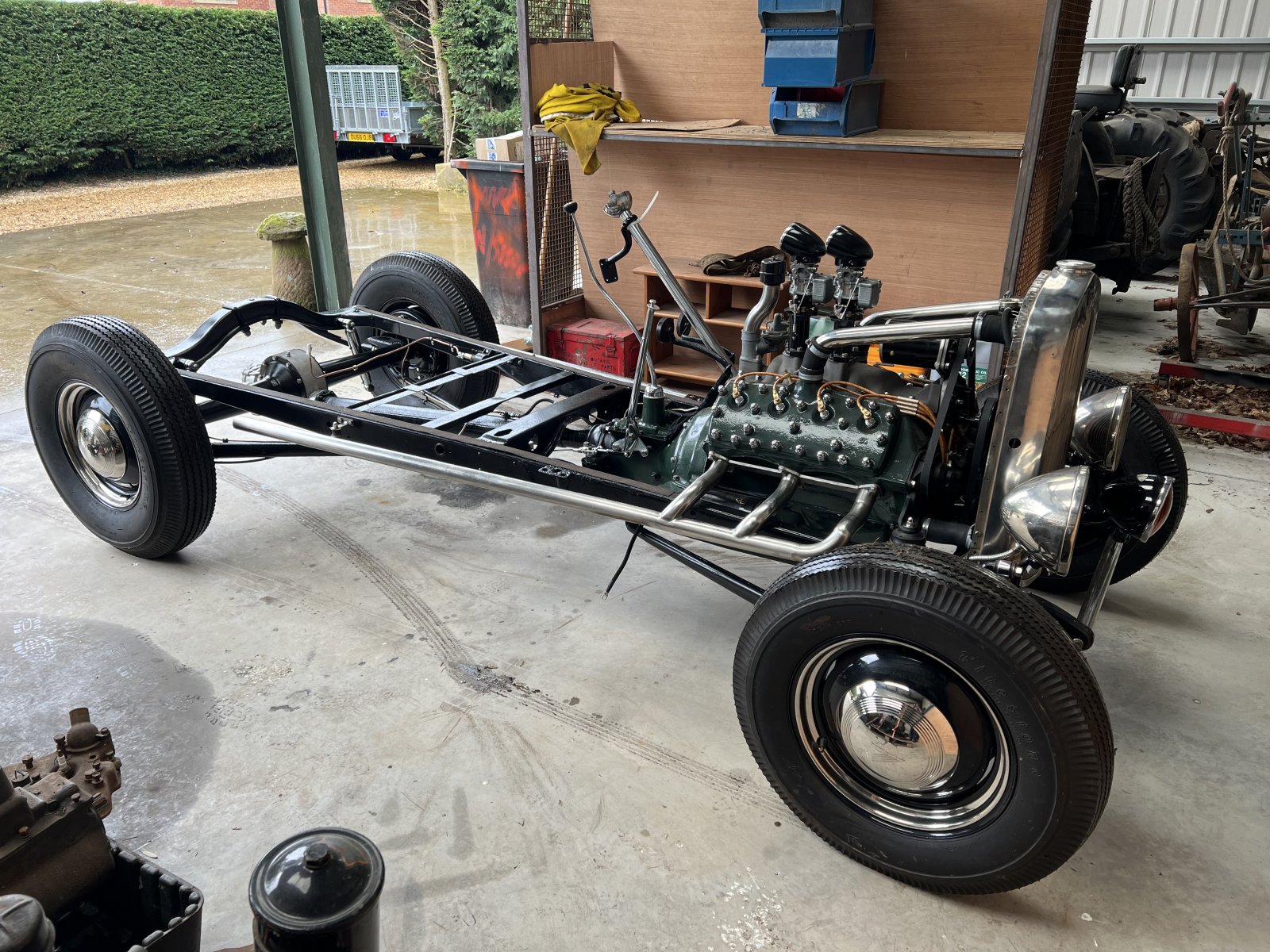

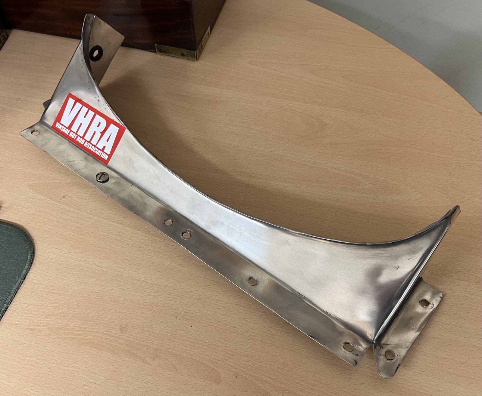

    A few more shots from today. I decided to spend some time on filling the holes in the firewall and improving the recess a bit. 95FDB8E4-17E5-4F9C-AE69-ADA596720F44.jpeg 62532CBE-970F-4E31-9E98-418332E6BB1A.jpeg 8DF69AF8-15CD-449B-987D-22A46CBB9B84.jpeg 3BE70A19-E40D-48B3-A8C3-5FFD10A3CDD5.jpeg 3C9EE295-F31C-4F06-A5D7-3CC106BEE136.jpeg 67EF89FB-4BDB-4FA0-822D-FA502EB6478F.jpeg

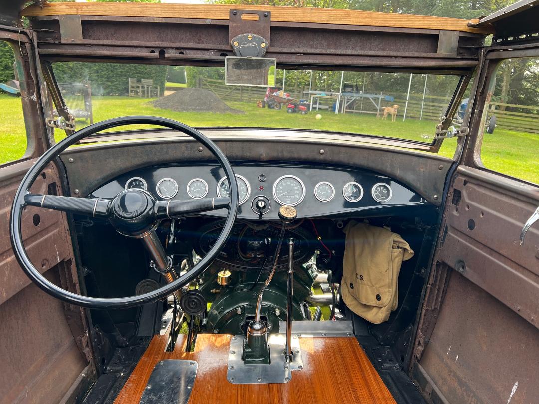

    Thanks guys. I'm still working on ****oning everything back up. There are loads of little bits that take so long. It will be a while before I get round to wiring the lights and gauges up and hit the road, but it's quite satisfying to be at this stage. Here are some stills of how she looks with the body on. Since these were taken I have got the windshield and steering wheel back in. I have also had to play around with the rear spring pack a bit - trimmed the second as I missed that issue first time round, and added one short leaf to the top of the pack. I have a problem with the fuel filler neck and have made up a better adaptor in the lathe to improve the strength of the connection.
    Next I will fit the seat and floor, then move on to the trunk lid/skin and the wooden body frame. Rear shock mounts are still on the water somewhere!

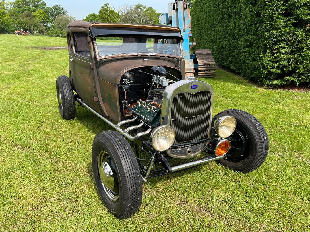

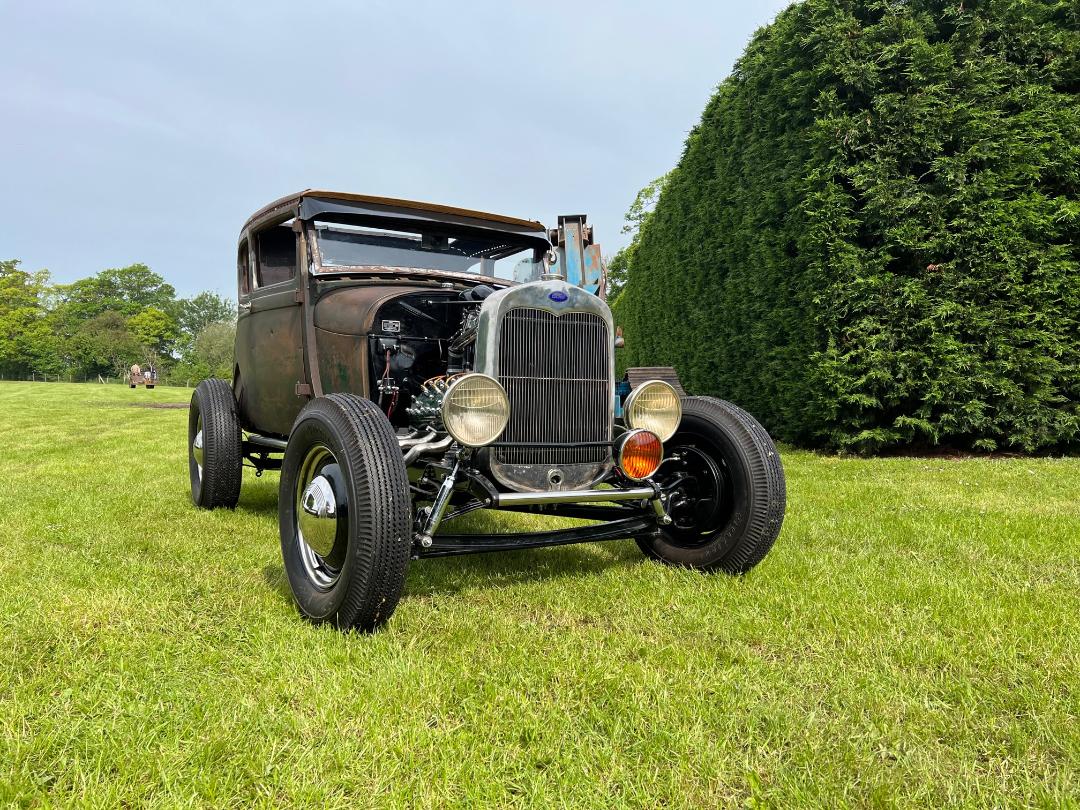

    I got some toys out at the weekend for a BBQ with some of my mates. the Model A made it's debut, albeit no yet fit for road driving. I did few miles round the paddock :)

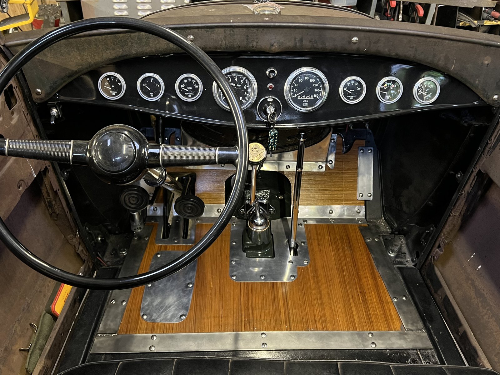

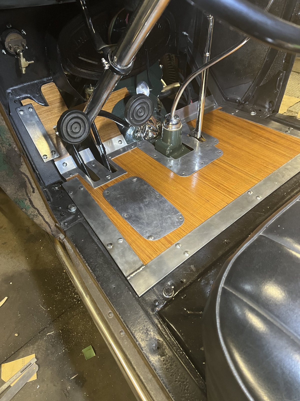

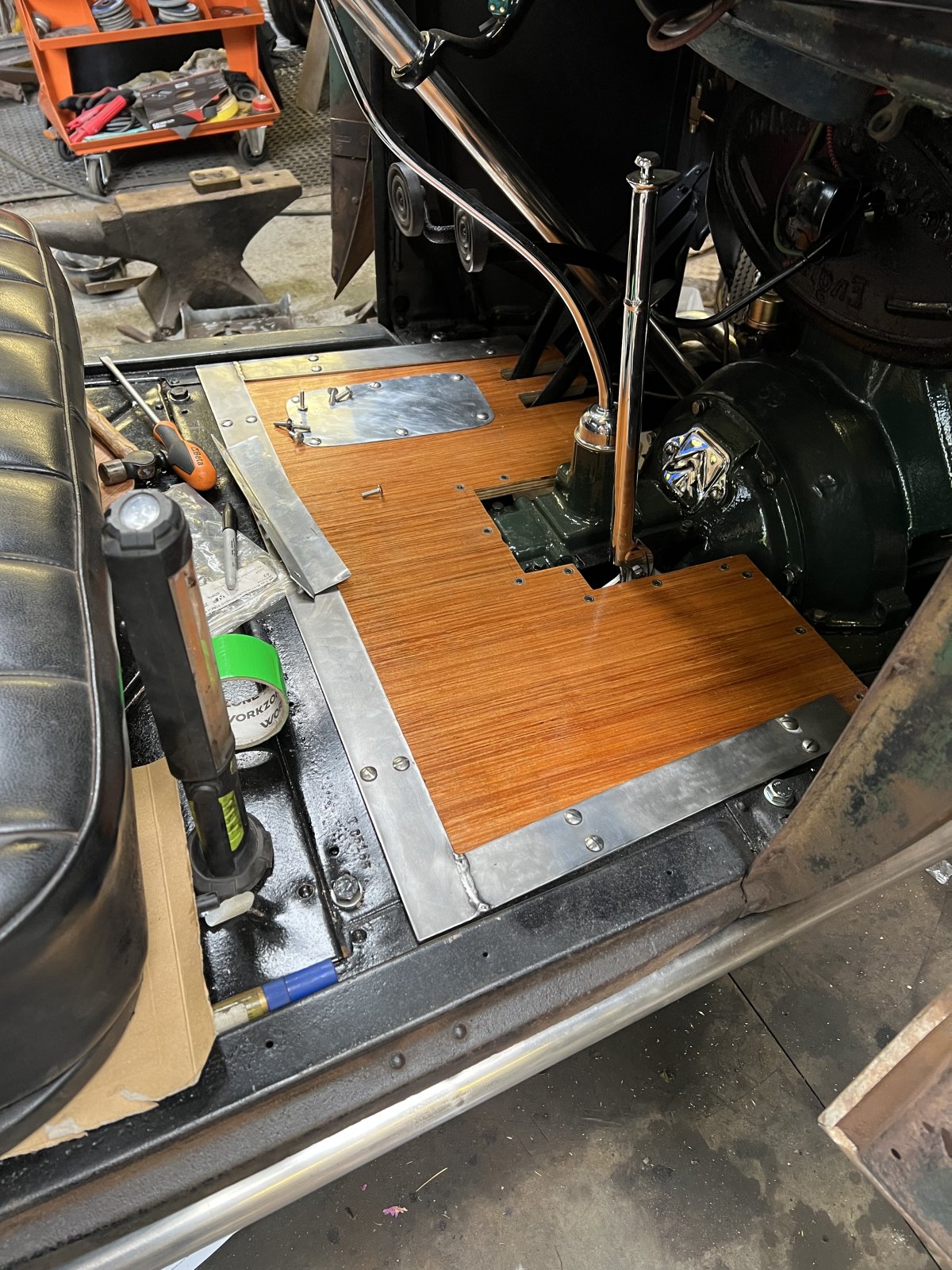

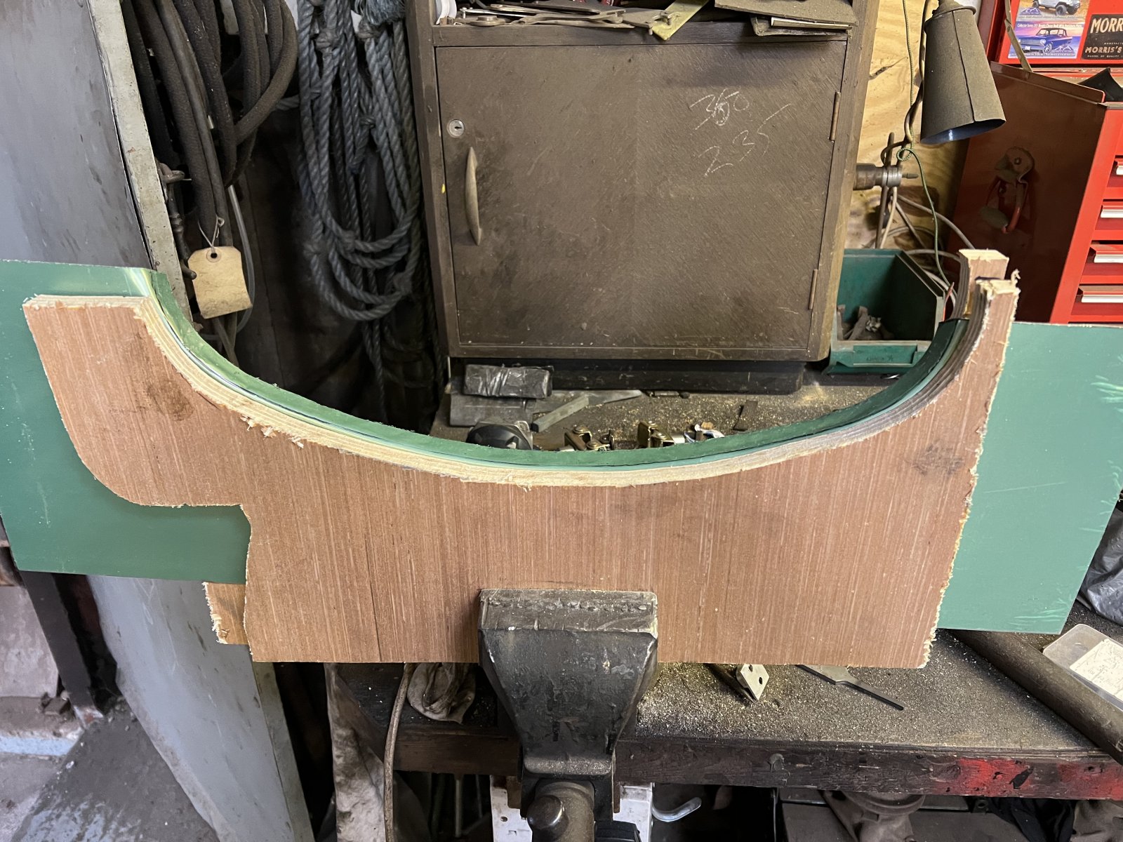

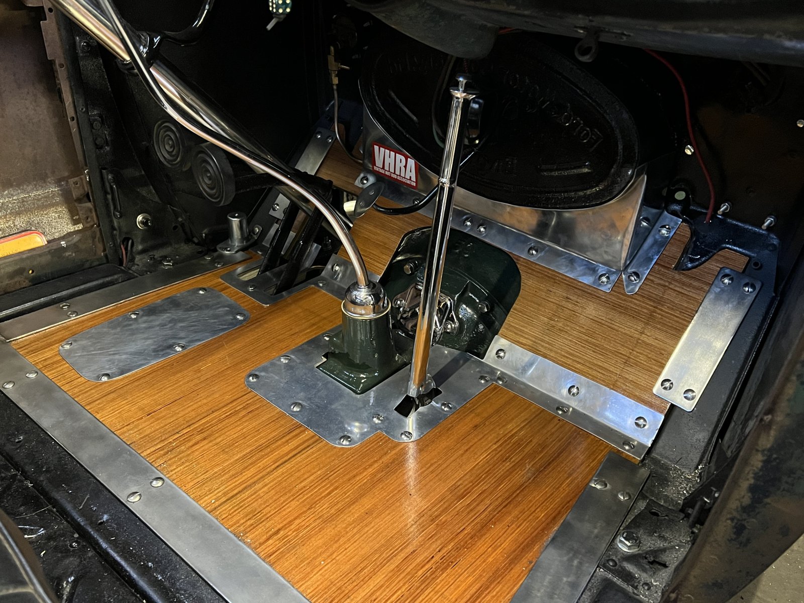

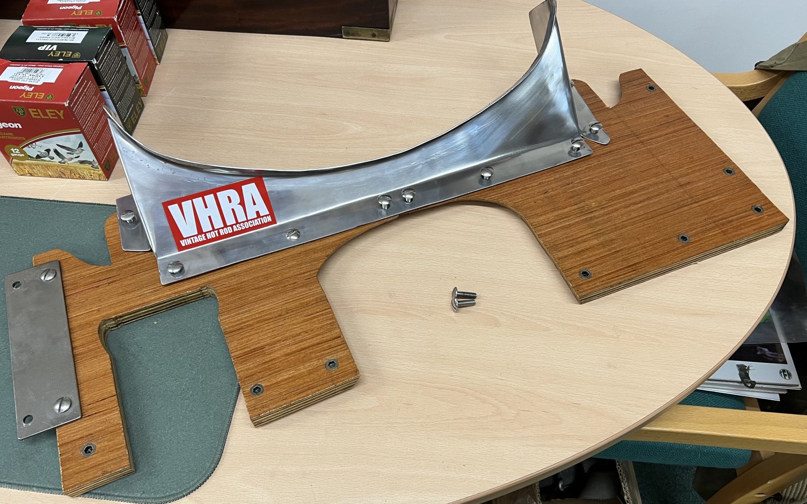

    At long last I think I have got the floor sorted. I found this but to be one of the most challenging parts of the project. Having used the oval Fordson recess in the firewall caused me a big headache and I just couldn’t visualise how to finish the toe board whilst making it look ok and have it easy to remove. I ended up making it in 3 parts (after 2 catastrophic attempts) - 2 x plywood floor halves and an alloy folded section to join it all together. I used more nutserts and mushroom screws. I’m happy with the look and it comes out in a couple of minutes to access anything I need to in future.
