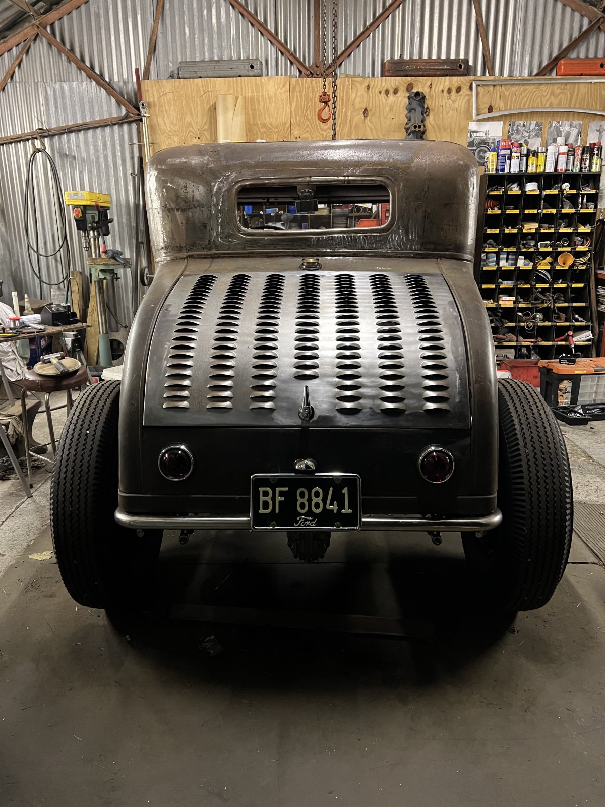

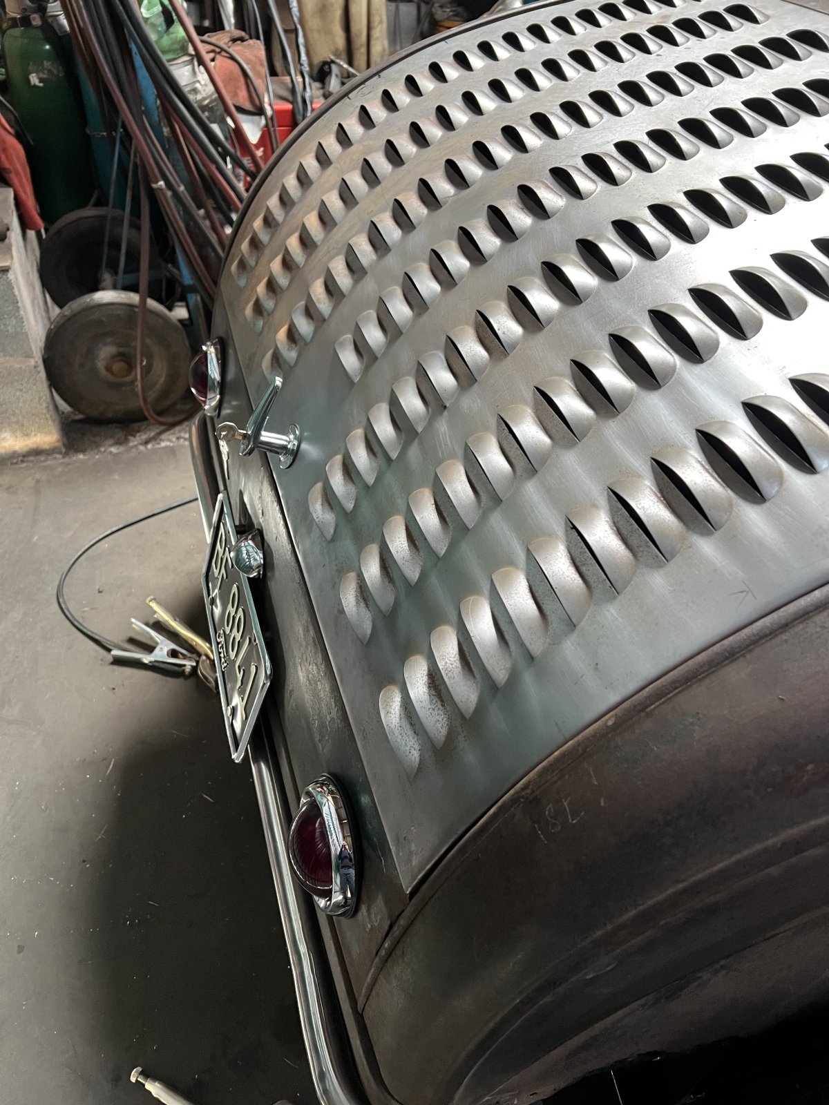

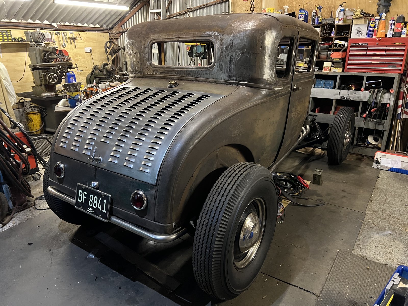

    Thanks guys. Nearly there with the trunk. The skin is now fitted to the frame. Just some final welding and minor dolly work to do. Then I am going to do the slam panel.
    F66DE2D5-6136-4228-9339-721E3563A5F5.jpeg EE495EF3-8CFC-43F1-871D-BBB5D3B27D6C.jpeg CD27D8D1-0AF3-40B6-B1B1-4CC137B0F0BD.jpeg
  21. Outback
    Joined: Mar 4, 2005
    Posts: 3,622
    Outback
    from NE Vic, Oz
    Your coupe is really coming together, that rear view is the money shot, it looks so good! Thanks for taking us on the journey!

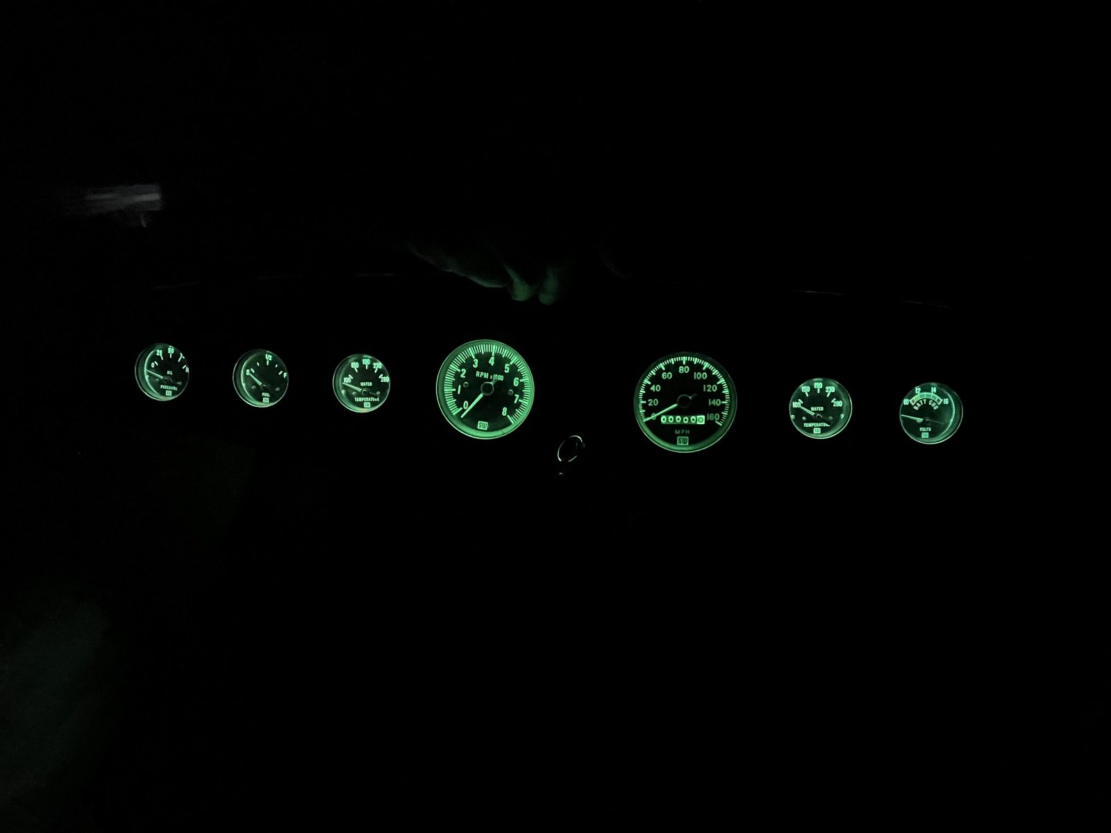

    Still working on wiring. We have fitted a large connector to the dash so that it can be disconnected from the loom and removed from the car if required.The biggest disappointment has been the quality (or lack of) of the new SW gauges. The smaller ones are OKish, but the Tacho and Speedo are shockingly bad. They have a real cheep feel to them, one has a plastic body and the font/typefaces don't match. The picture below of them illuminated shows the difference. They are going to get replaced before too long.

    I took the plunge and swapped the SW tachometer and speedo gauges for some from Cl***ic Instruments. Night and day difference in quality. I went with the curved gl*** to give a contrast against the small SW gauges that will stay for now. F97C9CC1-4C76-416A-B499-16F5BF2F1CF5.jpeg
