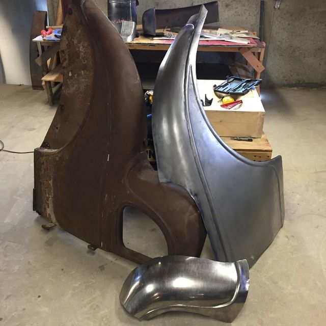

    I started finishing on the quarter this week...
    it was formed in 3 major sections so I started welding them together.. this is where it can go all wrong, luckilly it played nice
    [​IMG] [​IMG] [​IMG]
    also, I made some dies for the beltline of the front of the quarter.. still tuning them before I run them.

  23. toreadorxlt
    Joined: Feb 27, 2008
    Posts: 728
    toreadorxlt
    from Nashua, NH
    two more. I made a quarter window but im not entirely happy with it. Luckilly Nils and Josh have a stocker that I'll merge in. In the mean time heres the last pics from me for a while until I have time to fit and weld it all up. and if anybody wants beltline blanks, PM me.
    [​IMG] [​IMG]
