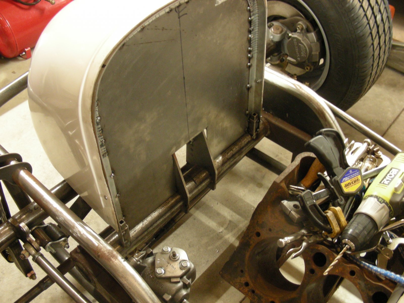

    So today I got a little bit done. Made a template for the nose to make a support hoop for the back of it. Using a section of formed angle I kerk cut it to be able to bend it to shape. You know Styrofoam board is rigid enough to form something like that on?
    I got it to shape and braced it to hold its shape. Now the next cool morning I'll do a bit of welding and grinding to finish it.
    Welded together the rear suspension supports so now I can put the turtle deck back on and drill the holes thru the turtle deck for them. I'm keeping a lot of things just tacked for now because you never know...
    And also made a mock up for the radiator. It needs to have an offset in the lower tank to fit around the steering box. It will be spendy, but what can you say???

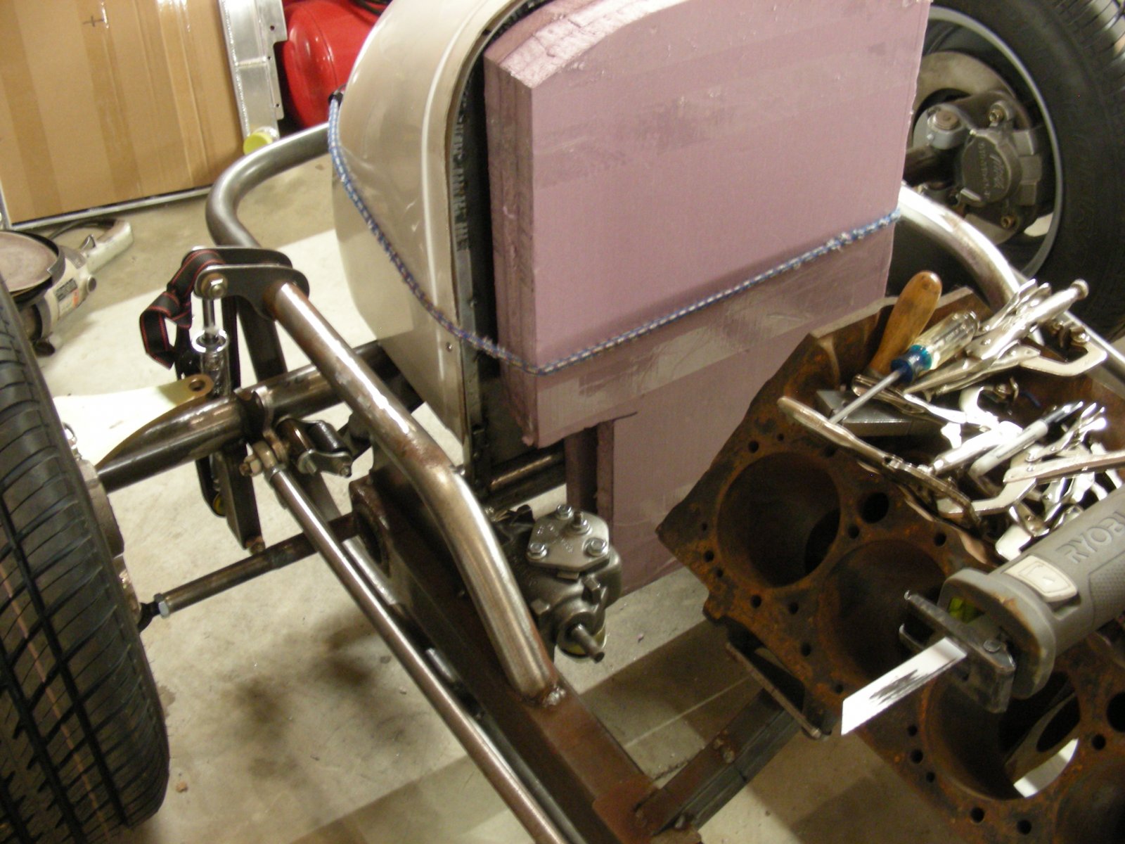

    Tinkering in the garage today. I think that I have a solution to the nose/hood/radiator arrangement. Made a support thing, not completely finished yet, and a start on the mount for it to fit the nose on the ch***is. DSCN1229.JPG This is the start. Yes the sheet stock needs to be mostly cut away, but it might be a solution to getting airflow to the radiator. I'm thinking that I can mount an electric fan to the front of the sheet, and cut and form a shroud to direct air from the nose thru the radiator.
    Also because the radiator if made like I'm imagining will extend below the front cross member, and I want some form of belly pan, I was thinking that it could be useful for more airflow to the radiator.
    DSCN1231.JPG Here's the mock up for the radiator. The notch to clear the steering box is bigger than necessary so it will be filled in before I deal with a radiator shop. I intend to send them the mock up once it's finalized.
    DSCN1228.JPG Angles looked good and it's centered so I'm good with it...
    Any ideas, comments, recommendations, I'm open to suggestions.

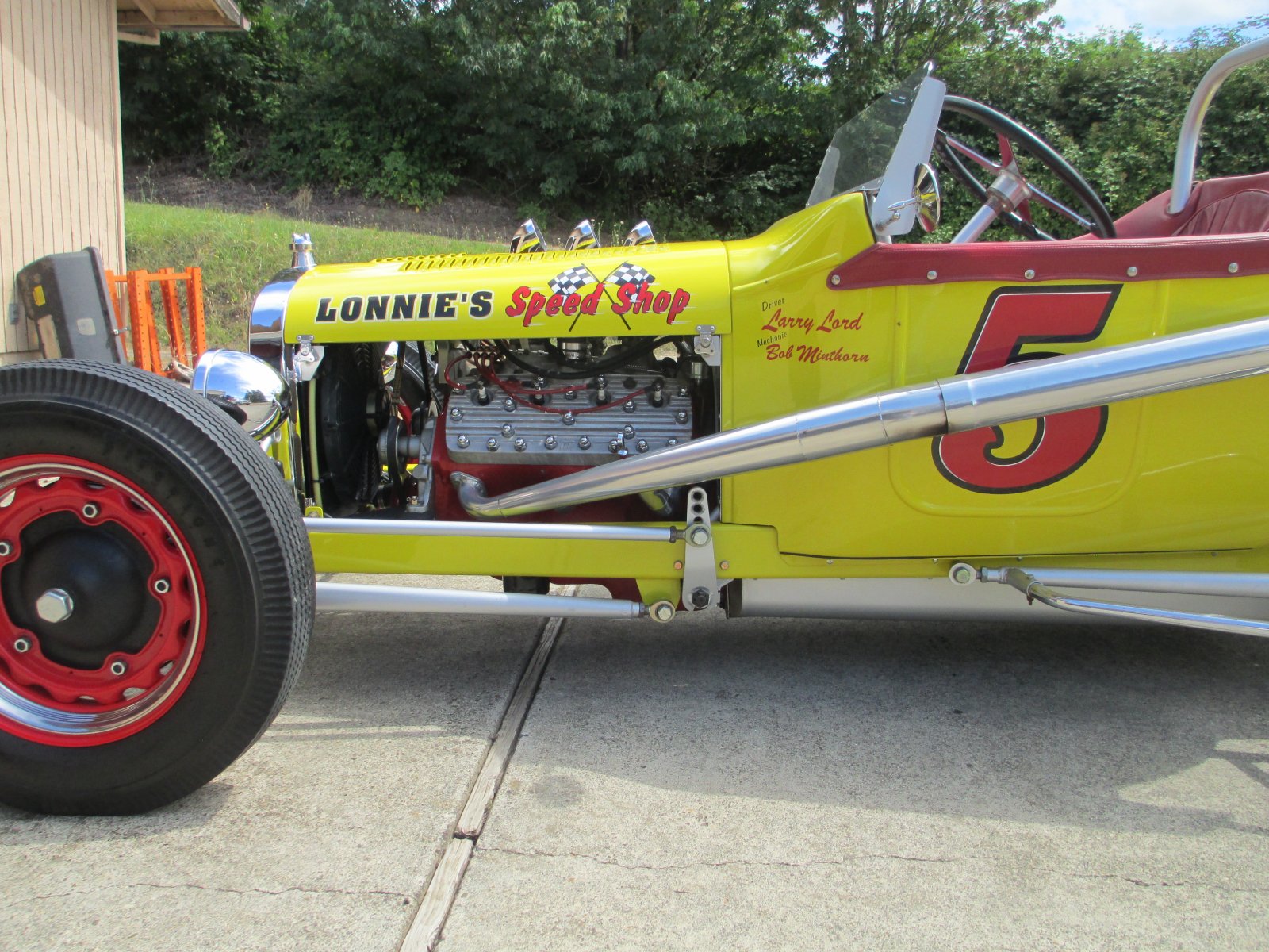

  7. HJmaniac
    Joined: Jun 11, 2006
    Posts: 5,396
    HJmaniac
    Taken from 65Pacecar's posting on "what did you see today"
    Okie Pete, ratrodrodder and loudbang like this.

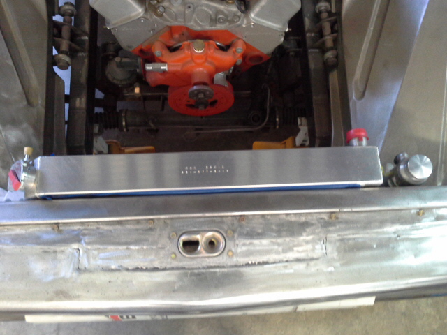

    So DD, what's your opinion on the radiator? Does it look doable for Ron Davis radiator?

    In the words of Dave Spivey "I like it! " (look up that name and mtd commercial).
    The white car's exhaust recess is really cool!

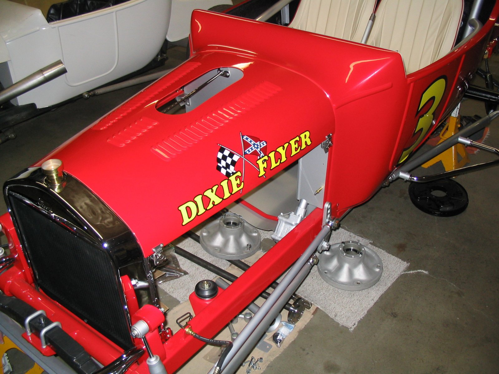

    I like the straps and springs. I saw somewhere a unique latch ***embly that worked with a strap. It looked really good, but now I can't find it again.

    Okay so some great suggestions for hood restraints. I may get thrown out of the club so to speak, so I will put this out for comments. I would like to have side panels as well as the hood. And on a couple of the cars we raced over the years we used Dzus fasteners to hold it all together. I'm thinking that the nose will be riveted to the support structure using large head rivets.
    And as there is a steel structure under the nose it will be strong enough to attach the Dzus springs to it, both for the hood and the side panels. That's the front. I'm going to fabricate a support hoop for under the cowl and will attach the body to it. I'm still cogitating on the firewall and have to make a decision sooner or later. Will it be a steel firewall with the fibergl*** cut away leaving a lip to attach the firewall to? Maybe aluminum plate to also act as the rear engine support?
    The body lip would be a good place to attach the Dzus springs for the rear of the hood and side panels. I can figure out what to do to get the support hoop the firewall and the body all attached to each other. The question is, am I way over thinking it?
    See this is why engineers get a bad reputation. And have to be reminded that better is the enemy of good enough!

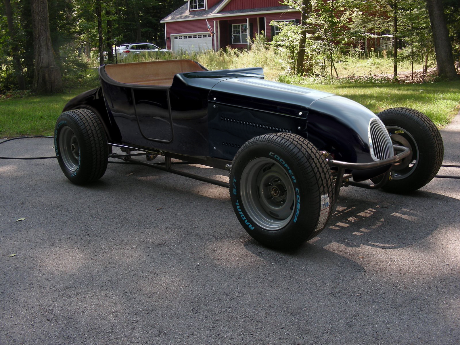

    Drilled the holes thru the turtle deck for the rear suspension upper shock mounts today. Being bodywork averse, I was reluctant to get it done because if I screwed up I'd have to fix it.
    DSCN1235.JPG Here's the right side. Today was the first time it rolled outside sitting on all 4 wheels without blocks holding something up. Tomorrow's project is get old mangy back in the frame to establish clearances...

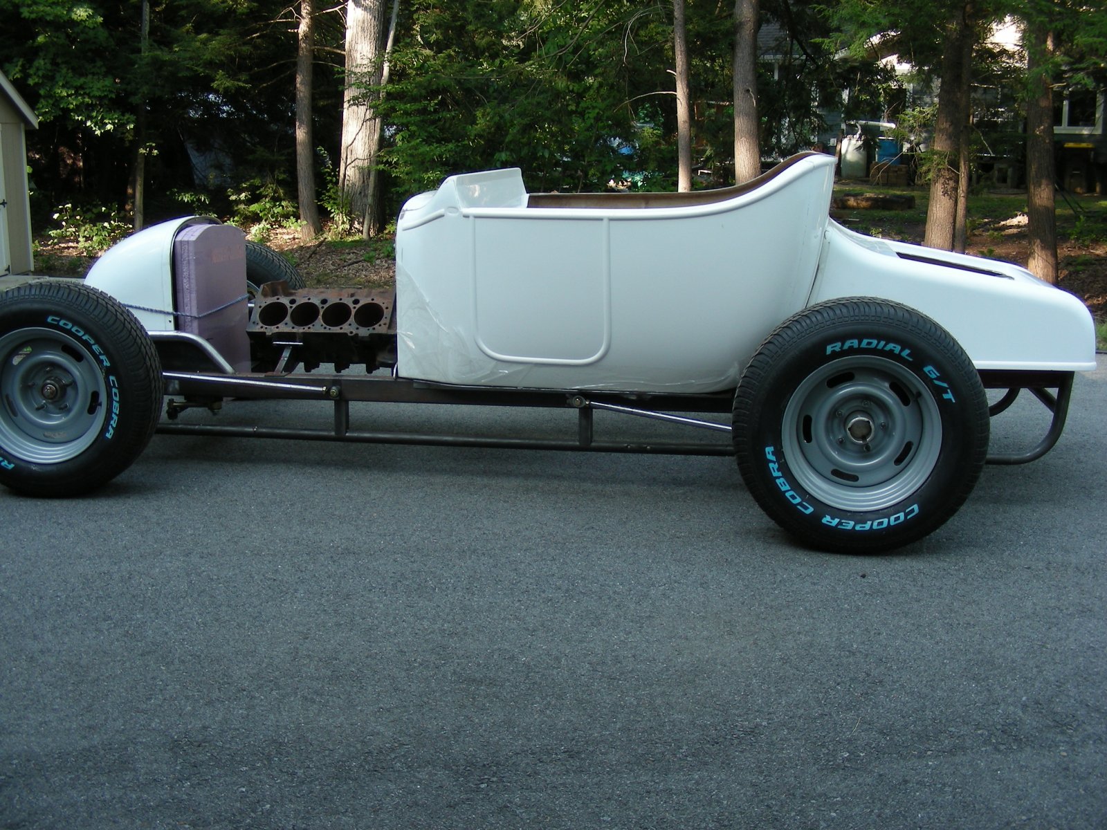

    Oh some other pictures while it was outside today.

  25. themoose
    Joined: Dec 7, 2008
    Posts: 9,900
    themoose
    Sorry this took so long but I had some other stuff going on. Here's something that might give you an idea of how it might look..Black would look sharp.
