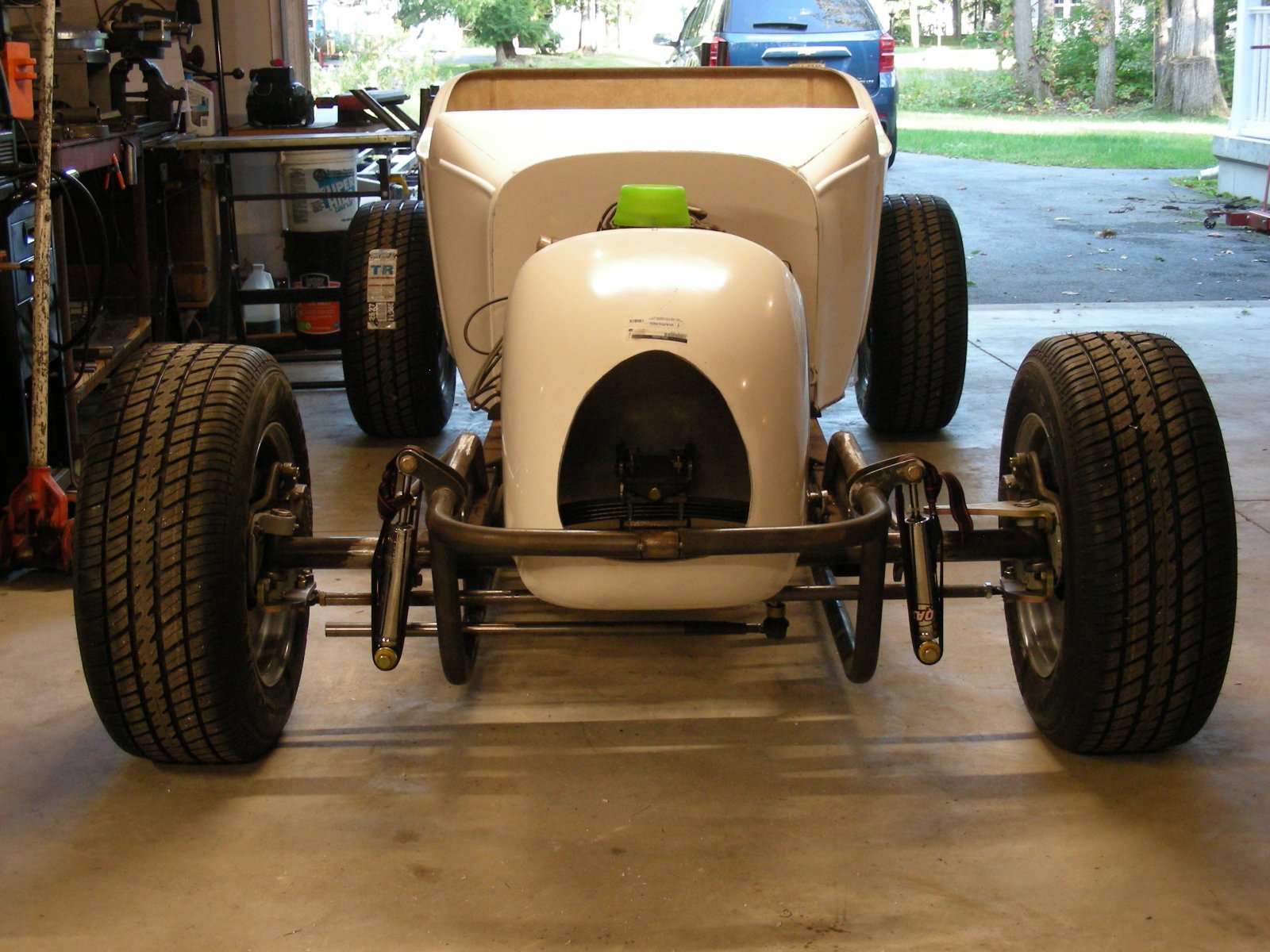

    Put old mangy back in the frame today.
    DSCN1239.JPG It's tight but doable for the most part. It needs to be right up to the firewall so I have to get the T5 in and make a crossmember to support it, doing away with the side mounts I was thinking of using previously. No big deal as I knew that I had to make crossmembers and triangulate the frame anyway. So Marty I plan on plaigerizingsome more of the parts that you've made in your projects. I think that I can even get my clown feet down there with 3 pedals. I'm thinking that I am not going to be able to use the Moon big foot pedal I've had for a couple of decades however.
    DSCN1241.JPG Right now it's a Flintstones car!
    DSCN1242.JPG From the front, it appears that the engine will be inside of where the side panels will end up. Headers are looking like sprint car style. And long tail pipes level with the bottom rails and right next to them. As I'm playing 3D Tetris building this thing, I keep thinking ahead to try not to backtrack too many times. I'm thinking that 3 inch diameter tail pipes with the mufflers built in terminating behind the quick change will look 60s dirt car.

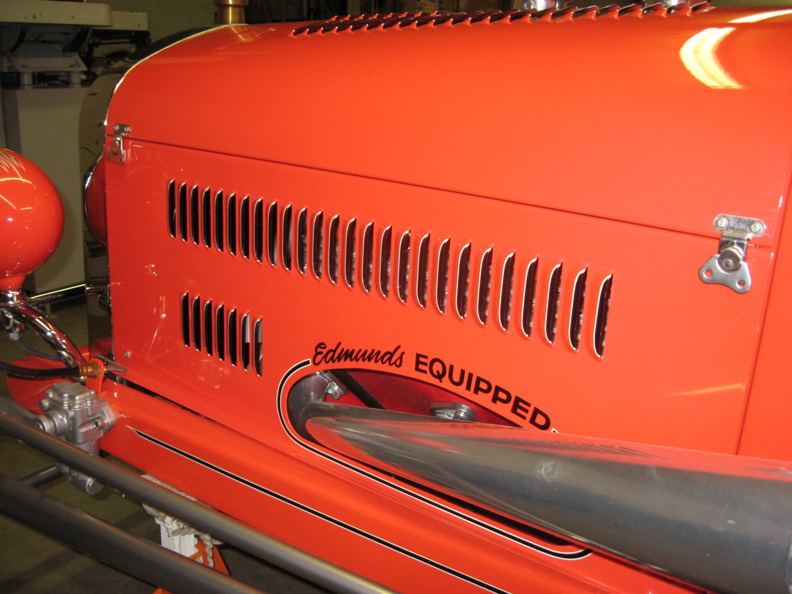

    Having a full hood, regardless of how many louvers, tends to block the escaping air, compounding the problems from the small opening in the nose. Just things to think about. IMG_1895.JPG

    Thanks for the inputs Marty. Yes I think I posted a picture of the 54 coupe from 74. Our radiators were not as good as available today, and on opening night with a brand new car, it was running hot. So off came the side panels, which went past the firewall. You can see Jim's feet in the picture.
    I'm thinking that I'll need to make vent area at least half again as large as whatever inlet area is including the nose and potentially some kind of scoop or ??? made into the belly pan. If I can't get enough airflow, well then the side panels will end up on the s**** bin.
    And I like those hood latches. I'm going to contact a colleague at the lab and see if I can scavenge some from some of the old equipment headed to get recycled. A lot of stuff used that style of latch. A lot of equipment has to be weather proof, but easily accessible.

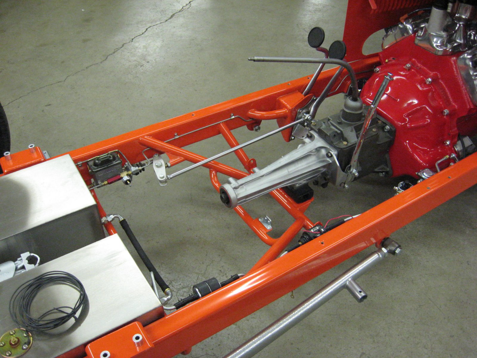

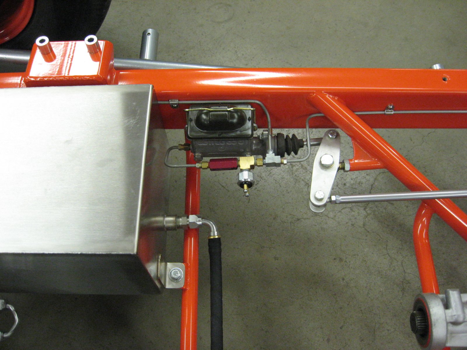

    Dave, this is what I use in the track roadsters, using 35-38 Ford complete pedal ***y. They always need to be re-bushed, shortened and a little bending required. The part I like is mounting the master cyl back a couple feet, with a rocker arm between. Also, you can change the pedal ratio, by changing the blades on the rocker arm. IMG_0667.JPG IMG_0685.JPG

    Nice! Thanks Marty. Interestingly the Mini pedals I have are shaped similarly to those, and when turned upside down will be very similar in shape. And like I said the pedal pads are small, about 1.5 inch square. Should help on room.
