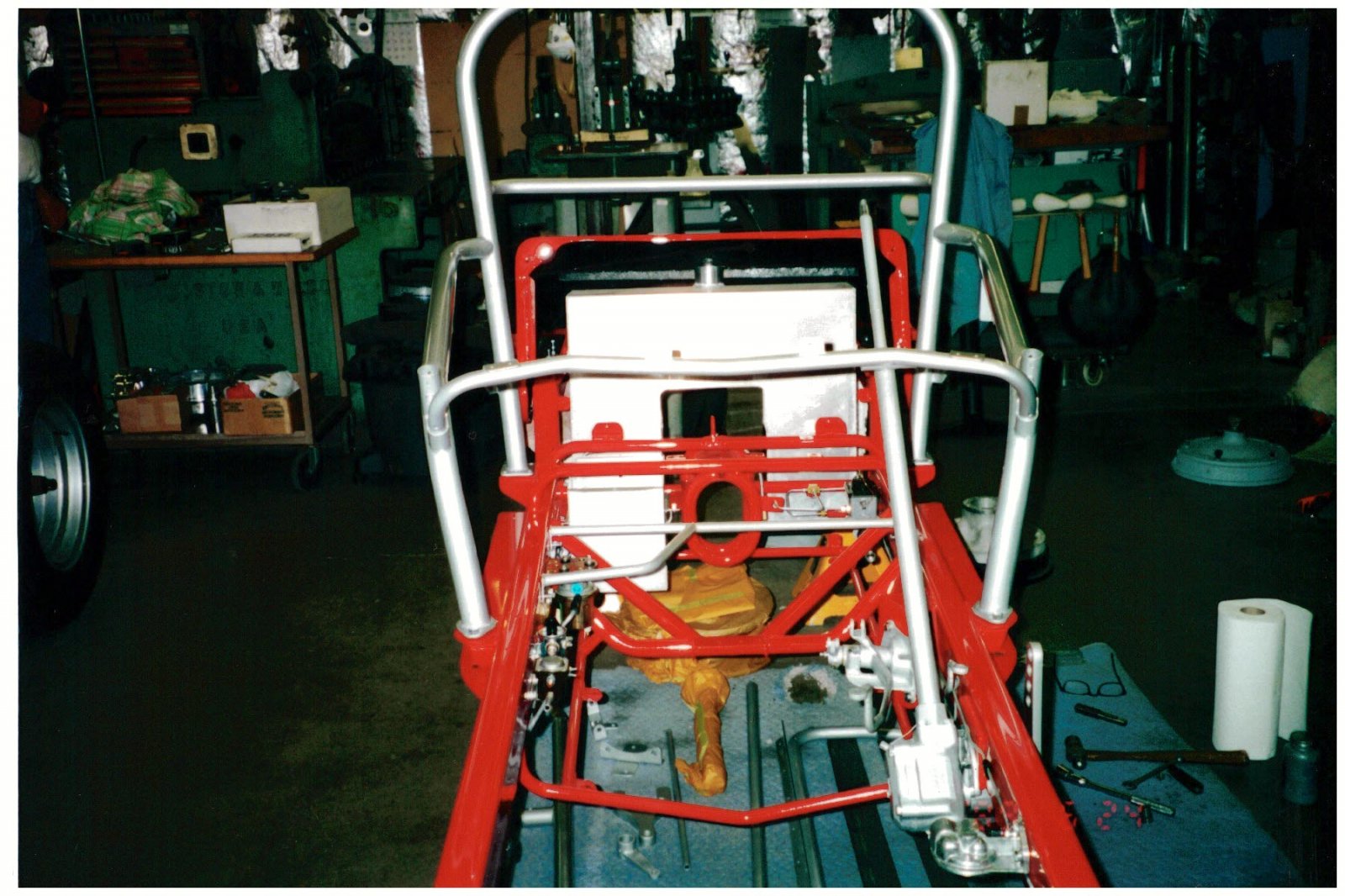

    Dave, If you aren't going have a tunnel over the trans, then you will need a double firewall to seal it up. This shot shows the inner one, .050, aluminum sandwiched between the block and bellhousing, that is free to jiggle with the engine movements. There is a soft rubber gasket between the inner and outer, to provide the seal. STRODE 1 (2).JPG
    Atwater Mike, brEad and ratrodrodder like this.

    That is a neat solution. I was thinking of using the idea I had from earlier, an engine plate but wasn't quite sure how to make a good seal. That's the answer. Marty this long distance teaching is certainly working for me. Thanks for the inputs.
    So back to the garage and get dirty and make some chips...

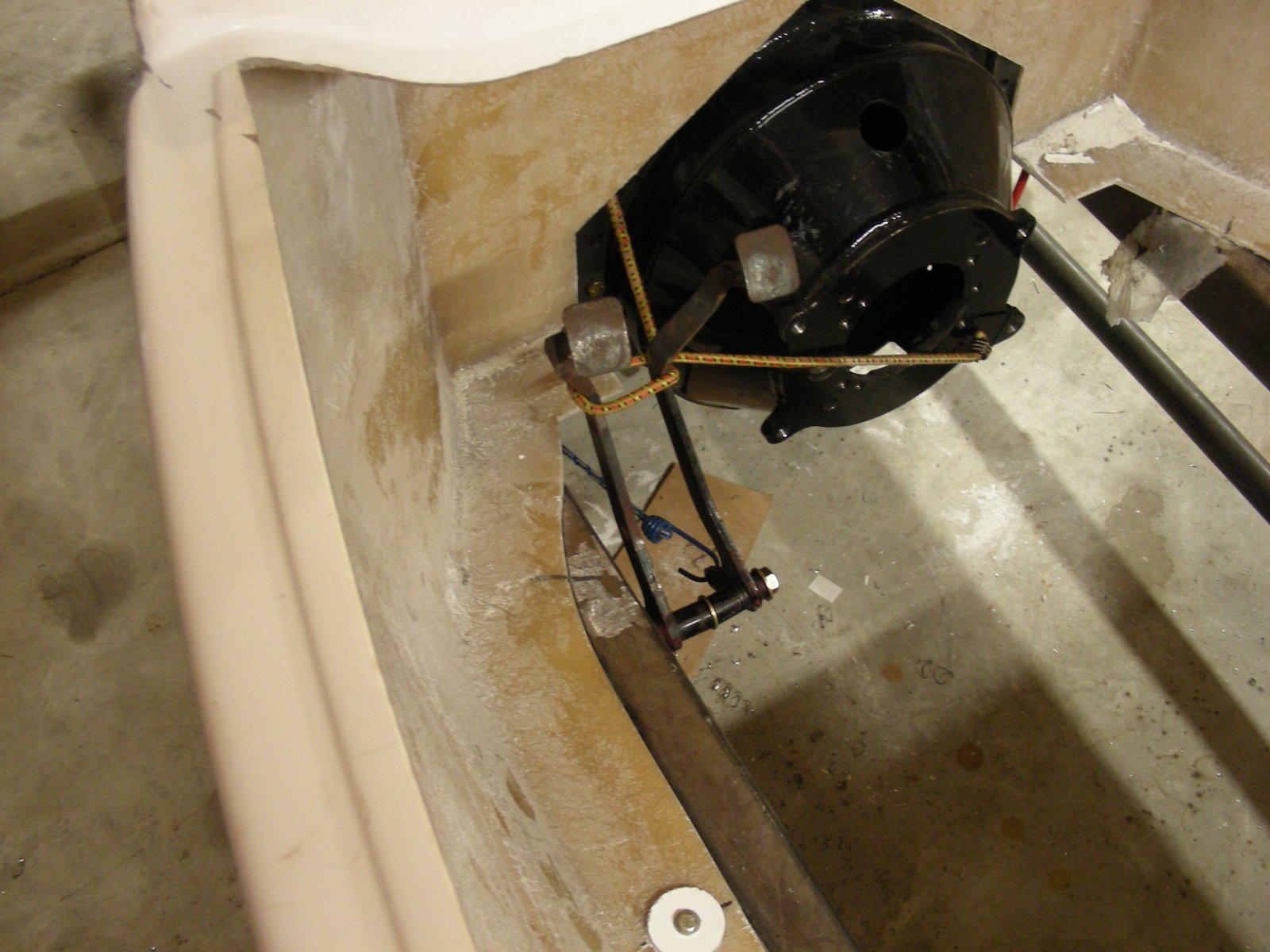

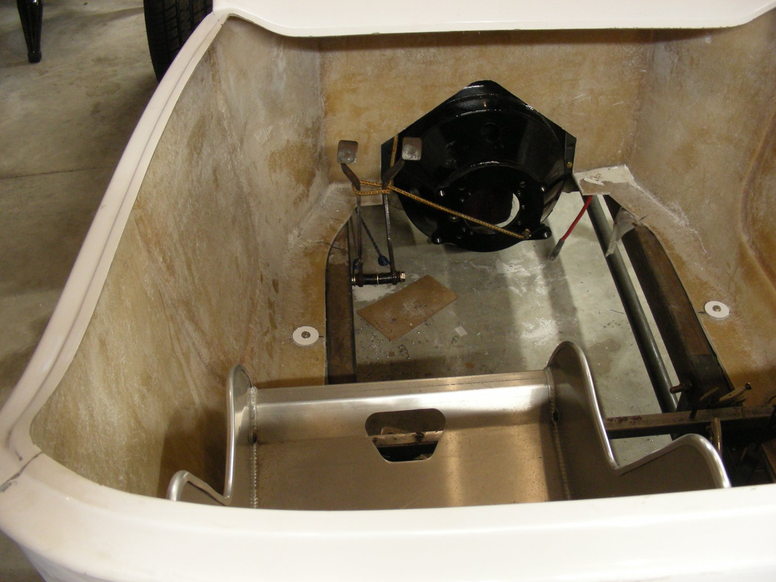

    Seat mounts today, and pedals. DSCN1243.JPG Here's the seat mount. Well it's started. Lots of welding and I'm thinking that I should put a sheet of eighth inch steel plate on it to protect the family jewels just in case...

    If I'm seeing correctly, MartyStrode has a pair of driveshaft loops incorporated in that pictured frame. Instead of just a piece of .120 steel on the bottom of your seat, why not incorporate something similar to contain your driveshaft "just-in-case"? I've always preferred "containment" at each end of an exposed driveshaft to keep it from becoming a "flail" if a "U-Joint" fails!!!

    That's in the works. But first I have to get the T5 and finish up on the engine mounts. It's looking like the nose of the engine needs to be raised a little bit and I think that when I do that the transmission will be a bit lower. You may also notice that there's not any diagonal bracing yet. I'm holding off on that until I get the important stuff located. I sort of learned that the hard way with the 1st and 2nd dirt cars way back when. And also to only tack stuff in and make sure everything fits before final welding. If you remember at the beginning of this diatribe I kept saying that I knew better. Well it's not true. And I'm still making mista...er that is design changes as I go along.

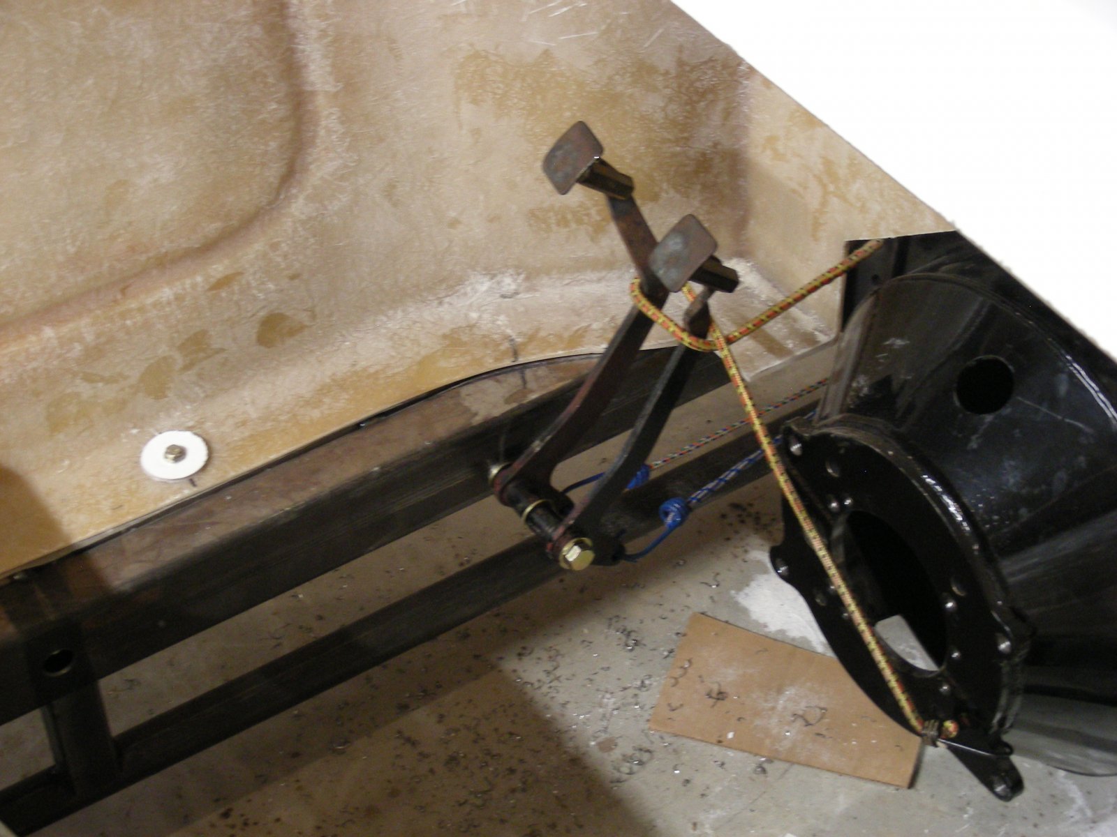

    DSCN1246.JPG Here's a picture of the pedals in the car. They are upside down and reversed, i.e. the clutch is now the brake and vice versa. A little heating and bending, change the pedal pad mounts (again, long story when used in the Mini and I sat in the back seat...), and mount the master cylinders to the rear of the pedals and viola, I might have working pedals. At least I can get my feet on them and they feel okay. Note the bungee cords used to get some tension on the pedals. The inner end of the pivot bolt needs support, and that will get done when mc mounts and xmembers are in.

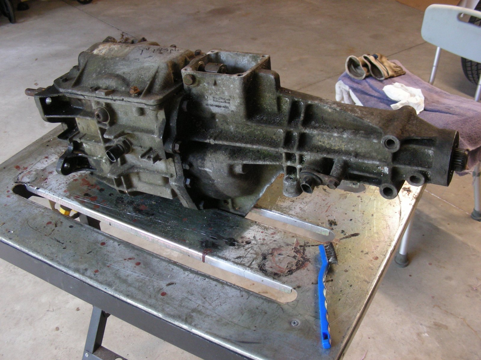

    Progress, sort of. I picked up the T5 transmission from my brother in law's garage today. It's a 4 cylinder transmission and has the electronic speedometer sender. At least it has the short shifter location. I'll have to check it out and determine exactly what it is inside. Grimy on the outside, but looks clean on the inside.

    As previously reported I picked up the T5 transmission yesterday. Unbolted the 4 banger bellhousing with the use of fire and force and lanolin penetrating oil. NAPA guys swear by it, I swear at it, due to the smell. Wet sheep! But it works. It appears that the 2 parts were never unbolted since GM mated them years ago. It even still had the id tag:
    Yeah not much help. Things rust up here in the northeast. And those casting numbers, the ****** identifier in that super t5 thread just said don't use casting numbers! So not sure what year it is. It has the electronic speedometer sender and is 4.something to 1 first gear. Spun and crudely counted.
    DSCN1250.JPG Grungy outside, fluid looks clean. I'll open it up later...

    Okay so I'm still trying to figure out what the transmission is. Looking at the t5 thread, it shows the wc t5 as having a better front counter shaft bearing, that apparently is a tapered roller bearing. The Timken number is LM 67010-BCE. This is the bearing in this t5. DSCN1252.JPG Like I said, things rust up here in the northeast...
    So last trip to the garage, I spun it carefully in 1st gear, and it's definitely 4.1:1. With the 1 inch 14 spline input shaft, WC t5. So not perfect but it was free! And I like free!
    I mentioned a few posts back that I put in a set of unmolested Mini pedals. Here's a picture of the pedals in place:
    DSCN1248.JPG There's plenty of room after all! See that big rod end? When I cut the floor to clear the pedals, I'll have room to get the steering shaft in. That rod end will be mounted to the frame rail just below the firewall and I'll put a u-joint on it and a short section of 3/4 shaft up to the Vega steering box, another u-joint and the steering is working.

    Will there be some sort of rubber or other gasket-type material to help keep "stuff" (fumes, some moisture, etc.) from coming up around the pedal arms? I imagine even with a belly pan there may be some undesirables that try to work their way up into the driver compartment (it can't be a p***enger compartment if you don't add a second seat!). Or just a slot in the floorboards and to hell with whatever comes through?

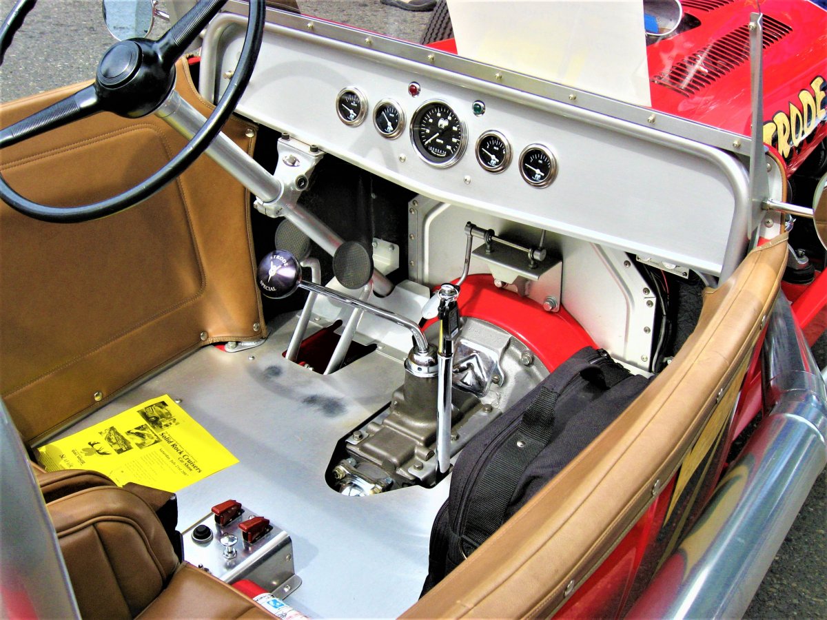

    Marty, it looks like the main roll bar hoop and the cowl support hoop uprights lean out at the top in the picture. Is that correct or is it an illusion of the angle of the picture? I'm trying to figure out what I have to do to get similar tubing structure to my frame rails. I know your frame has a taper. Mine is the same width front to back, established when I was thinking center steer using my Schroeder champ steering box, and not knowing where it was going to be on the frame.

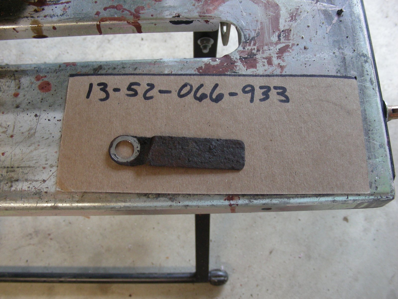

    Found the "calendar " mark on the transmission after scrubbing off some of the grunge. It has 93 inside the circle and 2 of those spaces have dots. So it matches with gimpyshotrods best estimate of the year 1993, and appears to have been manufactured in February of that year.
