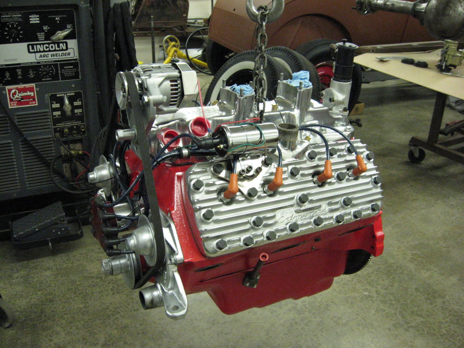

    Dave, I have been running 35 amp Denso's on my cars for 23 years, and never needed more. The wiring is simple with no accessories. IMG_0605.JPG

    And that engine looks soooo good, Marty. I'm going to use the 75 amp version (that's the actual rating, 100 is max), just in case I add something down the road, like electronic fuel injection. The engine builder and I have discussed making my old Hilborns electronic down the road. I have an idea or two on how to hide the injectors so the manifold won't have to get modified.
    But first carbureted. However I can get a 59 ab block. Maybe I should consider it. Again after the 327...

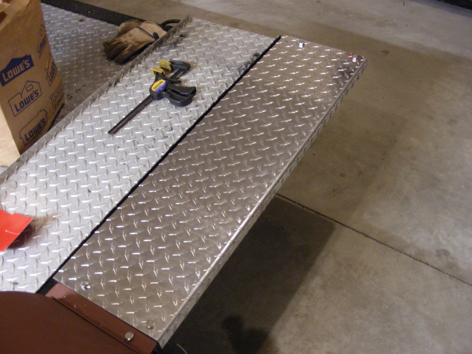

    First things first. Closing in on finishing up rebuilding my trailer. Got the new deck plates fitted and 2 bolted down. Made a couple of pointy bolts to transfer the bolt locations from the frame to the plates.
  25. Dave G in Gansevoort
    Joined: Mar 28, 2019
    Posts: 4,276
    from Upstate NY
    I hate it when I do that! Hit the post instead of the upload ****on. DSCN1277.JPG Took about 30 minutes total on the lathe and bandsaw to make these. I know, planning ahead I could have bought transfer screws, but that takes time, money and planning. These work just fine.
    DSCN1275.JPG DSCN1274.JPG Those 2 pictures show the left side new plates bolted down.

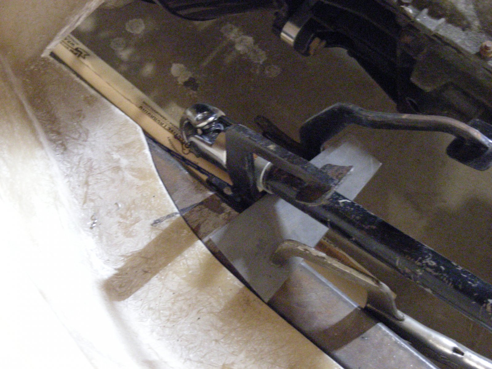

    Got the new u-joints and trial fitted them on the Whatever project. DSCN1280.JPG DSCN1279.JPG Need to shorten the shaft a bit and connect the column to it. Then build a support hoop for under the cowl. I've got to draw it full size tomorrow and bend the tubing. Still small steps, but getting something done at least...
