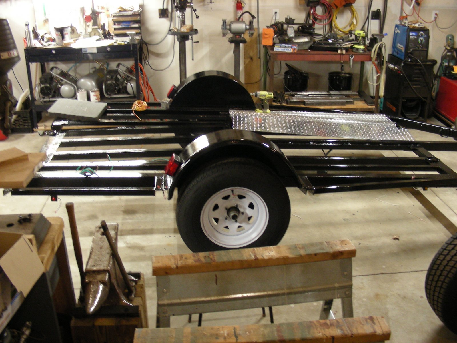

    Trailer update: painting is done! Wiring is half done! Decking is polished and ready to bolt down. I think I'll be able to get it finished tomorrow, god willing and the creek don't rise!
    Just a few needed things, some sealant, a couple of special bolts, and some self sealing tape. It's looking okay and it's just a 26 year old trailer... DSCN1286.JPG DSCN1285.JPG DSCN1284.JPG Tuesday, the Whatever project!

    Trailer is done! DSCN1289.JPG DSCN1287.JPG It's outside waiting for snow now. And a new plate! But it's out of the garage! Another project in the way of progress on the Whatever project done. Now back to work on the Whatever project.

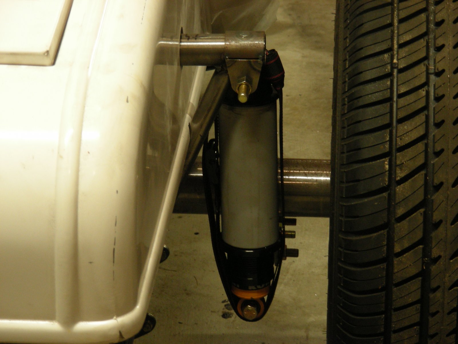

    Nothing big, just little stuff. Putting Konis on the back of the Whatever project, moving the current rears to the front as dicussed above. So making another pair of coil spring subs***ute spacers to set ride height. Measured up front to see if I can make the panhard bar the same length as the drag link. Probably not but it's going to be close.
    Also remembered that I was going to order the clutch disc and pressure plate for the T5. Forgot about it until tonight. Be calling tomorrow. Been absent minded since I was a kid, why change now?
    BTW plastic electrical conduit works great for making coil spring subs***ute spacers. Depending on the schedule it may need to be opened up a little bit to fit the spring seats on the coilovers, but it's more than strong enough.

    Got those 2 coilover spacers made today. Did the machining if you can call it that, using my old Delta Double Duty lathe. What a cluge! But it worked and I still have my fingers and eyes!

    Okay back to the Whatever project report. So after making 2 new coilover spacers I swapped out the rears and moved them to the front, taking the buggy spring and its big ugly mount out. Since the actual shocks front and rear are the same except for the coilover kits, it was an easy swap. However I had not welded the upper shock mounts to the frame. So I was able to set the front ride height with blocks and will weld the uppers tomorrow.
    I had preset the rear shocks to the correct length so the rear ride height was set when I set it back down. Tomorrow I'll be making a panhard bar and mounts for the front and a couple of spacers for the bottom of the front shocks. Then back to moving the radius rod/hairpin mounts lower in the frame front and rear to get better geometry in the suspension. I'm thinking that I will have that all done this week.

    DSCN1292.JPG That's it between the axle and bottom of the coilover. I know, really exciting isn't it? And here's the Konis on the back DSCN1294.JPG DSCN1293.JPG Not bad after turkey and all the fixings followed by pumpkin pie. And before you ask, I cooked it all. I actually like to cook, I found it was a good way to relax for a few minutes after cl*** when I was in college. I've gotten pretty good at it over the last 40 odd years.

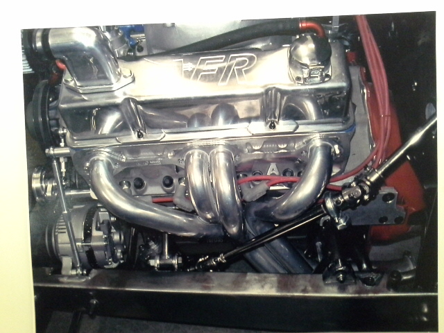

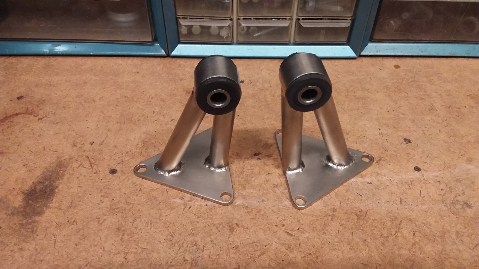

    If I remember right you have a tubing bender, thought I'd show what I did for my roadsters' steering shaft/rod end mount, you see them welded directly to the frame many times but I liked having the option of unbolting it.
    In hiding.

    I hadn't thought of doing it like that. I like it! And since I am the prophet of plaigerizm, if you don't mind, I'm going to rethink the way I was going.
    Thanks, I'll post pictures of whatever (that's bad...) I come up with.
    And did you make those engine mounts as well? I'm thinking about a similar design. Mine right now look bulky and ugly.

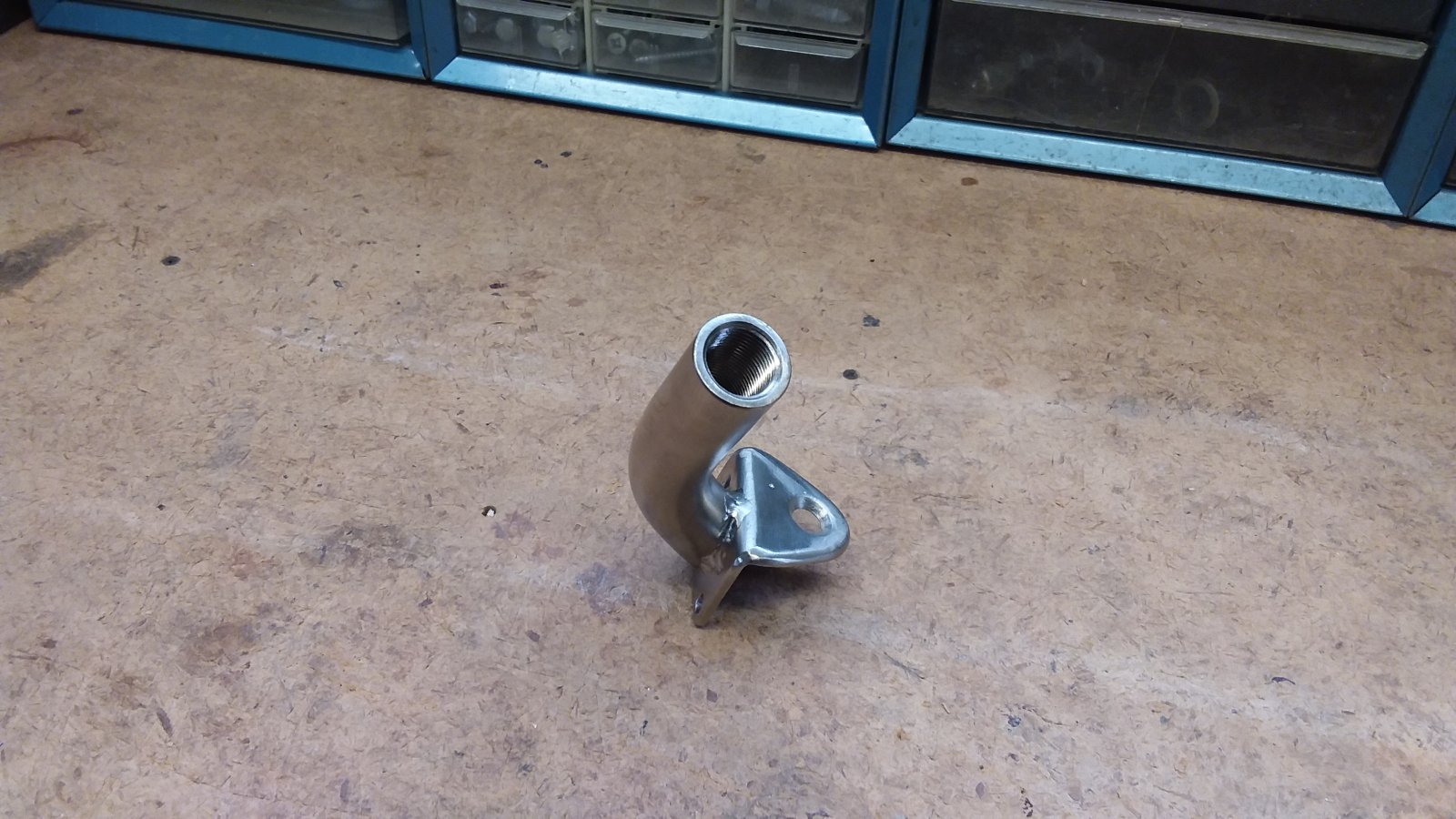

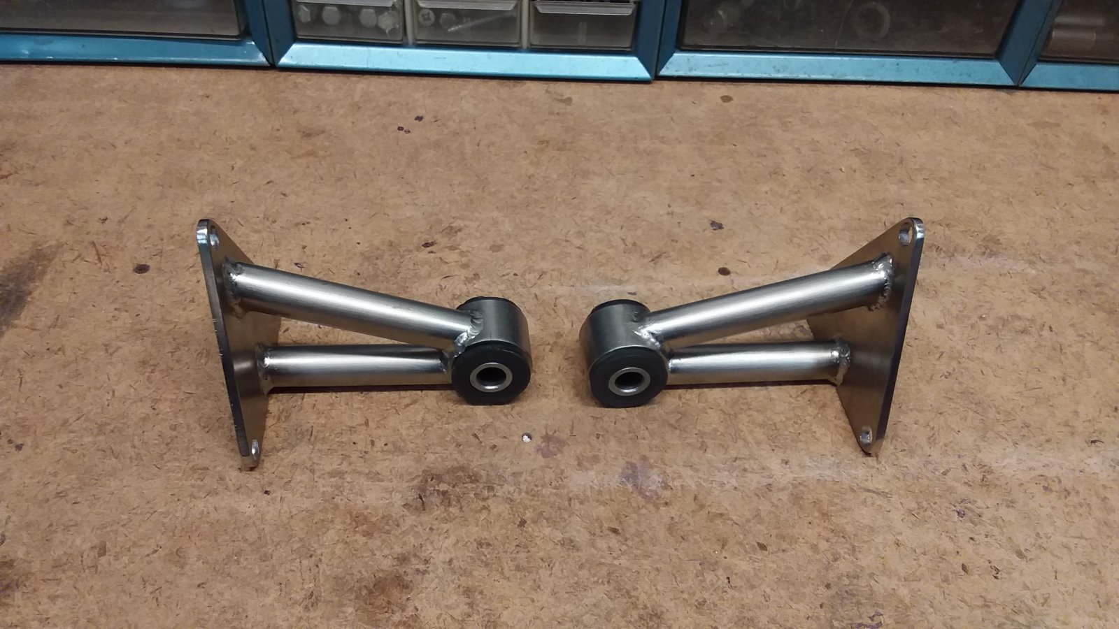

    I did the tube fitting, prep, etc, a friend did the TIG welding.

    Yup, I'm copying them! I'll probably make 3, 1 to practice welding and 2 for good. And a fixture to hold it in alignment for welding.
