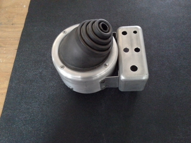

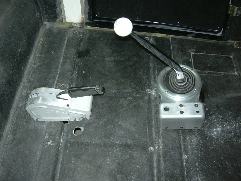

    Did you see the shifter surround/boot mount for my roadster?
    Started out as an aluminum cook pan from Goodwill and the switch box was found at an electronics junk store. Also, that e-brake surround is a B&M auto trans shifter cover.
    That was a frivolous (read that expensive) what-if purchase just to see if I could pull it off.

    Yes that's what I'm talking about! That is clever re-use! See, and they say gearheads aren't environmentally friendly. Reuse reduce recycle they say, well hot rodders qualify as early environmentalists then!

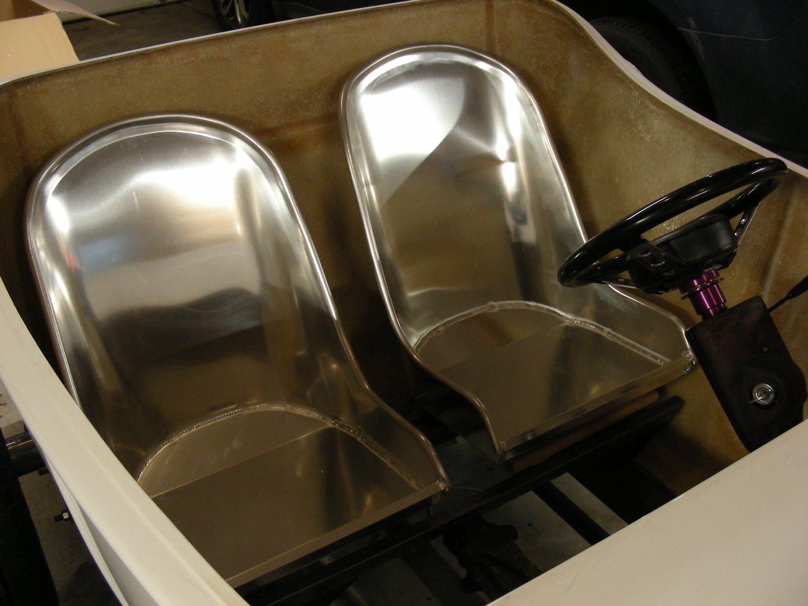

    Good news today. Got the new Speedway bomber seats. I won't bore everyone with pictures of seats. They look just like in the catalog. And the most important thing? My deriere fits!
    So tomorrow andFriday, fit the seats and finally finish the pedals and steering. It's supposed to be approaching 60 for the next couple of days, so it won't take too much to get the cold soak out of the garage.

    I did it!I got out in the garage today! Realised that I'm going to have to get the door kit from Speedway for the body. Stepping over the side to climb in and out of the Whatever is a real killer for my back...
    First thing I did was try the new seats, Speedway bomber seats. The former seat was a Kirkey Vintage seat, before the lightening holes. 2 of them would be a bit much width wise for the body. The bomber seats fit with plenty of room. I'm going to have to raise the new seats up about 3 inches, not a big problem. A 3 inch riser between the mounting pads and the framework previously made should do just fine.

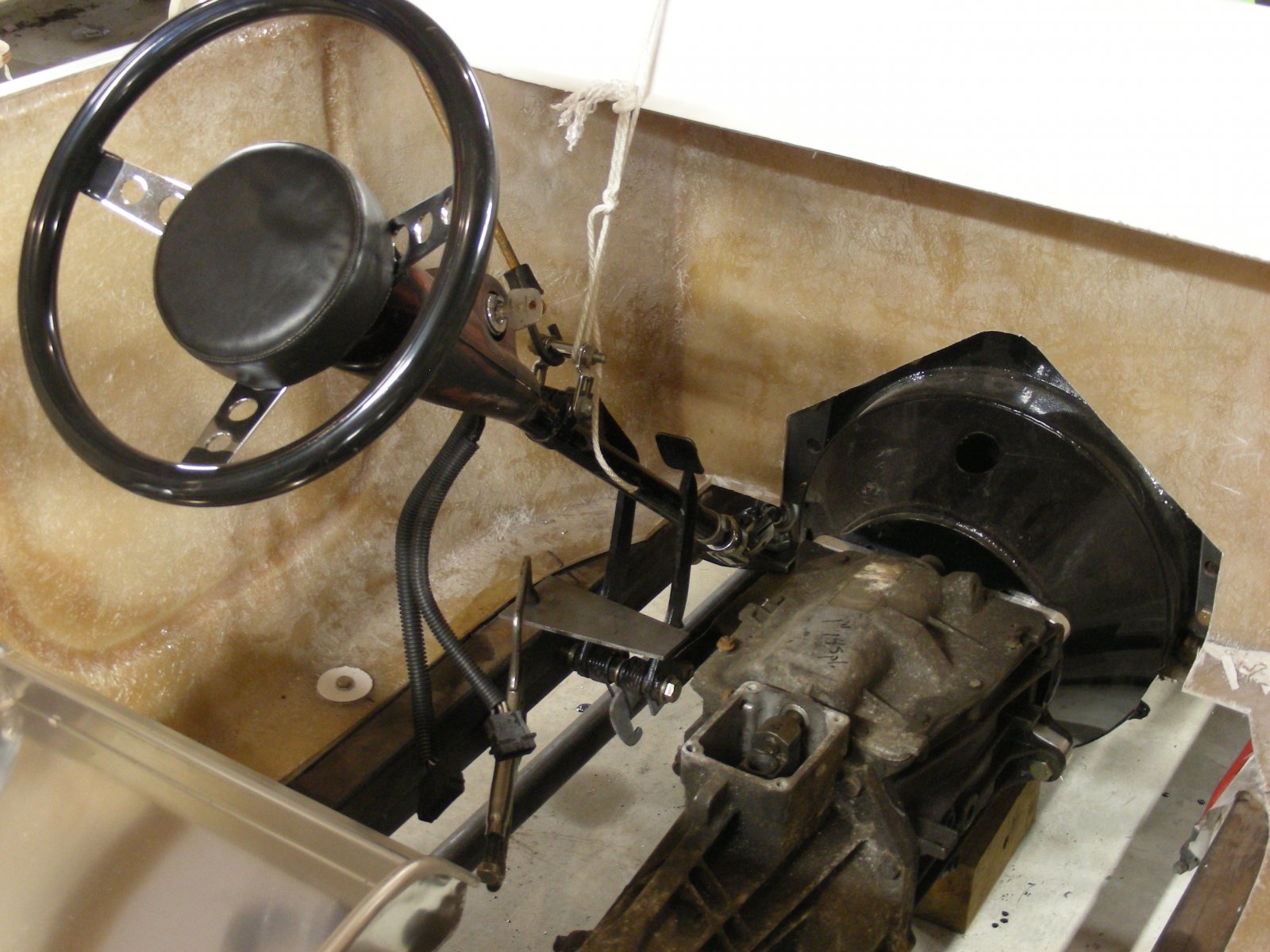

    Now with that established, I was able to determine the position of the steering column. Made a quick bracket to mount a support bearing for the intermediate shaft, and cut the shaft to length. File a notch in the ends to clear the tightening screw on the u-joints, and viola, the steering is established. Not fully mounted, but it gave me an idea of the next step. DSCN1304.JPG DSCN1304.JPG OOPS! Something is giving me issues today posting. Only wanted 1 picture, got 2. I'm going to reboot and see if it helps... back soon.

    Where was I? Oh yeah, talking about the steering. So now that the bottom of the steering column is located, the next thing is to make a support structure to attach the upper column to. I was going to plaigerise Marty's setup in his #10 roadster, however the side bars get in the way of the door on the p***enger's side. So instead, I remembered that he had done a double hoop arrangement on the Fiat (I think it was a Fiat...) roadster he restored. I'll copy that idea using 1 inch od 1/8 inch wall dom.
