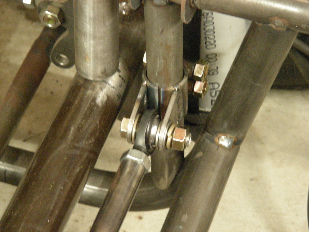

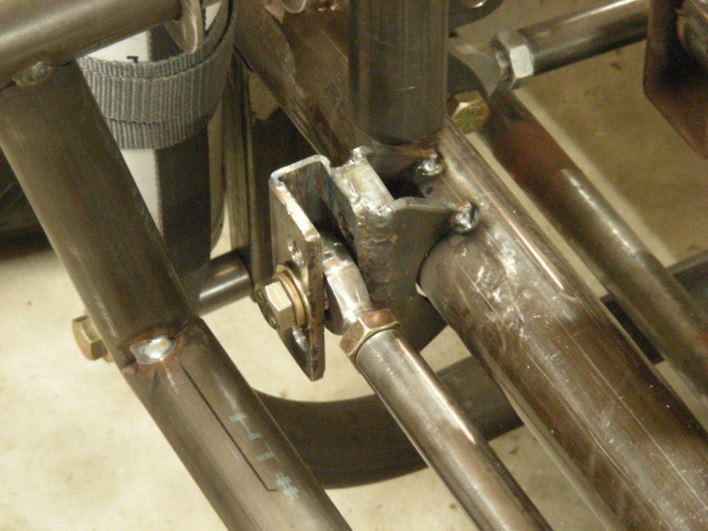

    Today was a good day. Got 2 new crossmembers made andtacked in, and that big ugly old front crossmember out. DSCN1314.JPG The front crossmember is located so that I can attach the front underside of the nose to it. DSCN1318.JPG Well if I was any good at taking pictures this would show the nose and crossmember colocated perfectly for making a solid support for the front of the nose. Maybe tomorrow for another attempt to get a good picture. What it does show is the new rear mounts for the nose, and how much room I've gained for a radiator.
    The upper crossmember is probably temporary, as it's awfully close to the engine and where I'd like to get a fan in there. Space, the final frontier!
    Now with that stuff located I was able to design and start on the front panhard bar mounts, both axle end and frame end. I could use 1/2x1/2 rod ends, but what I have is 5/8x1/2 due to the size of the tubing I've been using for radious rods, tie rod, drag link, hairpins...
    Being cheap, and just having spent a bit of cash! for new tubing for superstructure stuff, and that I have a bunch of the other tubing left over (I tend to buy lots more of stuff than I really need...), that's what I'm going with. It will be practically bulletproof!
    So for the short term for setup, I'm going to tack the axle end bracket to a 2 inch muffler clamp, and use that for setup porposes. It's not fishy, and it gives me the ability to align everything prior to finalizing the panhard bar height and path. FYI, porposes are mammals, not fish...
    I know its been a long day and I'm getting silly! SWMBO also wants supper, and that's next.

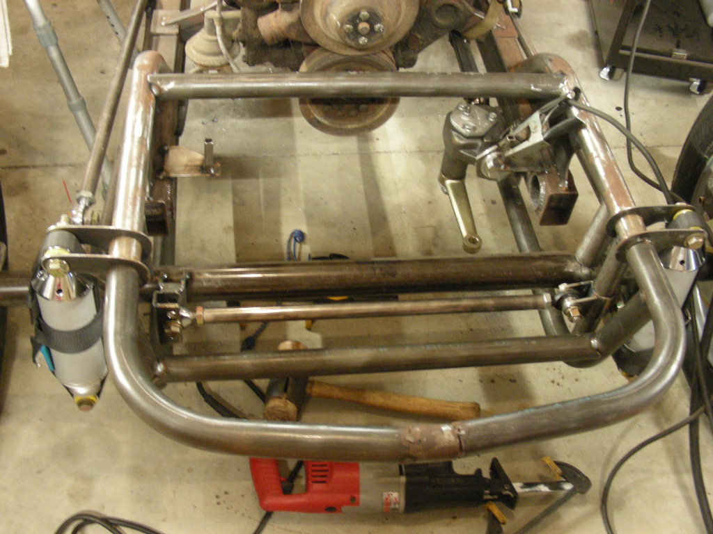

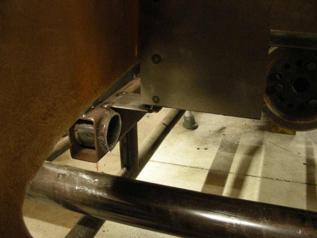

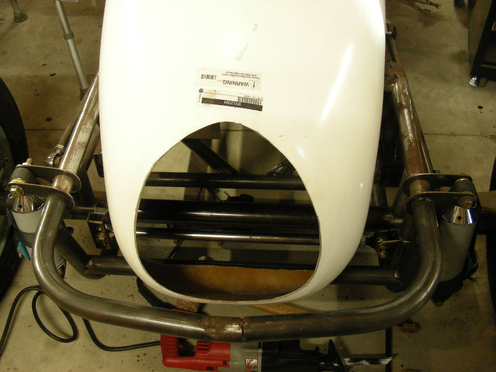

    Got a little bit done today. Made a crossmember up front and started on the support bracket for the nose.
    DSCN1325.JPG DSCN1324.JPG I know, terrible pictures, can't really see the x-member down in there. When I finish the nose bracketry I'll pull the nose and get better pictures. At least I got something done!

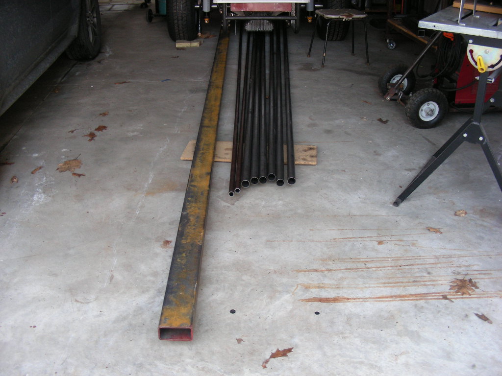

    Philosophical question: Does taking delivery of an order of steel cons***ute getting something done in the garage? I say yes. Anybody want to weigh in?
    Funny story tho: I had just rounded the corner of the grocery store from produce by the delicounter, when my cell rang. It was the steel supply asking if today was a good day for delivery. In 20 minutes! And I'm just starting, and its 10 to 15 minutes back to the house depending on who I get stuck behind on the road. Of course I said okay, I'll see the driver in a few.
    Get the basics we needed, cashed out, and beat feet home. The driver was just finishing getting the steel unstrapped and cutting the banding iron off the 6 sections of 1.5 inch dom tube.
    We unload the steel, sliding it under the Whatever as I didn't get an area set up to store it yet. Wait, what was that 6 sections? I only paid for 5! Looked at the receipt the driver hadme sign, and they hadchanged the 5 to a 6. This company isn't really a steel supply, in the sense that they supply others with metal. Rather they do it on these small orders as a good neighbor policy deal.
    So they had ordered in the dom tube for me, and evidently got 6 sections delivered, all banded together. Instead of putting 1 section on the rack that they would never use, they just adjusted the order quan***y, and sent it out!
    Now this is a $200 chunk of steel, and I know there is a bit of markup and delivery fee was $50, but just the same, they ate a bit of profit. That is how customer service should always work! Will I buy from/thru them again? In a heartbeat! Probably within the next week, as they also have a short rack, open to picking thru, and I could use some oddball chunks of steel for various projects.
    DSCN1338.JPG And that random length of 2x4x.125. It is 26 feet long! I only need 16 feet for its intended project, so now to decide what I can use 10 feet for...

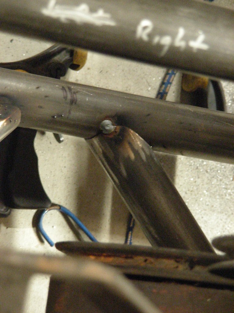

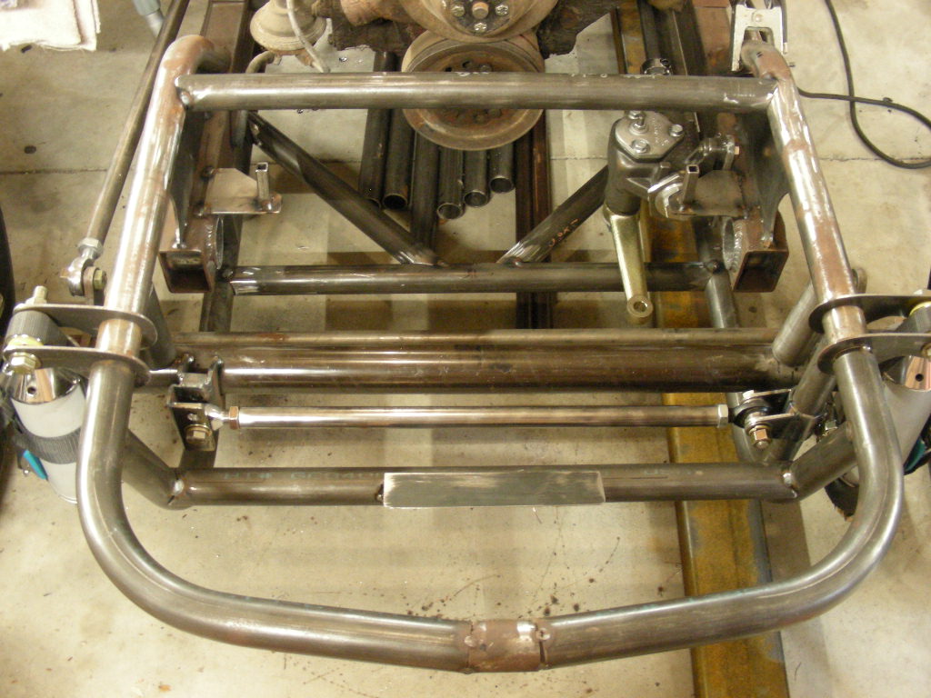

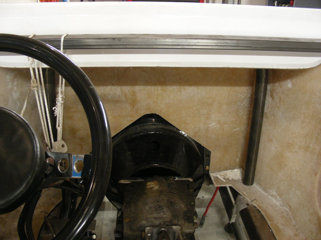

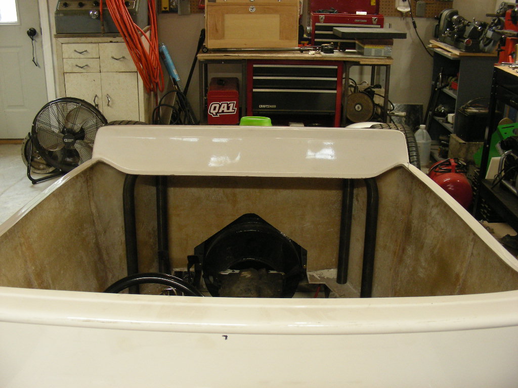

    Finally got back in the garage today. Fitted mostly the 2 hoops under the cowl. There's a lot more to do to get it done and bolted down but the hard part is done.
    DSCN1343.JPG DSCN1342.JPG The first shows both in place kind of... The next one shows the front hoop by itself. I have to narrow it a half inch give or take. Then remove some of the body's floor flange to get the feet down on the frame rails.
    DSCN1341.JPG DSCN1341.JPG The last picture is an overall view showing the stuff done last time when I was too lazy to get the nose out of the way. I did tack the nose front support to the first straight crossmember today, no big deal. Now we have a clear view of the k member, and how much room I have for a radiator with the old big front crossmember out of the way. Yes I will clean up the front of the rails. I'm going to splice in 2 new short sections of the box tubing to get rid of the holes.
