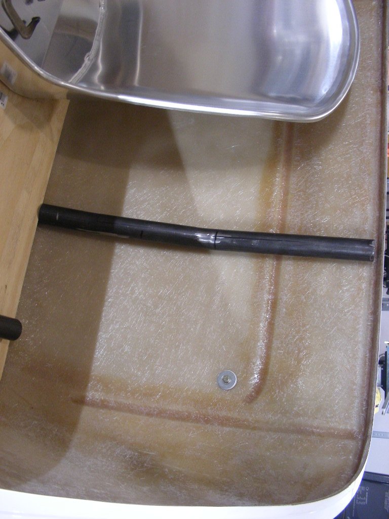

    Today I worked on the under cowl support hoops, fitting them in, and cutting some of the floor away to get them to the frame rails. But then I was looking at the rear of the tub, and decided that I don't like the seat mount now. And I need to make a hoop behind the driver. And get it to the frame rails and...
    So I'm in a quandary. Stuck in my head, I just don't see it yet. I've perused Marty Strode's projects, and the other T-bucket builds, hoping to find a design that I can plaigerize. But to no avail!
    DSCN1311.JPG Here's the problem area. I'm stuck and need help! Any and all suggestions are welcome. PLEASE!

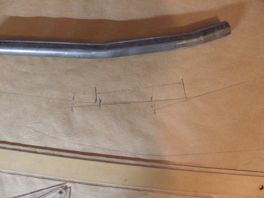

    Thanks to Marty, I was able to lay out the rollbar for the Whatever project this afternoon. Spent all afternoon drawing stuff out full size and reverse engineer his sketch to get the angle of the bend (94°) for the legs, go and look at his other posts, and in the same time, he's finishing up another project! I'm going to take up ****erfly collecting, I'm just so slow at this stuff!
    But at least I now know how much tubing to cut, and where to start the bends! Oh well it's a tiny bit of progress...

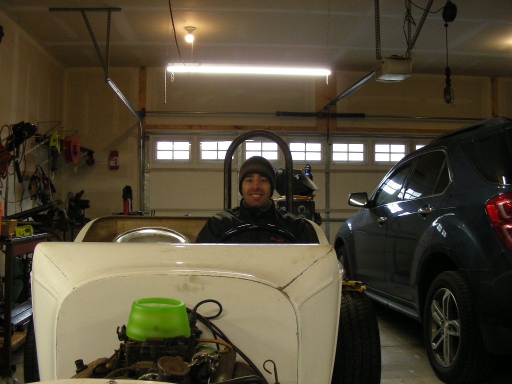

    When we got back from the swap meet, Alex, the nephew's real name, and I took some time to mock up one of the rollbar ideas for the Whatever project, and were able to get some pictures to determine the height of the bar.
  24. Dave G in Gansevoort
    Joined: Mar 28, 2019
    Posts: 4,276
    from Upstate NY
    Darn it! Fat fingers...

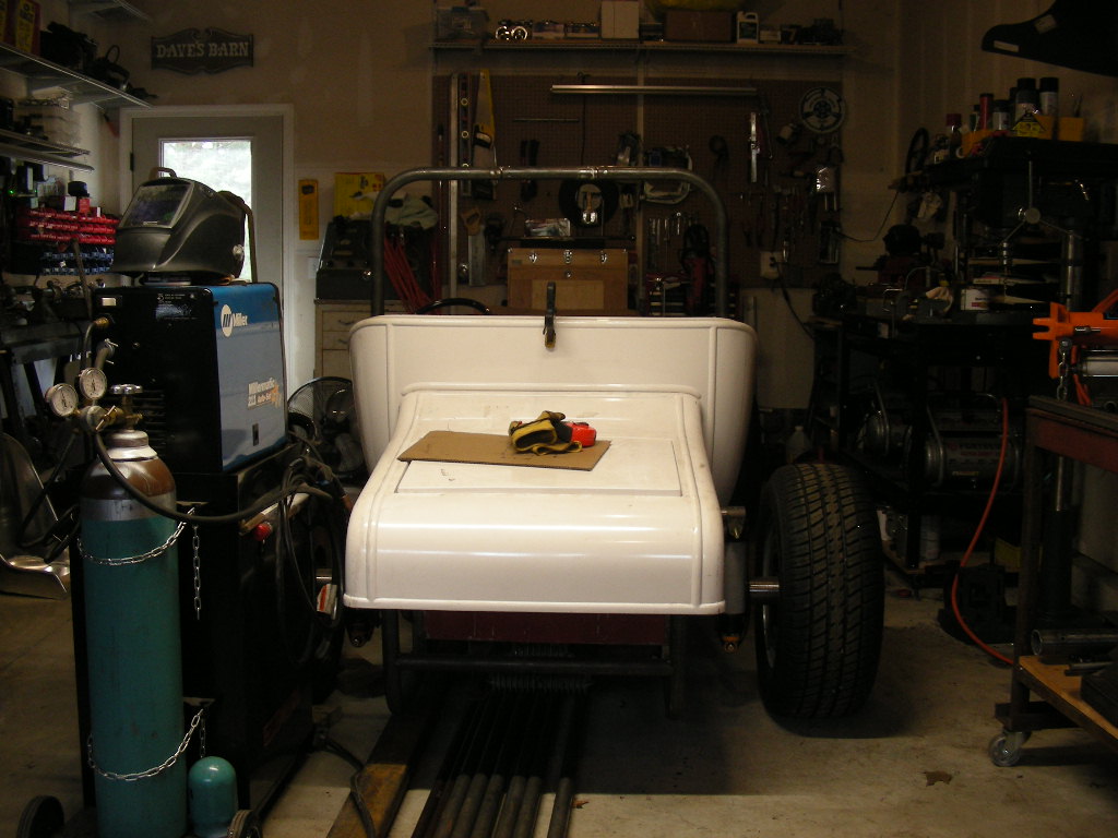

    So here's a head on picture taken at my eye level:
    DSCN1350.JPG Not high enough! Sorry for the shocking view... I ain't going to look any better! So I climbed out and we added spacer to get it higher.

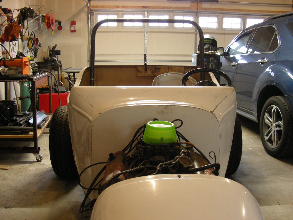

    DSCN1351.JPG A little bit high, but now we have a good reference height. Alex measured from the top of that shiny thing in the center of the picture to to a horizontal line off the top of the bar. He also got a side ish picture. It just demonstrates that I'm building the automotive definition of a blivet!

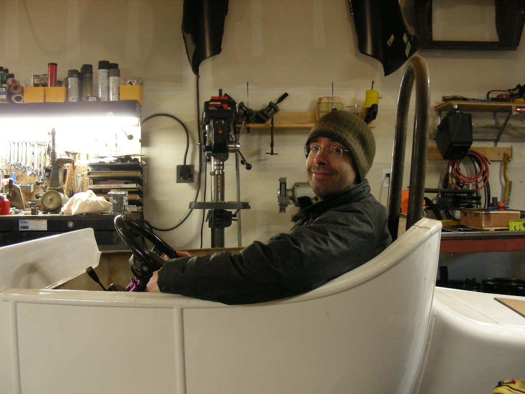

    DSCN1353.JPG No I'm not tiny! Alex, who is about the same size as his father, my big brother (why is an older brother called the big brother?), got into the Whatever and I took a couple of pictures to see how a more normal sized human being fits in it.
    DSCN1355.JPG DSCN1354.JPG So next is to finish the mock up for the Strode design roll bar and determine if I can make it work with me in this thing. I have a reference height to work from. I'll get to that tomorrow and post a picture or two of the car with it and get opinions of which is better liked.
    brEad and ratrodrodder like this.

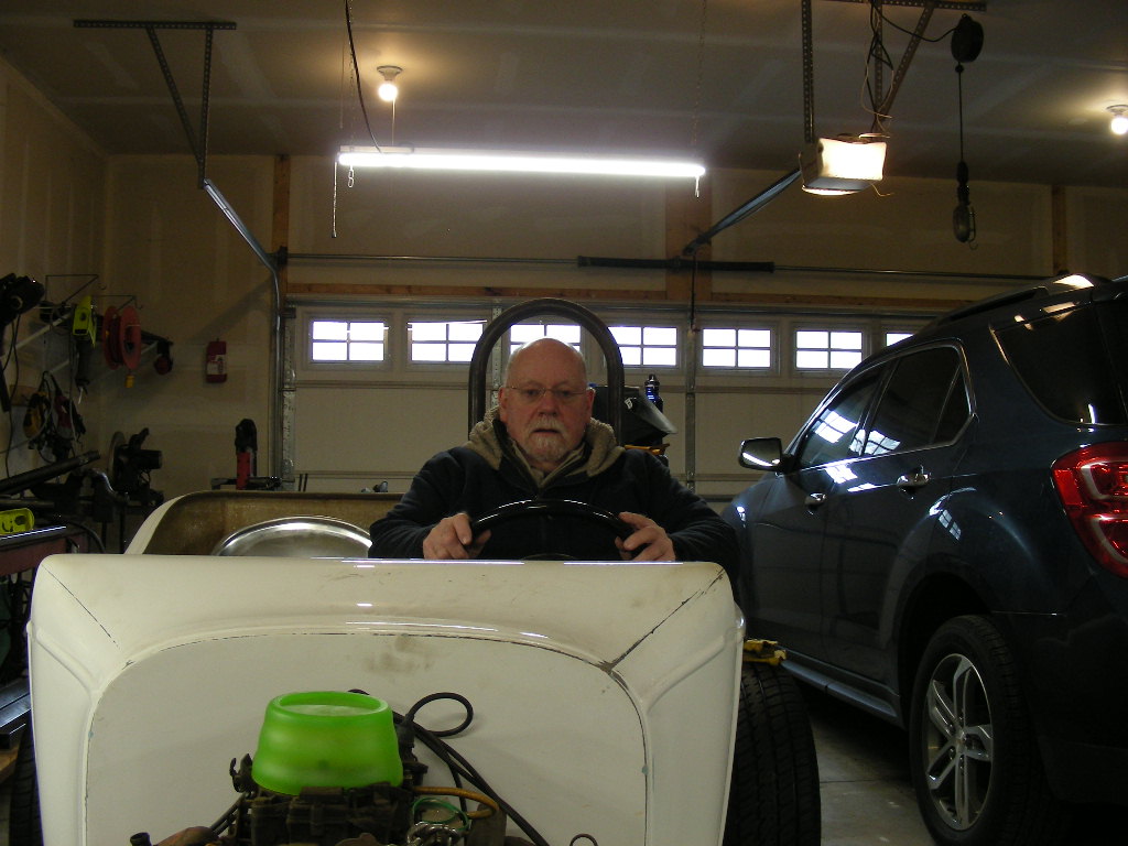

    Okay, so I got 3 pictures of the mocked up roll bar ala Marty Strode (mostly...). Mine is above my head by 3 or so inches, just in case I decide to autoX it in SCCA events.
    DSCN1364.JPG DSCN1363.JPG DSCN1362.JPG Compare and Contrast: which style does everyone like? I can get to the frame really easily with the single seat hoop, and brace it to the rear or forward like the 1st Cobras did. And then it's easy to just brace the under cowl hoop to support the steering column. BUT, how to tie a shoulder belt for the p***enger's seat.
    If I go with Marty's design, seat belts are easy, getting to the frame is not much different, AND with the side bracing like he does, the steering column can be supported without that hoop under the cowl, saving a bit of hoof room, not a small consideration considering 8-E width feet! My parents left me standing in the cow pasture too long as a child...
    So give me opinions, and if you can make circles and lines on the photos like in Alice's Restaurant. I'll tell a real story about that song and my home town some day...
    brEad likes this.
