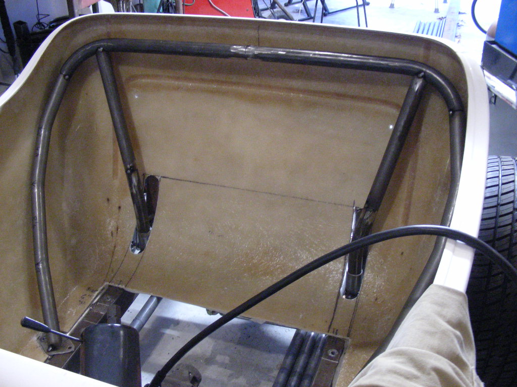

    Spent the afternoon with chunks of bent tubing. Finally found a path to the frame rails to support the structure for the roll bar I'm going to use. I should have copied Marty a lot more. My frame rails run parallel from front to back. Marty tapers his. Getting it wider at the back appears to make his efforts easier than the way I went. I guess that's the difference between a hack (me) and a real pro (Marty).
    Oh well, live and learn. But I can get there now. And I should be able to make a working p***enger door! SWMBO will be able to ride in it after all!
    So while sussing the whole structure out and making a mock up for the structure using previously bent sections of tubing I have a piece to copy. 4 bends and I still have to figure out what order to make the bends. Boy do I wish I lived within a half days drive to him!

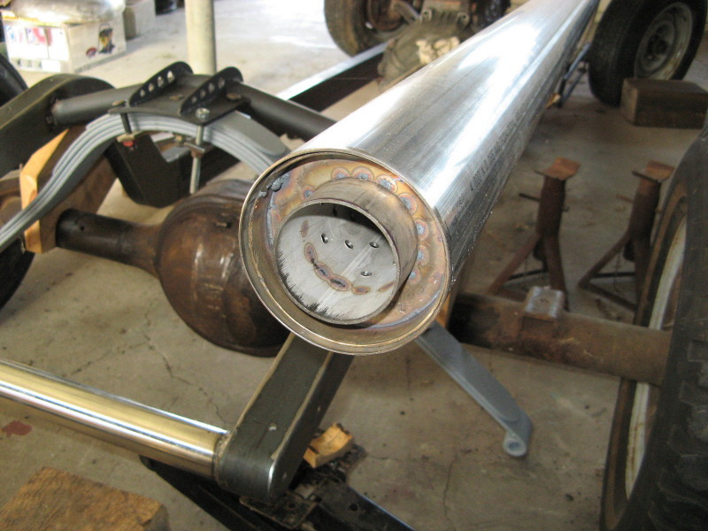

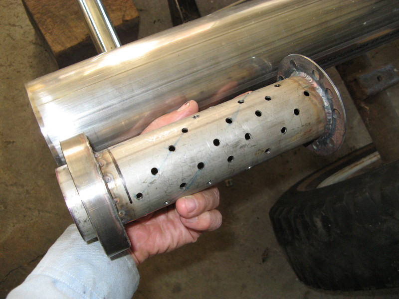

    On my champ car replica I made inserts for the rear which are tuneable by adding more holes.
    brEad likes this.

    Good idea! It looks like stainless steel. It'll save some poor, helpless gl***packs...
    Thanks for the pictures

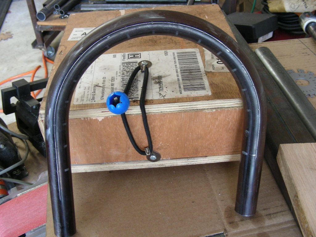

    Well, it's been an interesting learning experience the last couple of days. If I do overbend a tube a little bit, thanks to the many suggestions, I'm equipped to handle it.
    So I thought I had overbent one end of a short 3 bend tube, when in fact I had gotten turned around in my head, and bent the end 2 angles the opposite of what they were supposed to be. As it turned out, that bar fit better, so I made a new one, being extremely careful to get the bends the same this time.
    Now these tubes have all 3 bends in a single plane. I don't know where I saw this, so if someone recognizes this process and it's yours, take a bow, as it works.
    I laid a line out on the tube along the axis, end to end, then laid out the start of the bends, CAREFULLY this time. I have marked my die where the bend starts, and I put the bend start mark at this point in the die. I then make sure the axial layout line is touching the top of the die. This way each successive bend ends up in the same plane, without having to try to set angles using any form of level. It also works for out of plane bends, if you know the angle of rotation. It requires a little math, but isn't hard to do.
    Let's say two bends need to be rotated 15 degrees relative to each other. 15 degrees out of 360 is 4.16th of the cir***ference. And a 1.5 inch diameter tube's cir***ference is 4.71 inches, so 4.16th of that is 0.196 inches along the cir***ference. Or practically 0.2 inches. I have some very flexible steel rules from my millwright days, used for layout work just like this, that can be wrapped around tubes. Measure 0.2 minus just a bit, and draw a new reference line. Be carefull to wrap in the correct direction.
    I then line that mark up with the die edge and viola, it works, just make sure you put the right end in the bender...
    So here's some pictures of the support structure before welding. I figured I had succeeded in making the bends today, so I quite while I was ahead. I'll check my work tomorrow, and then do the welding. Besides it's almost time for another social calendar event, i.e. a doctor's office visit for SWMBO.
    DSCN1367.JPG DSCN1366.JPG In case you are curious, the joints in 3 areas of the tubing have internal sleeves twice the the diameter of the outer tube, and are the same wall thickness. Each joint will have a **** weld that penetrates to that sleeve, and 4 rosette welds per side half a diameter from the ends.
    I still have to make some landing pads for the front legs, and under supports. The rear legs are a fug snit into a pair of tubes that will be welded to the frame and gusseted. They are 1.75 od x 0.125 wall dom. The legs will be bolted with 2 each 3/8 bolts. But to keep the inner tube from collapsing, I'll be making some heavy wall crush tubes that fit inside the 1.5 inch tube.
    So some progress, slow but steady lately...

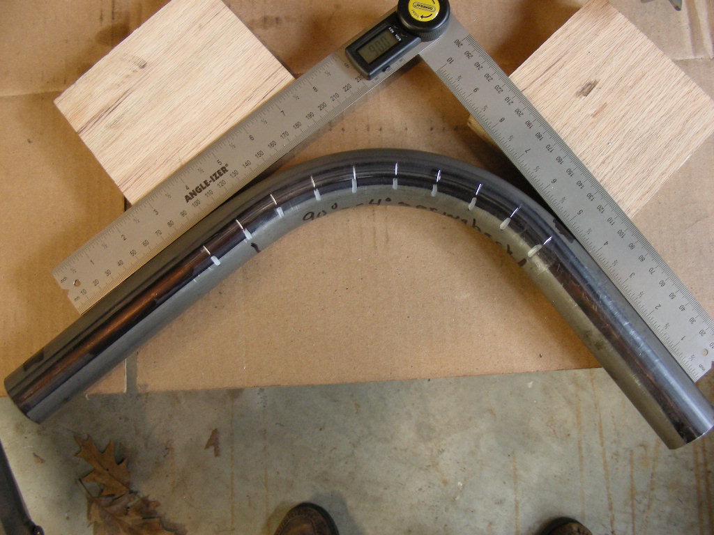

    Bought a new angle gauge yesterday. Used it today while making 2 new practice/layout bends.
    DSCN1369.JPG It's a lot easier to use than my old worn out vernier angle gauge, very easy to read the angle. The bend in the picture is 1.5 inch tubing bent to 90 degrees. Look closely and you can see the layout marks I made on it. Before bending I laid out a neutral axis line, and marked every inch along it. They are permanent, not just the Sharpy marks that are visible.

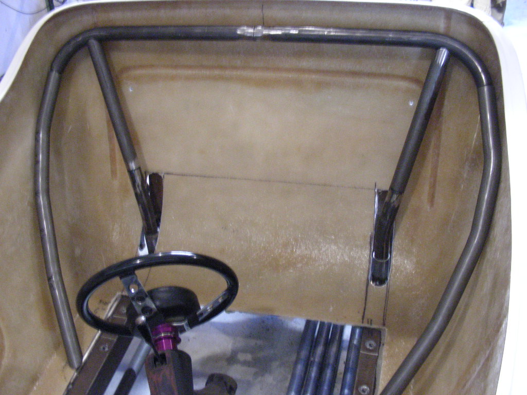

    Okay I'm slow. Got a little bit of welding done this afternoon. The stuff previously shown is tack welded so I'll be able to take it out and remove the body to finish welding it without damaging the body. DSCN1374.JPG yeah I know, BFD, right? But I also made flanges for the bottom of the forward braces, and cut the body to fit.
    Made a new cowl support hoop from 1x0.125 inch tube. Laid it out and bent it paying attention to everything determined from the practice bend, and son of a gun, it worked, first time! Flanges next, and figure out some bracing and support for the steering column.

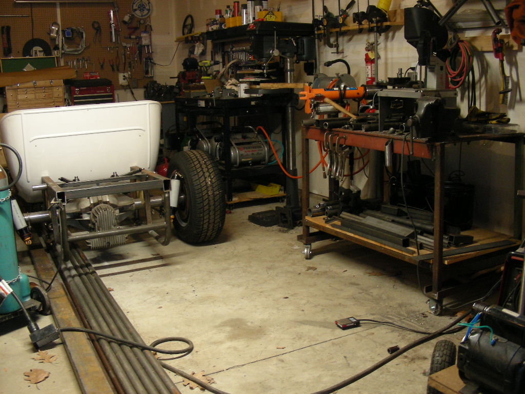

    DSCN1375.JPG And the last picture is of the mess! It's got to be cleaned up before I kill myself moving around the garage. And wasting time looking for stuff. DSCN1376.JPG So that's all... I'm such a slacker compared to most of you!

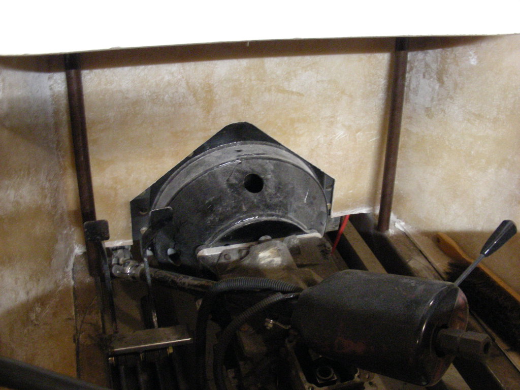

    Cleaned up the garage yesterday, and puttered around with transmission parts. Yes I have a T5 and the adapter for it and know what clutch disc and pressure plate to get. I also have a T10 that was shortened to use in a drag car. Now I have a complete case for it, with unmolested tailhousing parts.
    But to make it a complete working transmission, I need to get reverse gear parts and a new main shaft. Everything I have is appropriate for an early 60's GM version aluminum case T10. The shorty is a 2.20 low gear transmission. Should be a good match for the Whatever project with the qc.
    So now I have to acquire the parts. I'm open to suggestions for sources, just remember that I'm not too capable of using this internet thing. If anyone has one with a busted case or bad syncros or the like, and wants to part with it, let me know. Also willing to discuss trading the S10 T5 and the adapter for a working T10.

    Clean garage, dirty mind!

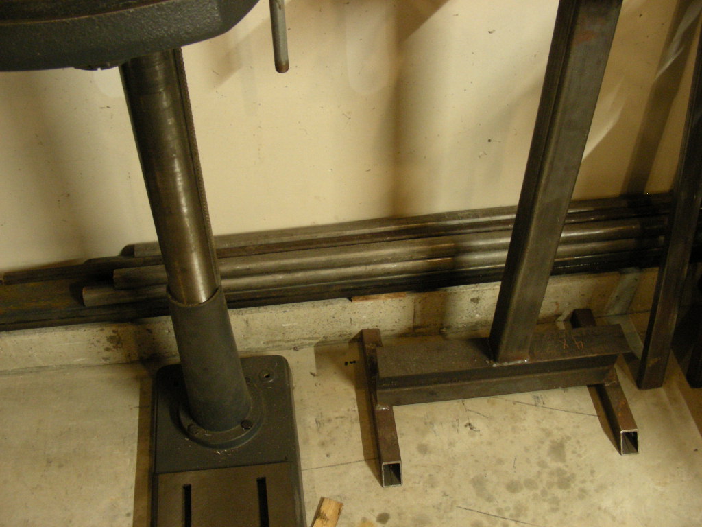

    DSCN1377.JPG New steel stored.

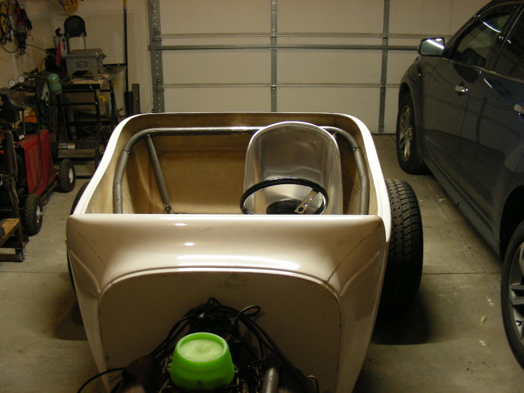

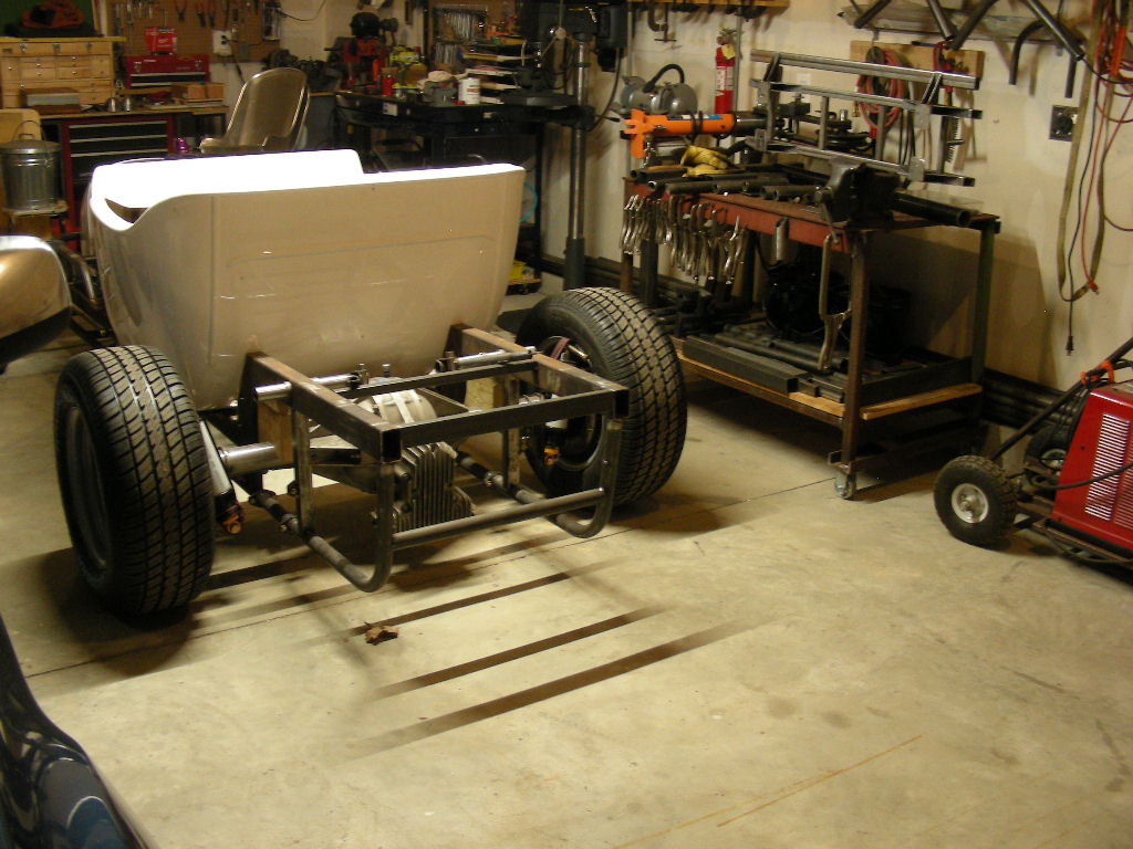

    And test fit the seats in the Whatever project for the first time after fabricating the rear support structure. Guess I'll be making a new mounting something (???), because they need to be a little bit higher.
    DSCN1380.JPG It's amazing how much a cluttered workspace clutters the mind. Without the mess, it only took 15 minutes to get that fit up and figured out the next steps.
    Keep telling myself, put it back when done with it!
