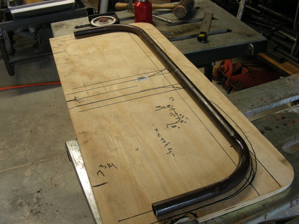

    Eureka! Got the new Marty Strode inspired seat mount designed, stock cut out, and bends laid out. Getting late and I make big mistakes when tired. So bend some tubing tomorrow and tack it all back together. I'll get pictures tomorrow as well...

    Didn't get to any car parts today. Made a roll around stand for the tube bender to get it off of the welding bench. Not quite done, I have to remove the tubing bender from the bench and move it's mounting bracket from the bench to the new stand. Fortunately it has been converted to air over hydraulic power, so it doesn't need to be bolted down to anything.
    Being lazy, I'm going to remove the tubing bender without taking it apart. I'm planning to pick it up with the engine hoist. Then cut the bracket off the bench and weld it to the new stand. Once re***embled I'll try it out on the Whatever project's seat framework... unless I take a ride to a friend's shop to see his 37 flatback going together.

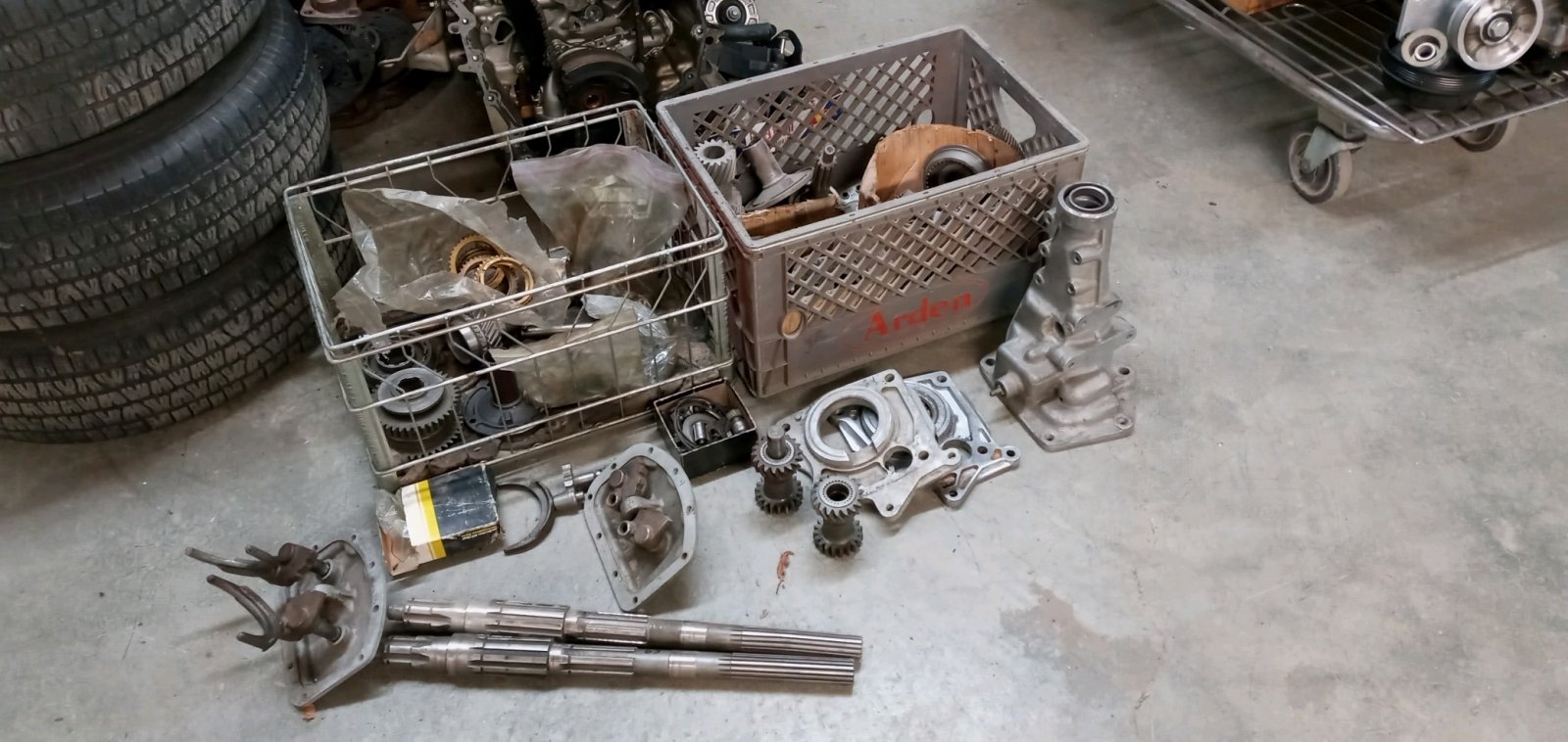

  16. Flatrod17
    Joined: Apr 25, 2017
    Posts: 845
    Flatrod17
    Dave, see anything in this pile of parts you can use? This is mostly 62 to 63 parts from a old Corvette. T10 parts.jpg
  17. Dave G in Gansevoort
    Joined: Mar 28, 2019
    Posts: 4,283
    from Upstate NY
    Why yes I do! Both main shafts, the reverse gear parts and the tailhousing. I'll pm you to determine the wherewithals. Thanks

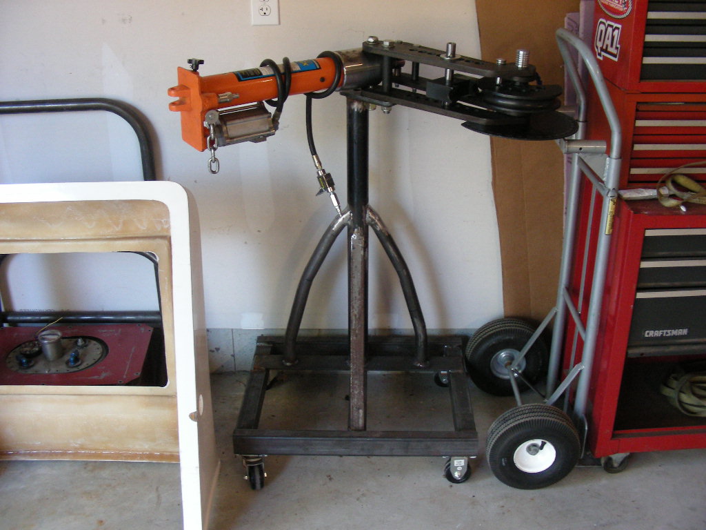

    Remember that I mentioned misbending some tubing previously? Well they came in handy for braces for the tube bender stand. DSCN1382.JPG That's them, the curvy tubes on either side of the main column. So not wasted. Now I'll get back to the Whatever project and finish up on the seat mounts.
    Atwater Mike, ratrodrodder and brEad like this.

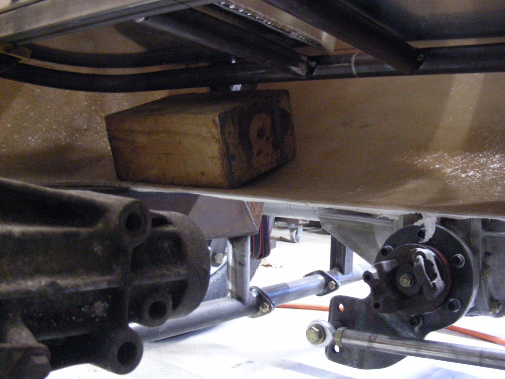

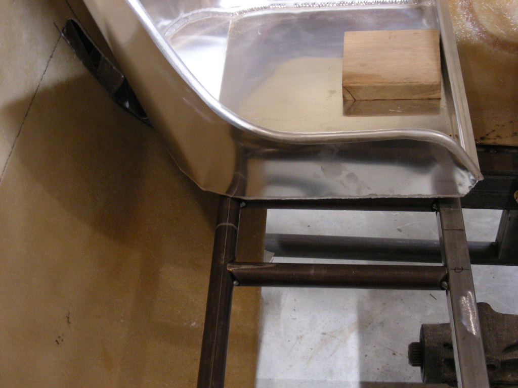

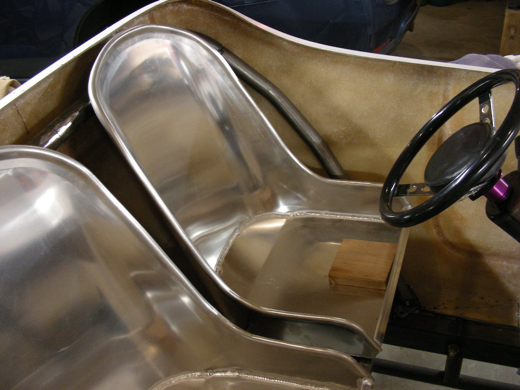

    Made a bit of progress on the seat mount today.
    DSCN1395.JPG It's so nice to use the tubing bender now. First attempt at the base tube and I hit it spot on. I was pleased to say the least. I guess paying attention to all of you real fabricating experts is paying off.
    DSCN1396.JPG It looks like 2 people might actually be able to ride in it together. Now to make a couple of supports from the frame to the bottom of the seat support.
    DSCN1398.JPG Plenty of room under here. Should be a piece of cake tomorrow...But we all know what that means...
  25. Dave G in Gansevoort
    Posts: 4,283
    from Upstate NY

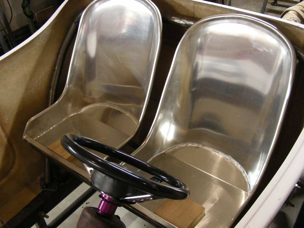

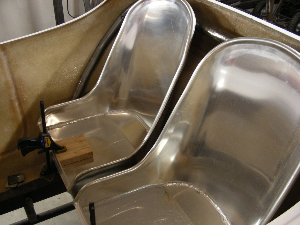

    Got the seat mount together today.
    Here it is. DSCN1403.JPG Not a copy of Marty's system, but inspired by it.
    DSCN1402.JPG The flat part of the seat bottoms are fully supported and there will be tabs like Marty showed to bolt the seats in place. 4 ****on head screws per seat. Eventually when they get upholstered, the bolt heads will be covered.
    DSCN1400.JPG DSCN1399.JPG And it looks like 2 people might actually be able to ride in it together without 1 being 98 pounds soaking wet!
    Tomorrow the steering column support finally!
