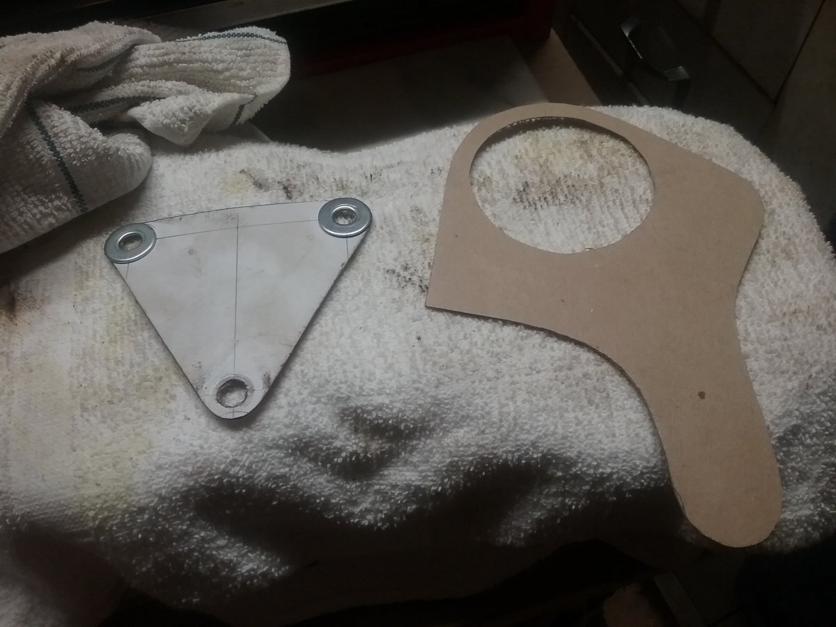

    So today was engine mounts. Remember early on I mentioned I have some degrees in mechanical engineering? I use CAD when designing brackets and such: 20201006_191833.jpg That's Cardboard Aided Design. A friend of mine from NC via Ann Arbor coined that term. The 1 on the left is the layout for the front engine mounts block pad (I didn't have any mounts to copy, so...). The right template is the brackets I had cut by waterjet for the rear suspension.
    So next for the front mounts is cut some tubing to go from a frame bracket to the block plate. That's tomorrow. I also got the rear block plate started. It only needs a few more holes and some frame brackets to bolt to.

    Hit the wrong ****on, so here's the picture of the motor plate: 20201006_191756.jpg The 2x4 was just the right height to hold the block at the 4 degree angle needed to work with the rear axle angle.

    Remind the cl*** again why you're running hairpins to the rear axle, rather than the more(?) common 4-link / trailing arm / Watts link setup?
    Also, I feel like we're missing some key triangulation here, but then again you're the engineer who's already built a few race cars...

    Dave : As for the front motor mounts... Might want to take a look at how the sprint car crowd does it(or just look at the Speedway racing catalog) : a "U" shaped plate bolts to the 2 bolts on each side of the front of the Chevrolet block & then to the frame(there's another one with 2 plates that pivot at the bottom of the motor to keep the mounts/frame from being "stressed" during use). The first (single plate one) could be mounted with a couple of rubber donuts resting on top of the frame(sort of a smaller version of the Ford donuts for the "flattie" water pumps)?? just a couple of ideas from the "KISS" principle(& from the guy that started me "down the road to perdition" with Sprint Cars almost 50 years ago!)

    Now back to motor mounts. Yes Dr. I thought about doing a front plate, but ran out of tooling plate. Hey I'm half Scotts, we're thrifty remember. So I'm going with side mounts out of thrift. I can make everything needed from materials on hand. And not have stuff in the way up front if I decide to run the Hilborns on it (belt drive off the right side, alternator down low on the left). I can picture it I just can't draw it yet...

    Got my idea for front mounts made. I may still do as the good Dr. suggested and make a front engine plate. What I made today will allow me to position the engine front to back so I can fit all the other stuff in. If I go engine plate, I'll figure out a way to mount an alternator and the Hilborn fuel pump off it to keep the front simple and clean. Here's what today's effort looks like: 20201007_141636.jpg 20201007_141627.jpg And Ratrodder does this look familiar? 20201007_141712.jpg For the next couple of days I need to work on a ramp into the storage shed so I can get more stuff in there for now: 20201007_141744.jpg This stuff is heavy! It needs to roll so that's next...
