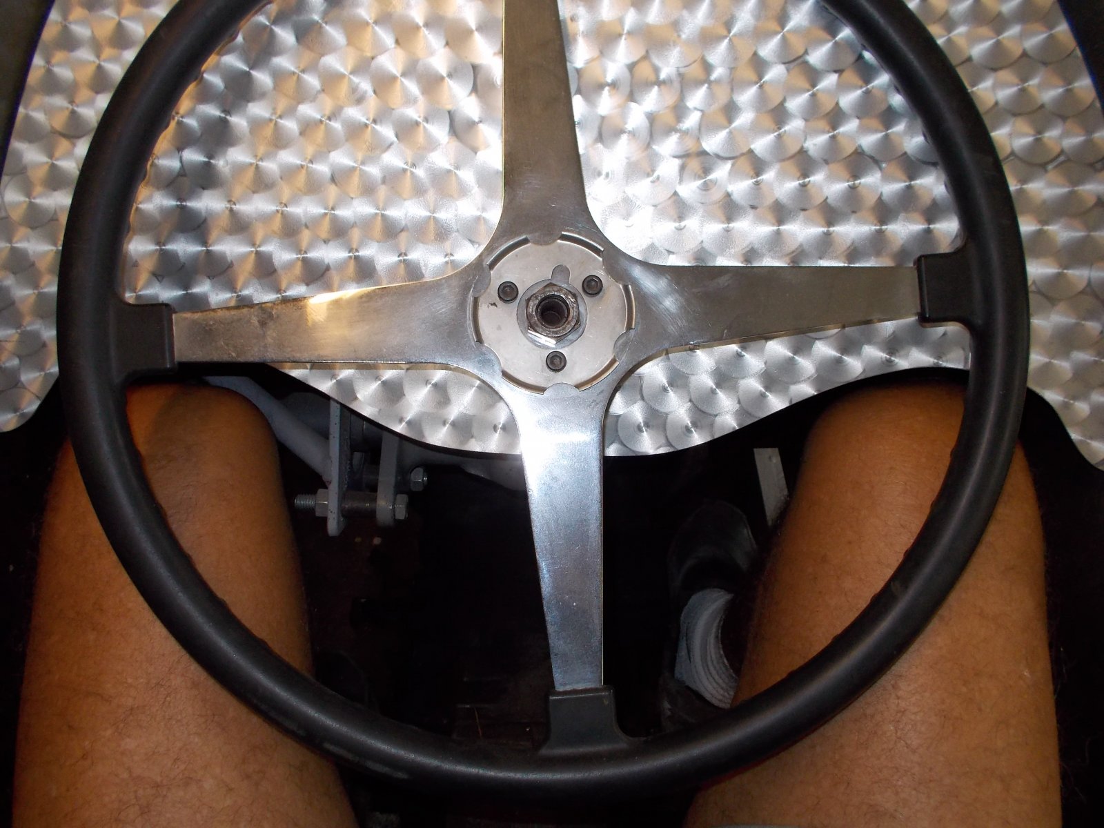

    Paint and I don't get along too well. Maybe engine turning is what I should do to the body. Of course that means I'd have to make a body of aluminum, and I don't know how to. But it could be a new learning experience...

    @Dave G in Gansevoort old school way of engine turning is a wooden dowel rod and some lapping compound like Clover. the new way is cretex rods and they come in my grits and sizes.

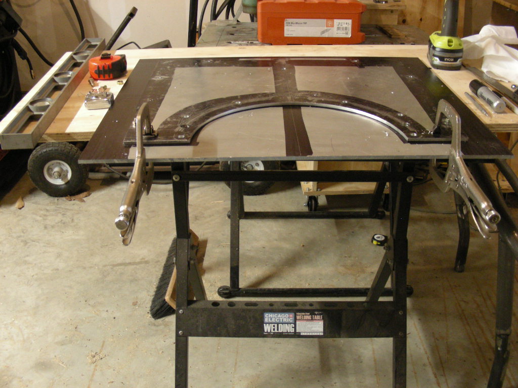

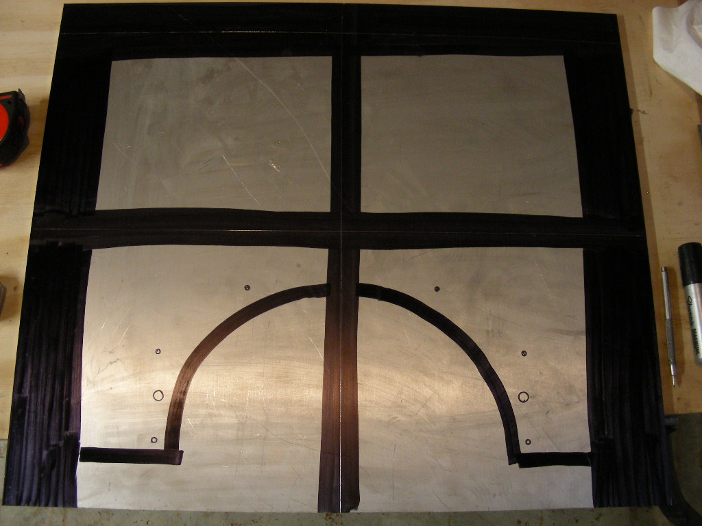

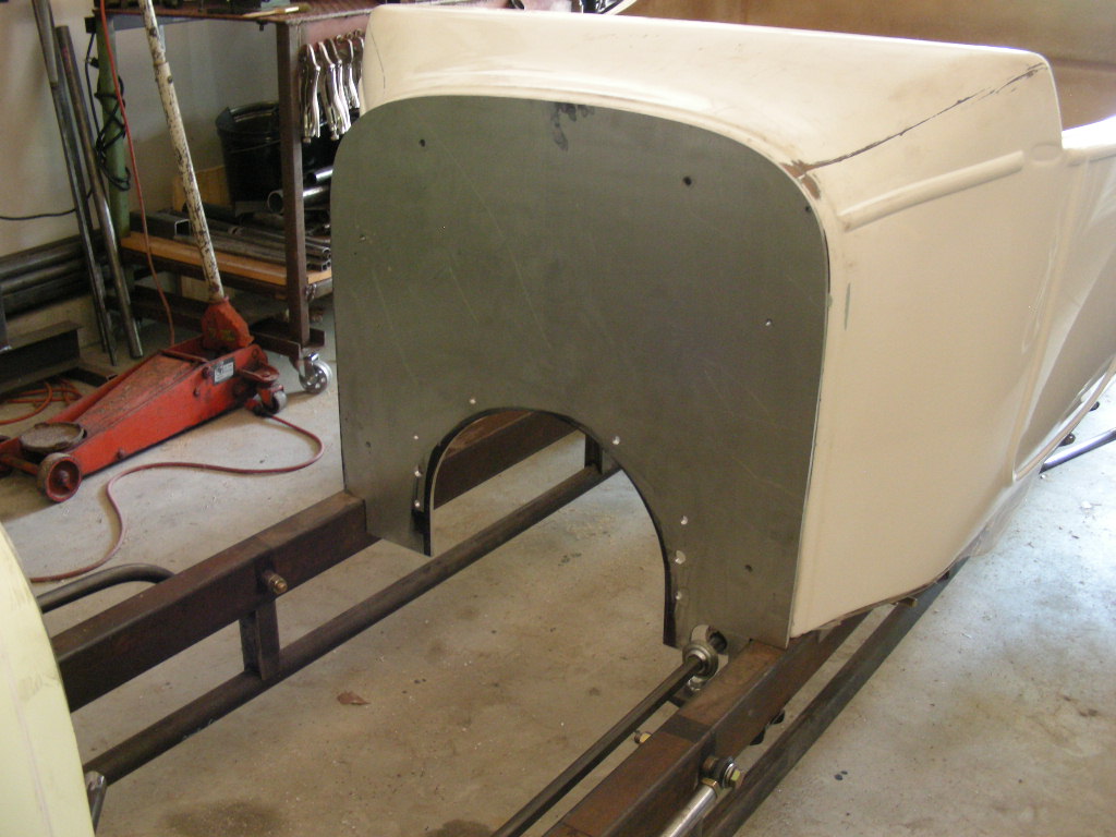

    Pictures first in no particular order cuz I'm lazy. That's the way they're in the file...
    DSCN1435.JPG DSCN1434.JPG DSCN1433.JPG DSCN1432.JPG DSCN1431.JPG The 1st picture is so far the last step today. All bolt holes drilled, but waiting on the 2 dowel pin holes. Need to make a drill guide bushing.
    The 2nd picture is just prior to all holes drilled.
    3rd picture shows the outer firewall bolt holes drilled.
    4th picture was the 1st 2 holes drilled.
    5th picture was the initial layout. I don't use ****m layout dye, only because I never think to buy it. I just use a maxi-marker. I can get them at the grocery store, so...
    Tomorrow, match it to the firewall and frame rails and make the cutouts. Can you feel your hands tingling from the sabersaw yet?

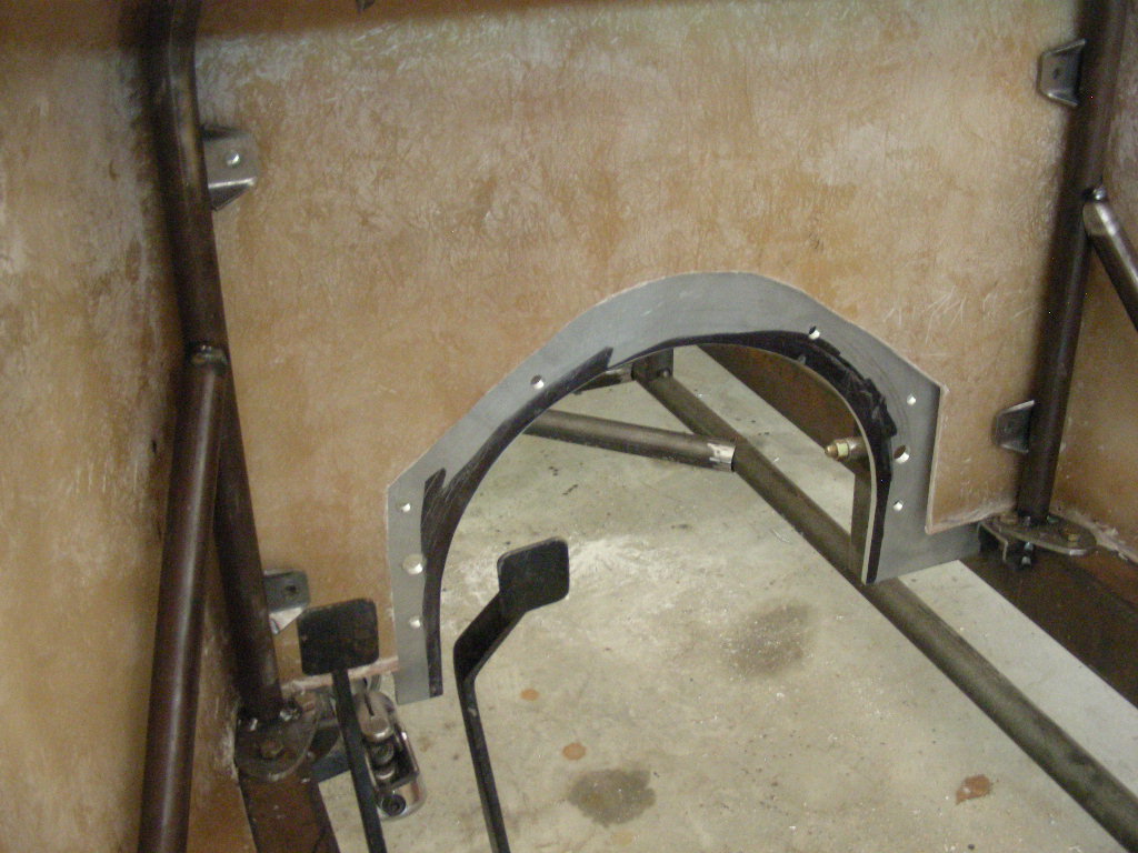

    Friday and Saturday's efforts revealed: and yes both days my hands have had that tingling from running the sabersaw so much.
    DSCN1437.JPG DSCN1436.JPG Inside view and outside view of the plate with cutouts and "bluing" removed. Giant magic marker...

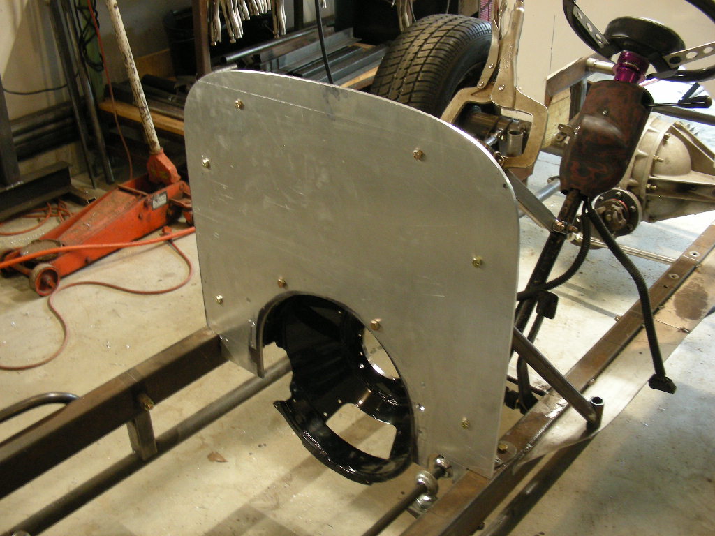

    Okay so start again. I hate it when I do that! Lost the first start on today's excellent adventure in the garage.

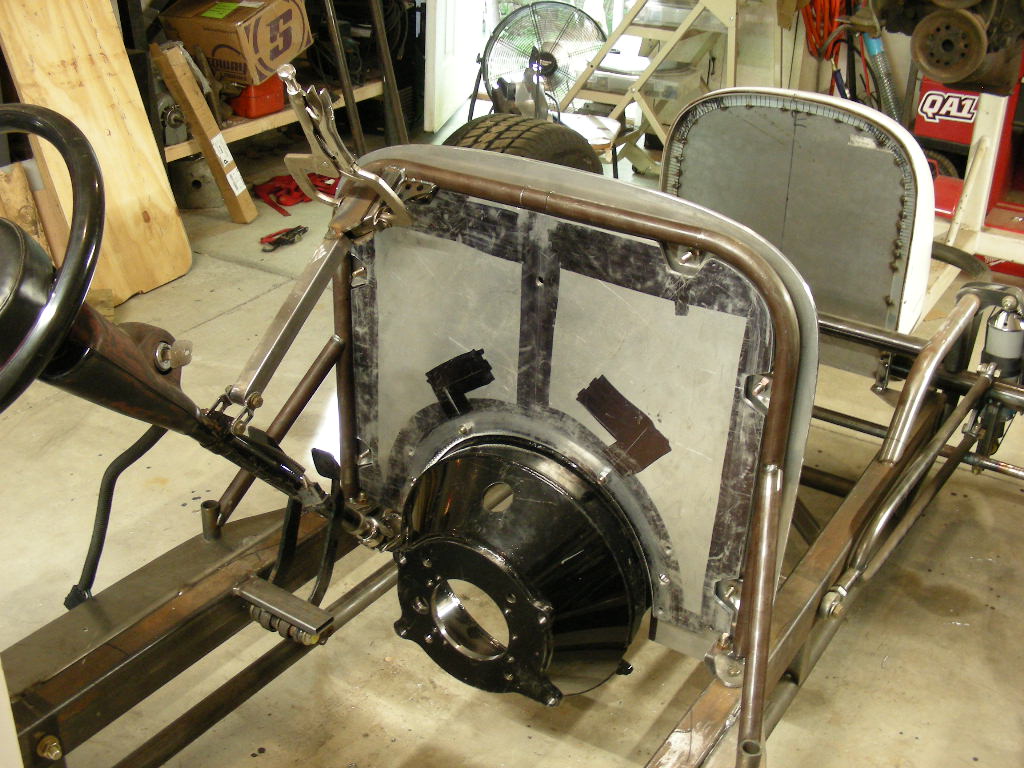

    I'm mostly finished with my best interpretation of Marty's firewall solution. I don't have many tools for sheetmetal fabrication, so I used what I had, the new tooling plate and the old. You've seen the new engine plate and the cowl support hoop mated, today I finished modifying the old small one to fit inside the cowl support hoop and bolt to the bellhousing.
    DSCN1438.JPG From the front.
    DSCN1440.JPG From the right rear.
    DSCN1439.JPG From the left rear.
    lurker mick likes this.
  20. Dave G in Gansevoort
    Joined: Mar 28, 2019
    Posts: 4,274
    from Upstate NY
    Had a time out for supper. Getting back to the pictures: if you look closely you can see the 1/4-inch space between the two plates. That's the thickness of the bellhousing flange. It's also the thickness of the body's firewall. I've got a couple of ideas from Marty on how to isolate the body from the plates, and effect a seal.
    The bottom of the inner plate is level with the top of the frame rails. With a little bit of effort I'll make a flange to support the front of the floor at that point. The frame rails will support the sides of the floor, and the pending crossmembers will create a surface for the center tunnel, and a driveshaft retaining strap. That's on the list of things to do...
    But that's for another day!

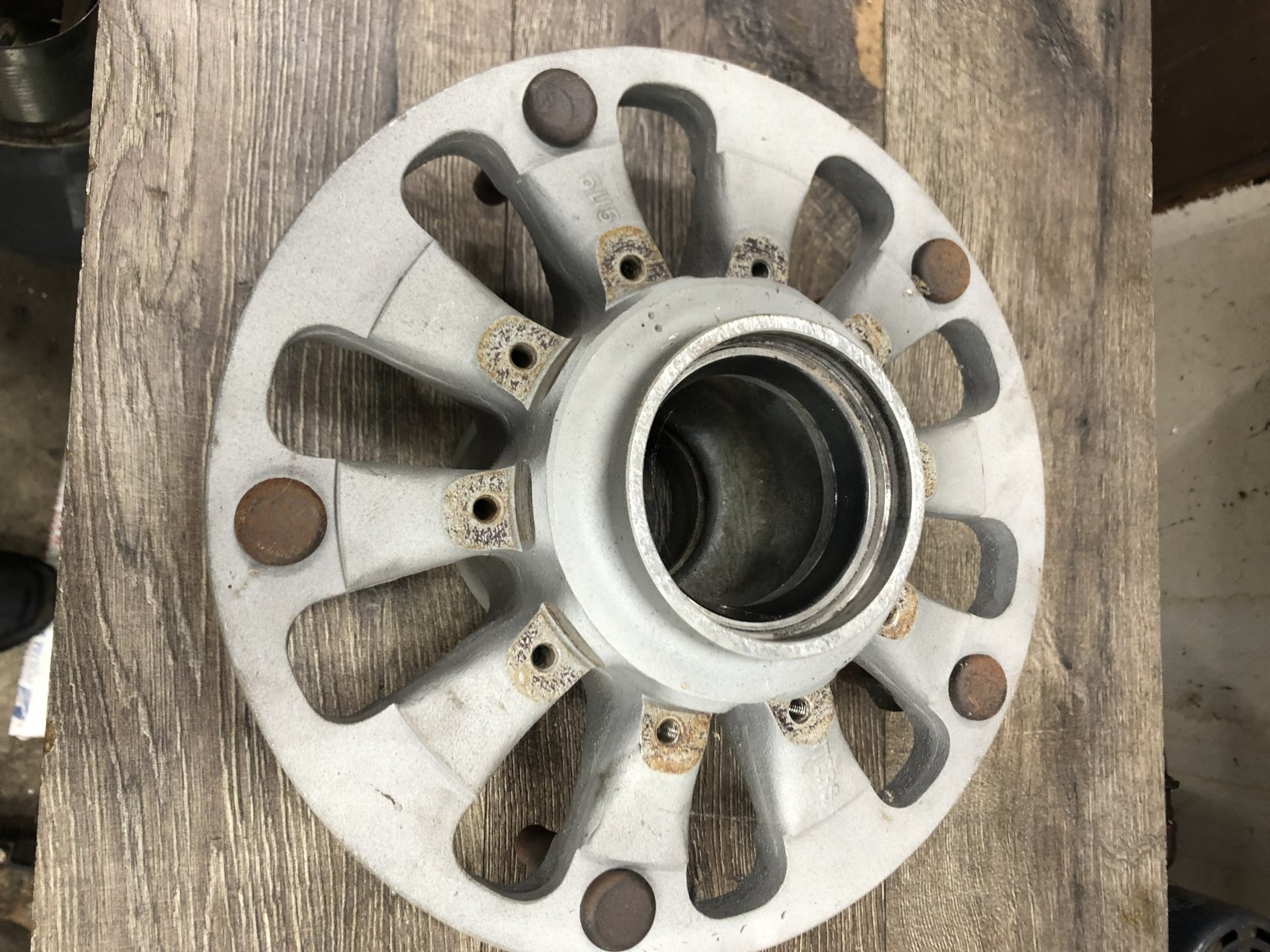

  22. GearheadsQCE
    Joined: Mar 23, 2011
    Posts: 3,669
    GearheadsQCE
    Alliance Vendor
    Dave,

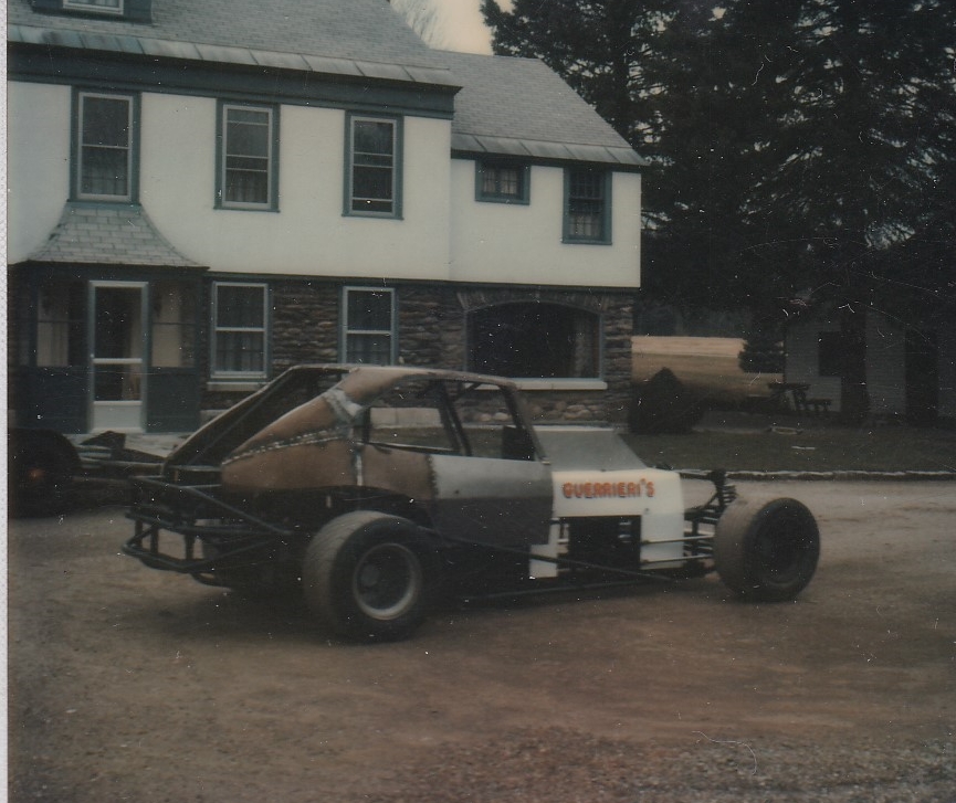

    In the 3rd picture:
    Rear hub, is that a Winters? I have a pair like that and would love to find two more. There is a Halibrand that is similar. I'll post some pics when I get out to the shop.
  23. Dave G in Gansevoort
    Posts: 4,274
    from Upstate NY
    I'm not sure of the brand. I got them from Gary's Speed Shop in Watervliet (spelling? ) NY and over the years probably had 6 more. They were lighter than the ones on the front in that same picture, and I felt with the open backing plates would provide better cooling. Must have been something to it, as we never had brake issues with that setup.

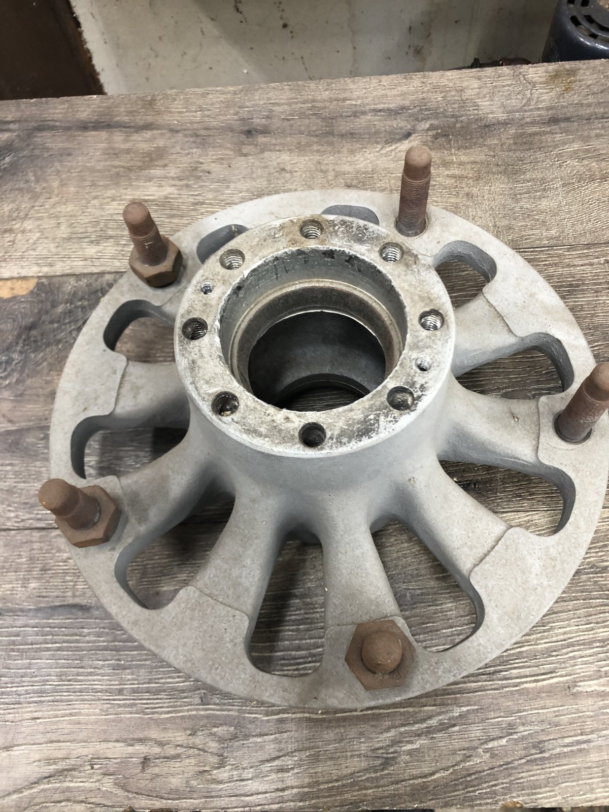

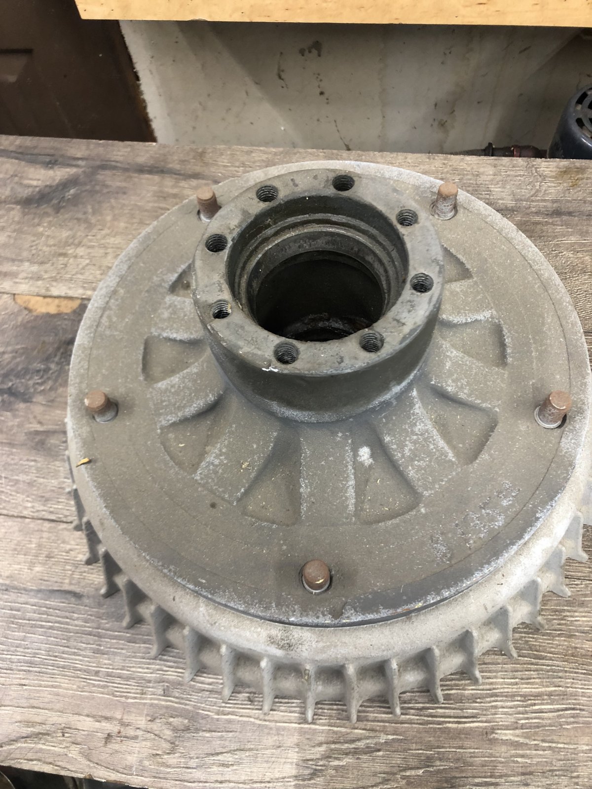

  24. GearheadsQCE
    Posts: 3,669
    GearheadsQCE
    Alliance Vendor

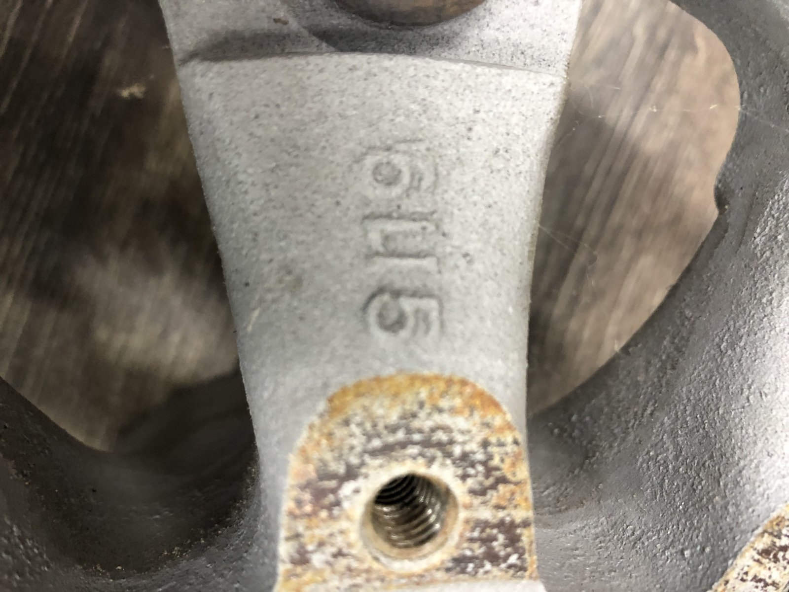

    IMG_4472[1].JPG I was hoping you would say that you had a couple of NOS ones sitting in your shop gathering dust!
    Here are some pics of the hub I'm looking for:
    Here is a Halibrand with a similar style
  25. Dave G in Gansevoort
    Posts: 4,274
    from Upstate NY
    WOW! I'm having a flashback! Yes they are similar. When I was using them, they were not machined for discs, just flat where the studs went thru, for the drums.

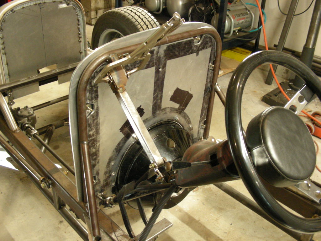

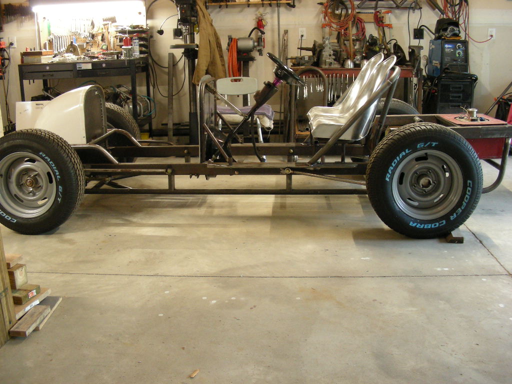

    Did some welding and fitting on the Whatever project today. Then cleaned up the garage. It had become a pig sty. DSCN1442.JPG DSCN1441.JPG DSCN1440.JPG DSCN1439.JPG That Vicegrip is off, the steering support is tacked into place and the steering is hooked up and works! It might be a tad slow, but that's easily fixed. Either a longer pitman arm or a steering quickener.
    I've checked out the seat to steering wheel position, and it works for my old fat nonbendy body. Of course it's easy to get in the seat without the body, but with a door I should be good!
    Now to get some more welding done with the body off, and the structure bolted down to help resist Mr. Shrink! Then work out a floor of some sort. And thanks again to Marty Strode and the many other people who have offered advice or just put so much good information in their threads. I'm thinking that I may use the International master cylinder like Marty has done. However there's a twist I'll be working on.
