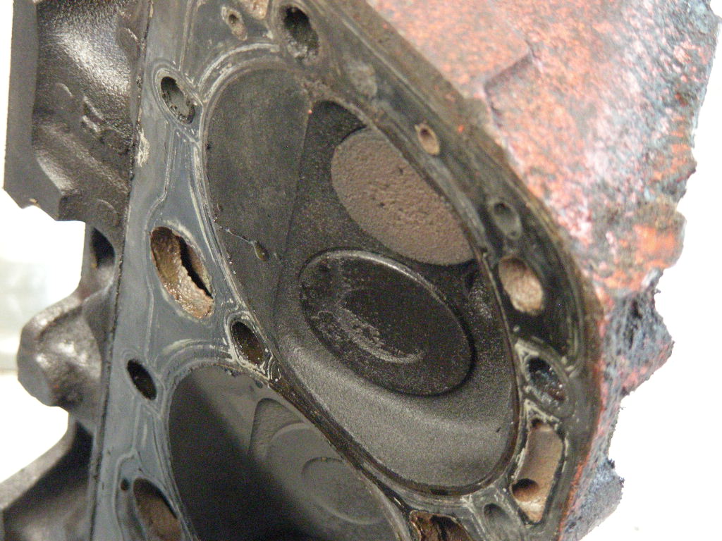

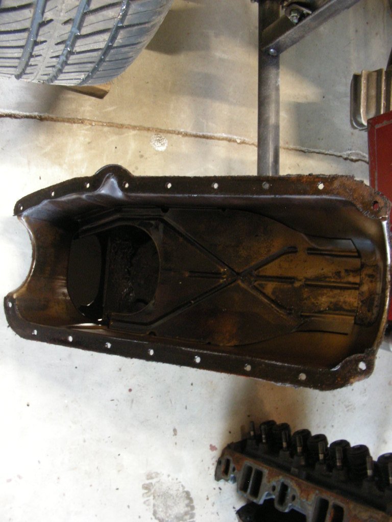

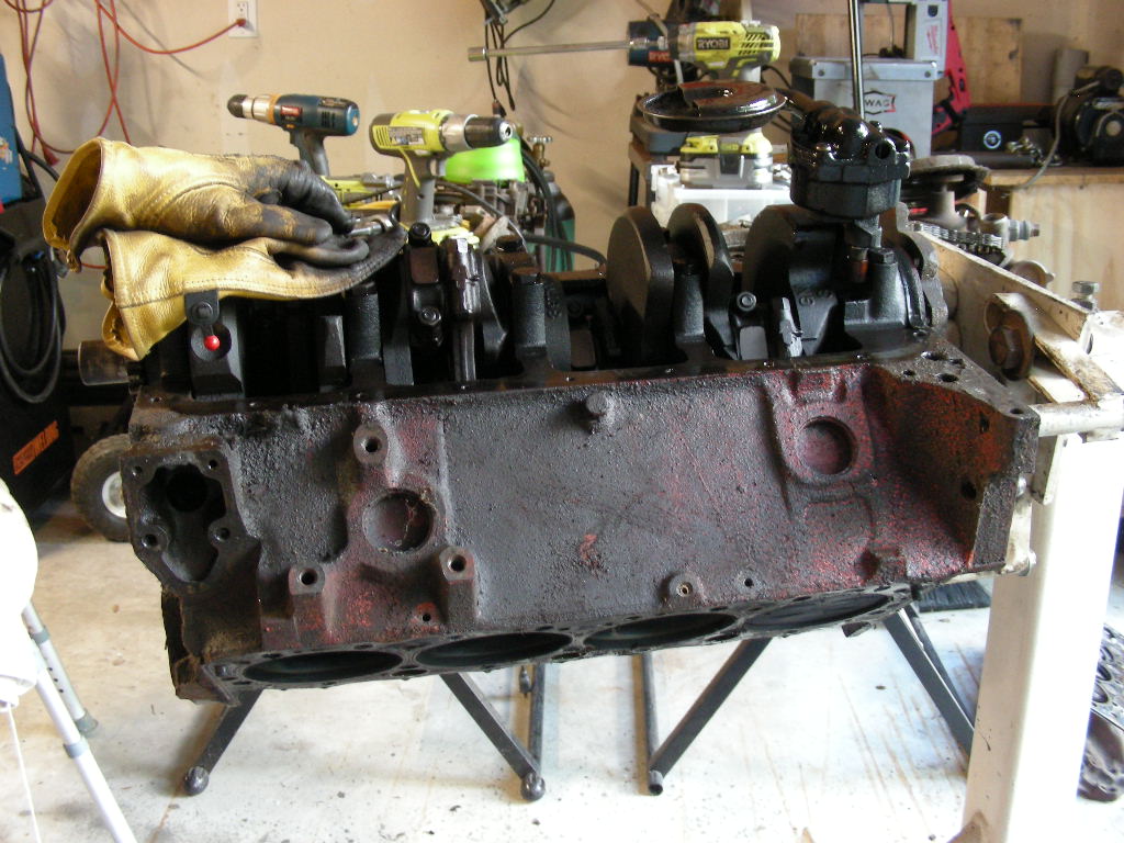

    Finally! Got old mangy down to a short block. The good news: it is in really good shape inside. It had been rebuilt sometime in its past, evidenced by the rods and main caps being numbered. It was a stock rebuild, haven't measured the bores yet, so there's that to check. It had steel shim head gaskets, with no evidence of any failures.
    The bad news: cast crank! Arrg! Now I know lots of engines have been built using cast cranks. I just don't like spending a bunch of money with the potential that if I get carried away, well cast crank...
    So next time I talk with Jack Boyd, I'll see if he has an opinion regarding a couple of options: a forged **** 350 crank (we'll call it a stroker 327...), or try to locate a usable 327 large journal forged crank (think hen's teeth these days), or finally pull the 283 forged crank I've been hording for decades out and have it ground and polished, and use my last 327 small journal block. Of course where that gets expensive is rods. Small journal forged rods are becoming a bit spendy. Everything else will be new anyway, so those will be the places where I'll be spending more.
    So here's some pics of the insides. Surprising how clean it is. DSCN1455.JPG DSCN1454.JPG DSCN1453.JPG DSCN1452.JPG Decisions, Decisions!

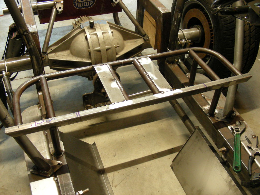

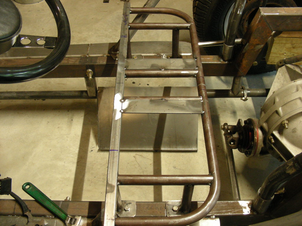

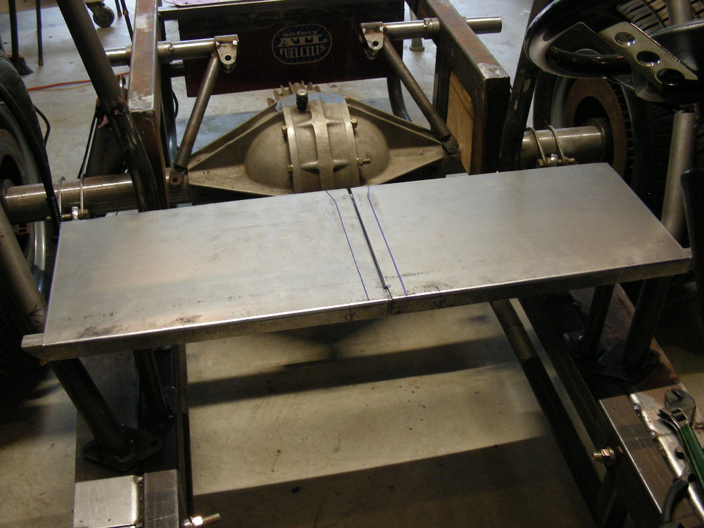

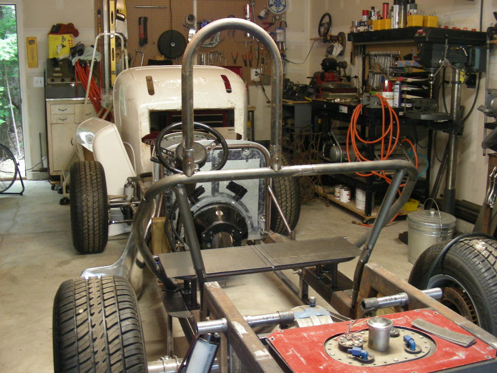

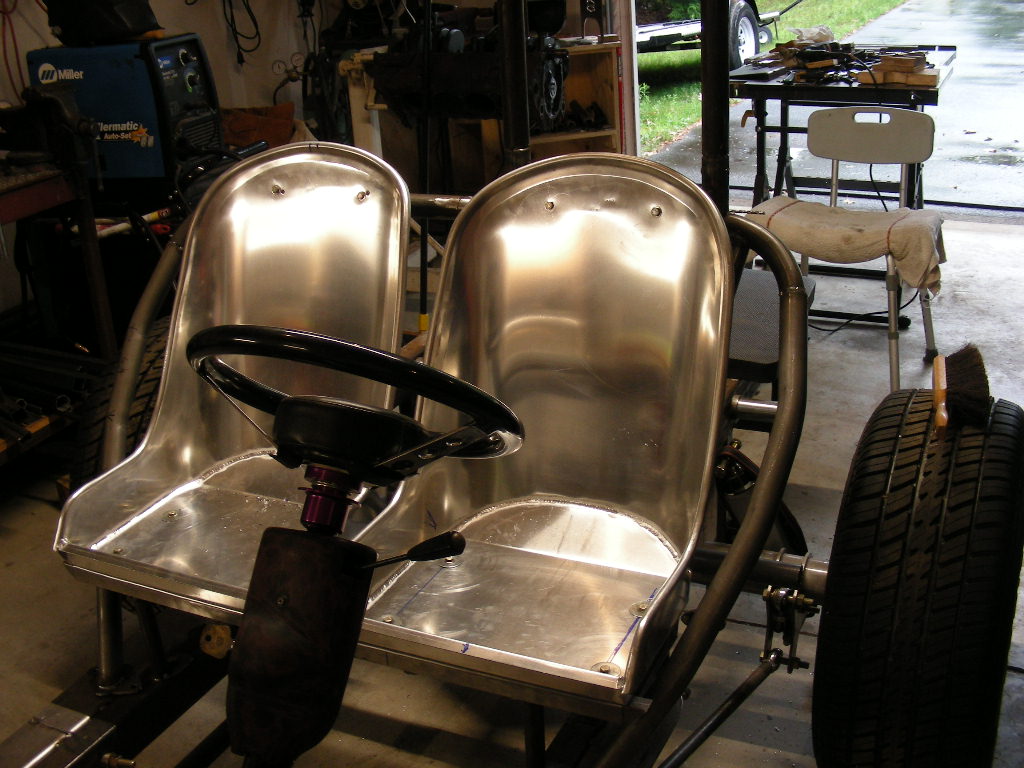

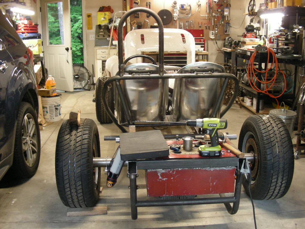

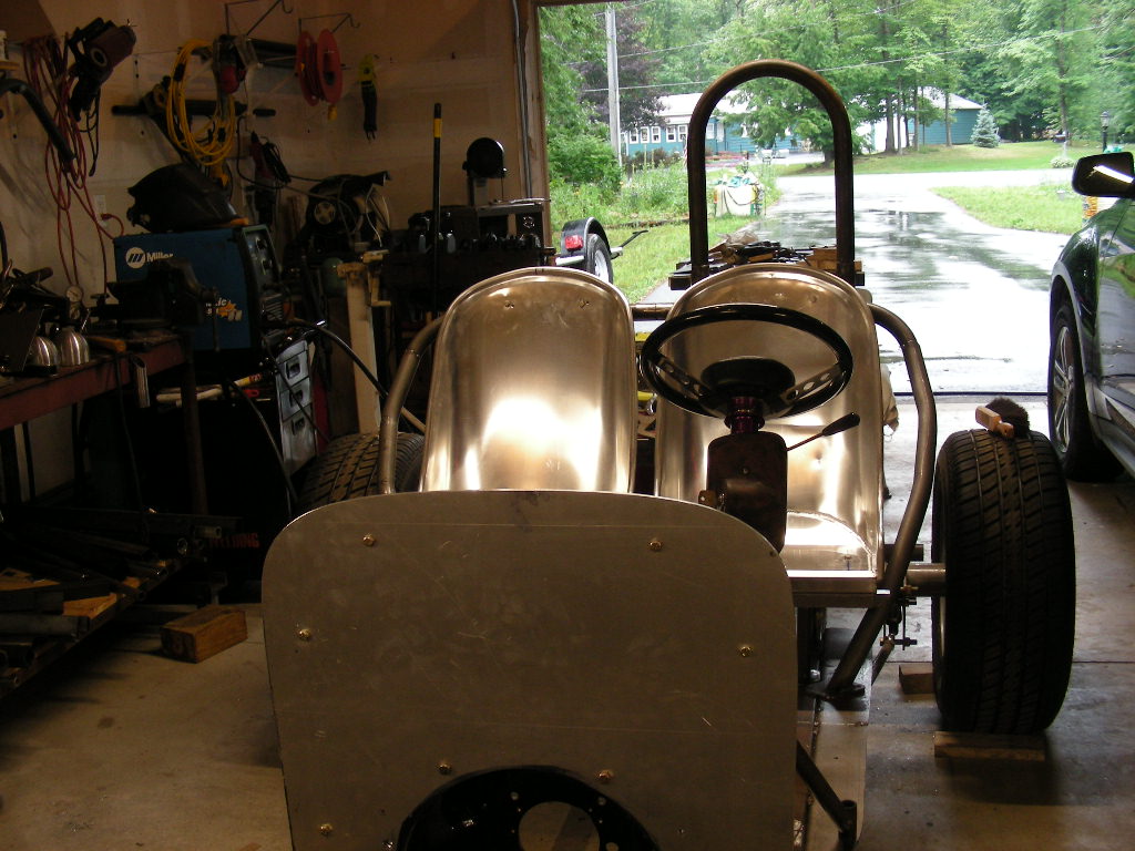

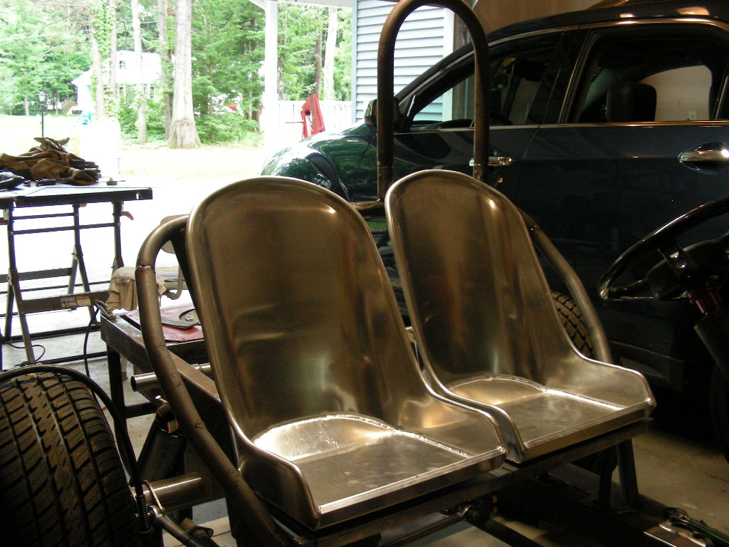

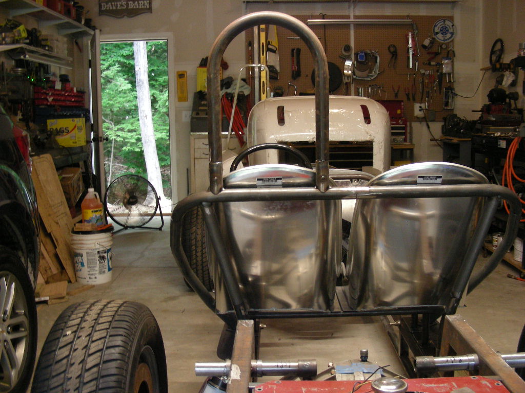

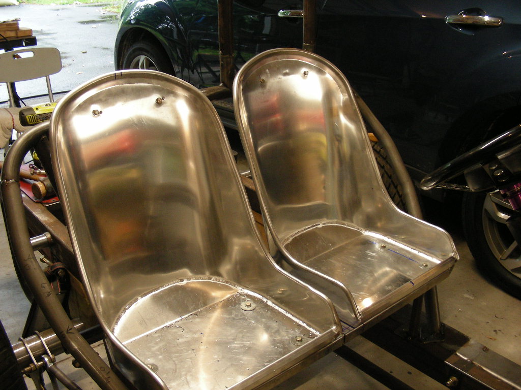

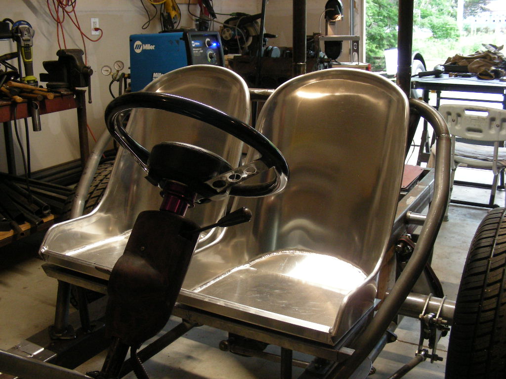

    Real progress today! Got way further along on the seat mounts. And the roll bar. If a picture is worth a thousand words, here's 8,000 give or take...
    DSCN1467.JPG DSCN1466.JPG DSCN1465.JPG DSCN1464.JPG DSCN1463.JPG DSCN1462.JPG DSCN1461.JPG DSCN1460.JPG DSCN1459.JPG DSCN1458.JPG Okay so I can't count. 10 pictures, 10,000 words. And that's all I'm going to say about that! Ask questions if the pictures are not self explanatory. I'm hot and tired, and need a shower and supper.

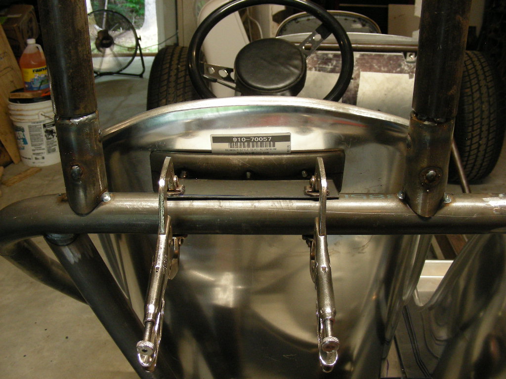

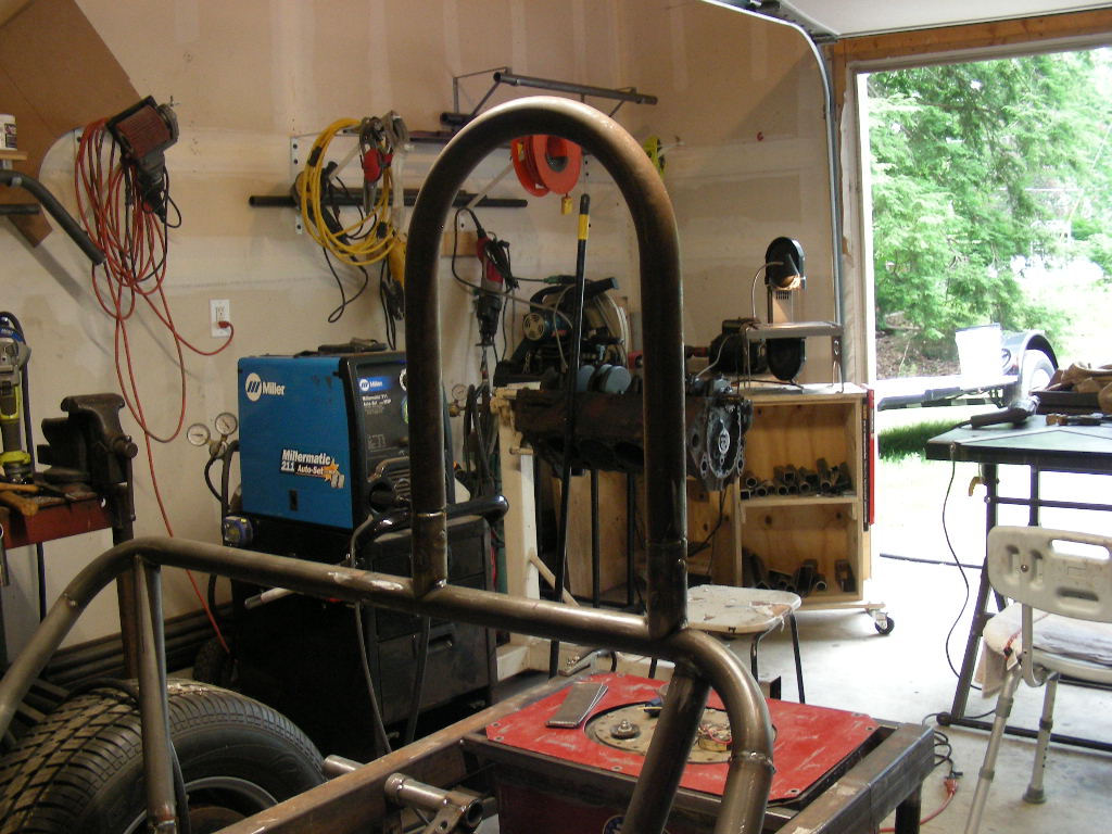

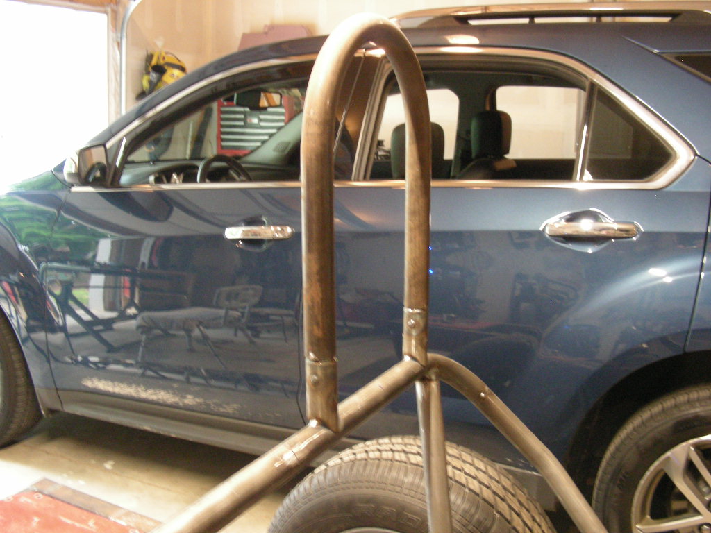

    Next batch of pictures: DSCN1474.JPG DSCN1473.JPG DSCN1472.JPG DSCN1471.JPG DSCN1470.JPG
    I hate it when my fingers don't want to cooperate! Anyway here goes.
    1st picture from the rear, overall view of the the support hoop and the rear braces for the seat backs. 2nd picture a little closer view showing the seat back braces in better detail. Looking closely you can see the parts that bolt to the seats, and the tabs welded to the support hoop. When finished they will be bolted together with grade 5 bolts, to allow some give if there's ever a n oh $#!+!
    Next, some cross bracing for the body hoop, to add support for the roll bar right leg. Then pull it all apart and put the body back on and start the next couple of projects on it...
