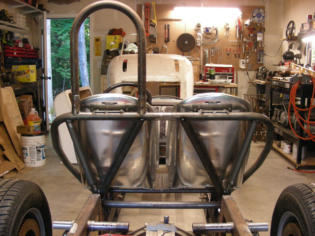

    DSCN1476.JPG Triangulation! Now I'm happy with the rear support structure. I may still change to a full width roll bar, but that's not a big deal. Just move the center mounting stub over to the right side, and maybe the left side a little bit more left. The beauty of doing that would be the rear bracing. It would get 2 braces and they would go straight to the frame rails at a better angle. We'll see...
    Then it was time to strip! All of the support stuff, so I can get the body back on and check fitments, plan the next couple of steps, ruminate on pedals...

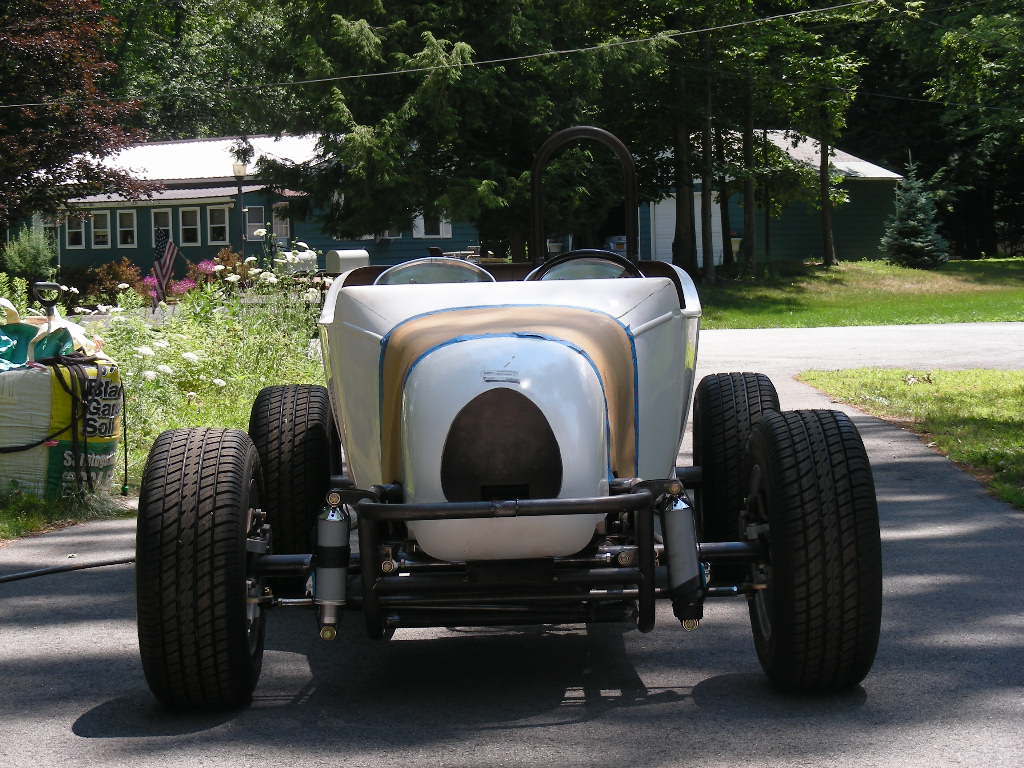

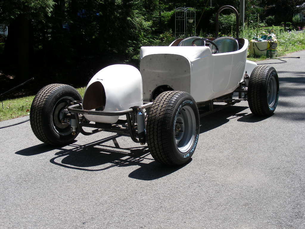

    Got up early today and out to the garage and the whatever project. Put the body back on and reinstalled all of the support structures and seats. Here's a few pictures.
    DSCN1483.JPG DSCN1482.JPG DSCN1481.JPG DSCN1480.JPG DSCN1479.JPG Okay so I'm biased, but it does have a nice profile. So much more to do.

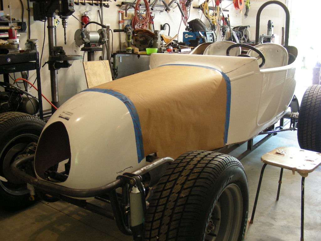

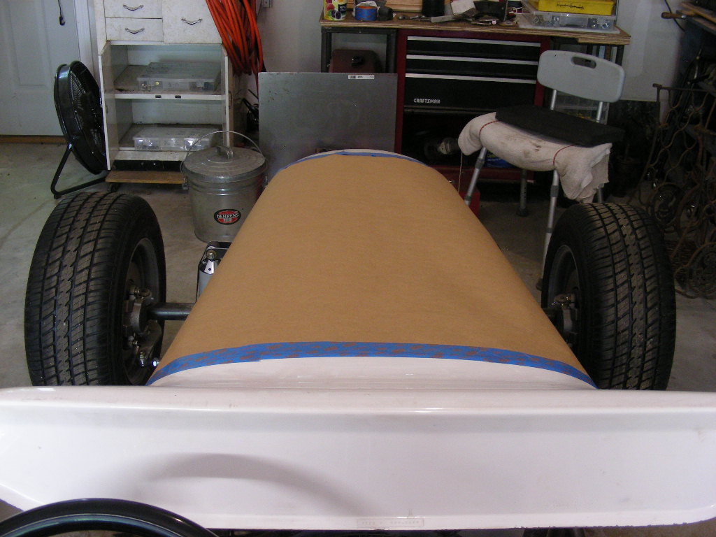

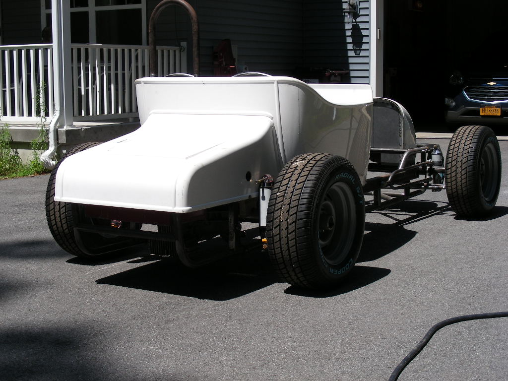

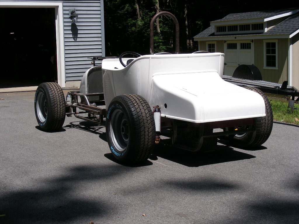

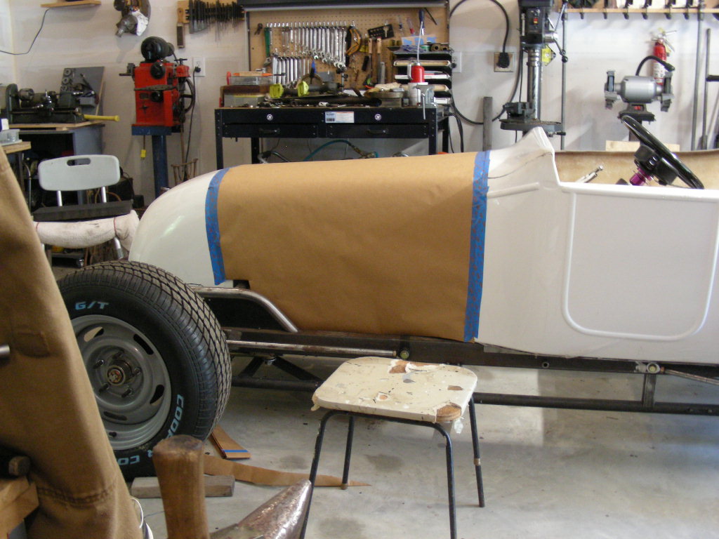

    Pictures of a hood in the neighborhood... DSCN1490.JPG DSCN1489.JPG DSCN1488.JPG Had to see what it's going to look like eventually. Brown butchers paper and masking tape. With my limited skills with sheetmetal forming, I think I'll make it in 3 parts. Going to watch NASCAR this afternoon, and draw up the pedal bracket modifications. Took measurements, got an engineers pad, a ruler, and a pencil. What can go wrong?

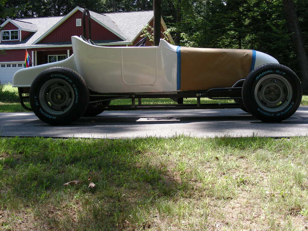

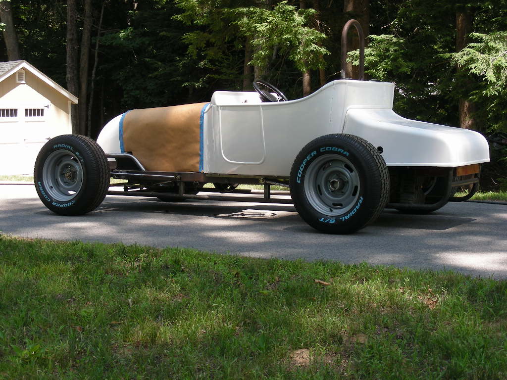

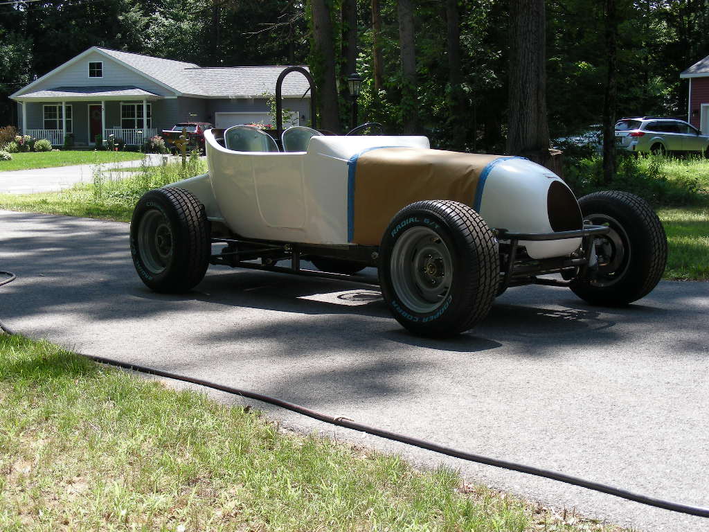

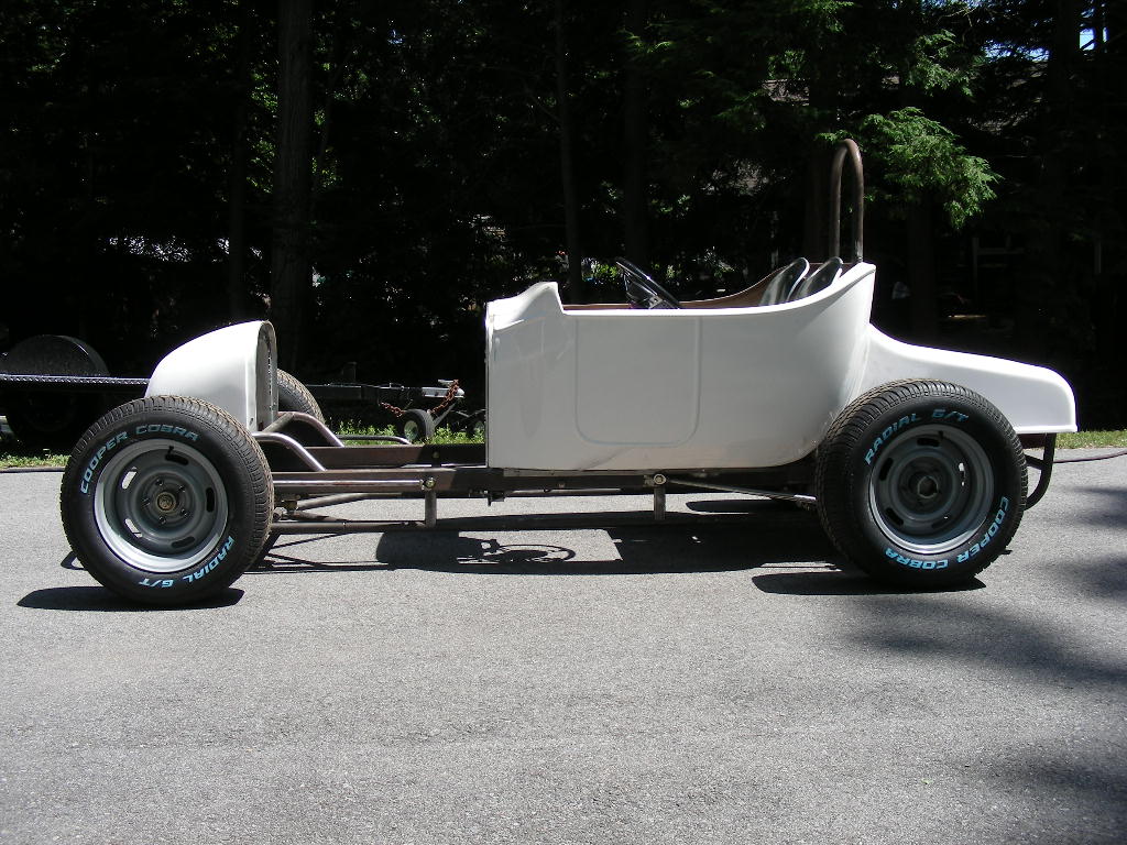

    Outside pictures today with the paper hood. So it's going to catch fire on the car, I always said I was going to flame it!
    Afterwards back in the garage, rolled up the paper hood and pulled out the firewall ***embly. I re***embled it on the bench so I can make the pedals work. Here's the ***embly.
    DSCN1504.JPG DSCN1503.JPG DSCN1502.JPG DSCN1501.JPG Lots of room above the bellhousing and to the right side of the pedals and steering column setup. That's where the master cylinders are going, with a little bit of time creating a couple of bell cranks. And there's plenty of travel, as can be seen between the pictures with the bungee cord holding the pedals up and the picture with the pedals hanging free. Either way has a lot of travel, so it just depends on how comfortable I am with either position.

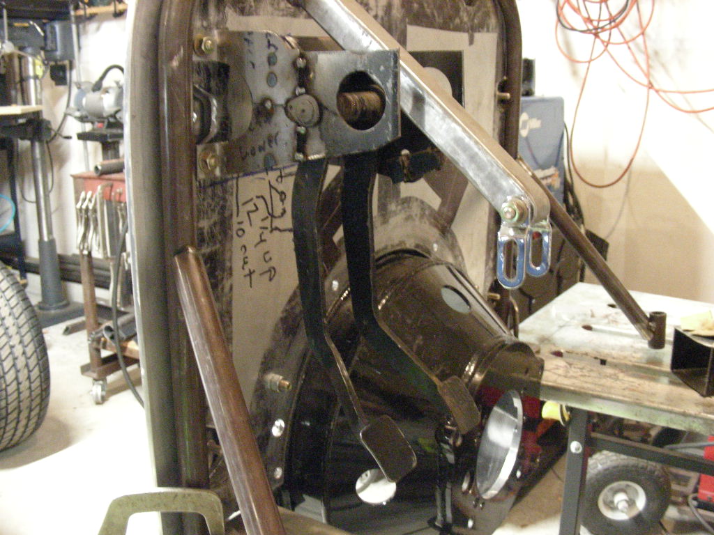

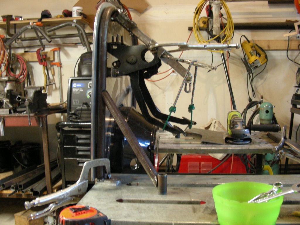

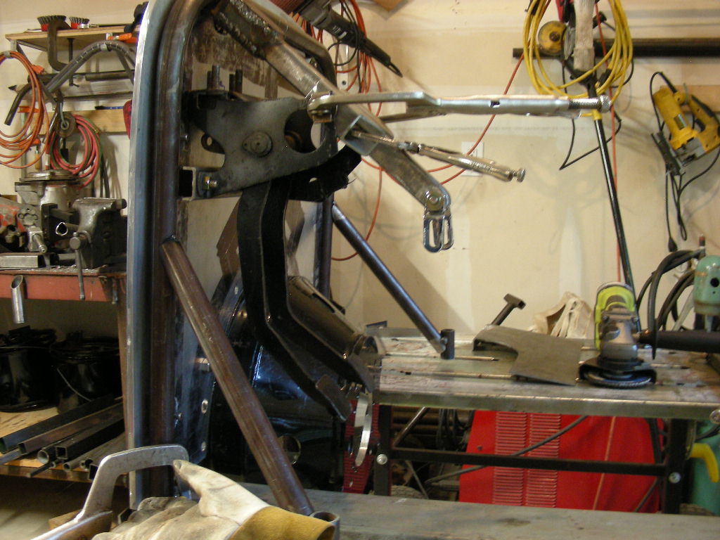

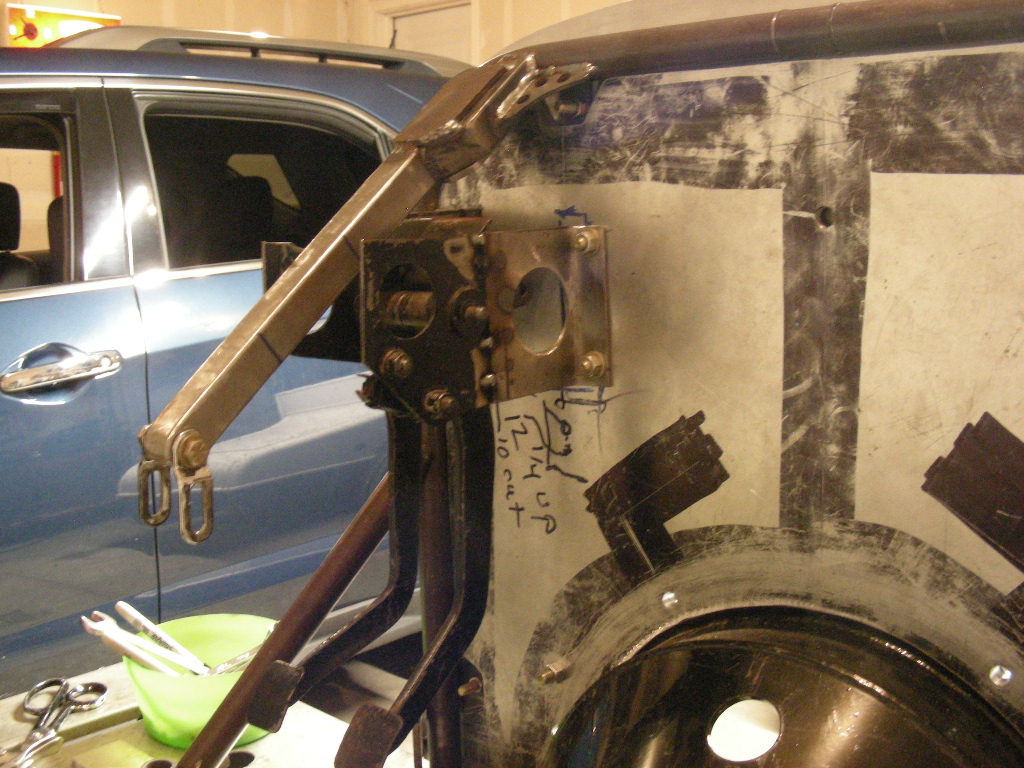

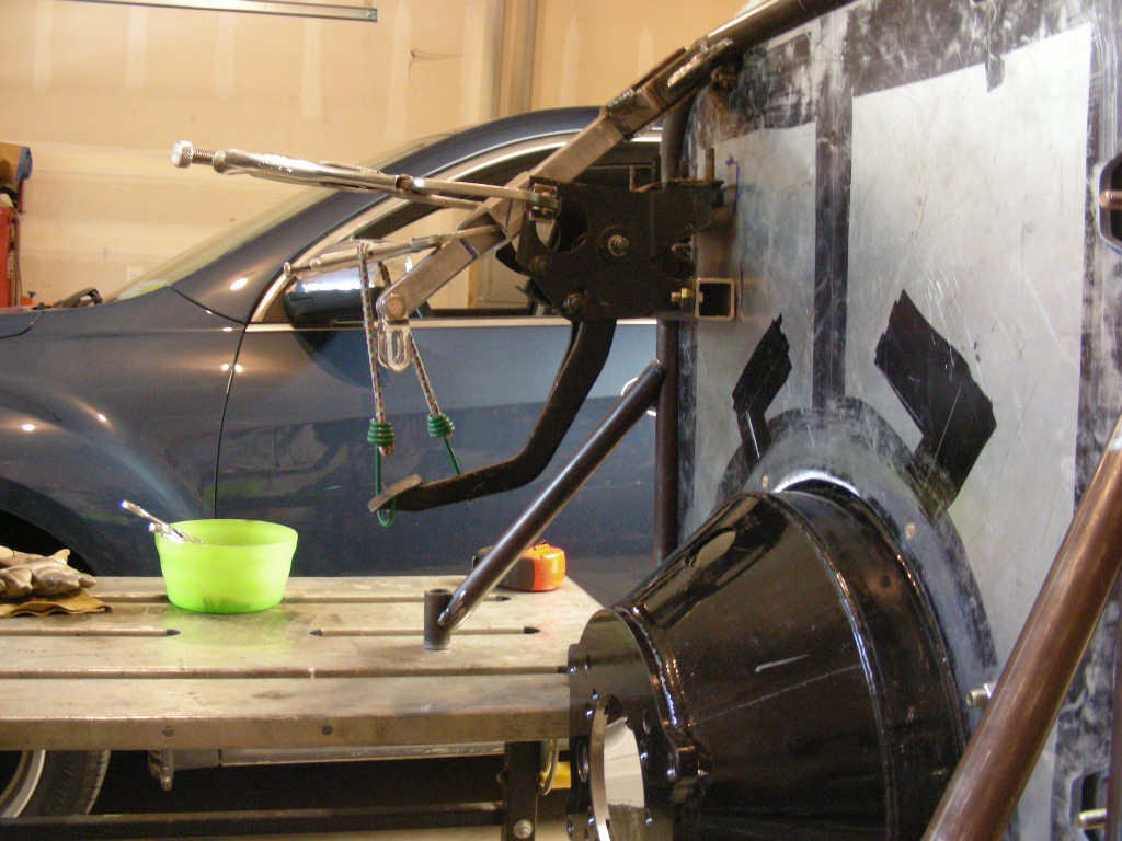

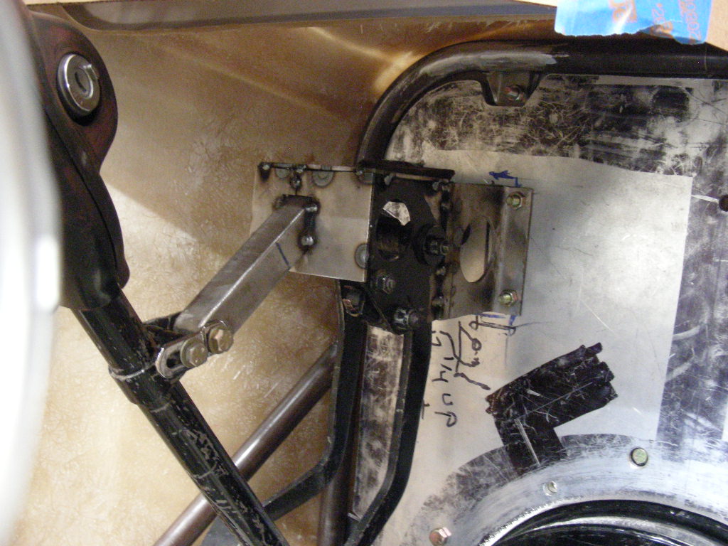

    A bit more progress today. Made the bracketry for the pedals and got them bolted to the inner firewall. Once I make all of the bits and pieces that will finish the firewall ***embly, it's going to be really stiff. Next is actuating mechanisms for the master cylinders. DSCN1508.JPG DSCN1507.JPG Tomorrow I'll redo the steering column support so it's not so ugly. Little steps add up.

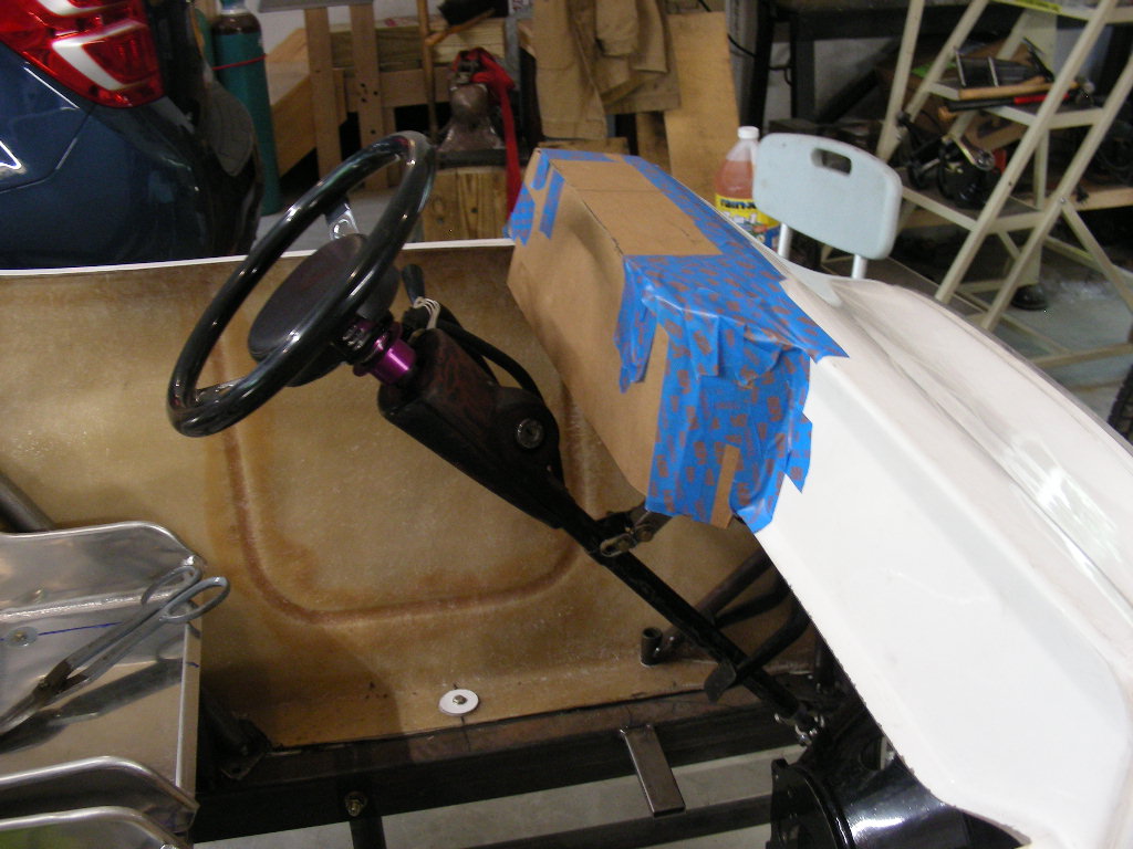

    Speaking of the pedals, here's where it stands today. DSCN1511.JPG Now I'm trying to figure out how to get the master cylinders in it somewhere. Which leads to the next 3 pictures:

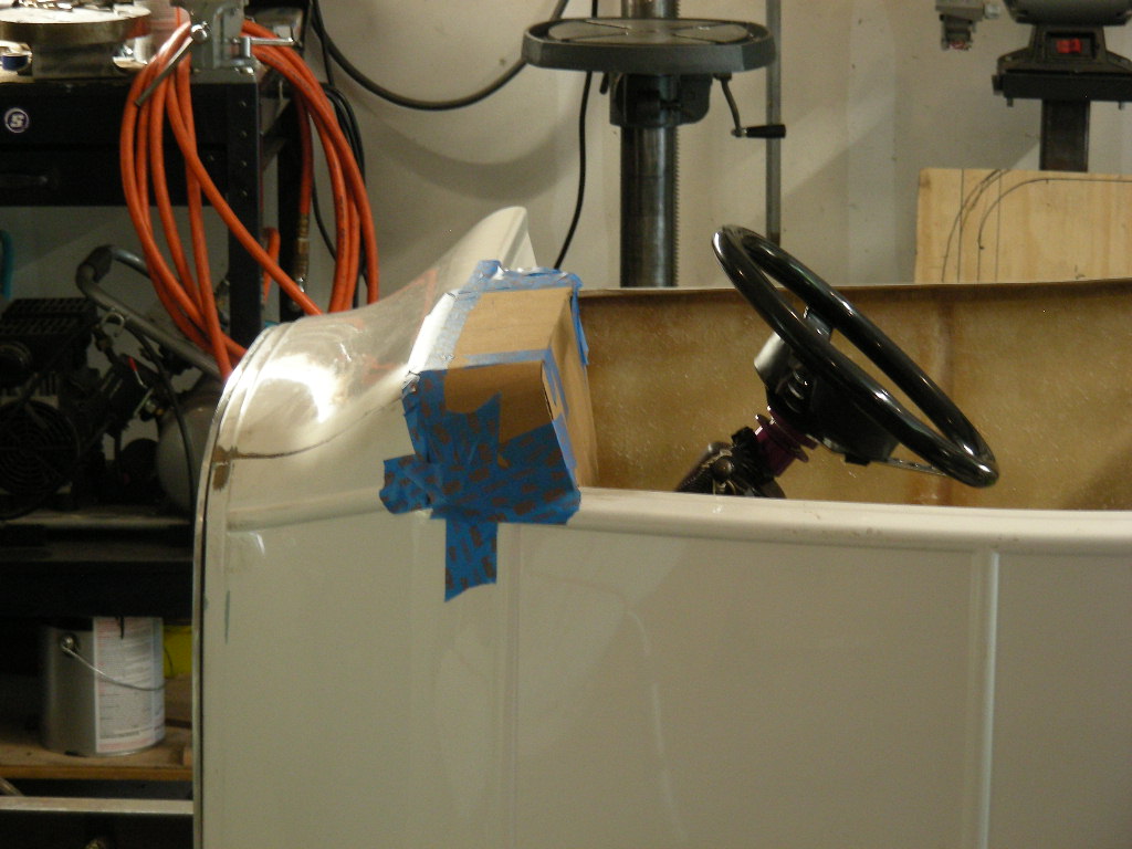

    DSCN1512.JPG DSCN1510.JPG DSCN1509.JPG I'm thinking that I can make an expanded dashboard thingy kind of like that ugly cardboard and painter's tape wart. It's only half length because I intend to make the p***enger door open. So this is a ripoff of what Marty did on the Spaulding roadster replica. I'm thinking that it can be made from fibergl*** and hinged at the original dash top for access to the master cylinders. And they will face the rear under the wart.
    I have a nephew, ratrodder, who has some experience with gl***ing, so he's on notice already for that when needed. I think that a plug to gl*** over can be made from Styrofoam board covered with packing tape so it doesn't melt.
    There's just so little room in a t. And I thought fitting a full rollcage in an Austin Mini was like building a ship in a bottle...

    Dave,
    I kinda like the lump for the M/Cs (and gauges?)
    Your nephew probably knows about foam that won't melt with polyester resin.
    I like your steering column mount, much cleaner.
    Keep at it.

    Yeah I hated that fugly thing before. And the lump should hide a lot of stuff that needs to be in the car, like you said gauges and the like.
    And I certainly hope he's up to it. I think he's in Maine right now, with his parents. It'll be a little while before I need it made,so he's got time to determine what we need to get...
