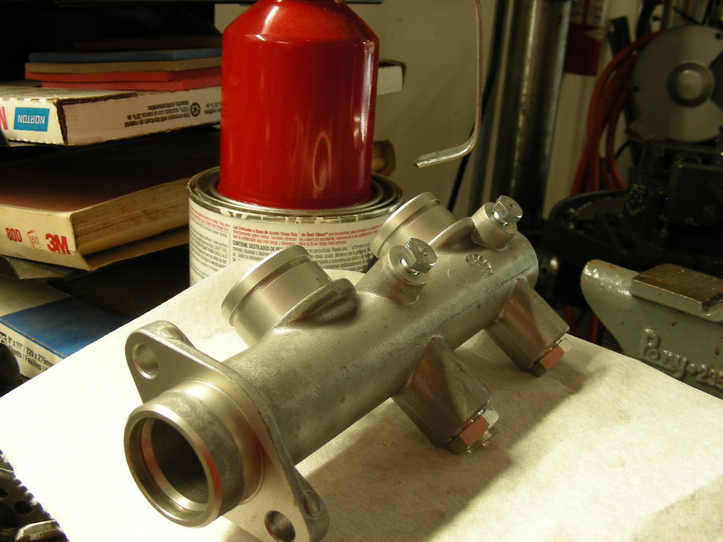

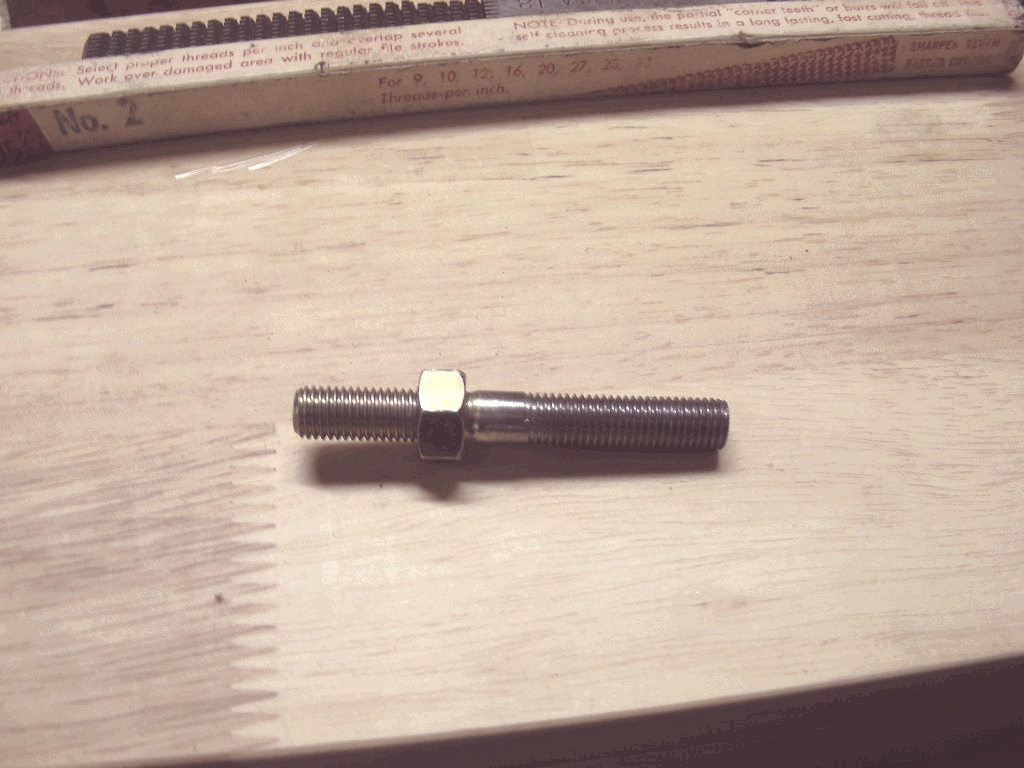

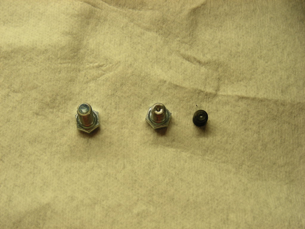

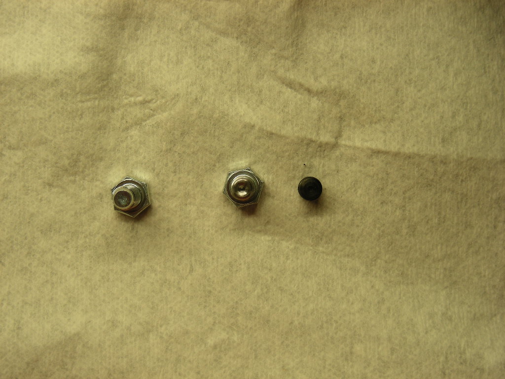

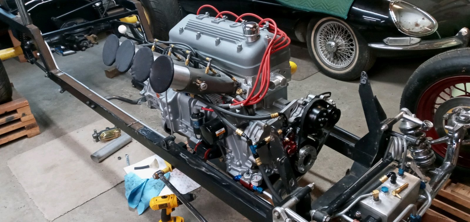

    Spent some quality time in the garage today on a lathe, making port plugs. Here's some pictures. DSCN1515.JPG DSCN1514.JPG DSCN1513.JPG Self explanatory. Here's a picture of the master cylinder with the plugs in. Now to re***emble it and mount it in the Whatever project! DSCN1518.JPG Amazing how much time a simple little project can consume...

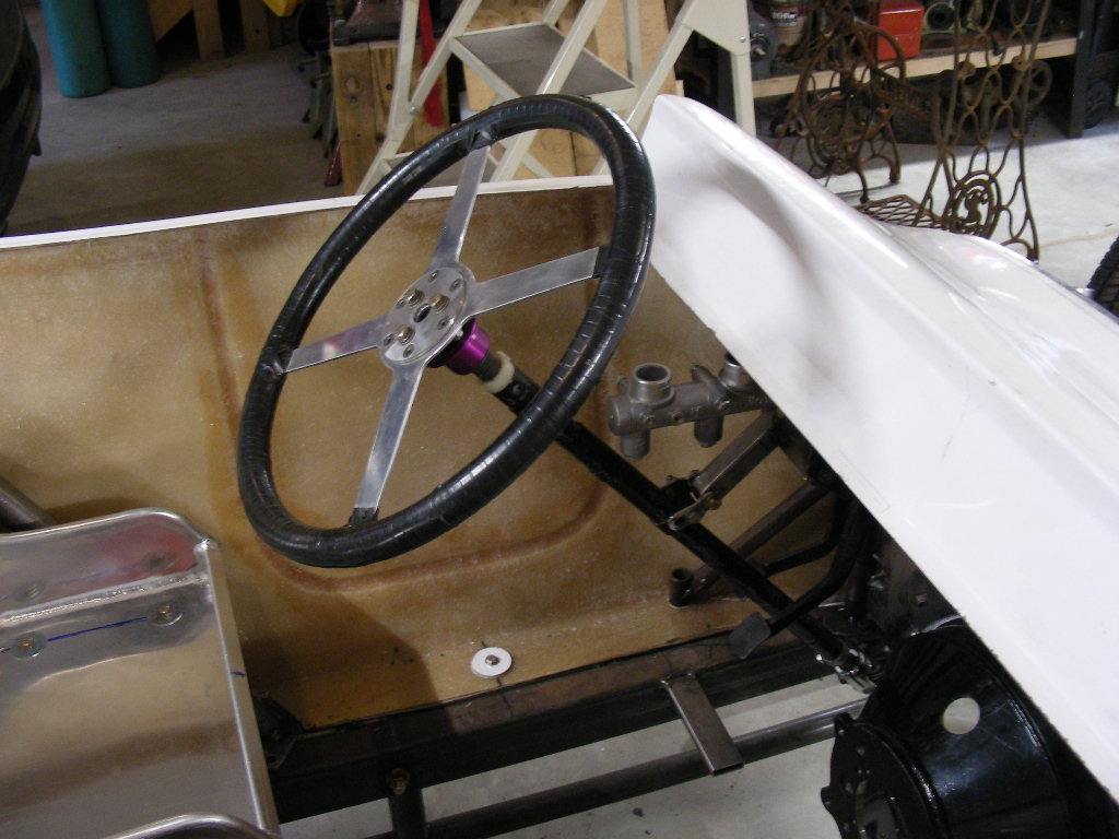

    I made a steering wheel decades ago from some aerospace alclad sheet, at the time considered unobtaneum. It was leftover from an experimental project at the research firm I worked for. Don't really remember what the core alloy is, just that it's really good stuff. Then clad in a very thin layer of pure aluminum on each side. It turns out that it's very good for corrosion protection.
    DSCN1519.JPG Just got it back. Long story so I won't get into it. Going to make a template from it and have a few blanks cut out by waterjet. Cut the original by hand using a jigsaw and vixen files. That was not fun...
    It's 17 inches in diameter and the grip is a section of tygon tube slit and taped to the flat rim section.
    Still struggling with the brake and clutch master cylinder linkages. Now I have to get some small diameter tubing for pull rods. And the fun continues...

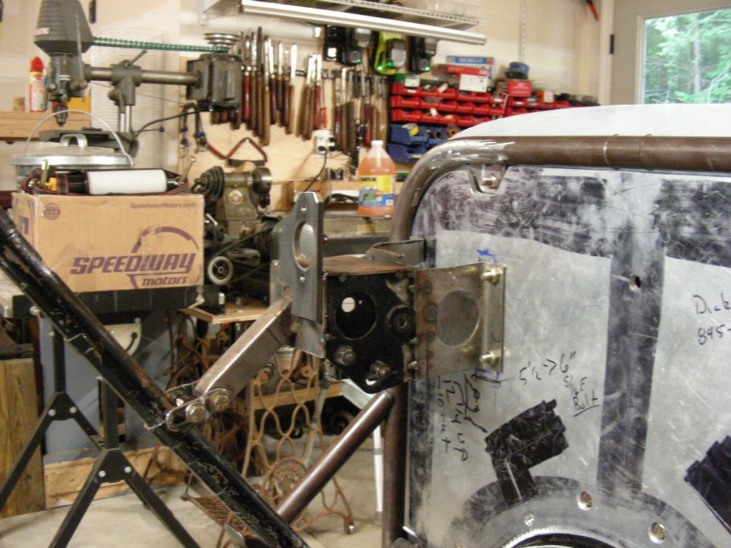

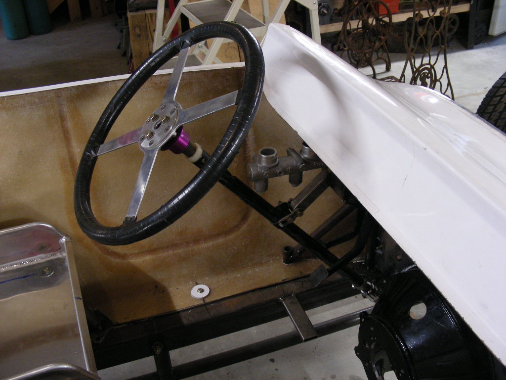

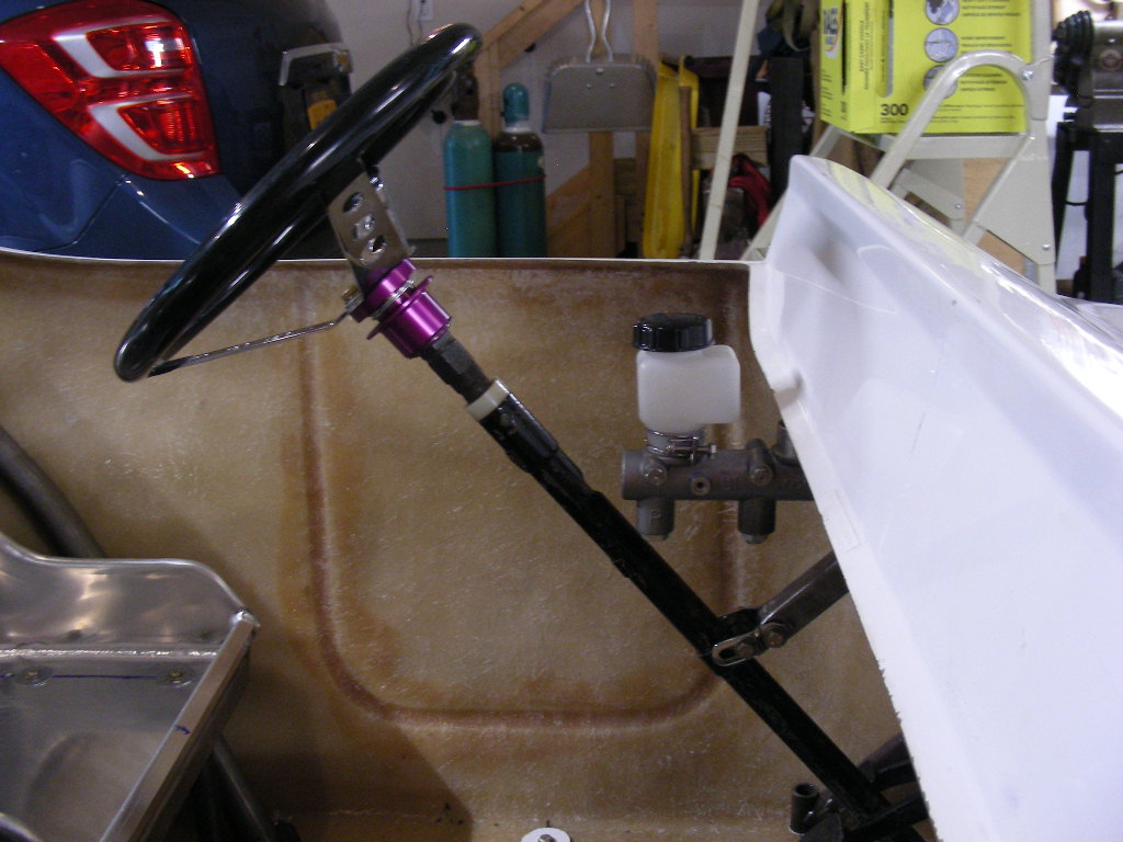

    You'd think I would have learned by now. Space is limited everywhere I would like to mount the master cylinders. Under the floor, up over the bellhousing, on the firewall...
    DSCN1436.JPG I don't really like the idea of mounting them out here. They'd be just to the right of the bolt kind of visible on the drivers side of the firewall with the tops of the reservoirs just below the hood line. That is, if there's room above the left cylinderhead. Got to put a dummy block and head in it to check. Fortunately I can mock up everything without the body, so I'll also be removing the body again!
    Opinion time: give me feedback on the options I see, and if someone has an alternative to those 3, please, please post it.

    I like the idea of mounting the MC under the cowl, at right angles to the pedal. That is what I plan to do with my Attic Anglia project.
    Similar to this

    Very interesting. That looks like it sets the pedal closer to the firewall as well. That could give a little more wiggle room for the toes...
    That and possibly mechanical linkage for the clutch.
    I guess tomorrow I'll make a mock up and see if that could be a solution. Thanks

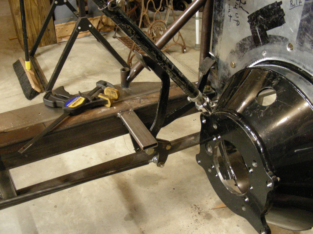

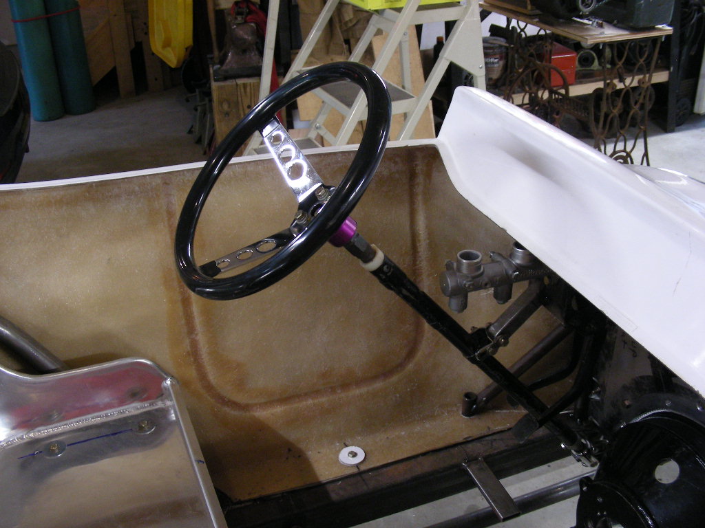

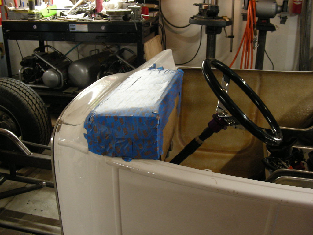

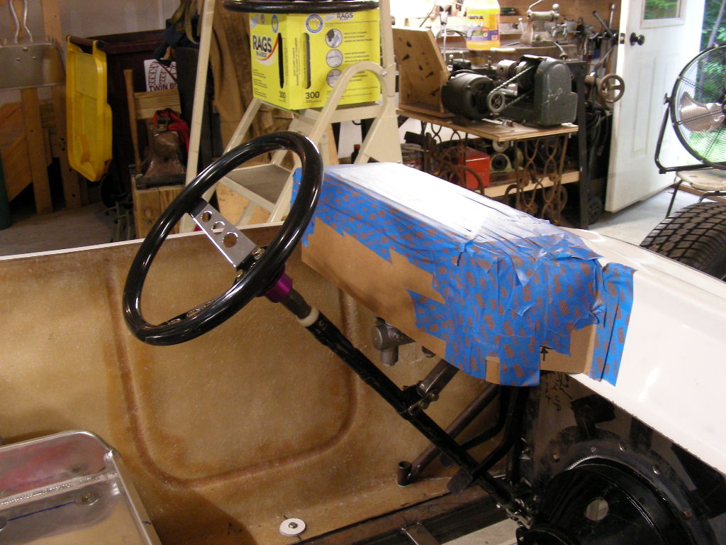

    Back allowed back in the garage today! Worked on the pedals and master cylinder mountings. DSCN1521.JPG That's the brake master, and if it survives the cut and HAMB opinions, that bracket will be fully welded and gussetted to minimize flex. Here it is back in the whatever. DSCN1523.JPG DSCN1522.JPG I really like my old hand made 17 inch diameter steering wheel, but unfortunately it ain't gonna work! My stubby legs don't clear it withthecurrent length steering column.
    And unfortunately the Mini electricals and steering column shroud doesn't clear the master. So it's off! I can probably use the turn signal switch, if I make my own small shroud around it. But the old shroud and ignition switch is Outta Here!
    So here it is with the 13 inch deep dish wheel again, for now. DSCN1524.JPG And seeing as how the master sticks past the Speedway dash, I guess I'm going to be making a half cowl extension: DSCN1527.JPG DSCN1526.JPG DSCN1525.JPG Yeah I'm still not very good at inserting multiple pictures at once and getting them in some semblance of order that makes sense. The last picture shows where the reservoir will be. Hence the ugly lump mockup is back on the whatever. Tomorrow I am going to get out some pink insulation board and cut and shape it MUCH better. We'll see what that looks like...
    I'm expecting a bunch of s****. Anyone want to place bets on how many attempts?
    Just looked at the pictures myself, and realized I didn't discuss the master push rod. When the pedal is adjusted correctly, it moves thru the full 1.1 inches of travel of the Wilwood master, and midstroke it is perfectly straight to the bore. The effective pedal ratio is just under 6:1. The cylinder is a 1 inch bore master, for an effective area of 0.7854 sq. in.
    So ***uming I can generate 100 pounds of force on the pedal, there will be 600 pounds force on the master. With the size of the master, 1 inch or 0.7854 sq. in., that gives 764 psi give or take a psi. I'm using calipers with 2.5 inch pistons to start on the front, slightly smaller on the rear due to the internal emergency brake mechanism, and that gives about 3750 pounds clamping force at the calipers, slightly less on the rears.
    That should woa up a sub 2000 pound track roadster type car. Some day in the future if I get crazy, and locate some Buick drums, I should still have enough pressure given the wide variations of available wheel cylinder bore sizes that can be made to work. And that takes me back to MY dirt track days, messing with wheel cylinder sizes to affect the response at individual wheels to affect handling. But enough of that for now. First get it running with what I got!

    Can you turn the cylinder 90 degrees and hide it under the dash, rather than create a bumpout? Throw in a bell crank or two or sumpthin?

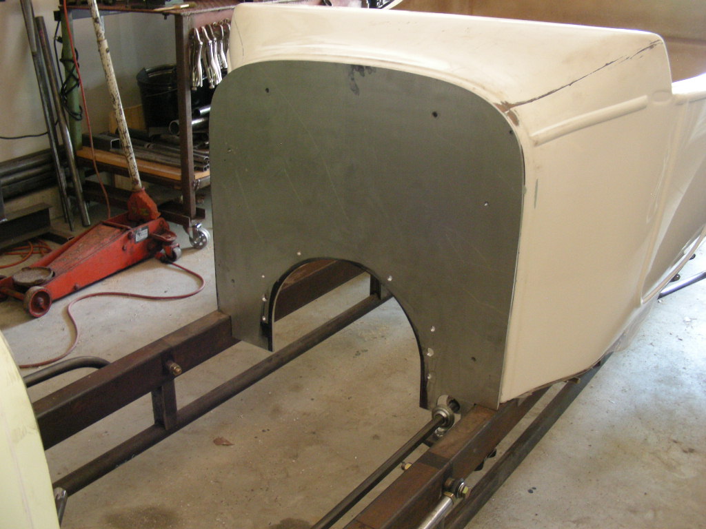

    Yeah I hate the lump! I took it apart today, to remove the body. I'll bolt the cowl support hoop and the firewall ***embly back on after getting it up on jack stands.
    I'm going to take another look at putting the cylinders under the floor and using a bell crank ***embly. Getting the body out of the way and getting it up on jack stands will make it easier to crawl around under the ch***is to figure out how to make it all fit and work.
    Fortunately the firewall ***embly fits the same with or without the body, and I can determine foot clearance as the diagonal braces actually limit foot room. Now if I can figure out how to brace a bell crank shaft...
    More tomorrow and pictures!

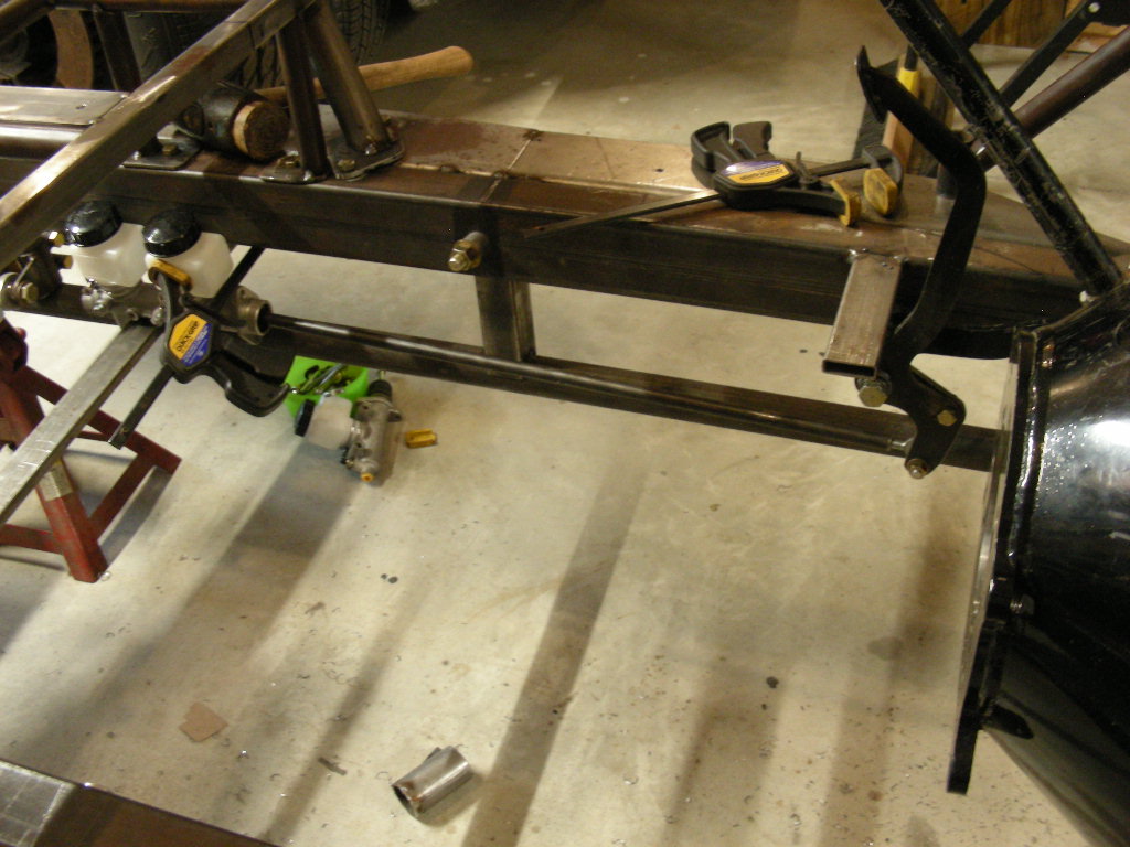

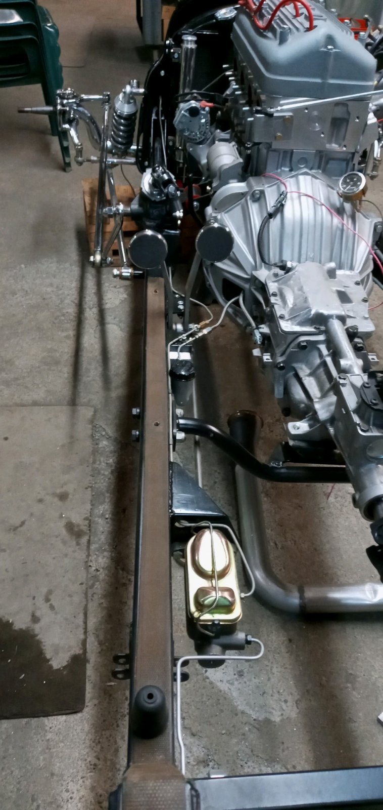

    DSCN1534.JPG Remember the pedals and master cylinder hanging here? I just couldn't make it work and look like something that doesn't look like an afterthought. So it's out of here! The pedals are back under the floor in the mount previously installed.
    DSCN1533.JPG Here's the 2 pedals and a first attempt at the push rod to the brake master cylinder.
    DSCN1532.JPG Here's the master cylinder mocked up under the floor way back under the seats. It looks like a good place for the master cylinders, and the push rod arcs thru the range of travel will be minimized by the length of the push rod.
    So next step is to fabricate a mounting bracket for the master cylinders and a crossmember to tie it into for support. 1 step forward, 1 1/2 steps back...
    Oh, and I get to fabricate a mounting bracket for the steering column AGAIN! 3rd times a charm!

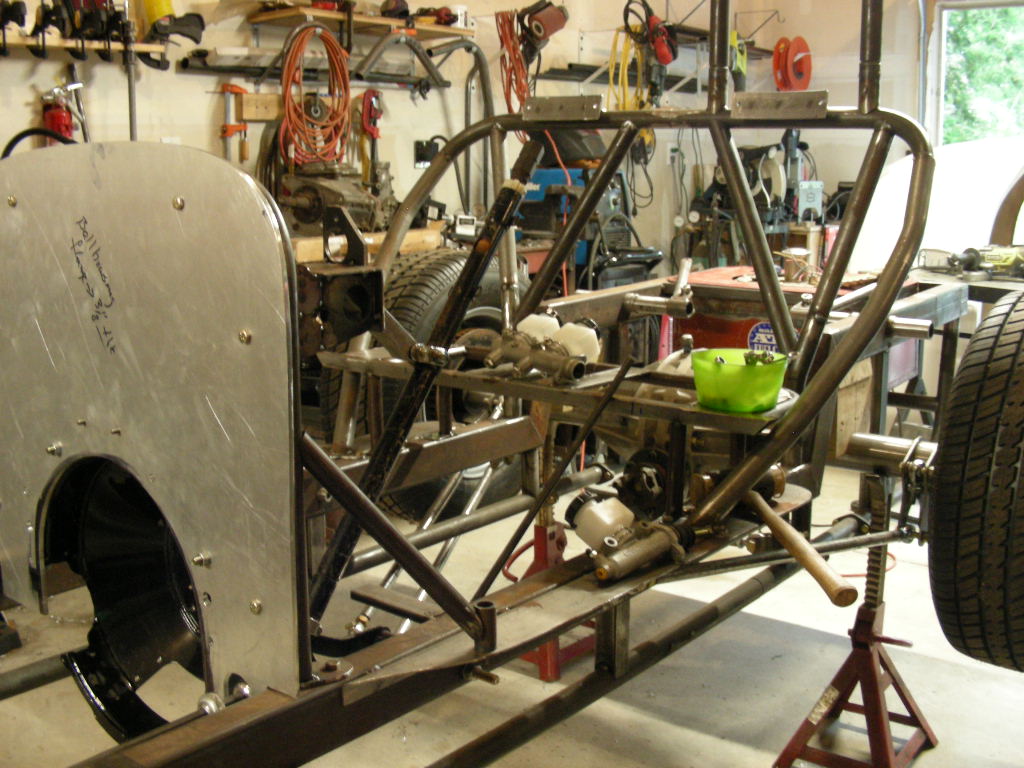

  19. Flatrod17
    Joined: Apr 25, 2017
    Posts: 844
    Flatrod17

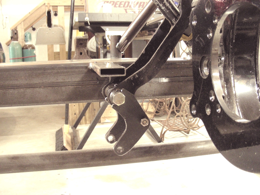

    Hi Dave, I know you have a plan but thought I would show a pic of how I did my pedals. I was thinking you could do this with a few bell cranks and keep your hanging pedals. frame brakes.jpg

  20. Dave G in Gansevoort
    Joined: Mar 28, 2019
    Posts: 4,277
    from Upstate NY
    Actually I'm really glad you posted the picture. Where you are is where I'm going. And seeing it in iron and steel shows that it should work. Regardless of the pedals hanging or sticking up, it still only has so much room where the pedal pads actually end up, for me to be able to get my wiiiide feet on them.
    Looking at the picture, I can't see why it won't work for me. As I have a lot of vertical space between the 2x3 rails and the 1 1/2 bottom tubes I should be able to make a bracket for the master cylinders like you did, and I might be able to make it hold the cylinders side by side.

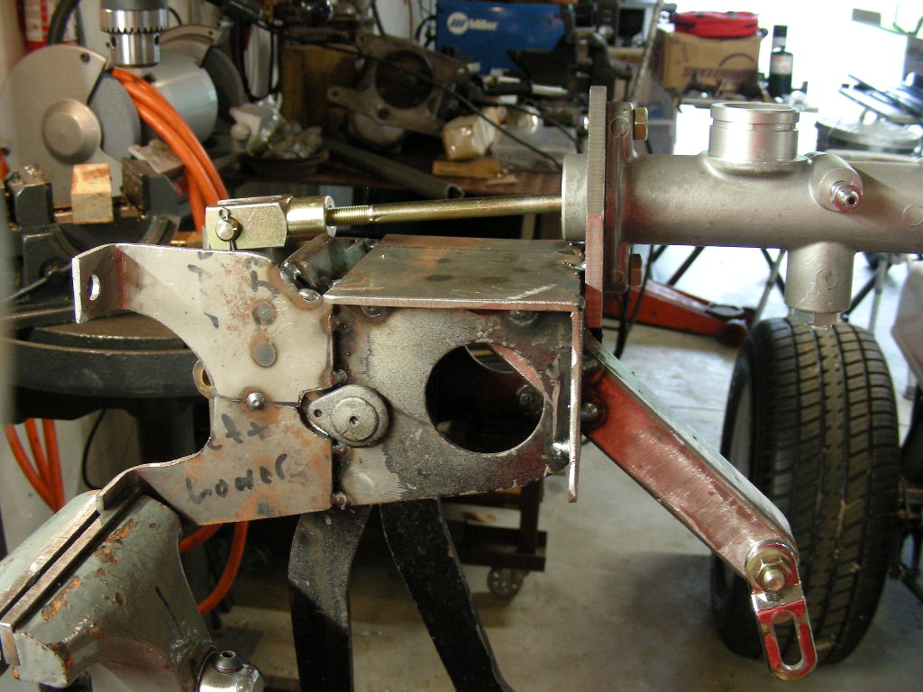

    Not yet. It's on my to-do list... Still working on the pedals and master cylinders. 20220824_185714.jpg 20220824_185532.jpg 20220824_185518.jpg Top picture shows the pedals and the extension on each to get the ratio and angles where I think I want them. We'll just have to wait and see. I can remake the extensions if need be once the master cylinders are mounted. They're going under the seats.
    2nd picture shows the push rod with the adjuster and clevis. It's so nice using sharp cutting tools. New left hand dies to make the adjuster. That's the 3rd picture.

    Made the bracketry for the master cylinders today and basically just plaigerized your setup. Cut out a bracket for both of the master cylinders, a couple of 3-4-5 gussets, and got it tacked mostly together and roughly positioned. Your picture was a really good inspiration...
    I'll have more tomorrow when I get it all tacked into place and the push rods cut to length, well initial length. There may be some fettling to do still to get my feet to fit on them and make them work. I suppose I should start thinking about the floor and gas pedal as well. And make a final decision on the steering column support that needs to be redone AGAIN!
