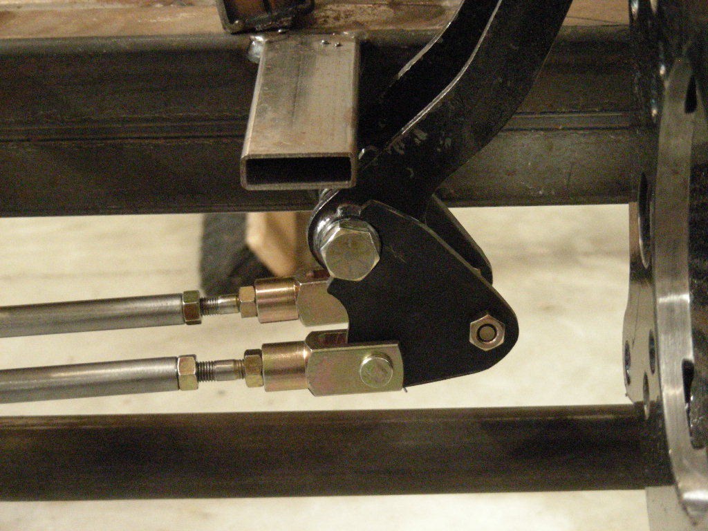

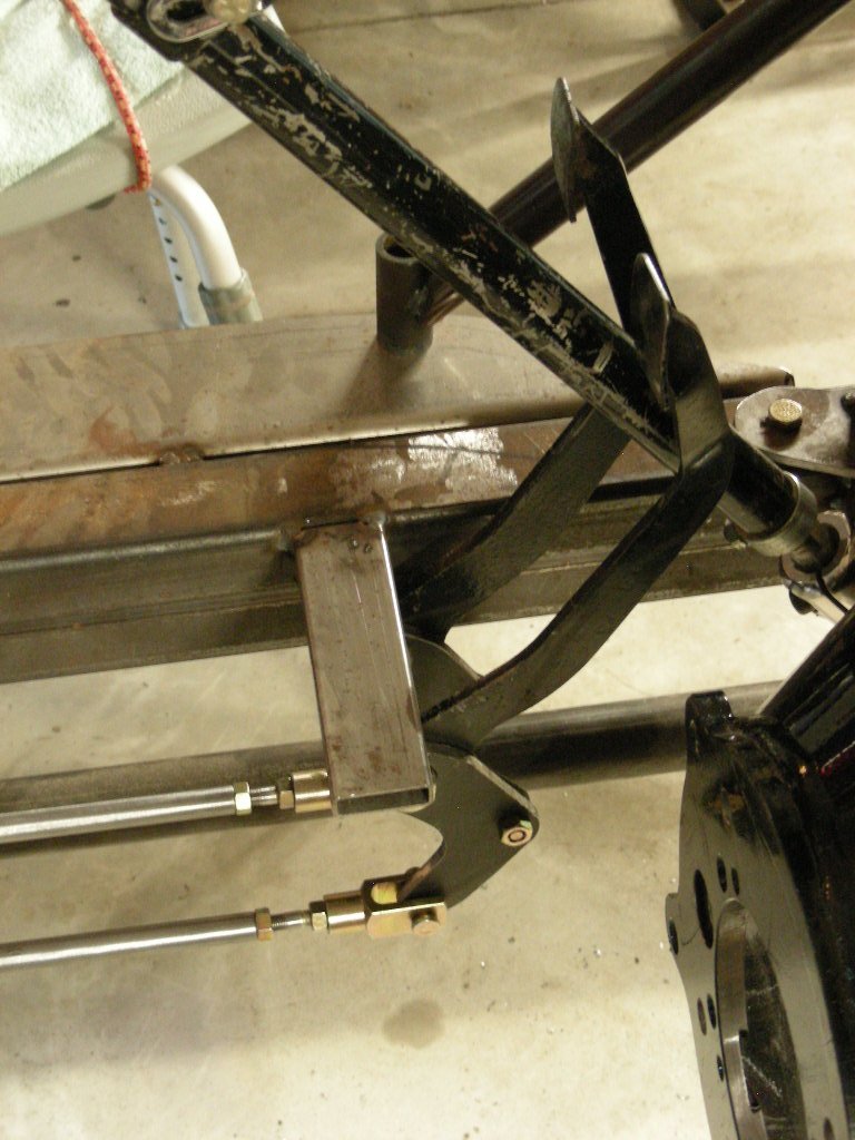

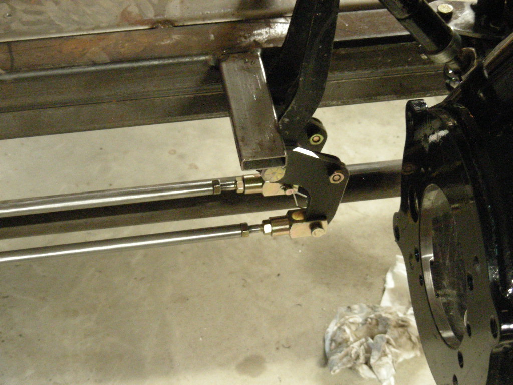

    I did it! And my feet fit on the pedals! 20220826_172055.jpg 20220826_172025.jpg 20220826_171927.jpg From the top: 1st picture from the right side, pedals hooked up.
    2nd picture, master cylinders and bracketry tacked into place. Once I get to final welding, I'll add a tube to give more support.
    3rd picture, from the left, I need to bend the clutch pedal slightly to the left and add a dead pedal to the angled brace. And I get to fabricate a mounting bracket for the steering column, AGAIN! That current setup doesn't stay as it's fugly seeing as how it won't be holding the pedals and master cylinders.

    Okay! Thanks Marty for the inspiration 2 step. We're both glad you posted pictures of your setup! I've got better pictures now. Did some editing so I'll post them w/o explanation.
    So there's a better look at the pedals and master cylinders. It took some time and a community to get to this point. Now I can move on...
    Framework, floor, steering column support, battery box, and so much more.

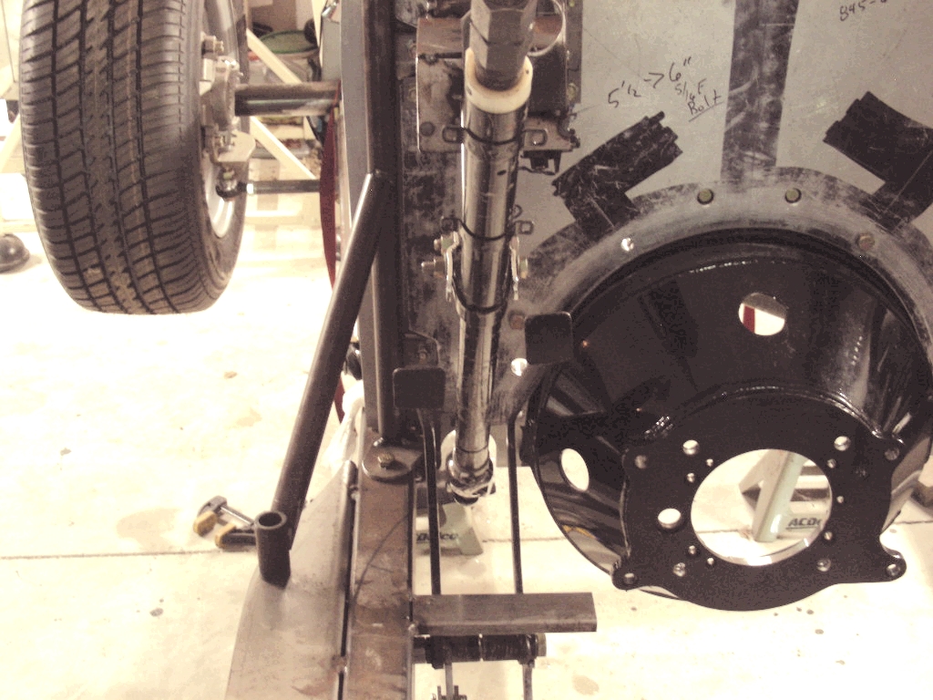

    Got the new steering column support fabricated. And the old pedal/steering column support out. No pictures today because of a migraine onset. Pictures tomorrow...

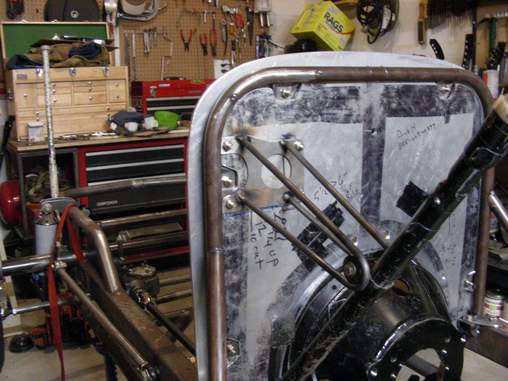

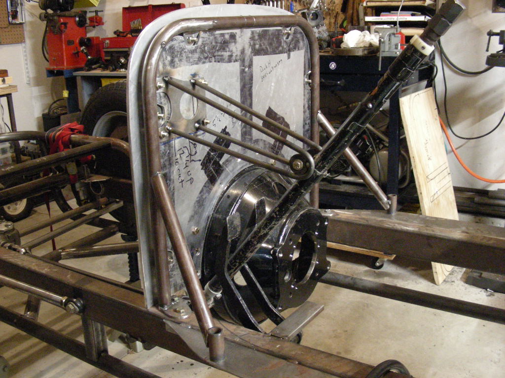

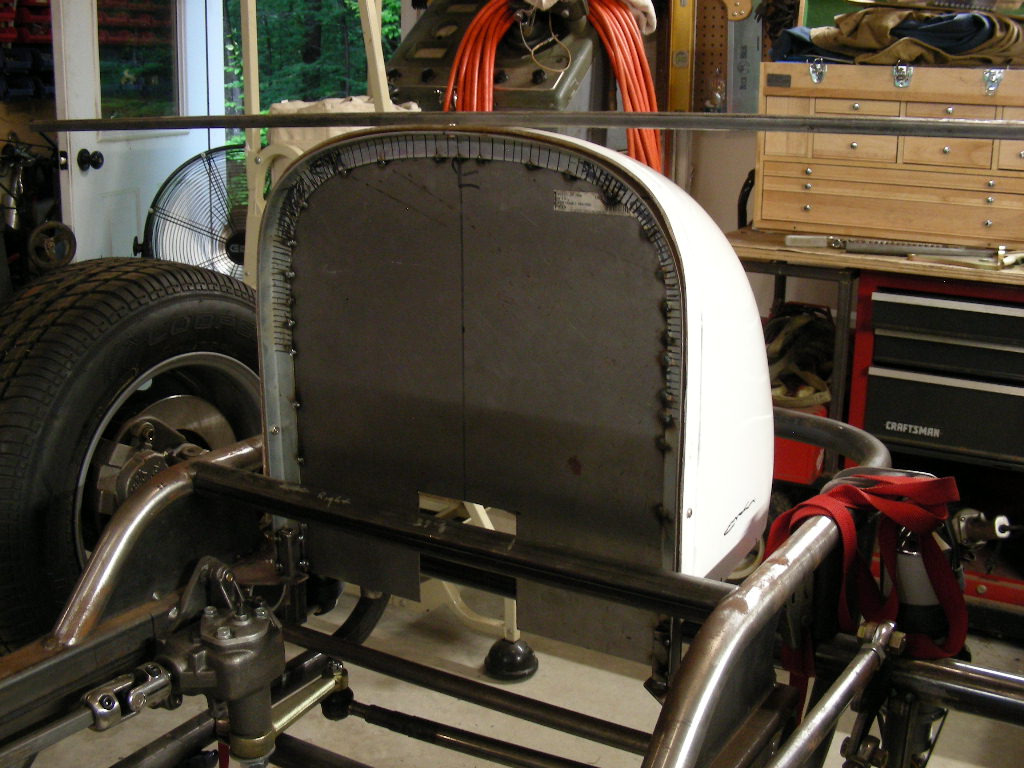

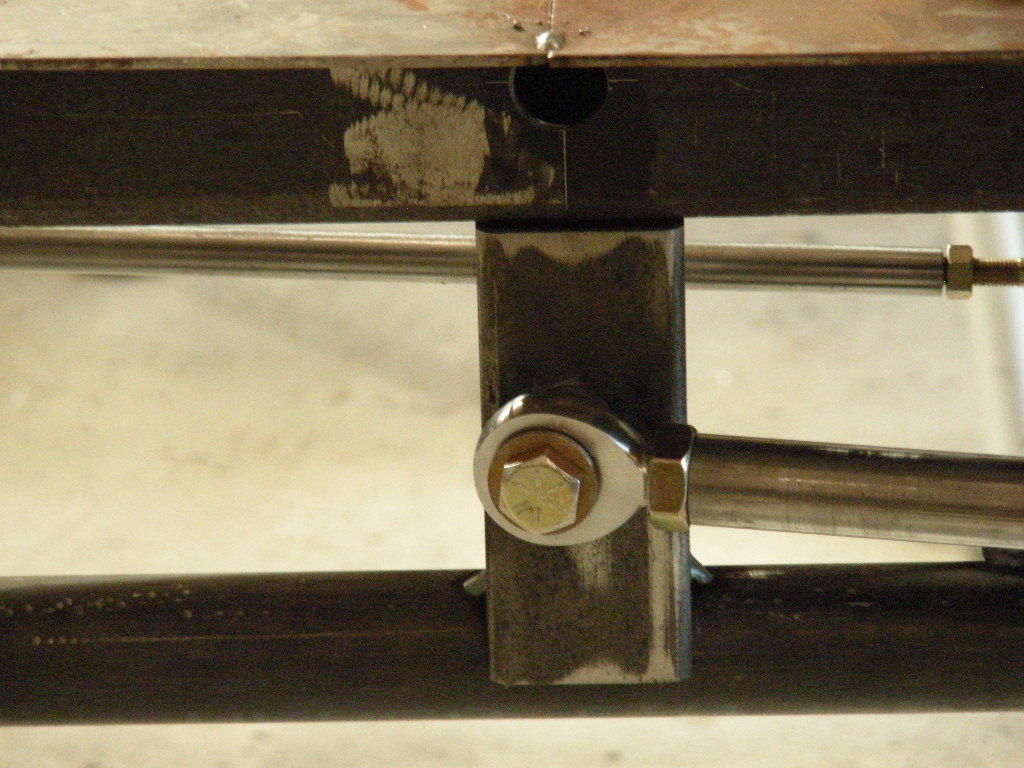

    Just a couple of pictures of the new steering column support. Hopefully it's the last iteration... DSCN1553.JPG DSCN1552.JPG And it even uses the bolts that held the previous ***embly in...

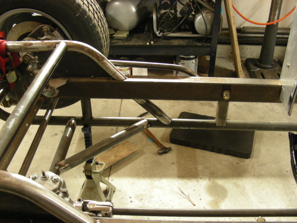

    Study this picture. It's going to change. DSCN1541.JPG Measured the pedals for dimensions and in this configuration I have an effective ratio of just under 4:1. So it's a good thing I haven't welded the lower arm extensions on yet. So I have sketched out 2 new extensions and will be cutting them out tomorrow or Saturday. Oh well, doesn't matter. Only fall off again anyway...
    patmanta likes this.

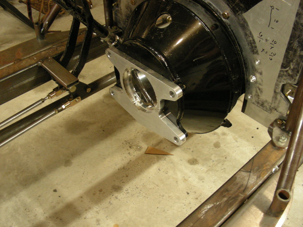

    Remember yesterday's episode and the picture above? Well, here's today's progress in pictures: DSCN1557.JPG Remade the extensions and ended up with 6:1 pedal ratios. Still not going to weld them on yet, just in case...
    Here's the rest of the pictures of today's efforts:

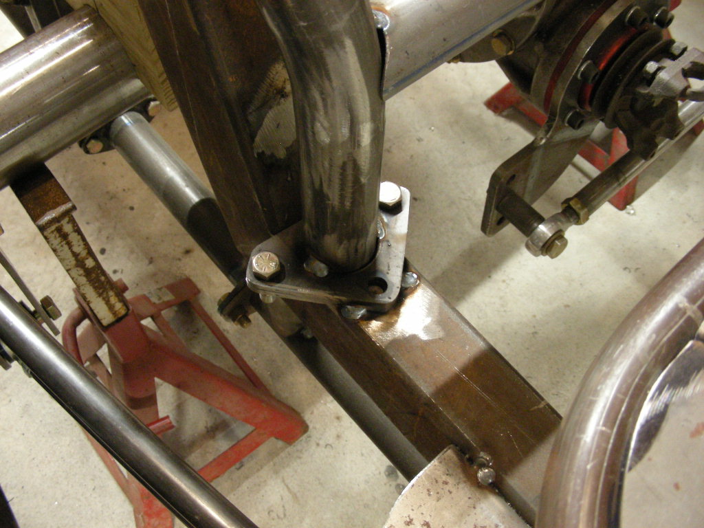

    DSCN1555.JPG DSCN1559.JPG 2nd picture shows the new front mount for the rear suspension. Look closely and you can see the old hole in the frame rail above it.
    The last picture shows the new mount for the roll bar support hoop to the frame rails. So nothing exciting, just little stuff that needs to be done...

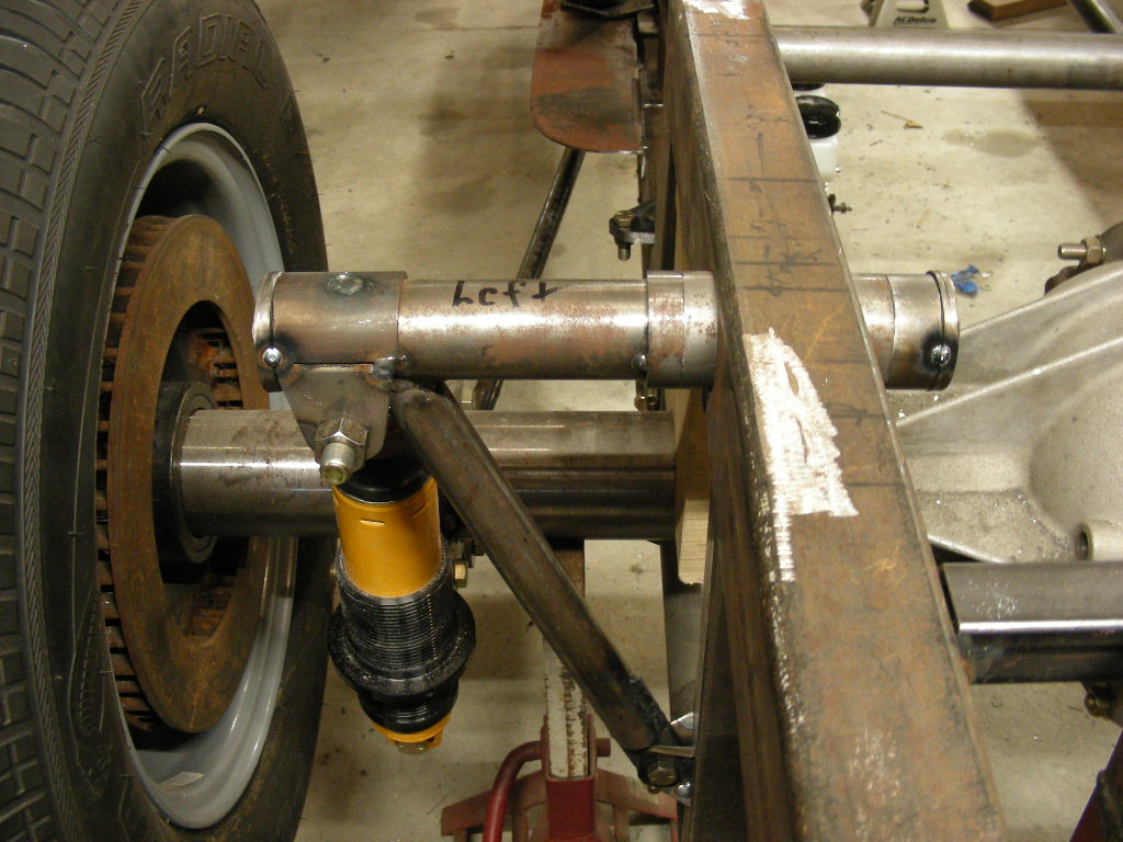

    New blade in the bandsaw and finished the project started Friday. And checked out rear suspension clearance at full bump. Both sides clear with an inch to spare at the Marty Strode Body Mount Method plates.
    Made a pair of retainers for the rear suspension ch***is mount brackets. Just need to do some welding tomorrow and I'll post a picture or two of the stuff.

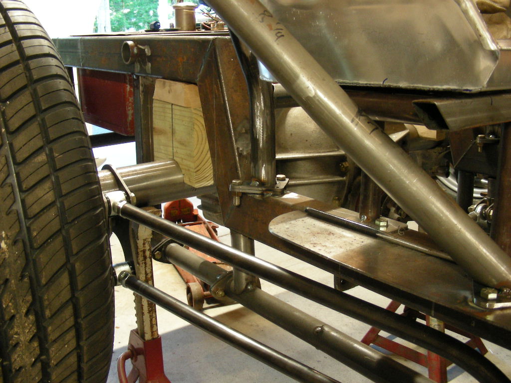

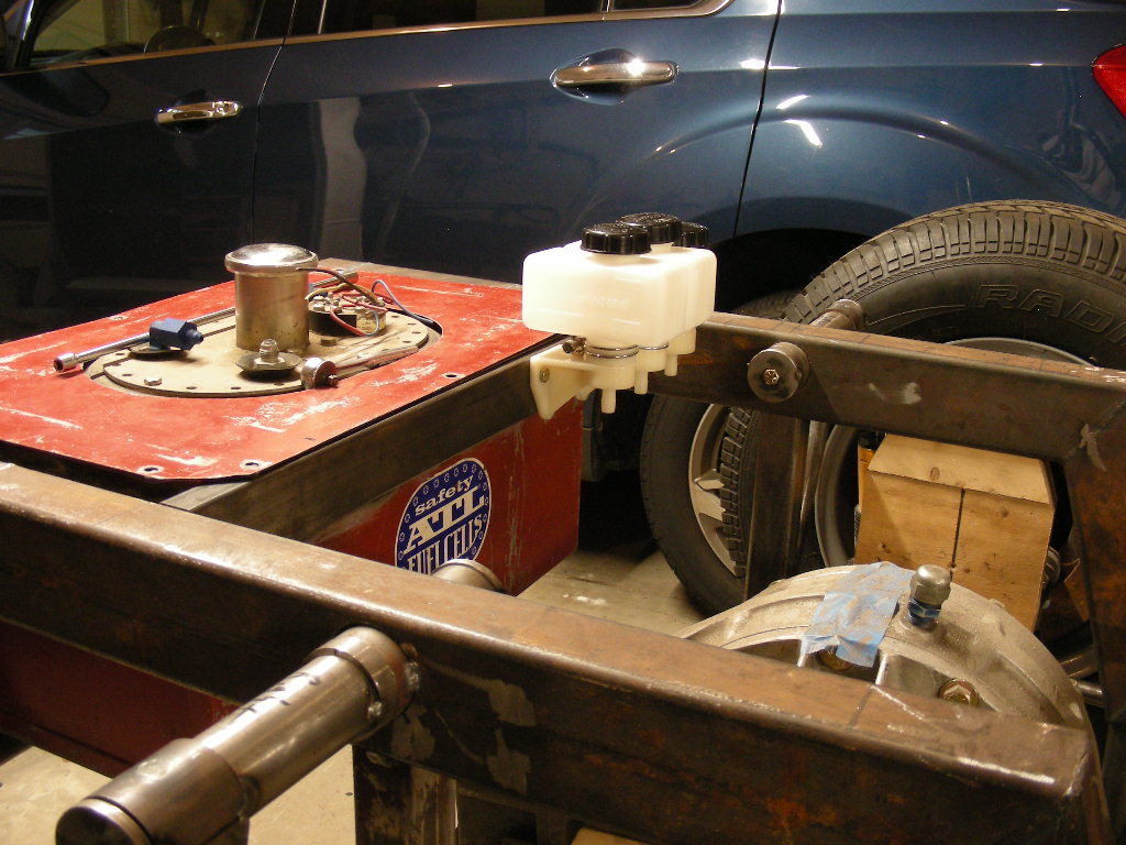

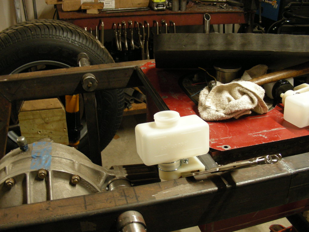

    Got a little bit done today. Pictures included.
    DSCN1561.JPG Got the shock stand cut to length and figured out a fastening method. When finished there will be a half inch bolt in place of the small ones currently used to fabricate the system. Still a lot of finish welding to do.
    DSCN1564.JPG Here's the roll bar support hoop mounts that replaced the 1st setup.
    DSCN1563.JPG I found a place for the master cylinder reservoirs. They're close enough to the master cylinders and above them. Also it will be easy to get to them under the deck lid of the turtle deck.

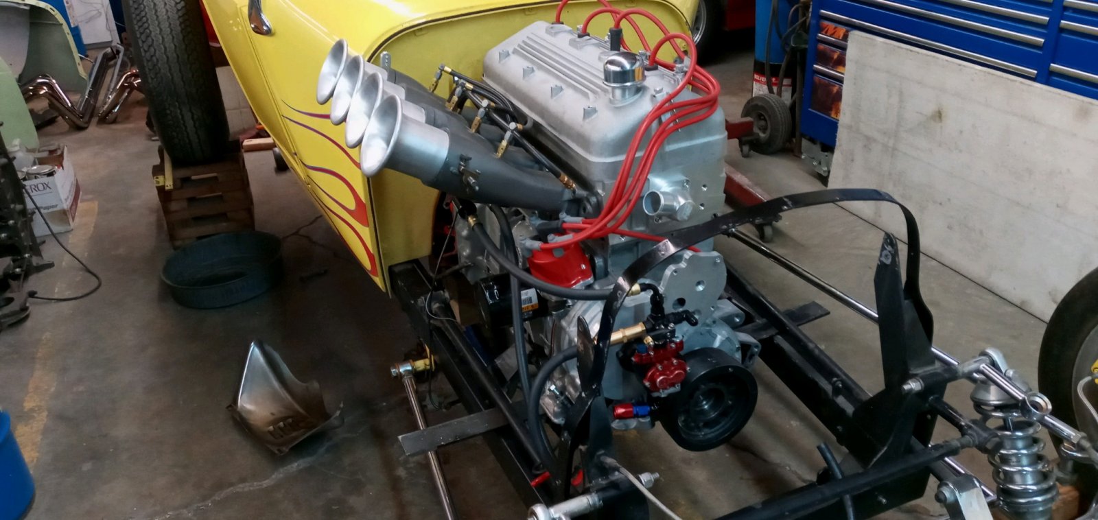

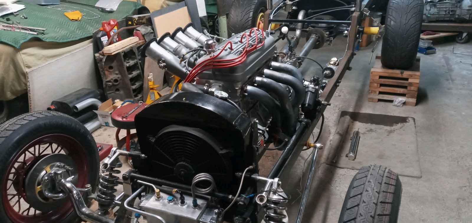

    Dave, here is a couple pics of my car radiator mounts. It is about the same size as yours. Maybe help mounting yours? Its pinched in at the bottom and just a 1/4 bolt at the top on each side. The band is for holding the nose on. 20210731_21082200.jpg blackengine.jpg
    Okie Pete likes this.

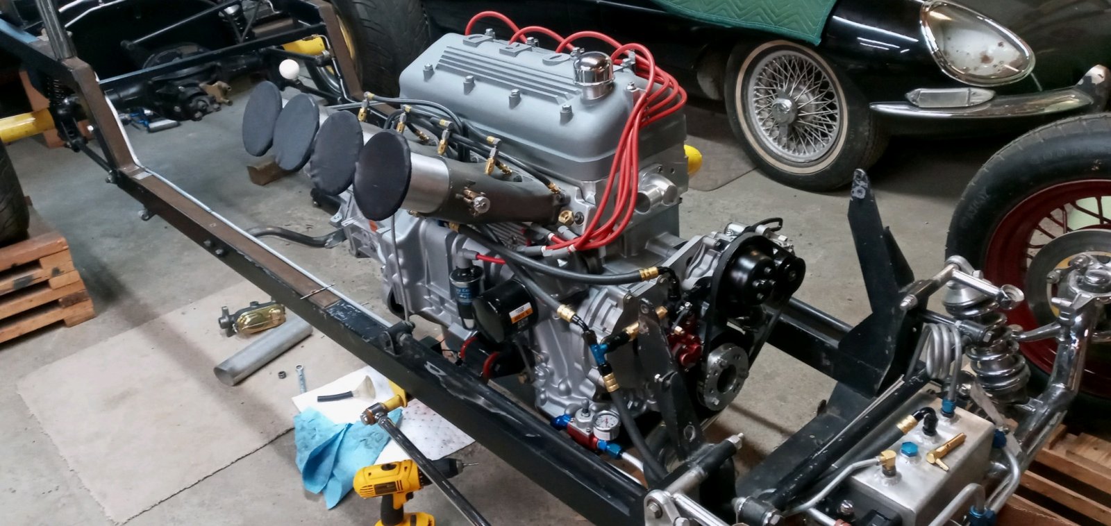

    enginetuning.jpg Here's another pic I found, it shows the upper mounts holes and the little tabs, if you look hard, that pinch it in at the bottom. engine2.jpg
