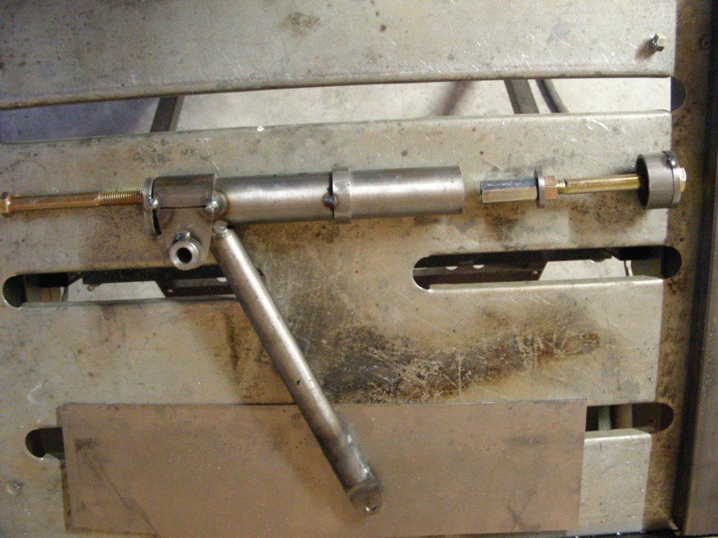

    Another good day in the garage. Went to the local hardware store that has everything under the sun, and got a length of 1/8×1 cold rolled steel and some 1/2-13 gd 8 bolts and coupling nuts.
    DSCN1577.JPG Replaced this
    DSCN1583.JPG With this. Looks better, a lot lighter, and made a lot more room for a radiator. Still a lot of work to do before it's finished, but I'm going to talk to a radiator shop first and get an opinion on shape and capacity of a suitable radiator. Then the radiator support and the nose support can be integrated into one part. I hope...

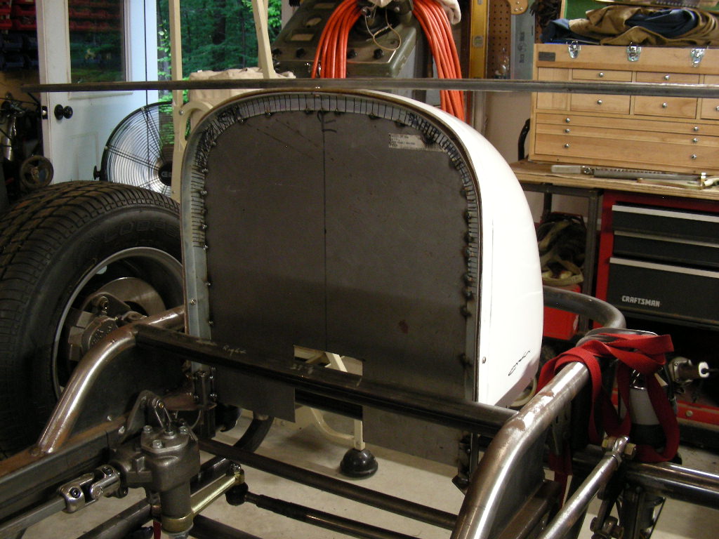

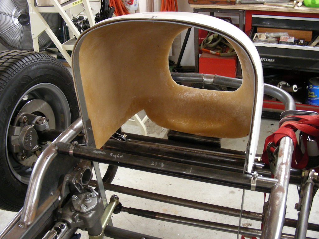

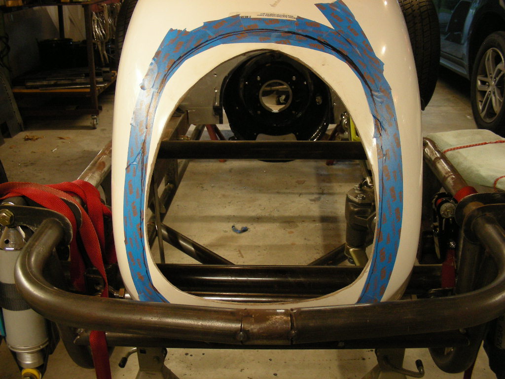

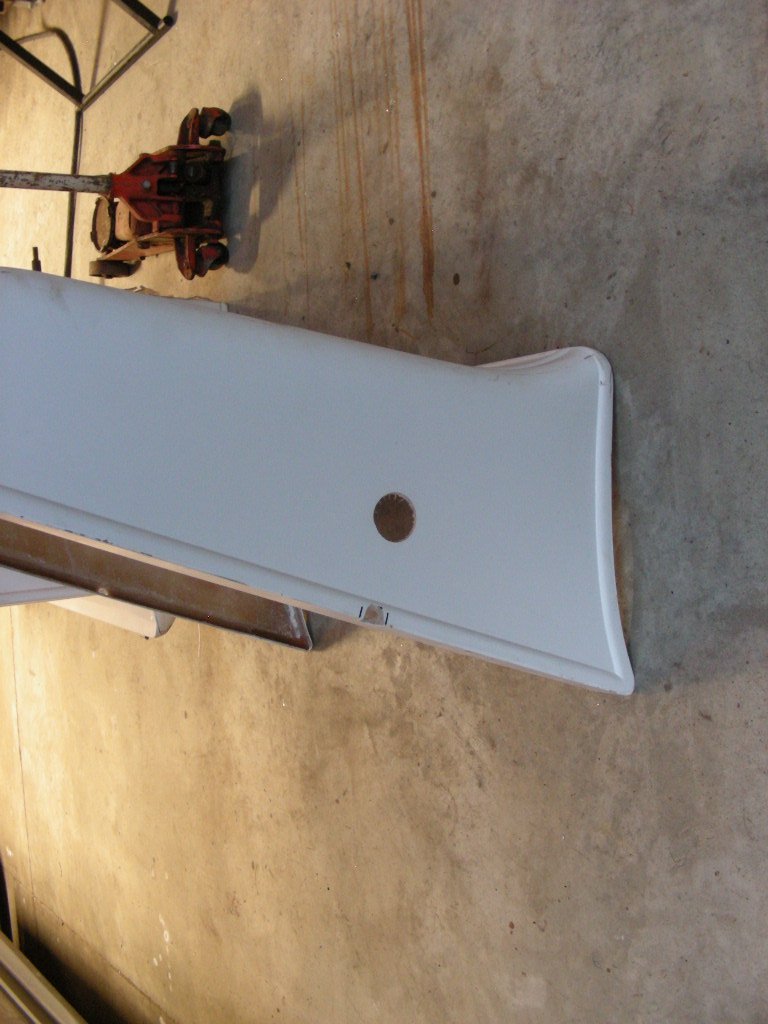

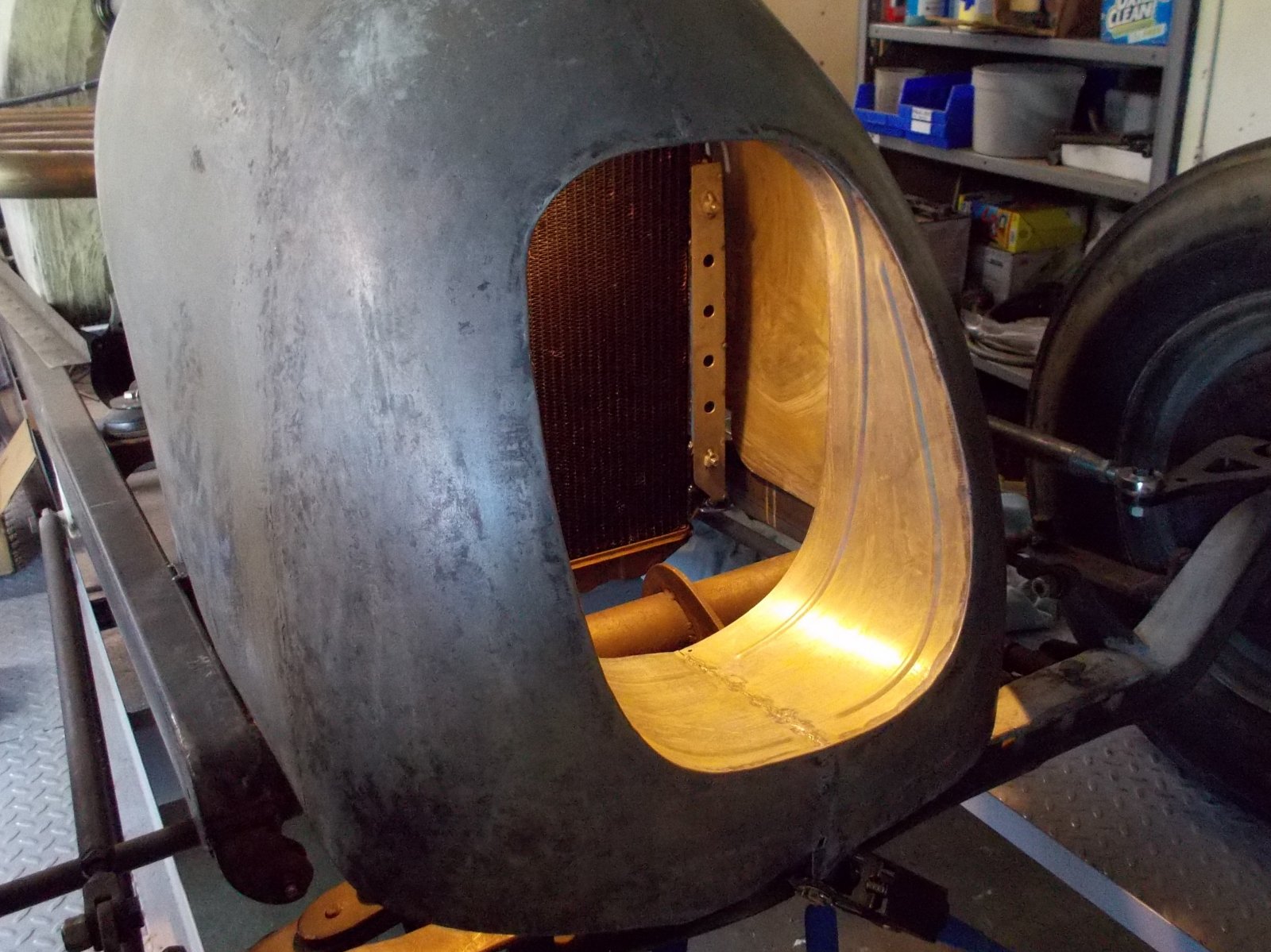

    DSCN1575.JPG And while writing about the nose, I am thinking about the future grill and opening. If you look at the picture closely you can see that I Sharpied an outline on the painter's tape. An aside: I know the tape is blue but that's the end of the spectrum that's mostly gray to me. Having an issue at the violet-blue end of the spectrum makes wiring with color coded wires interesting to say the least. Back to the nose. That's my first attempt to redefine the opening. I need to get some thin flexible tape and lay it out a little bit better. Moving on...

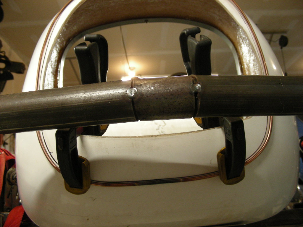

    DSCN1578.JPG So remember a ways back I agonized over cutting holes, slots, etc, into my brand new Speedway body? And I also way overthought the rear coilover mounts? Well here's what I came up with:

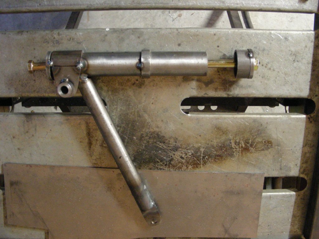

    DSCN1582.JPG The horizontal tube goes thru the hole in the turtle deck and is kept from rotating by the diagonal brace. I went thru many iterations of concepts to hold the tube in the frame. Here's what I did:
    DSCN1580.JPG And another view:
    DSCN1581.JPG And installed in the frame, mostly:
    DSCN1582.JPG So some things are more firmly designed. Will there be chanes?

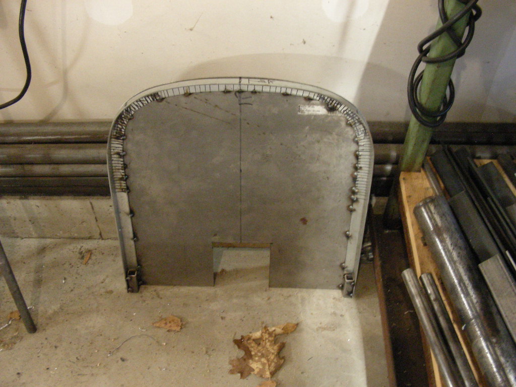

    Do you need a lock-nut or lock-washer or something similar to keep the two bolts from vibrating loose?
    For the front radiator opening, I'd suggest using stiff cardboard, poster board, or something similar to cut out different sizes/shapes that you can tape in place before you make any cuts in the fibergl***. And when you do cut it, if you are careful with your cuts you may be able to save most of the rolled lip, which we can graft back on once the opening is enlarged. We can also use the rolled profile to match to with the new 'gl***. Maybe a piece of thin wall tubing to hold the lip's radius? I'm sure others have dealt with this issue already, just spitballing here...

    Eventually, when final ***embly happens (you know, the one that you'll be helping on...), there will be lots of fasteners with locking media coming into play. These bolts may get lock wired. I also like a relatively new system of 2 interlocking washers, that I don't remember off the top of my head the name of, that I'm planning on using in places like that. I have samples in my desk, but it's downstairs and I'm just lazy and don't feel like getting them to get the name.
    There's no lip around the front opening on the nose, so again we get to figure it out ourselves (hint, hint). And im messing around with some of the hardware cloth to get the shape and depth of the grill and it's shape. I guess I'll be learning how to make compound curves in some kind of material to make a grill from. Rocco has done this before so my next trip to his shop will include taking the nose. And then figure out an opening layout...
    But first, I have to get a radiator, and make more x-members, and figure out a floor, and finish the firewall, and mount a battery, and, ... good thing I'm retired and can spend time with it most every day.

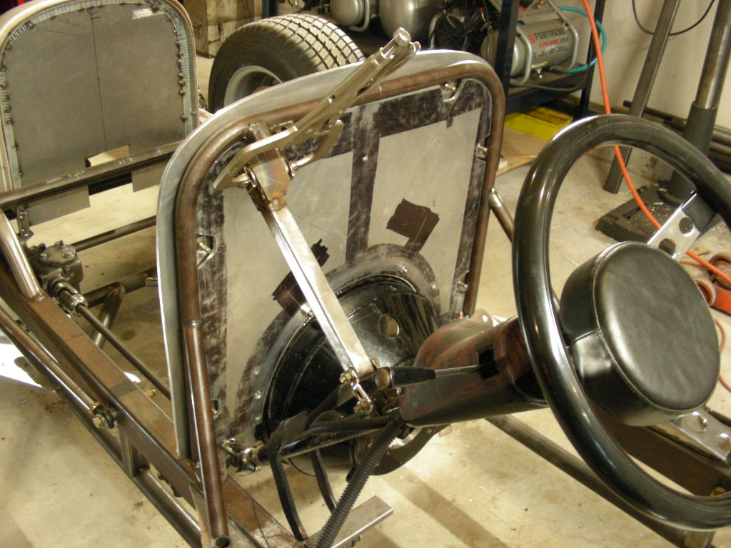

    This morning's diatribe is about missteps. I was wondering if it might help others to see that missteps happen, but they're not insurmountable. The first thing to keep in mind is that never finish weld something until everything looks right, fits right, and works right. Here's a few pictures along the way as reminders of the many missteps I've made so far...
    Let's start with steering related missteps:
    DSCN1439.JPG First column support. Fugly!
    DSCN1551.JPG Another go round. Trying to make 1 fabrication do more than one job. Couldn't get the brake and clutch setup to work. So much for that.
    DSCN1197.JPG Traditional-ish side steering? Nope! Would need to reverse the steering box. Doable, but harder to mount the box.
    20200930_162246.jpg Considered using this, for a slightly different approach. But no. It's a 9:1 Schroeder Champ Car steering box. Saved for another project...
    DSCN1552.JPG Now! Unless I have another brainstorm or nightmare, and change it...
    DSCN1583.JPG DSCN1577.JPG DSCN1573.JPG Now these 3. From the top: current setup, the middle is the heavy, ugly, space wasting 1st inner support structure, and the bottom picture shows it inside the nose. Oh and also where the steering box ended up.
    I have more. But I thing the point is made, to the point of being dulled. Go back thru the many tedious pages of the Whatever project and you'll see many more. And I've learned a lot of new things along the way, both from my missteps, from the plethora of suggestions, and views of the many project threads of the much much more experienced builders.
    I'm learning new things every day. And I know the missteps are not over. But as the British are fond of saying, "Calm down and carry on! "
    Or in Bobby Mcfarrin's song, "Don't worry, be happy!"

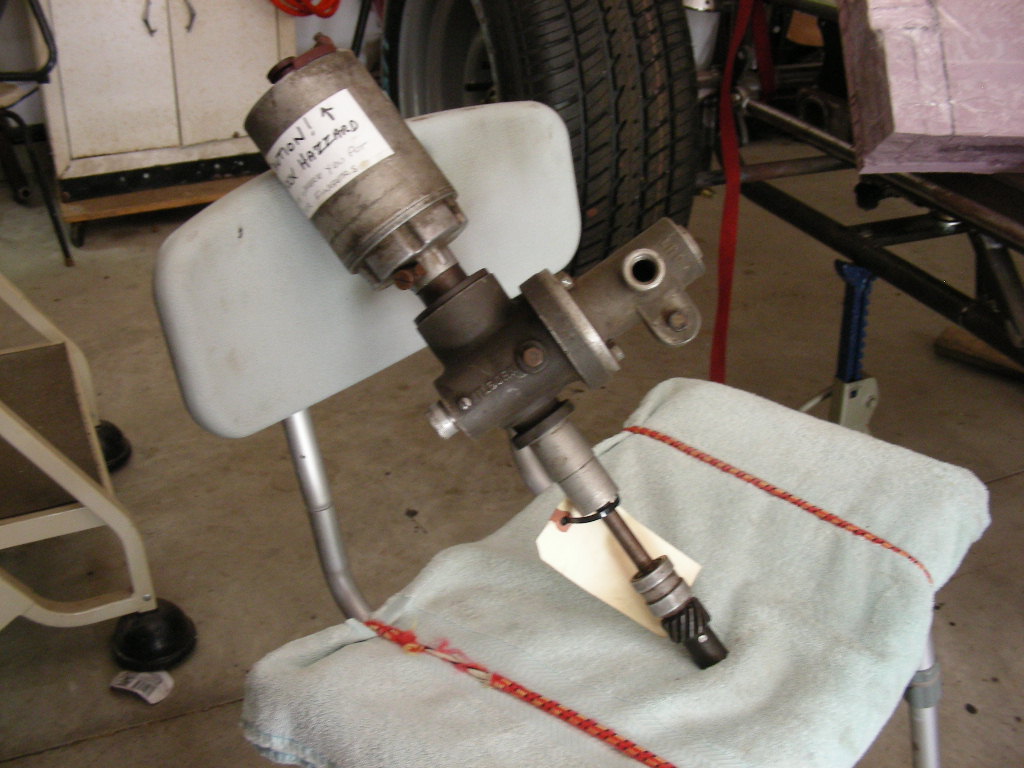

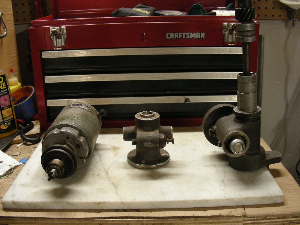

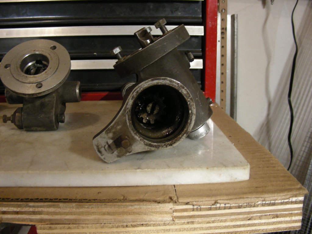

    And I acquired this neat old part:
    DSCN1587.JPG Will it be used in the Whatever project? Or something else? Whatever...

    Is that "neat old part" a magneto drive, perhaps? The top looks like a steering box, but I see a distributor gear on the bottom, so... :confused:

    It's like the Swiss knife of accessory drives: it drives a magneto, that big lump at the top, a fuel pump, the gray thing sticking out of the side, and a mechanical tach, the small shiny cap opposite side of the fuel pump drive. I pulled it apart yesterday to check out the condition of the bearings and other components. The pump needs new vanes, but the carbon insides are smooth, uncracked, and potentially usable. The threads for the tach drive cable and the square drive appear to never have been used. And the magneto, while dirty and in need of new cap and rotor, is in decent condition, although I would send it out to be worked on if I use it.
    An interesting tidbit, the magneto drive base is for a Mopar engine. The drive was designed to use that due to it being much shorter than a gm distributor. I don't know if the magneto has an advance curve or is fixed. Haven't pulled the base off yet. Maybe tomorrow...

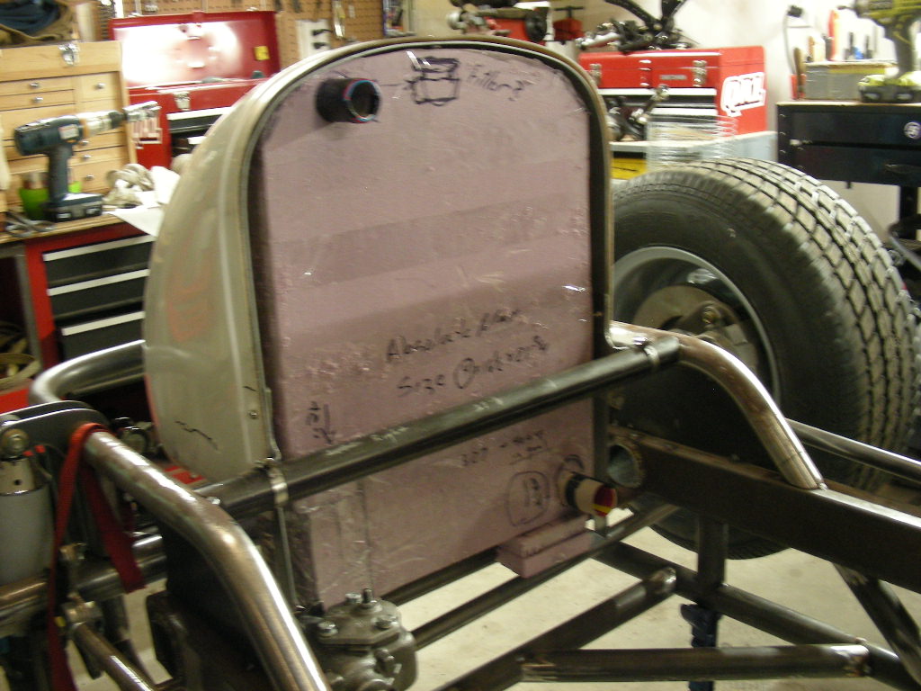

    I like to build them a cardboard facsimile with the fittings located too. Don't forget to specify if a trans cooler is needed.

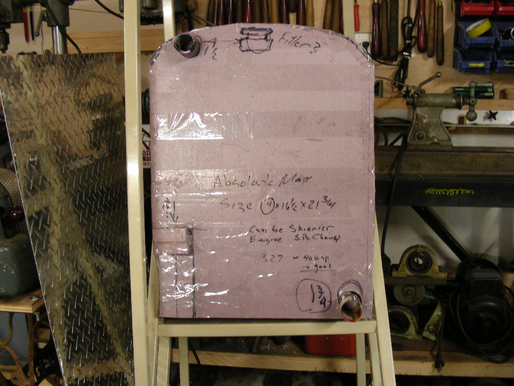

    Thanks for the tip. I made a mock up for the radiator out of foam and marked for the necks, never though to simulate the hose connections. I could use toilet paper cores and the like to be sure they clear x-members. That's why I keep coming back to the combined wisdom here. Someone always helps steer me to a solution.

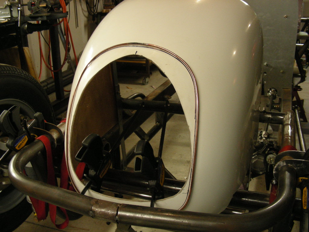

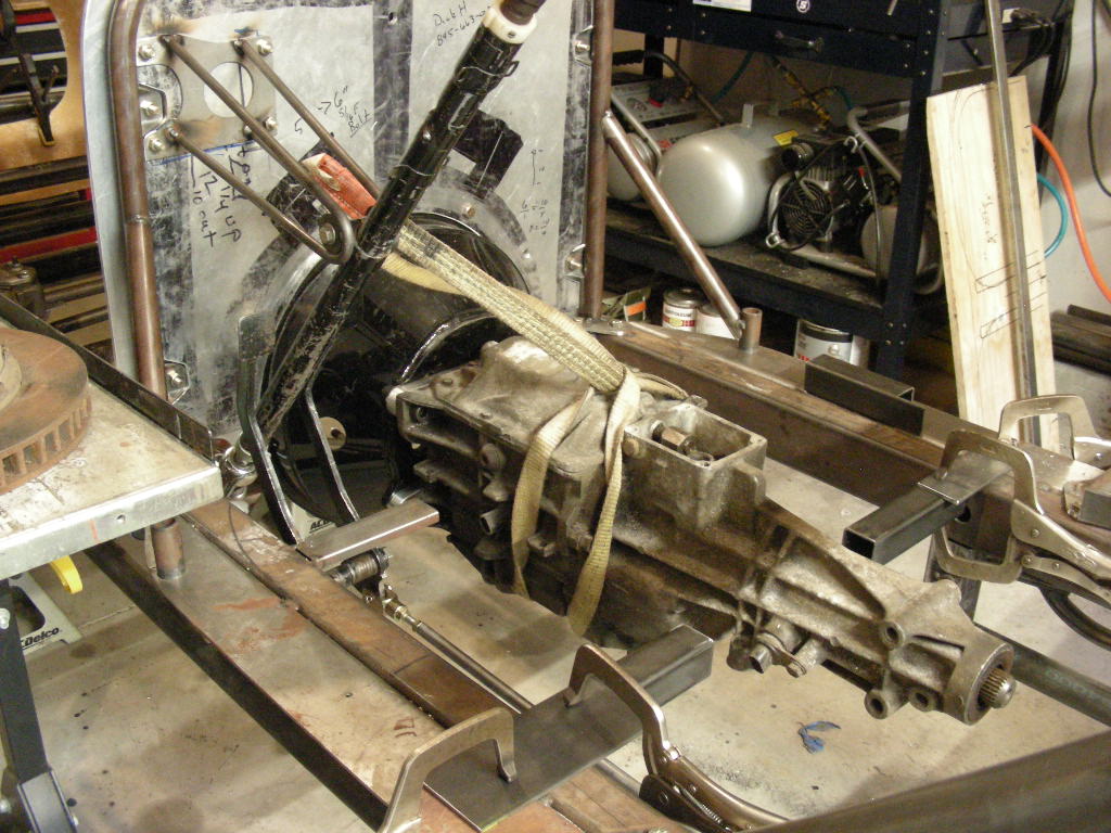

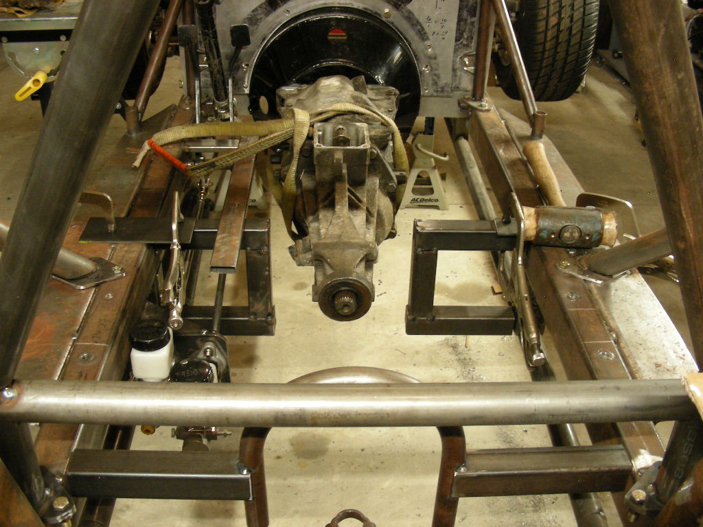

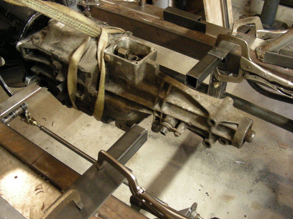

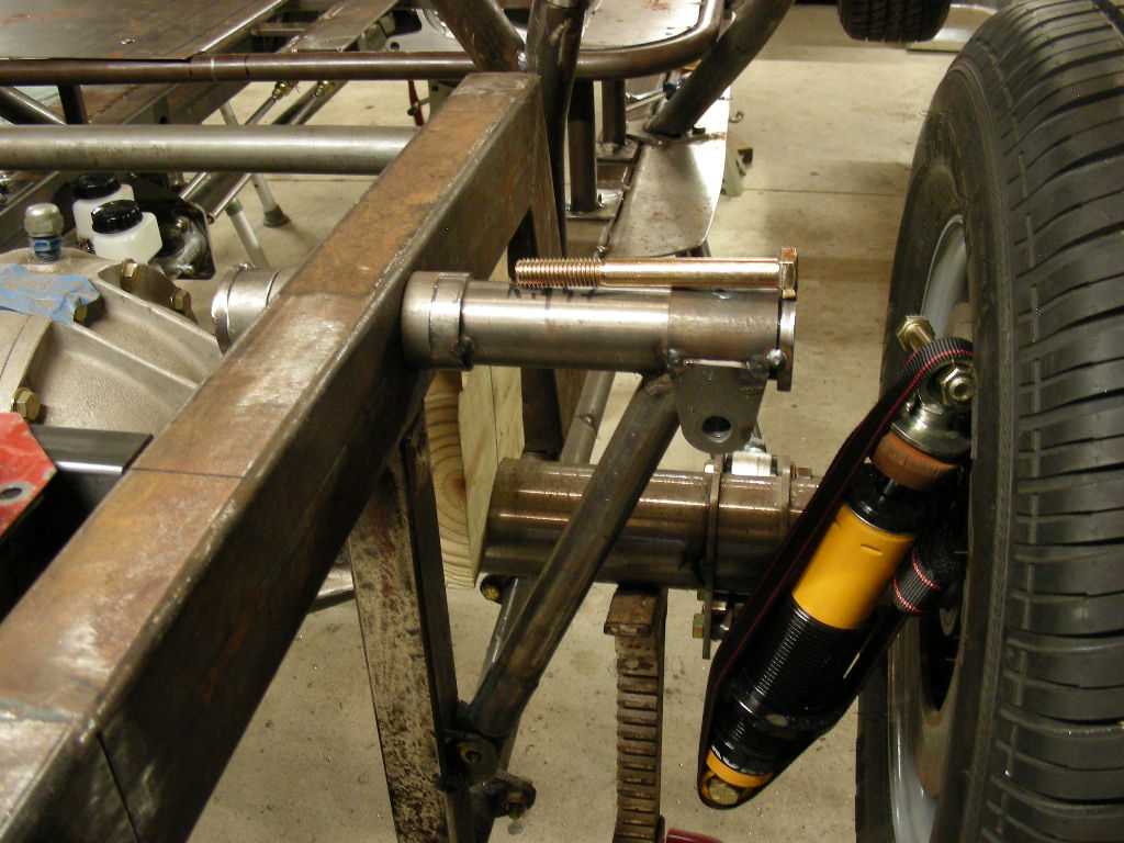

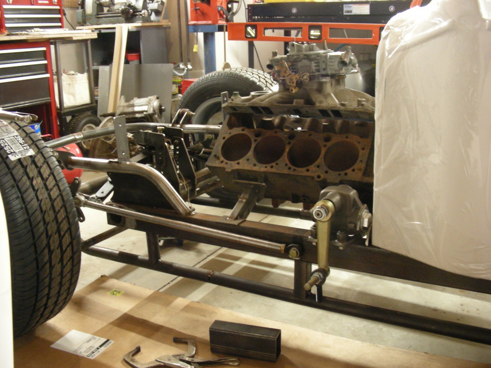

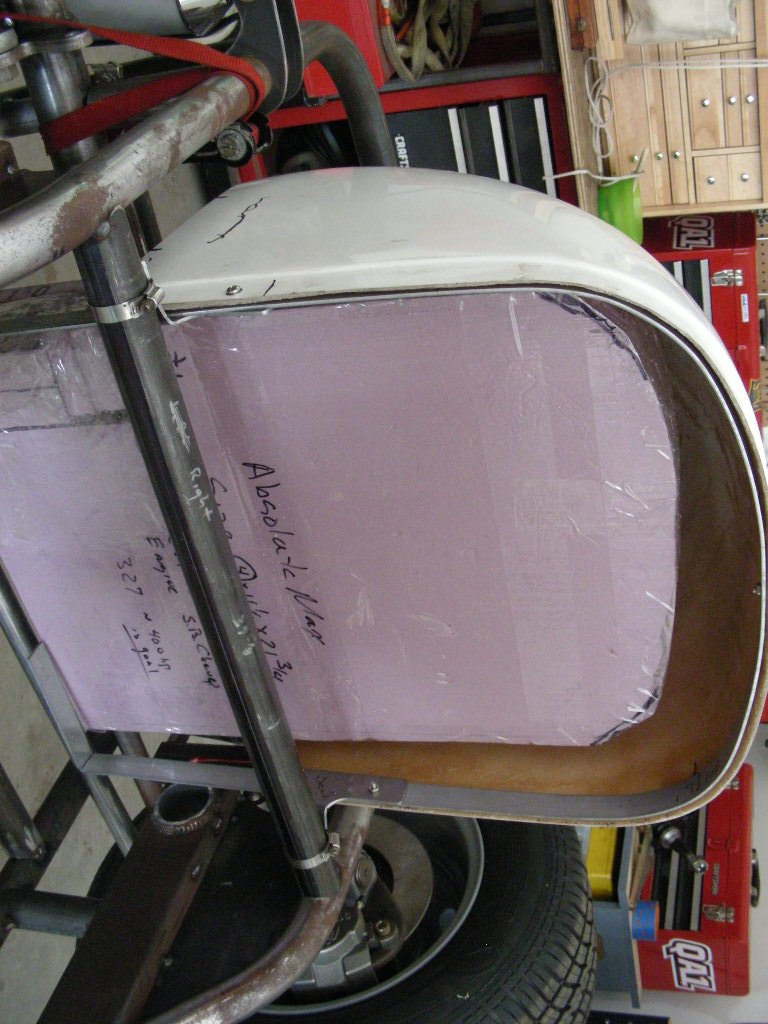

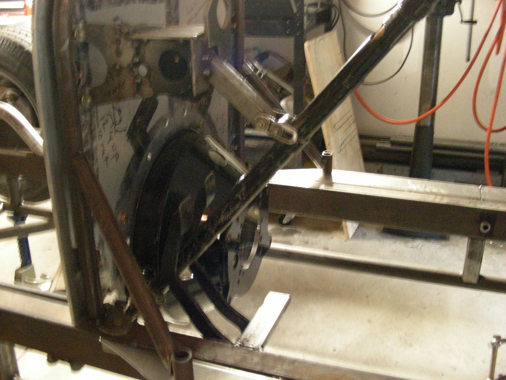

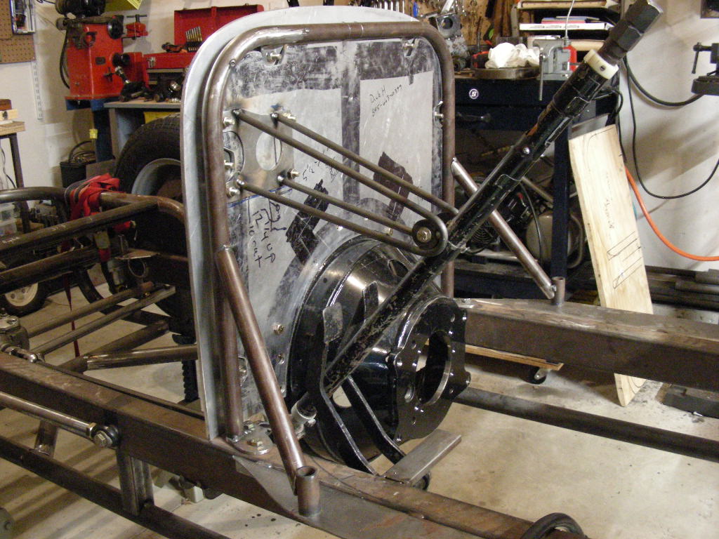

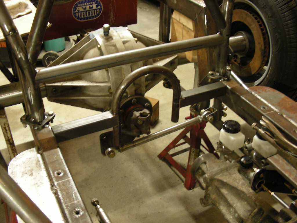

    DSCN1594.JPG DSCN1593.JPG DSCN1592.JPG DSCN1591.JPG DSCN1590.JPG DSCN1589.JPG DSCN1588.JPG Okay so I did manage to screw up already! The pictures are in the reverse order in which I did stuff today. So I guess I'll flip my mind and start at the top regardless...
    After relocating the forward pivot points for the rear suspension, I knew that I had to raise the rear pivot point of the left side radius rod to match the arc of the hairpin on the right side. I'll drill it tomorrow. No big deal...
    2nd and 3rd pictures show the T5 transmission in place. It's the larger of the two transmissions, so making the floor and crossmembers, I want to ensure both will fit in the car when done. Plenty of room so no problem. Got a start on the fabrication, and have a plan for the crossmembers including a driveshaft tunnel and just in case shield, both up and down. I've seen a driveshaft go through 2 walls and inbed in a 3rd in dyno cells, and they weren't just sheetrock! We were lucky no one was in the 2nd cell when the shaft came out of the 1st one.
    That gets us through the first 3 pictures. The 4th and 5th pictures show the shape that I finally came up with for the nose cutout. It's made from heavy welding rod, and can be used to get the grill fabricated as well. At least that's my story and I'm sticking to it!
    Taking suggestions to heart, I finished the mock up for the radiator including where the hose connections need to be. Never thought I'd be using woodworking tools to make the mockup, however I used a Fein oscillating tool to cut the foam to rough shape and a Shurform to refine the shape. Followed by 80 grit sandpaper. Now to get it made! That's a bill I'm not looking forward to...
    Lots of progress today. Now if I can just maintain the momentum!

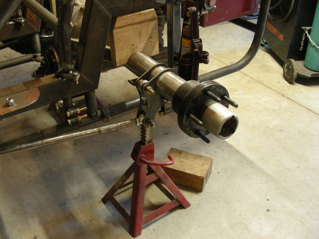

    Go back one square and look at the first picture. Yeah, I pulled the hub today, took the outer bracket off, and drilled a new hole halfway between the existing holes. Drilled the inner bracket in situ, after doing the outer one in the drill press. Now the pivot points for the rear suspension match side to side. And the links will be level with the ground i.e. horizontal, when at ride height. Another little job done.
    Bought a new shop press from Harbor Fright today. Got an email coupon for 25% off. Had to use it! I've been putting off broaching a couple of keyways as I didn't have a press, so long that I don't remember what I bought the broaches for. Must have redesigned whatever it was to not need a key. Oh well, I've got the broaches and the press now, now I have to make something that needs a keyway...

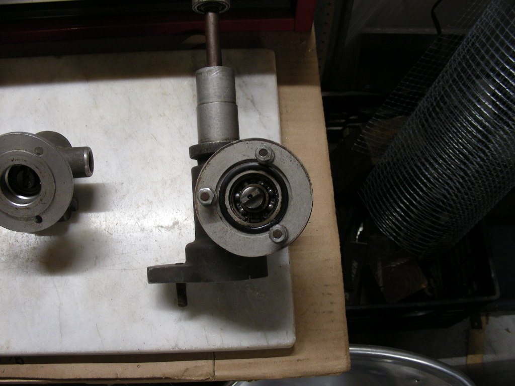

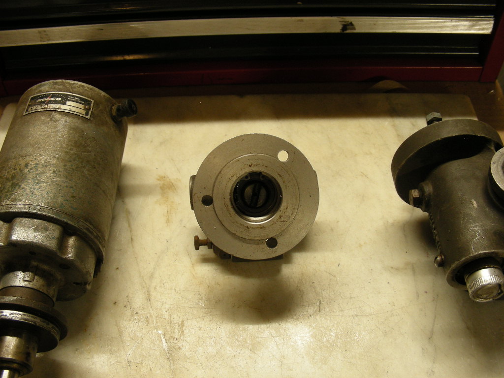

    DSCN1600.JPG DSCN1597.JPG DSCN1596.JPG DSCN1595.JPG Here's the Hilborn mag/pump/tach drive dis***embled for cleaning and fettling. Check out the mag drive: you MOPAR guys probably recognize the bottom of the magneto. It's in really good shape, just needs cleaning up and regreasing. Before Sonny gets it, I'll send the magneto out for a freshen up and maybe an advance curve. That's the oldest mag I have, around 1960.
