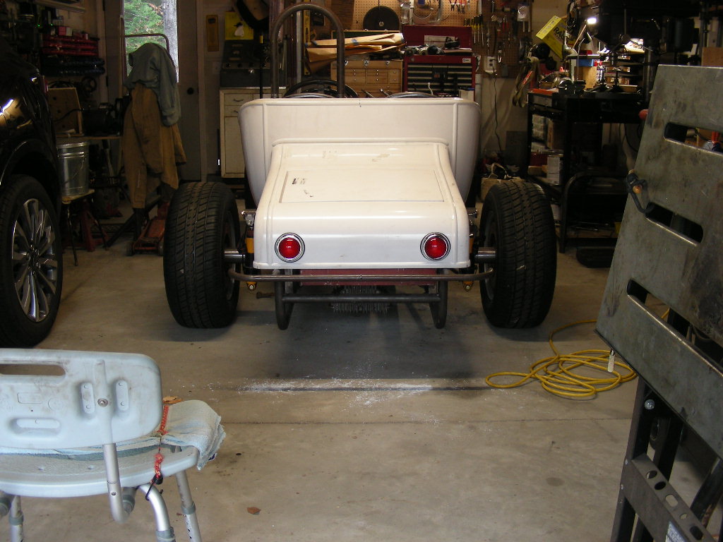

    DSCN1685.JPG I got a box of goodies yesterday from Speedway. Mostly hard parts, but these taillights also. Had to get them mounted, so I could see if my choice works. As always, opinions are welcomed, but I guess I'm committed to them now.
    Also got kingpins, bearing spacers, and ***orted other stuff. Not picture material yet. And no one wants to see pictures of that stuff, either in in the boxes or on the car. Just let it be said for the record that it actually took longer to lay out the holes thru the turtle deck for the taillights than to install the other stuff...

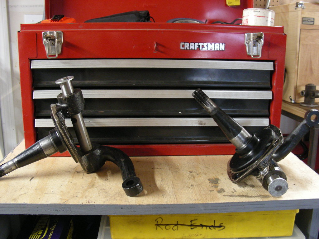

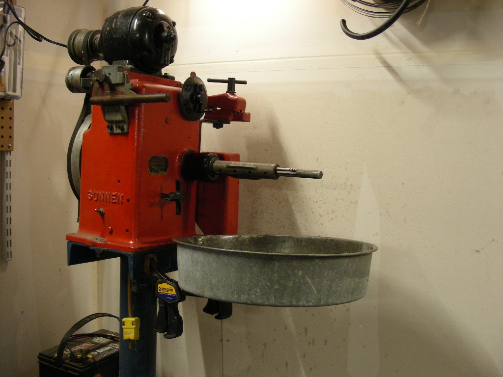

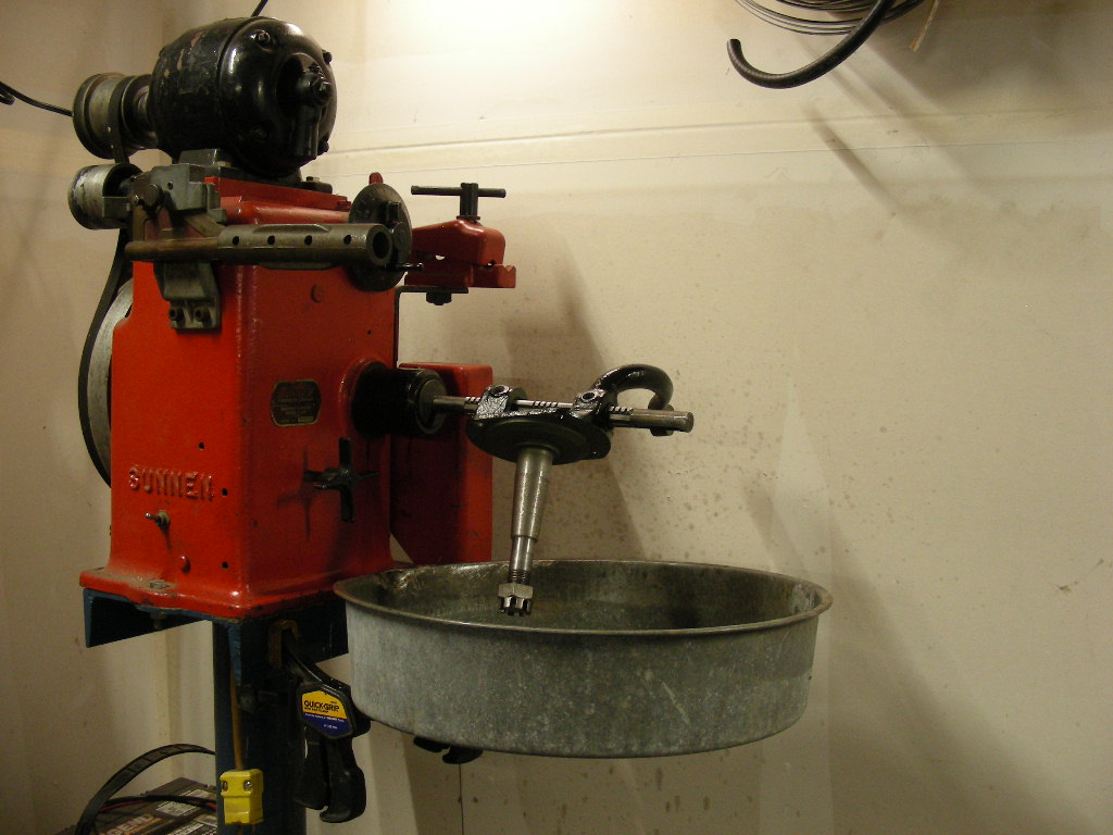

    New kingpins and bushings in the F1 spindles today. Used the newest and the oldest tools in the garage doing it. DSCN1696.JPG Here's the newest, a horror fright press. Sorry didn't think to get a couple of pictures of the process, but I think everyone can figure it out. Used an appropriately sized mandrel (well an 11/16 socket actually) to change the bushings.
    DSCN1692.JPG And here's the oldest, a 1928 Sunnen bushing grinder. Yes, one of these days I'll make a real coolant system, and not just use a drip pan and squirt bottles, but it's worked for me since 1976, so I'm not in any hurry...
    DSCN1693.JPG Here's the setup in progress. Well sort of, I forgot to get pictures of the F1 spindles so this is a stand in 34 spindle.
    DSCN1694.JPG DSCN1695.JPG Here's the finished product. I shoot for a 0.001 minus fit, and nailed it! It took longer to dig out the machine and make room to work on the spindles than it did to do the job! The joy of a small work area.

  12. DDDenny
    Posts: 23,422
    Dave
    Sometimes it's the little accomplishments (victories) that keep us going.
    By the way, I worked for 30 years as a machinist (same place), started out with junk machinery, some had two different military dept. plates on them, were still there when I retired.
    Talk about victories, on a daily basis!
    Soldier on.
  13. Dave G in Gansevoort
    Joined: Mar 28, 2019
    Posts: 4,277
    from Upstate NY
    Yes, the little details that go unnoticed. Some of these are completely invisible so only we know that the job got done. A friend of mine has said he doesn't want to see a rattle can paint job, because he knows that I'm terrible at paint. Time and our health allowing, and if I can do some of the preparation beforehand, he's thinking about coming up from NC to paint it for me.
    And that's the stuff people see. He wants to ensure that the finished product stands up to the actual work underneath. When we worked on cars together back when we both lived in Ann Arbor MI, we had a motto, any job worth doing is worth overdoing!
    Regarding that 94 year year old bushing grinder, I can only imagine how many sets of kingpin bushings it has sized during its lifetime. The mechanic who bought it new had it from 1928 until he retired in the early 70's. He gave it to a friend who had a Shell station in town but Sam didn't have any interest in it. It was headed to the s**** yard when I pulled it off of his truck in 1975 (I think...) and I've had it ever since. I did all of my own kingpins for the modifieds with it and for a couple of friends as well.
    Now I just have to make a real coolant system for it, and finally after all these years, get some new stones. I'm on my last set. Fortunately Sunnen has never changed the mandrel design.

    Oh and the kingpins will just slide in from the top when lightly oiled. I can't feel any wobble in them in the bushings, either singly, or all of the way inserted. And I am happy with that fit

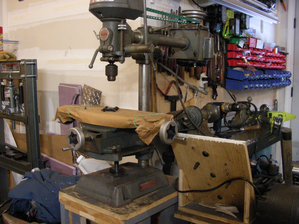

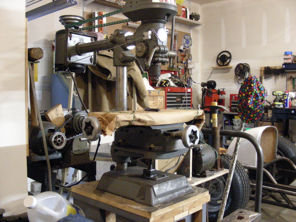

    Oh, the drill press? I got the x-y table bolted down and eyeball engineering aligned. It's my almost precision positioning drill press. 1st time I use it I'll see if I have to do a better job of aligning it.
