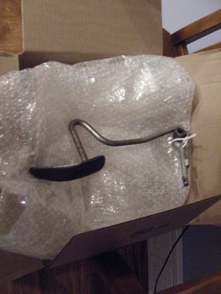

    DSCN1734.JPG Look what got delivered today! Been on back order since September. How many orders did it take for Speedway to make a run of them? Certainly nicely done.
    I'm glad I plaigerized Marty's body mount method. And firewall! The way that the body is bolted down to the frame should keep it in alignment when I have to cut the side out to install all of this.
    Anybody got tips, tricks and pictures from installing a door either post them or let me know what the thread is where you detailed the install. I can use all of the help anyone wants to provide.

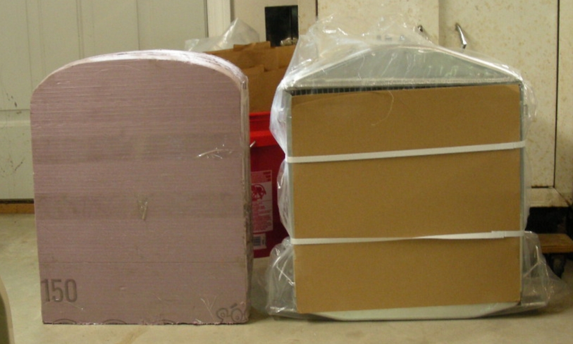

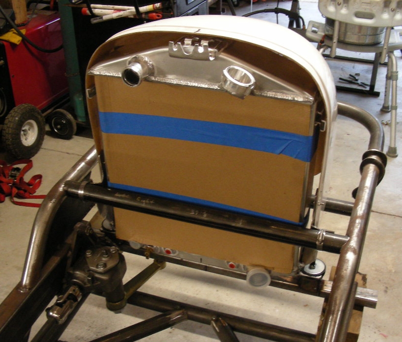

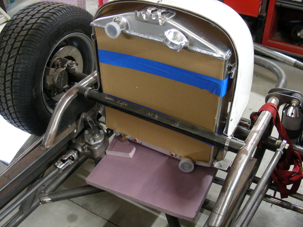

    Spent some quality time in the garage today. Took some pictures of the new radiator. Made a plan for the mounts for it. I'll be spending some more quality time in the garage grinding the remnants of the first crossmember removed from the front of the frame when I took out the buggy spring and its big ugly mount. Now the pictures:
    20230526_182357.jpg Here's the mockup on the left, altered slightly in height only so I could see if the Speedway deuce chopped radiator would fit in the nose. The new radiator is obvious.
    BTW: I have been accused of stating the obvious! It's what I do...

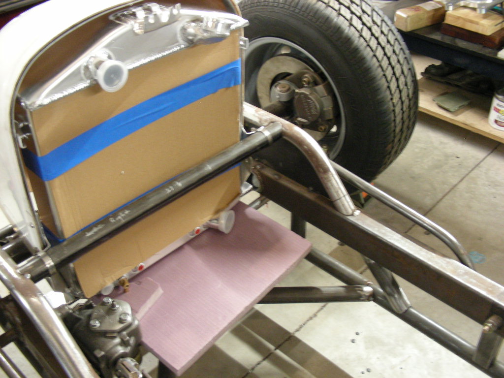

    DSCN1744.JPG DSCN1743.JPG Nice fit! In the first picture, you can just see the remnants of old crossmember by the right side mounting bracket on the radiator. Here's a picture of the area: DSCN1746.JPG And yes it's fugly down in there. And I know I'm going to have so much fun grinding that weld off. And it's on both sides of each frame rail. And I have to plug the hole as well. I think I'll be taking a bit of the front apart!
    Looking closely at the sides of the radiator, it has brackets welded on to bolt to Speedway's loboy chopped deuce grill shell. Interesting to see that the track nose will almost bolt on to it as is. I'm thinking that I can integrate the mounts for both, and eliminate the support structure that is in there now.

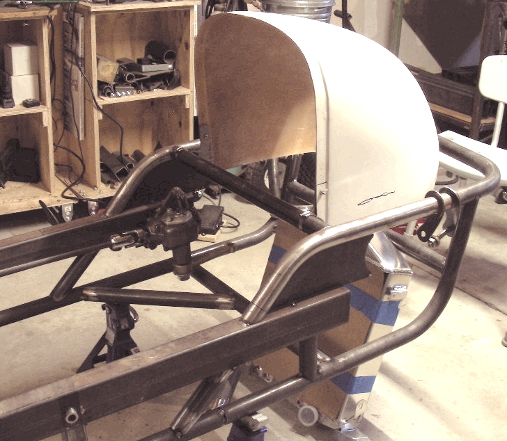

    Drat! I DID it again! One more picture:
    DSCN1742.JPG Lookingin thru the front of the nose, it looks like a good fit. I should be able to seal the nose to the radiator easily, making sure that all of the air coming in thru the nose makes it thru the radiator. And there's plenty of room for a water pump mount fan, and I'm going to make a shroud so it pulls thru as well. And yes, that tube crossmember will be inside of the shroud.
    Of course I'll need to ensure that the air can get out of the engine bay. I'm going to try to run full side panels. I'll need to have vents of some sort. Suggestions, pictures, other places where I can plaigerize your idea of what the vents could look like are as always much appreciated.

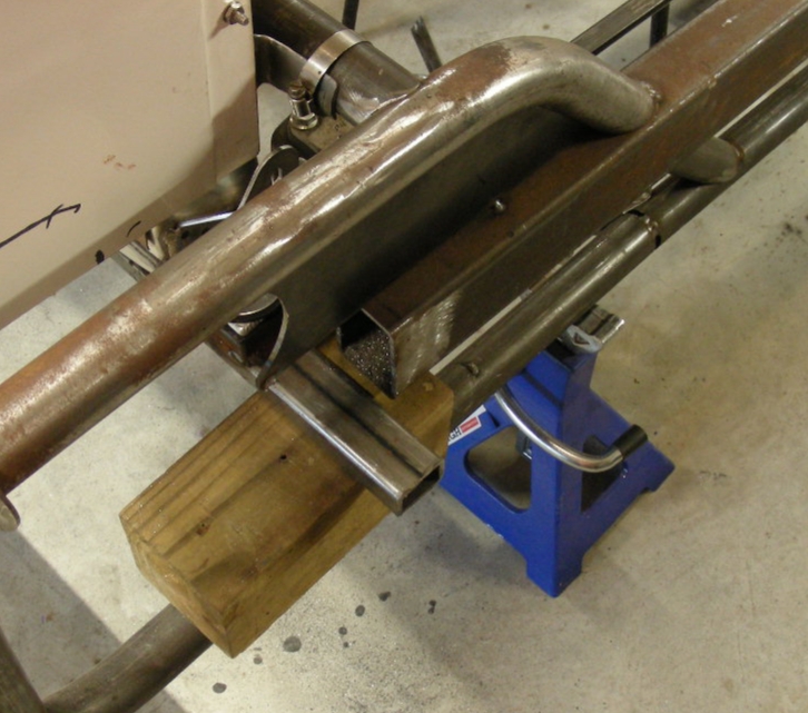

    PICTURES I've got PICTURES! And a few sentences for you.
    20230608_180309.jpg I finally got the front suspension out of the way to get rid of the ugly front crossmember holes. And the ugly is gone!
    DSCN1751.JPG Yup, just cut it right off! Can you imagine all of the grinding and then cutting 4 circles out, welding and more grinding? And I might not need to splice new sections of 2x3 onto the ends. I've been working on the crossmember to support the radiator, and I'm coming up with a little twist.
    So I started by making 2 of these uprights that the radiator will sit on and bolt to.
    20230608_180417.jpg A section of 1x1.5 rectangular box section tubing and some more welding and I have a crossmember. I'm picturing a plate hanging straight down from the gussets on each side of the first picture, that will bolt to them. And a hoop just behind the radiator and nose to support both. We'll see...

    4 pictures of today's progress. They don't really show anything clearly. Some day I'll learn how to take pictures that actually look good. Okay so here's the pictures:
    Lower left side of the radiator crossmember and where it needs some bracketry.
    Steering clears. The drag link goes underneath.
    Roadside view of the crossmember. Yeah I know, big deal...
    From the engine side.
    Early on, I made a hoop and sheetmetal fabrication to support the nose. It might just be a good start to sealing up the nose and radiator so all of the air coming in thru the nose makes it thru the radiator. We'll see... That's why we never toss anything out!
