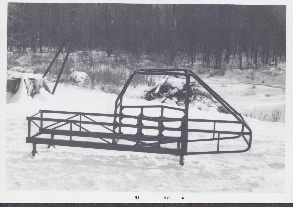

    So here they are again as images...hey I'm learning: IMG_20201013_0005.jpg The 1st win in a brand new limited sportsman for Jim. See his feet? The car was running hot so off came the full side panels. Of course they went from the nose to the roll cage, and the firewall was 8 or 9 inches in front of the cage to get Jim to fit in the car. He was 6-2 or 3 before back issues. IMG_20201013_0018_NEW.jpg Here's where I started. IMG_20201013_0017_NEW.jpg It was relatively light. I could moveit around by myself if I stood inside it at a balance point. IMG_20201013_0021_NEW_NEW3.jpg Sorry for the poor quality. A little work was done by this point.

    So do any of you have "One of those days" stories to talk about? For me today it was time to finish the "Oh $#!t" structure that includes the tubes that go under and over the front axle. Having a suicide front spring mount, I figured I'd incorporate the front bumper/shock support structure with some tubes coming from under the axle. Well I got the tubes bent and fishmouthed, and then started to fit it all up.
    1st tack weld, Oops! Did I forget to drop my helmet? No! it decided today was the day it was going to fail. Batteries? Nope, its got built in batteries and solar cells to recharge from the arc. So how old is it? Oh yeah 10 or 11 years old. Like all rechargeable batteries, there is a limit to recharge cycles, and today was the limit. So off to the welding supply to get a new one. This one, a Miller Elite something or other (I only have one set of eyes) has replaceable batteries, so that shouldn't happen again.
    Got the tubes fitted but no pictures today. Hey I'm lazy and forgetful. I did get some old pictures transferred onto the tablet from the old Iphone soI'll include some pre-"Whatever" pictures...

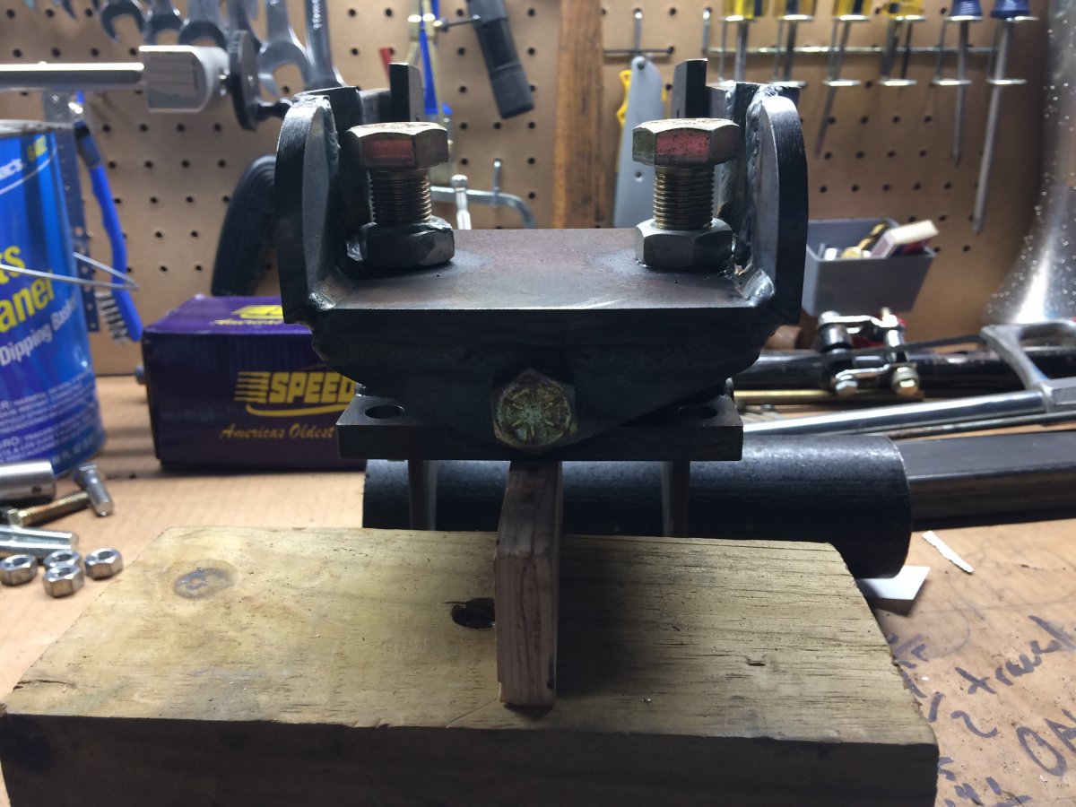

    IMG_1167.JPG Starting on the front spring mount. It's built like the old time race car weight jackers, adjustable for cross weight and front ride height.
    IMG_1167.JPG IMG_1130.JPG Back a while at the start of the frame.
    IMG_0176.JPG Taking a ride in Mr. Peabody's Way Back Machine, here's the front setup as first envisioned. Too complicated and somewhat overweight. You can see the fabricated swing sleeve ***emblies on the axle, the left one is free to pivot, the right one clamps and would be pinned to resist rotation if used.
    IMG_1113.JPG Here's the first take on the rear suspension, with the aluminum birdcages that would be free to rotate on the axle tubes. Fun to make, too complex and not practical.

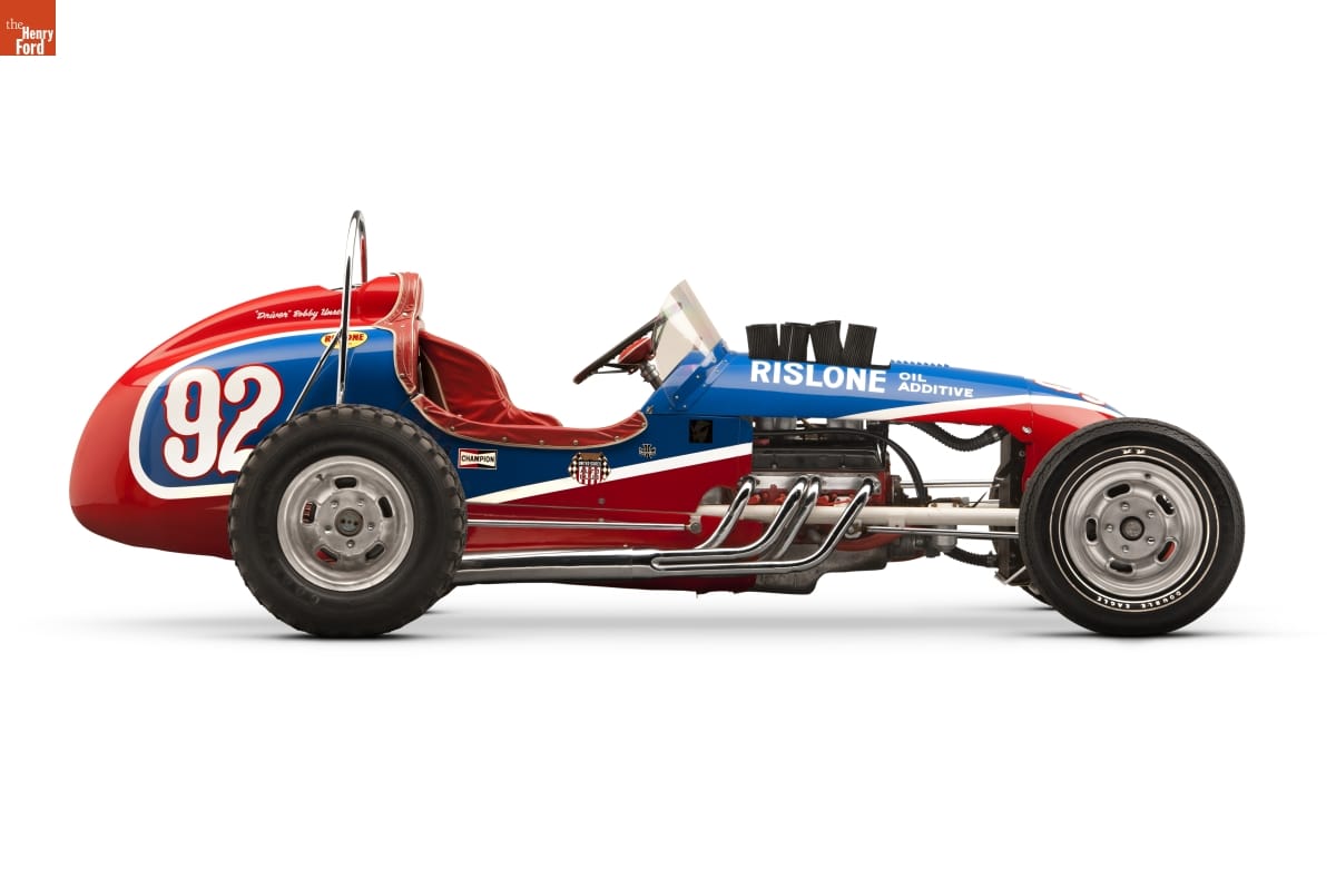

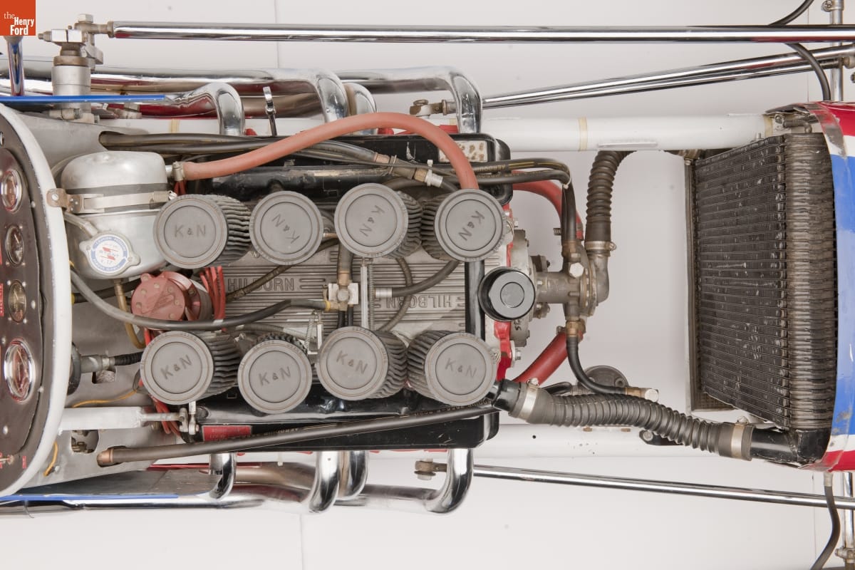

    THF91311.jpg Here's the car that inspired the setup I am using. Itis Bobby Unser's 9 time Pikes Peak winning champ car. Look it up in the Henry Ford Museum, where its on loan. As you can see from the right side photo, there is only 1 radius rod for both the front and rear suspension.
    THF91316.jpg Look closely at this picture and you can see the hairpin on the left side of the front axle. I don't know where I found some better pictures of this car from the left side, suffice it to say both front and rear have a hairpin on the left side. BTW the rear axle is NOT an open tube sprint car axle. It's an axle very much like the late model guys run. I bet the axle housing tubing is much thinner wall than what mine are, but hey you use what you have.

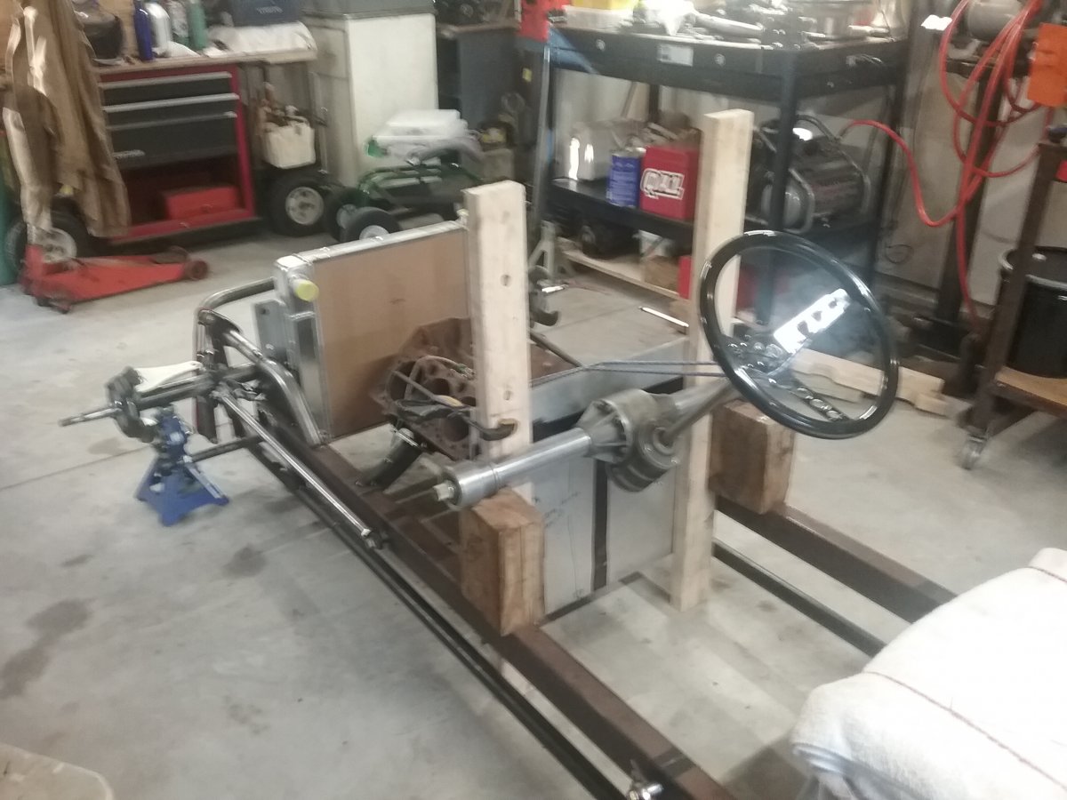

    Oh and 1 last thought: here's a crude sketch of what I have tried to describe as a way to have the "Look" of cowl steering and the effect of Vega cross steering, a la Frank Kurtis Indy cars from 1952 IMG_1116.JPG

    I like the concept. Literally out of the box thinking to get around steering shaft clearance issues in a tight engine compartment.

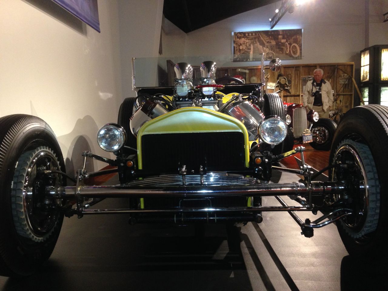

  7. Do it like Cotton Worksman's "T" bucket.
    Just Gary, enloe, AHotRod and 3 others like this.
  8. Fabber McGee
    Joined: Nov 22, 2013
    Posts: 1,523
    Fabber McGee
    Perhaps a photo that actually shows Cotton's steering would be helpful.

    I believe the top photo is a recreation, as photos I've seen from 2015 show the car still in yellow, not black. I've never been good with geometry, but I'm not sure those arcs are too similar...
    Y'all ponder these, and I'll see if I can find any better photos.

    He had it very well laid out. The 2 arcs will be close to the same radius, hence minimum influence. Probably covered by tire squirm. Of more interest, blow up the lower front picture and look at the left side hairpin bracket. You will see it is attached to the axle with a swing sleeve. Werksman used CAE axles for sprint cars on the t-buckets, and that design has the same concept I was initially working on. If I can figure out how to upload it, I have a 1970 CAE catalog digitized that shows this axle setup. Of course 1st I have to find the file...

    ON the Unser car, the left front has a "Y" type radius rod to keep the front axle from twisting. That's pretty much how my first sprint car was set up. There must be something else on the rear to keep the rear axle from wrapping up. They might have depended on the torque tube to prevent wrap up.

    No it is actually just another hairpin like the front. He didn't have an open tube rear axle in the car. I don't know the exact setup, but from pictures I've seen the rear is similar to what I am using, some sort of floater hub, like a GN or some such. I bet he has a locker rear as the car needed to turn in both directions, and some turns on Pikes Peak are really tight 180 degree turns. I know on my racing buddy, Jim's Mt. Washington hillclimb car, the rear diff had a locker, for the same reason.

    So it is! So that eliminates any bind as the axle deflects? I see that the drag link and hairpin are close to parallel, but does the sleeve cure some/all of the ills from having the pitman arm lower and to the rear of the hairpin pivot?

    Oh and the axle bracketwas just welded solid to the outer tube housing, so that the 1 hairpin resists braking and accelerating torques.

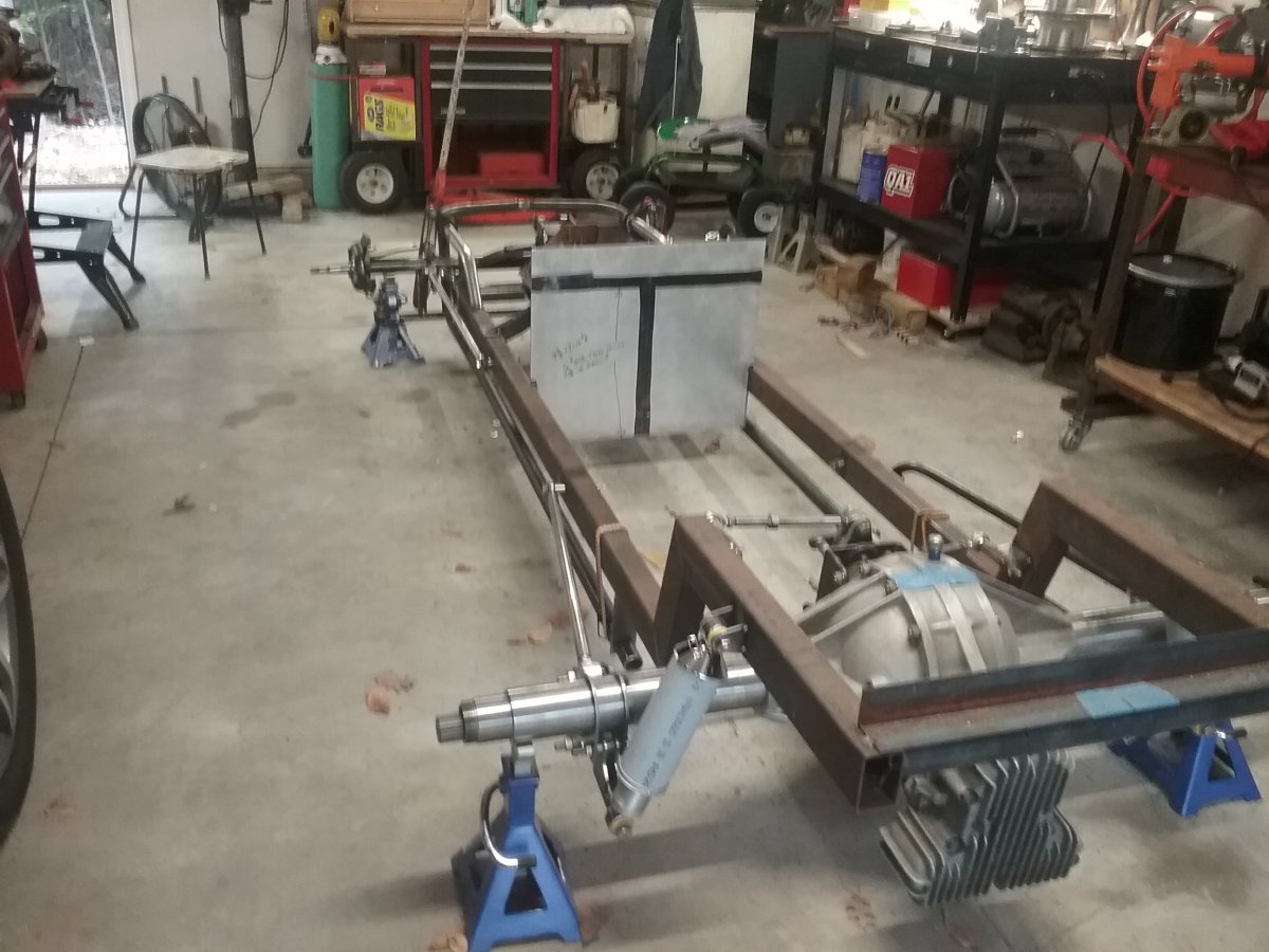

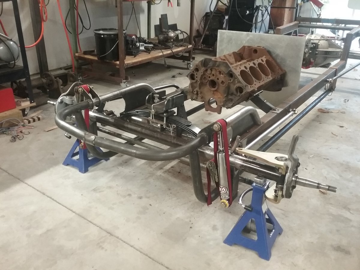

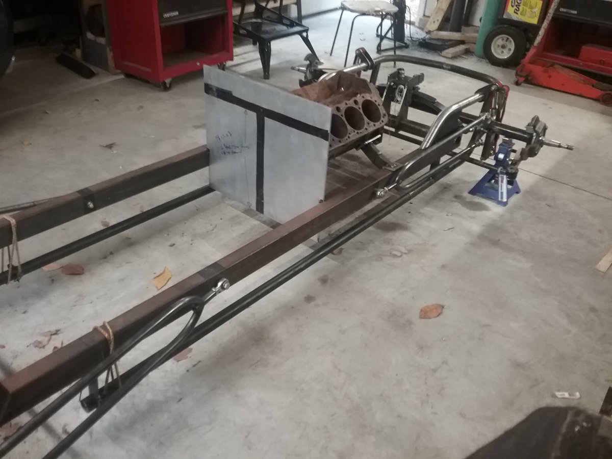

    So finally able to get into the garage for a little bit today. Back issues, only get an hour or 2 sometimes before it just says "NO MORE". Anyway...
    20201019_140951.jpg As you can see, I got the front of the frame fabricated. Kind of looks like an older dirt car frame up there. I didn't want a peak in the front bumper, and I didn't want it to just go straight across. So I bent the 2 tubes to 85 degrees, and put a small (~2 inches long) piece in the middle. When welded and ground, it will have a small almost flat area to push something with (hey you never know who you want to nerf...).
    The 2 under bars are bent at 75 degrees and go under the front axle parallel to the main frame rail. For ease of fabrication, they are spliced and then continue to the rear, ending just in front of the rear kickup. As the picture of "whatever" starts to firm up in my mind, and I am musing on going 1 of 2 ways regarding a body, I have built in some ability to alter some aspects of the frame to fit.
    If I build something along the lines of Greg Lazerinni's "Deuce-ish" roadster, then the frame will work as is. However I have always wanted to build a hot rod sports racer like the west coasters used to build using Devin bodies, Ak Miller's Devin bodied Pikes Peak winning car from the late 50's keeps coming to mind. And Toluca Lake Cl***ic Motorsports just happens to manufacture replica Devin bodies. Not cheap, but with planning I can probably afford 1, maybe have to sell some of the other stuff I've collected over the years to fund it...
    Oh and get a certain nephew involved to see if we can figure a way to get a body from Sunny California, to Upstate NY somewhat cheaply. His "She who must be obeyed" is from Sunny California after all...
    A couple more pictures of today's miniscule progress... 20201019_141009.jpg And... 20201019_141023.jpg Yeah a lot more structure to come. If I go the Devin body route, there will be a widening and lowering of the main frame rail from the engine plate to the rear kickup, to get the driver and p***enger seats beside the driveline tunnel. Hey its only steel, just cut and weld...

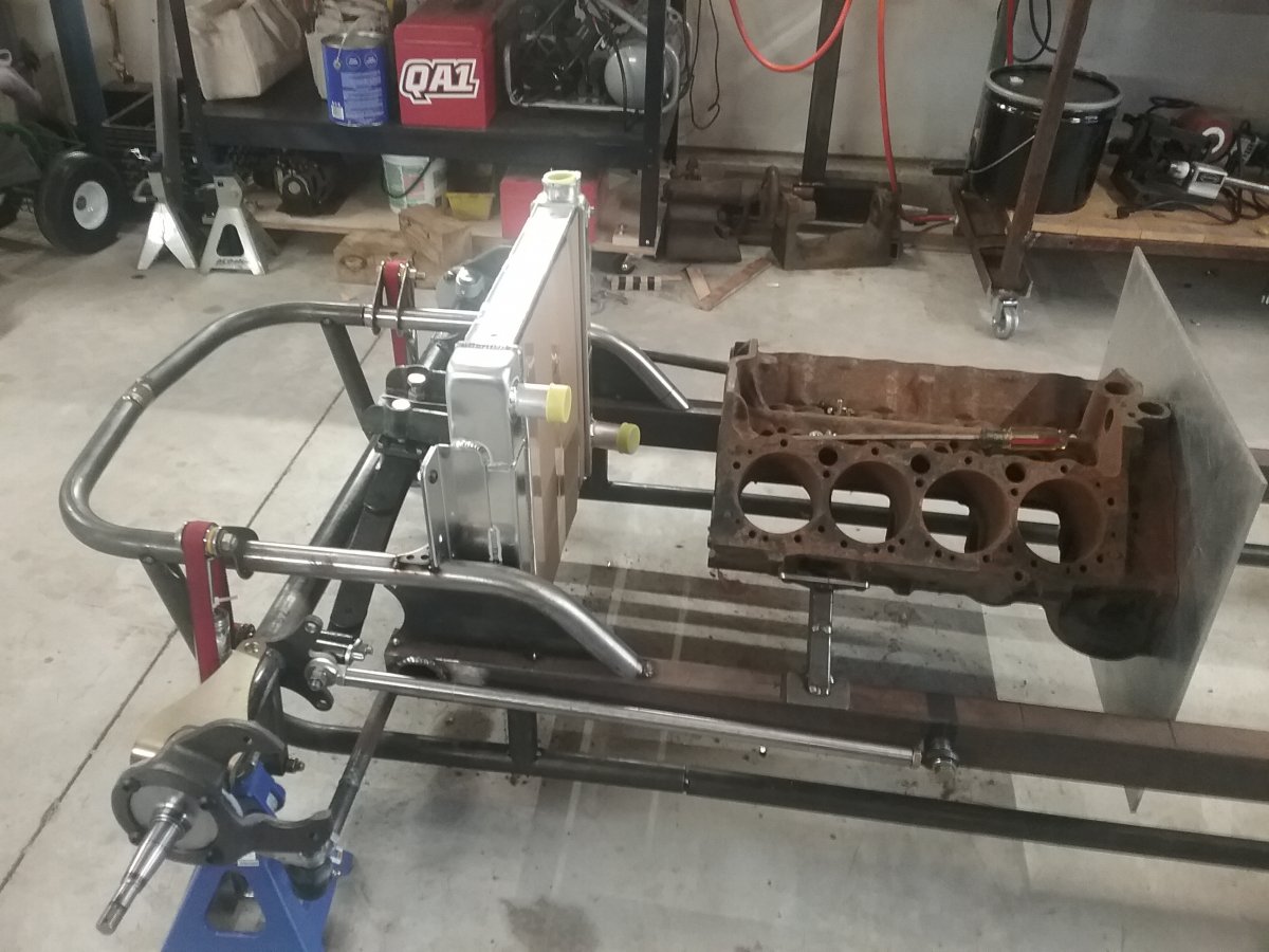

    Got the radiator mounts fabbed today: 20201021_155404.jpg It looks good from this angle. 20201021_155414.jpg I think there's enough room for a fan, and the top of the tanks are above the water outlet on the 327, so there should be no air bubbles trapped. I goofed on this once on the 54, and ruined a set of Mondello ported 492 angle plug heads. It was a painful experience, but I knew better...
    So I also brought the Shroeder champ car box out to see if it will fit. 20201021_162307.jpg And: 20201021_162314.jpg Would work great for a single seat center steer, but not a 2 seater where I'm heading, so back to the ba*****t with it...
    Guess I'll use a Vega box, but stay tuned for something different in the way I do it.

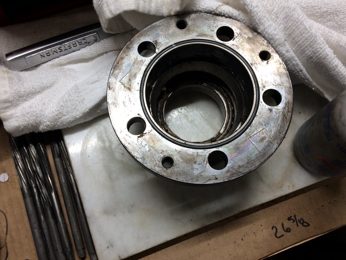

    Finally back in the garagea bit today, BUT... IMG_1177.JPG Grand National billet hubs, came with the QC. They had 5/8-18 studs, good if I want to use steel GN wheels or drill evey wheel out. I had already installed 1/2-20 stids in the front hubs(5x5 bolt circle to match the GN hubs), and they looked like they had the same size knurl (0.685-inch). So buy the studs, got them last Friday.
    You know the carpenter's old saw, "measure twice cut once", well it's car corrollary is measure twice, order once! Yes I'll beordering a 43/64 drill bit to open up the holes by 0.050-inch, the old studs were 0.635-inch give or take knurl. Oh well...

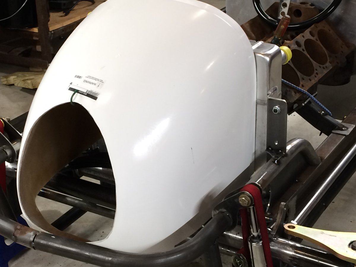

    Also in the delivery was a race car nose from Speedway. IMG_1175.JPG Looks good, except for the radiator. It hangs out! IMG_1176.JPG
    And it fits the frame so well... At least the bracketry is only tacked in, easy to remove. Guess I'll wait for a more finished body concept before I get another radiator, or haveone made to fit. At least the effort wasn't completely wasted. I know how much room there is in front of the engine where I located it, so I canbe sure one will fit. A side benefit is that I really didn't like the side mount on the aluminum radiator. I prefer having it supported from underneath resting in a formed c-channel, with top clips to secure it in place.

    So I got the 43/64 drill bit this week and drilled the rear hubs for the new studs today. Installed the studs and put the hubs back on. Now I have matching 5x5 bolt patterns front and rear with 1/2-20 threads. Now I have a ch***is that with rolling stock could be a roller. This bolt pattern is GM big car or pickup 5 bolt pattern, so now to get some wheels/tires. I'm thinking that the rolling stock on the Werksman roadster looks really good, so maybe some 5 spokes with low wide tires... opinions ?
