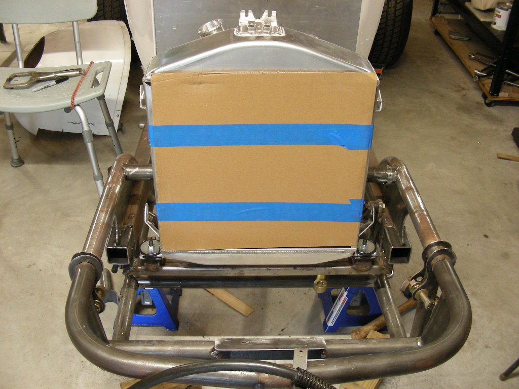

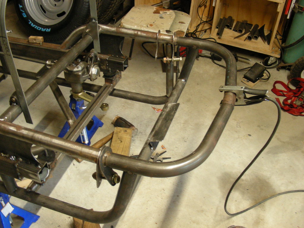

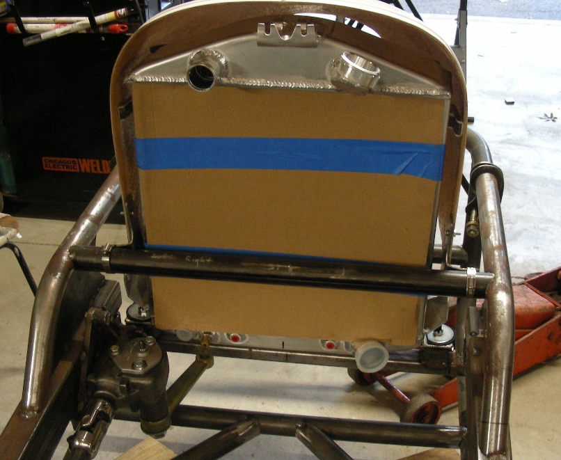

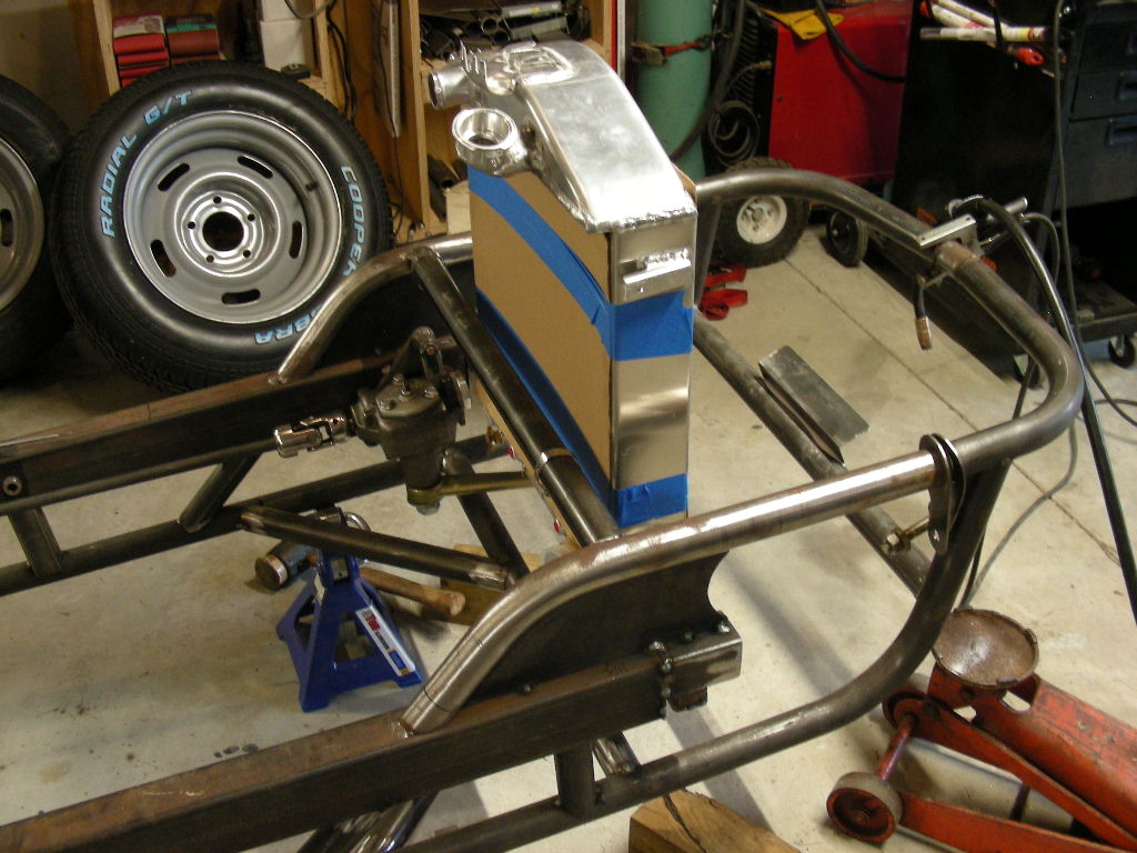

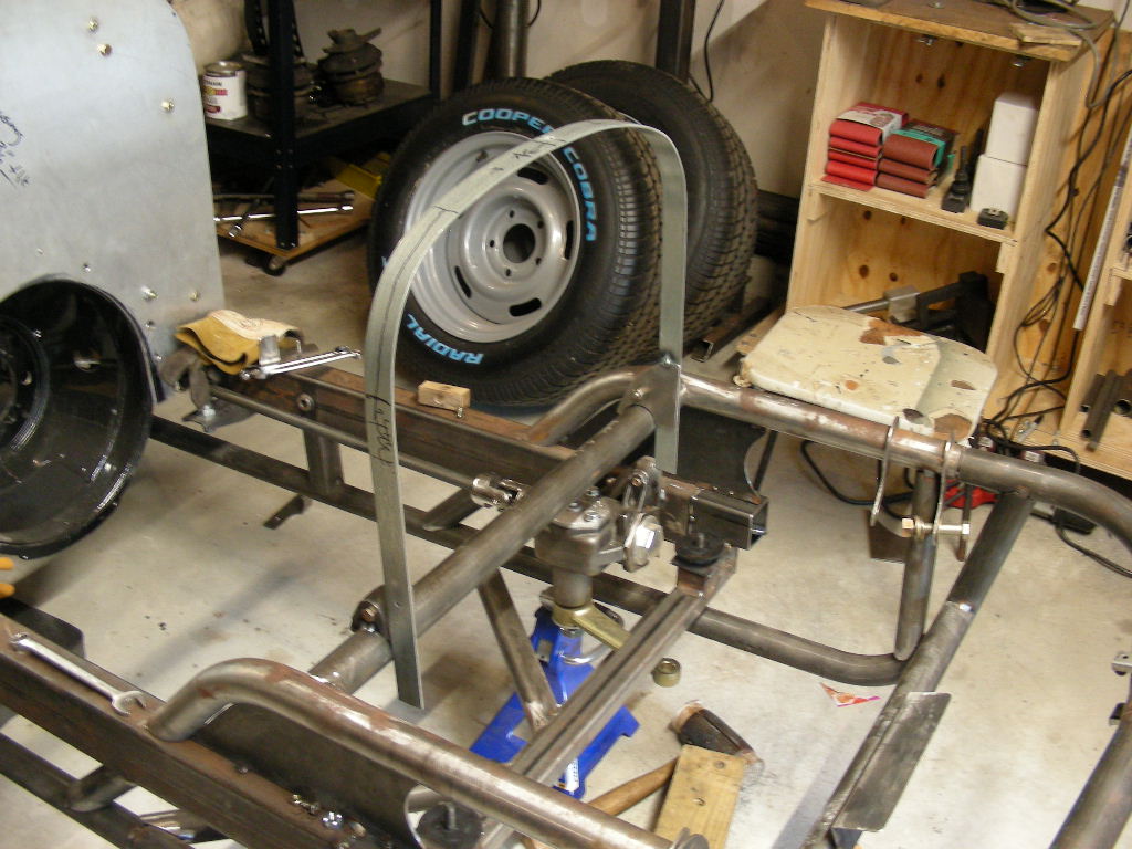

    A few more pictures today. The crossmember to support the radiator is fabricated and tacked into place. Good clearance Clarence to the nose and the steering. Nothing else will be near it. And as I just took a muscle relaxant, I'm going to skip the diatribe and just post the pictures.
    DSCN1769.JPG DSCN1768.JPG 20230613_192553.jpg 20230613_192404.jpg 20230613_192200.jpg
    You get the idea. More tomorrow...

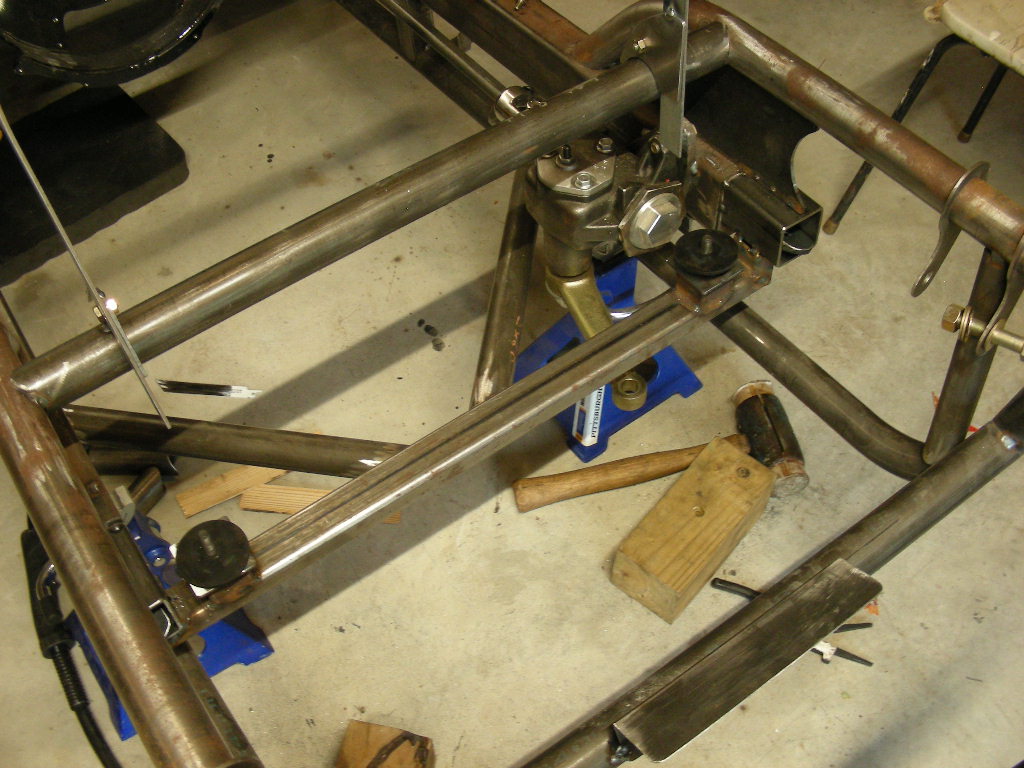

    So a little bracket racket on the Whatever project today. CAD besign of the brackets is done, just have to cut it out and drill some holes. Pictures later...
  7. Dave G in Gansevoort
    Joined: Mar 28, 2019
    Posts: 4,276
    from Upstate NY

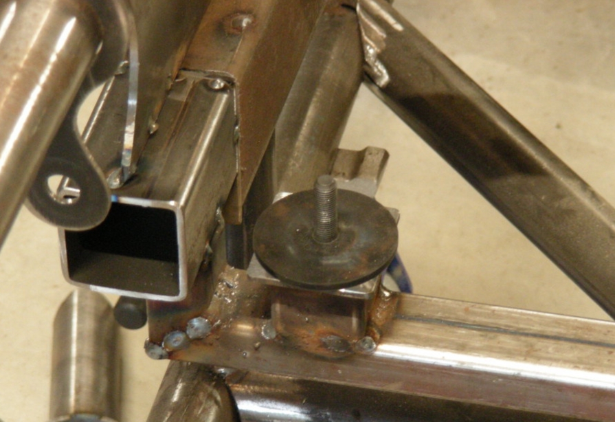

    Okay so I didn't make it out to the garage until today, as the back was behaving today. The 1st attempt at the bracketry didn't make the cut, so with 1 little cut on 2 of the parts I had cut out, and viola! I have the nose support hoop attached to the frame! Here's 3 pictures in whatever order they came off the camera's chip.
    DSCN1774.JPG DSCN1773.JPG DSCN1772.JPG Those who have back issues can appreciate that even the smallest of projects getting done is a big deal.
    The nose will attach to the hoop and the angle bracket lower right side of the last picture. And the radiator will attach to the hoop also, so the complete ***embly will be tied together, making for a pretty solid setup.

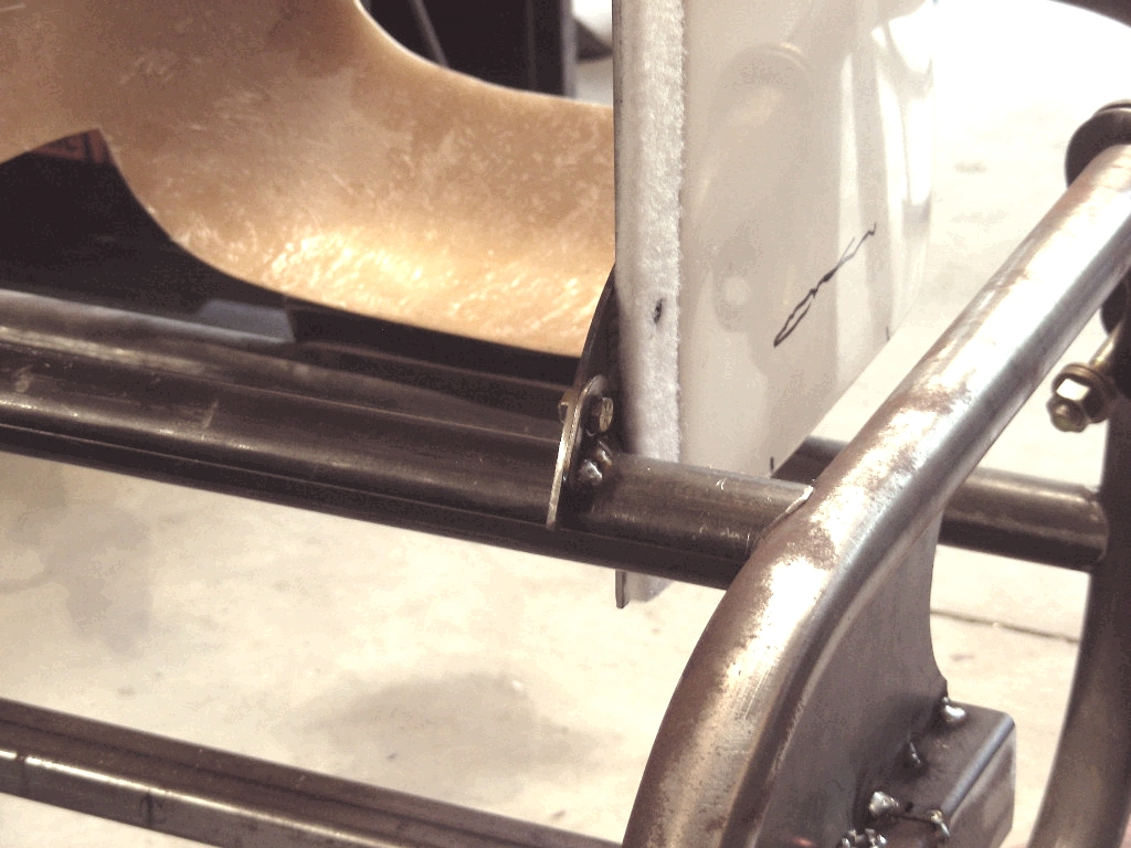

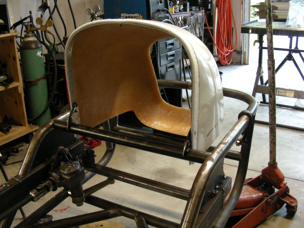

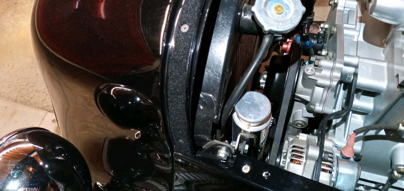

    So I have a question for everyone: I need to affix the nose to the support hoop. I've been considering flathead screws thru the flange on the nose where the hood and side panels will be, but I'm concerned about the screws pulling thru the fibergl***. The two could be permanently affixed to each other, but I don't know what adhesive or bonding agent to use. How about some recommendations?
  9. Flatrod17
    Joined: Apr 25, 2017
    Posts: 844
    Flatrod17
    Dave, I put the fuzzy side of velco on the nose and firewall to protect the paint. The nose is hold on with 8-32 screws cut into the fuzzy stuff. Probably 12 or 14 or so of them. I will get a couple pictures when I get back down in the shop.
    Tman likes this.

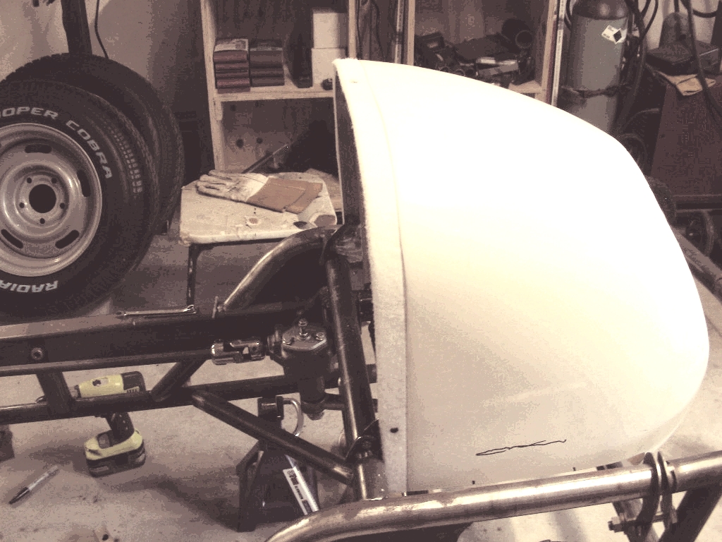

  11. Flatrod17
    Posts: 844
    Flatrod17

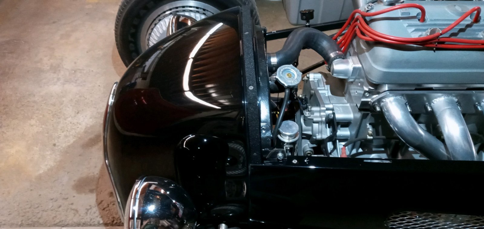

    pic's as promised.
    The original was hold on with twice as many screws, but I didn't see a need for that many, plus I have to remove the nose if I have any trouble with my surge tank. The screws are a counter sink type.
    Atwater Mike and Okie Pete like this.

  13. Flatrod17
    Posts: 844
    Flatrod17
    Its a gl*** nose. I can only wish I could hammer anything close that I wouldn't have to throw away! They are counter sunk in the gl*** and the Velcro was over the top of the screws. I didn't want to try to peal off the velcro (takes the paint with it) if I wanted to take the nose off, so made a tool to cut the velcro at each hole, so they are buried in the velcro and don't scratch the side panels paint.
    Dave G in Gansevoort likes this.

    Bought a bunch of Velcro and small socket head flathead screws to give the attachment of the nose to the support hoop as suggested a try. I'll get pictures and report back later...
  16. Dave G in Gansevoort
    Posts: 4,276
    from Upstate NY
    Progress, thanks to flatrod17 and his pictures! I think that the pictures speak for themselves, so here they are:
    Taking the fuzzy side of 2 inch wide Velcro, I wrapped it around the hood recess and wrapped it over the edge, sticking it on both sides of the nose. It leaves a good space for the hood and side panels when I get them made.
    I only have 3 screws thru the flange and support hoop right now, so the nose is still slightly deformed in a couple of spots. The areas will pull down to the hoop on final ***embly. And burying the screws in the Velcro really works great.
    20230628_174200.jpg It will also finish off the edge of the nose nicely.
    Now of course I will have to remove the Velcro before painting is on, and I'm not looking forward to either. Good thing about white. Believe it or not, it cleans up easily. And touching it up only requires a rattle can of refrigerator white, or fleet white.
    So small victory today, but it was a victory!
    ps: it also looks like a good way to cushion the front nose support.

  19. Flatrod17
    Posts: 844
    Flatrod17
    Dave, Good Job mounting the nose!! It looks like you have nuts on the back of the screws? Mine is tapped (threaded) right into the band. Will you be able to get to those nuts when the radiator is in place?
  20. Dave G in Gansevoort
    Posts: 4,276
    from Upstate NY
    Yes to both. There's sufficient room for the nuts to clear the radiator, and the nose goes on after the radiator is bolted down.

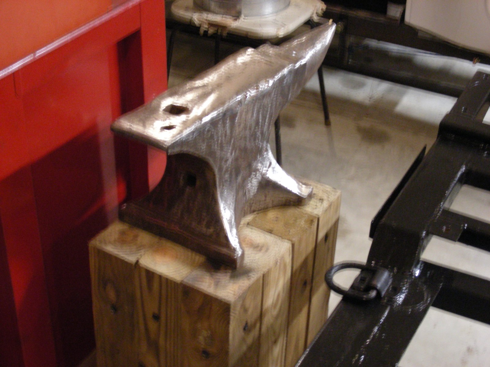

    Very good video! I made my anvil "stump" in a similar fashion. DSCN1262.JPG The anvil is the neighbor's, the "stump" is 12 chunks of 4x4 he had in his shorts pile. He's a former contractor, nothing gets thrown out. We get along fine...
    It's held together with leftover looong lag screws from another project. I think I'll be making another one from his leftover bits and give that a try. I even have a leftover piece of high density nylon 1 inch thick.
