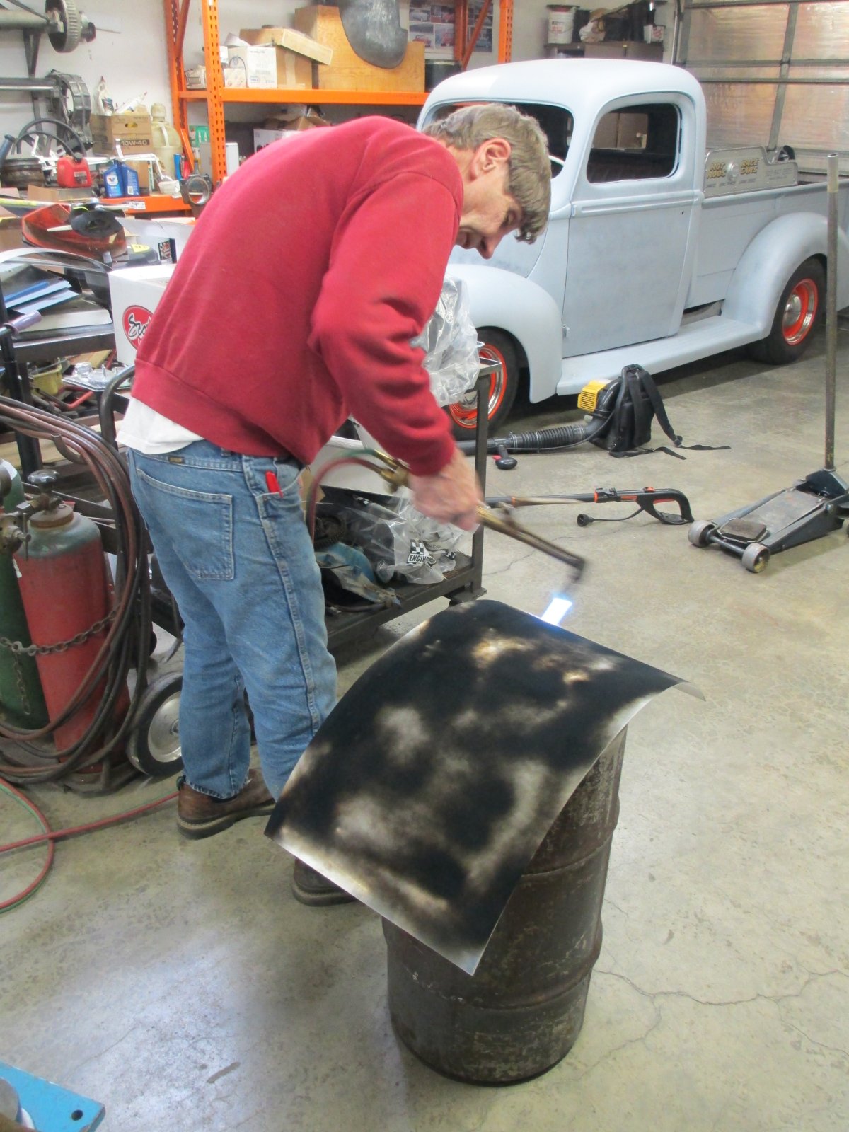

    That's what I use, here is an example that I annealed and beat into submission, and used a HF wheel to roll out the lumps. I used half hard, not dead soft. IMG_1700.JPG IMG_1702.JPG IMG_1703.JPG IMG_1704.JPG IMG_1705.JPG

    Way back in the modifieds days I used the half hard for internal panels and the hood and that big lump covering the injectors. But that all had no compound curves. In fact most were 90 degree bends in a homemade brake. 2 pieces of angle iron, a piece of 3/8×4 or 6 inch crs bar stock, and some barn door hinges. But it was only 20 gauge thickness.
    20220528_210328.jpg The nose was just a simple piece with 2 bends made around some 1 inch pipe. Amazing to think thru 4 seasons and 3 rebuilds changing everything but the seat, pedals, and the hood, that the only damage to the hood was inflicted by me by hand. Oh well I was young and had a bad temper in those days...

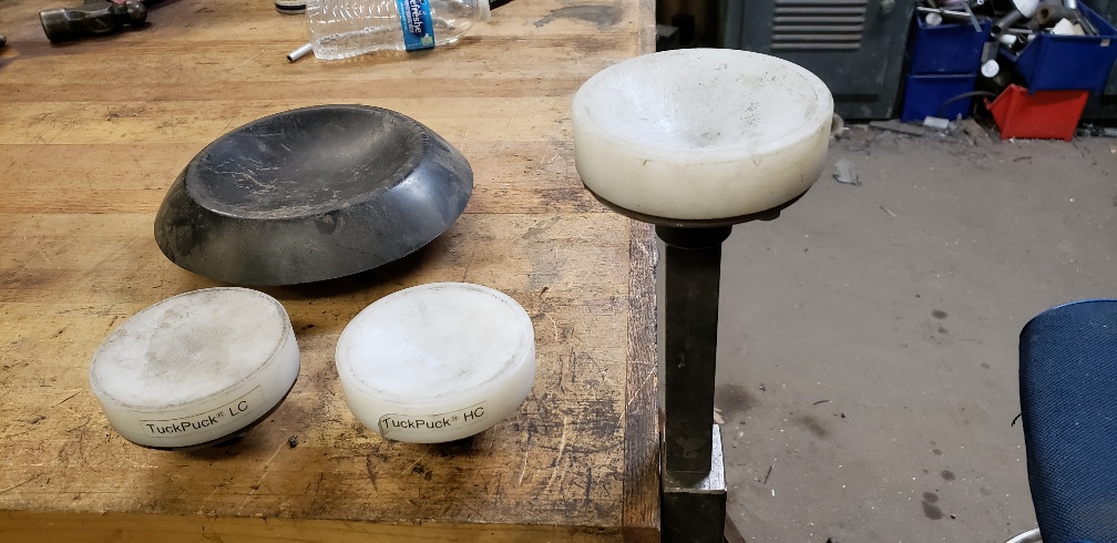

    Dave, the 1/4 scale Willys in my avatar was my first foray into metalshaping after watching videos and reading anything related to it. I built a station buck based on a 1/25 Revell model of the '41 and then a reciprocating hammer and an English Wheel from internet plans.
    I also picked up a number of Tuck Pucks which take the place of the dish in a stump, but never used them on the model. Rather all the shapes were done from the flat on the wheeling machine in 22 gage. The stump allows you to rough shape quickly, but with the thin metal I could not afford to stretch such small pieces. I have used them to shape other parts for my current project.
    There is a steep learning curve, but I have been able to apply those skills to the '50 Austin that drew me away from the Willys.

    Now that's an interesting concept. I could make a similar stand to fit the square hole in the anvil, and shape some pucks like that from the hd nylon stock I have on the lathe. The stuff works like wood, so fast and easy to make. Hmmm...

    There you go. I cast the bench block mount to match the Hardy hole in my anvil so I can use them either place.

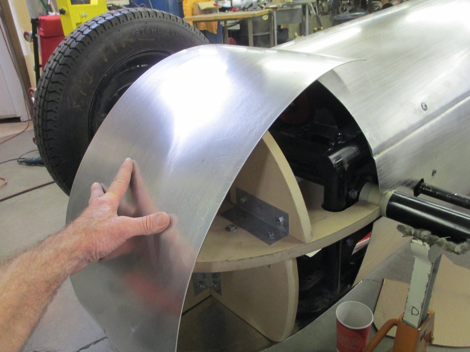

    Okay, so I'm even more conflicted about the grille now. I came across a Ferrari eggcrate style grille and it triggered a memory of another racecar grille, both of which look good.
    THF108089.jpg Here's the racecar grille. You may recognize it as the Unser Pikes Peak multi-time race winning car. And here's the Ferrari eggcrate style grille
    images.jpeg-2.jpg Both of them are nice. But how do I make one? FTFs nose, and more specifically, the insert, looks like a good way to get started. The slats I would think would be easy, once I have a contour I like. They can be cut out from flat stock to the required contours. And slotted to fit together where horizontal and vertical slats intersect. And I believe that I would silver braze it. And like I was thinking previously, maybe make it out of stainless steel. It should polish up really nicely.
    But it still needs the outer surround part. Should I still attempt to make it in one piece and then cut away what's not needed? And like FTF, make a hoop type of thing trimmed to the outer contour of the nose, welded or brazed, to give something to attach the slats to?

    And I've been rereading FTFs posts about his nose and grille! This time I bookmarked it so I can get back to it easily...

    Dave, I had bars laser cut from 3/16 - 6061 sheet, for Dennis Webb to build the grille for the Spalding copy roadster. After all the trouble, Pat acquired an original Art Engels NOS grille.
