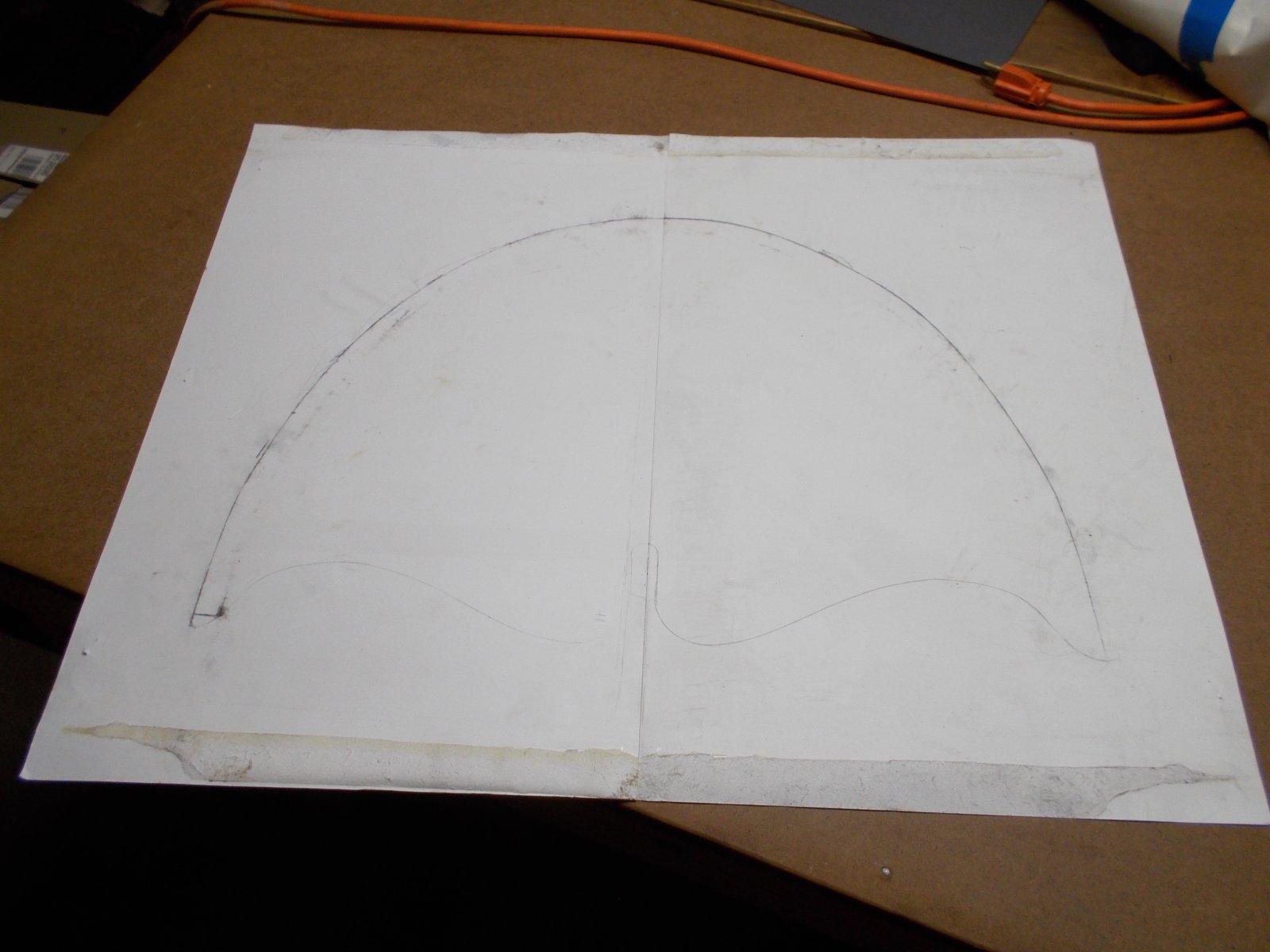

    From my days in vintage aircraft restoration, make parts out of card stock. Easy to cut with scissors and hold together with tape. Measure many times before cutting the aluminum and make the parts slightly oversize and trim to final fit. I saw many builders with barrels of s**** aluminum in their hangars. Card stock is much cheaper.

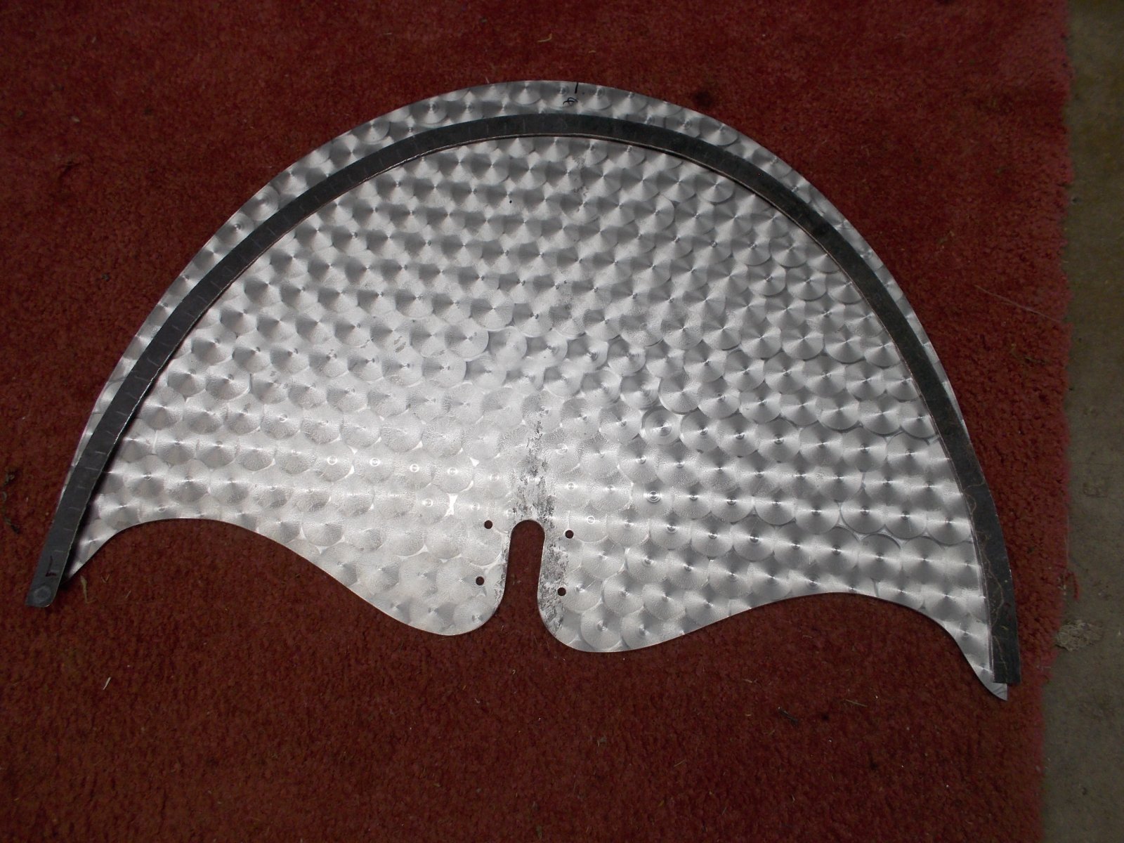

    That design is very similar to what I want to end up with. My local metal supplier lists 1/8 x 1/4 aluminum bar stock in their inventory. With my recently completed edge bending and un-bending fixtures I plan to use bar stock, make card stock templates and form the appropriate arch and TIG them into the underside of the surround. I am still not entirely happy with my surround so job 1 is to get it to a happy place. Then add the bars. For your dear readers who do not follow my champ car build I will repost pics here if you please, along with a pic of my home built E-wheel, which I fabbed because I wanted it tall enough to fit my frame comfortably.
    EDIT: Now I am wondering if it would be possible to make up some simple edge bending dies for an English wheel? I had a Diacro bender available, so that was an easier route for me but I can see the posibility of a 3-roller die set for an E-wheel, no? Maybe even powered by a cordless drill??

    Yes I believe in CAD, cardboard aided design. Marty recommended that I get floor protecting stock at a big box store, as it's also cheap, and can make big templates.
    You may remember the butcher's paper hood pictures earlier on. It took 6 or 8 layers to get it stiff enough. But it's not really practical.
    And ftf, I've been revisiting your thread as well. I was looking at the bending fixtures you've done, and looking thru the available stuff to make things out of. I've got gears and bearings and other ***orted things that might look like a bendy rolly thingie sort of device for use in the press. Hey I designed an earthquake simulating test rig decades ago at Battelle. I ought to be able to make a simple bending fixture.

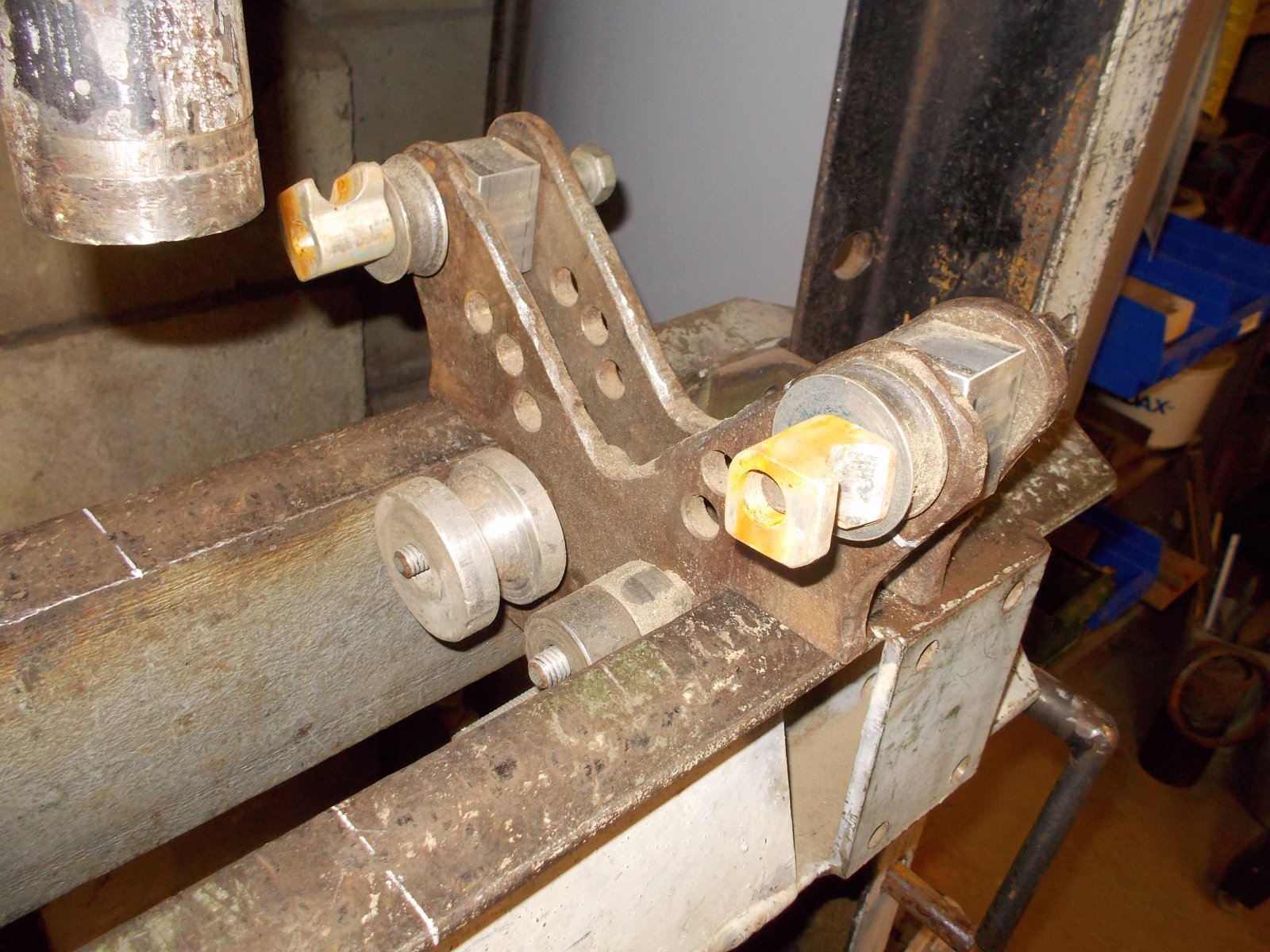

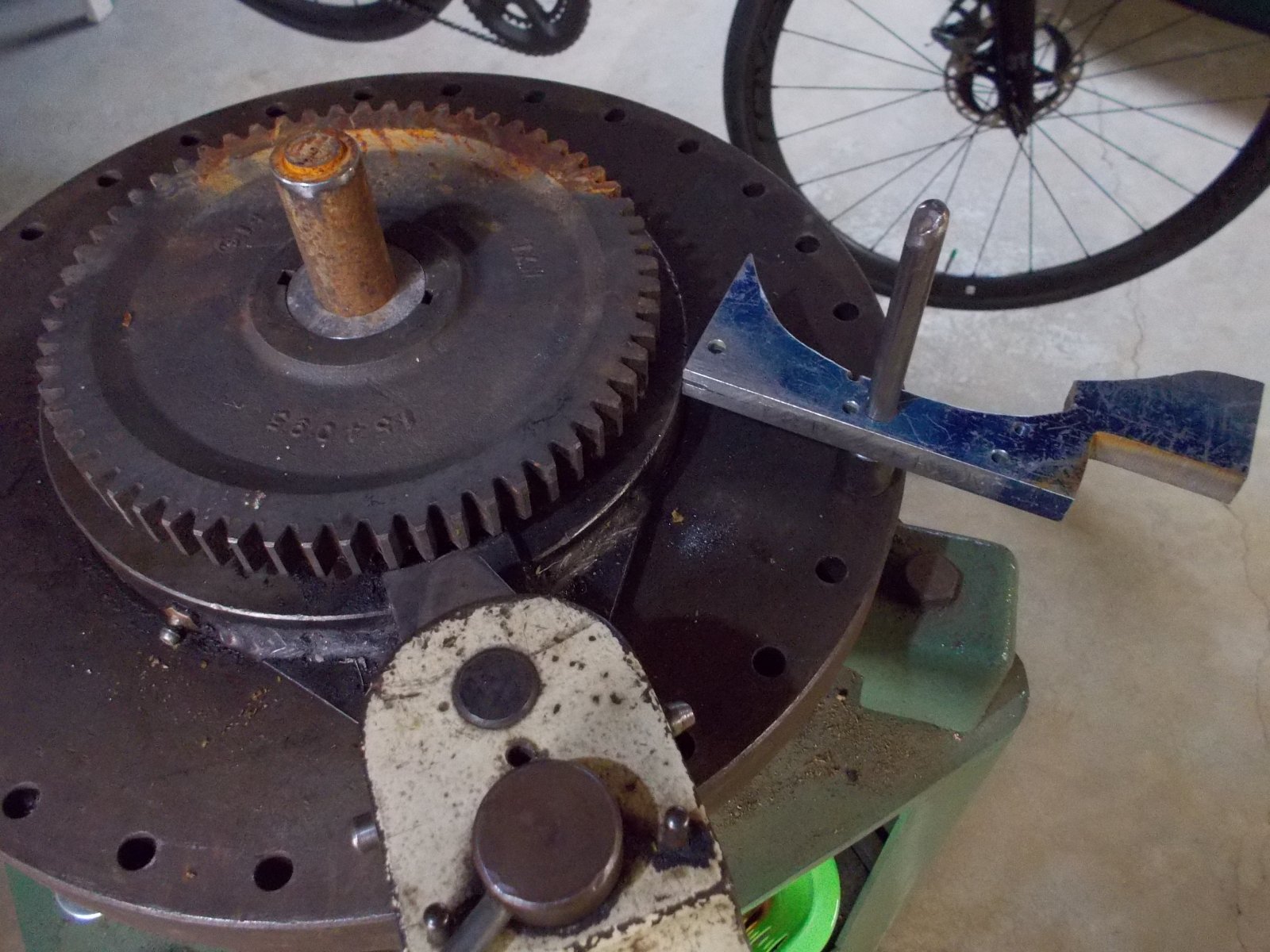

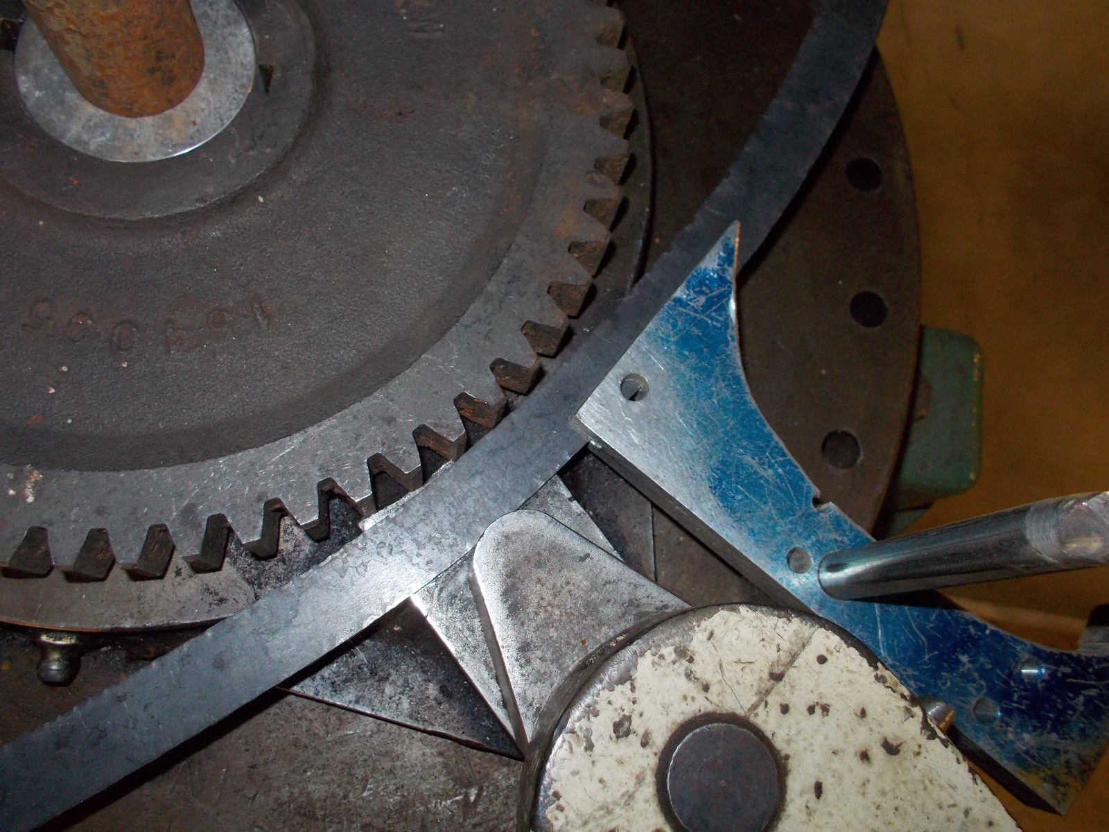

    That is correct Dave. I've never seen how champ cars attached the instrument panel to the cowl so I decided to make a curved flange, welded in to the cowl. I imagine the concept I am employing is not unlike results you can get with a ring roller and special dies. Not having one I decided to use a DiAcro bender and make a bending fixture from an old tractor gear and s**** aluminum. I made one fixture to bend and another fixture to "unbend" since there were places where I put too much bend in the flange and I had to press some of it back out. In this case the flange is 1/16" 4130 and I'll probably just drill-n-tap some holes around it and hold the panel down with small screws.
    For the nosepiece grille bars I can envision using the bender to add gentle curves and welding them all to the underside of the surround. I may weld them on flush with the surround, or I may weld them to the backside. Dunno. I'll probably sand all the bars down a bit to get them even before polishing.

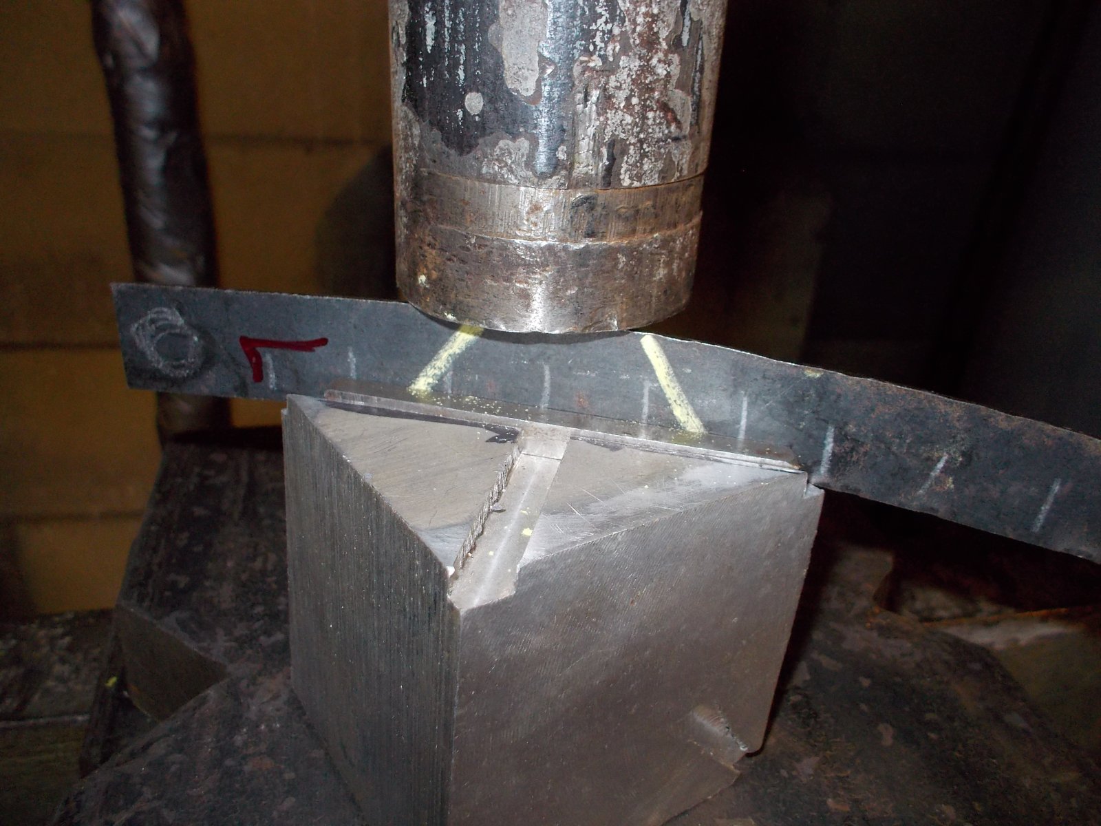

    Your debend fixture gives me an idea for a bend fixture for use in my shop press. I'm going to make it this week and see if it works. I'll post results. For those of us who don't have all of the shop toys, yet!
    THE FRENCHTOWN FLYER likes this.

    ...maybe something like this, with the appropriately sized shoes and roller dies?

    I think it's going to need side guides to hold the metal from twisting. I'm thinking that the side guides would be sort of like the guides on bandsaws. Only made beefier to control the possibility of sideways deflection. So the lower portion would entail 2 substantial bushed rollers, to better withstand the downward pressure, and 2 guide blocks, for lack of the proper term for them, for each side of the bar being bent on each side. Total of 4.
    The ram would need a similar arrangement, and also be constrained to not rotate under pressure. So once again plaigerizing your ideas, and adapting to the jod at hand.
    Yeah, I know, I'm the "Great Plaigerizer"! You've inspired me to greater heights... and depths! So first I've got to make a surround for the nose, like you did. And I have most of the materials to cobble together a bending fixture. Then to decide on thickness and width of the bars.
