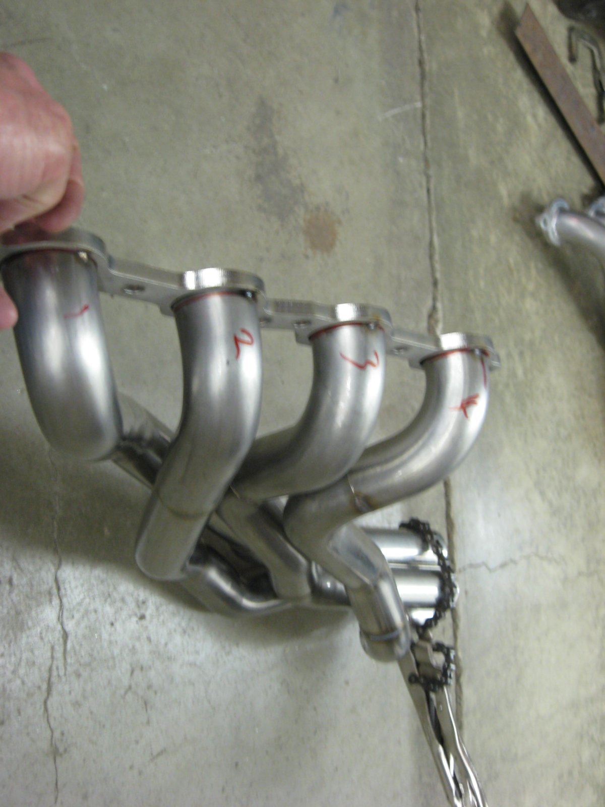

    I agree! Worked on the headers today after getting a couple of those chain vise grips. Really helps hold things in place. Got the left side mocked up and bolted to the engine. But there's trouble right here in River City!

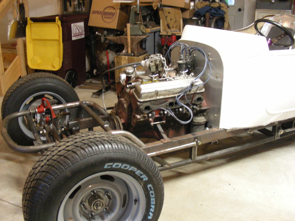

    So here's a few pictures of the progress today. And the ugly mandrelish thing made from railroad spikes (Thanks Don...).
    I seem to never get the pictures in a sensible order, so from the top.
    Closeup of the left side header. Marty, you were right, the chain wrenches were just the ticket.
    The 2nd picture is from slightly above and a little bit more of the whole car. The tubes seem to angle down from the flange, but the vertical portion seems to be good. And the tubes into the collector run at the same angle as the frame, which is just right. And parallel to the frame as well.
    The 3rd picture is the squaring thingie made from railroad spikes. A little welding, a little grinding, and viola, I had a useful tool. I was even able to use it to get a couple of the squared ends turned a little bit to better make them line up. Lucky I guess...
    The last picture is from closer to the floor to give an idea of the downward angle the tubes make. I'll probably have to live with that angle.
    So, opinions, suggestions, just plain old ball busting?

  26. GearheadsQCE
    Joined: Mar 23, 2011
    Posts: 3,669
    GearheadsQCE
    Alliance Vendor
    Dave,
    I've seen headers that had the tubes truly horizontal. They looked awful. They were made with the tubes installed at an angle to the flange. The eye doesn't appreciate that. I don't think the flow would be as good as what you have now.
    If you really want to have the primaries horizontal, they should have an upward curve section before going straight.
    JMHO
