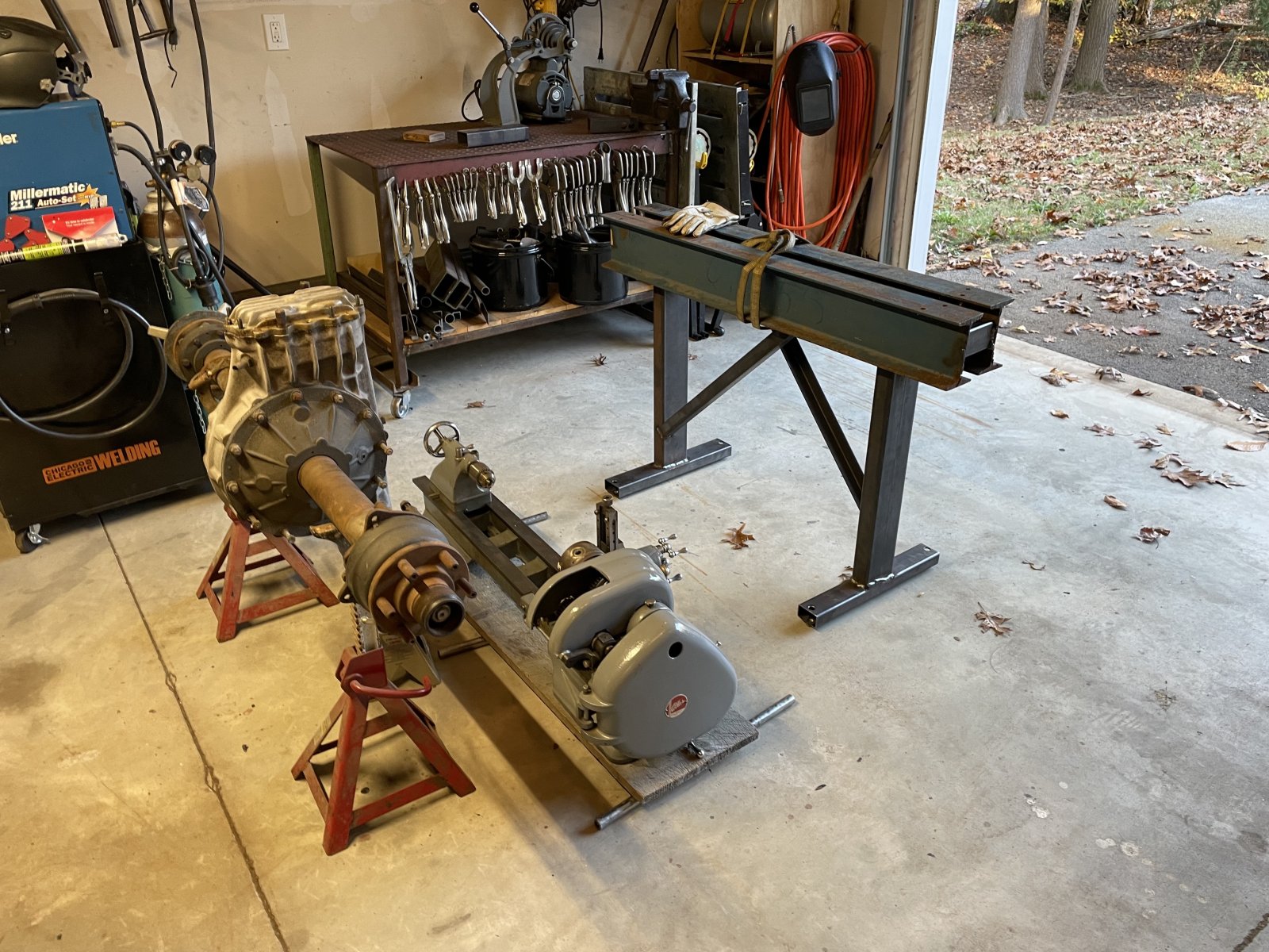

    Well everyone, ratrodder got a new to me lathe over to my garage this past weekend. We spent the day Saturday making a stand for it out ov some scavenged i-beams I had, plus some random box tubing and angle iron. Still a couple of details that need to be addressed, but the kid can weld pretty good. No pictures yet.
    I'll get back to the garage when I p*** a kidney stone in a day or two, so that's all the news that is fit for print.
    And thanks again to the 2 guys that made a new lathe to me possible: ratrodder and zeke. Give me a couple of weeks and I'll be turning stuff out like nobody's business...

    Here's where we found ourselves last Saturday morning: Lathe & Whatever.jpg
    Next step: build something to get the lathe up off the floor and at a comfortable working height!

  8. ratrodrodder
    Joined: Feb 19, 2008
    Posts: 415
    ratrodrodder
    from Boston
    After a bit of rummaging through the parts piles, we came up with some "s****" I-beams of a suitable size, some leftover bits of steel, and a few wild ideas. Time to get welding! Lathe stand parts.jpg

  9. ratrodrodder
    Posts: 415
    ratrodrodder
    from Boston
    A few hours later, with barely any grinding done, we had ourselves a welded, sturdy stand, ready to be moved into final position. A wooden top to connect the stand to the lathe, a tray at the bottom of the stand for some additional m***, and maybe some paint, and we'll be in business!

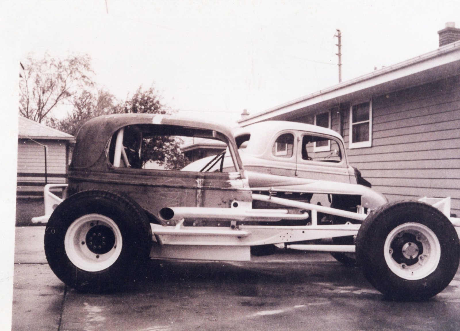

    About 1979 I used a Watts link on the front of the QC. My super late model ch***is. I made the seal plate and used an img261.jpg Oilite bearing. About a 10" roll center. You can see the left frame extension for the left link. I continued to use the Watts link on my road race ch***is. Speedway Enginering came out with one like mine later.

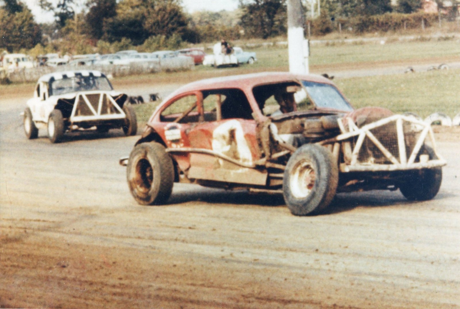

    Here's a track nose I built 1966. I used the round part from a 1950 Chevy truck hood. Can't find the nose picture. Ran without the nose because of over heating. I installed this 34 Ford truck grille s img076.jpg img082.jpg hell for 1967.

    And to think, when you built it, deuce frames were still available and nothing special.

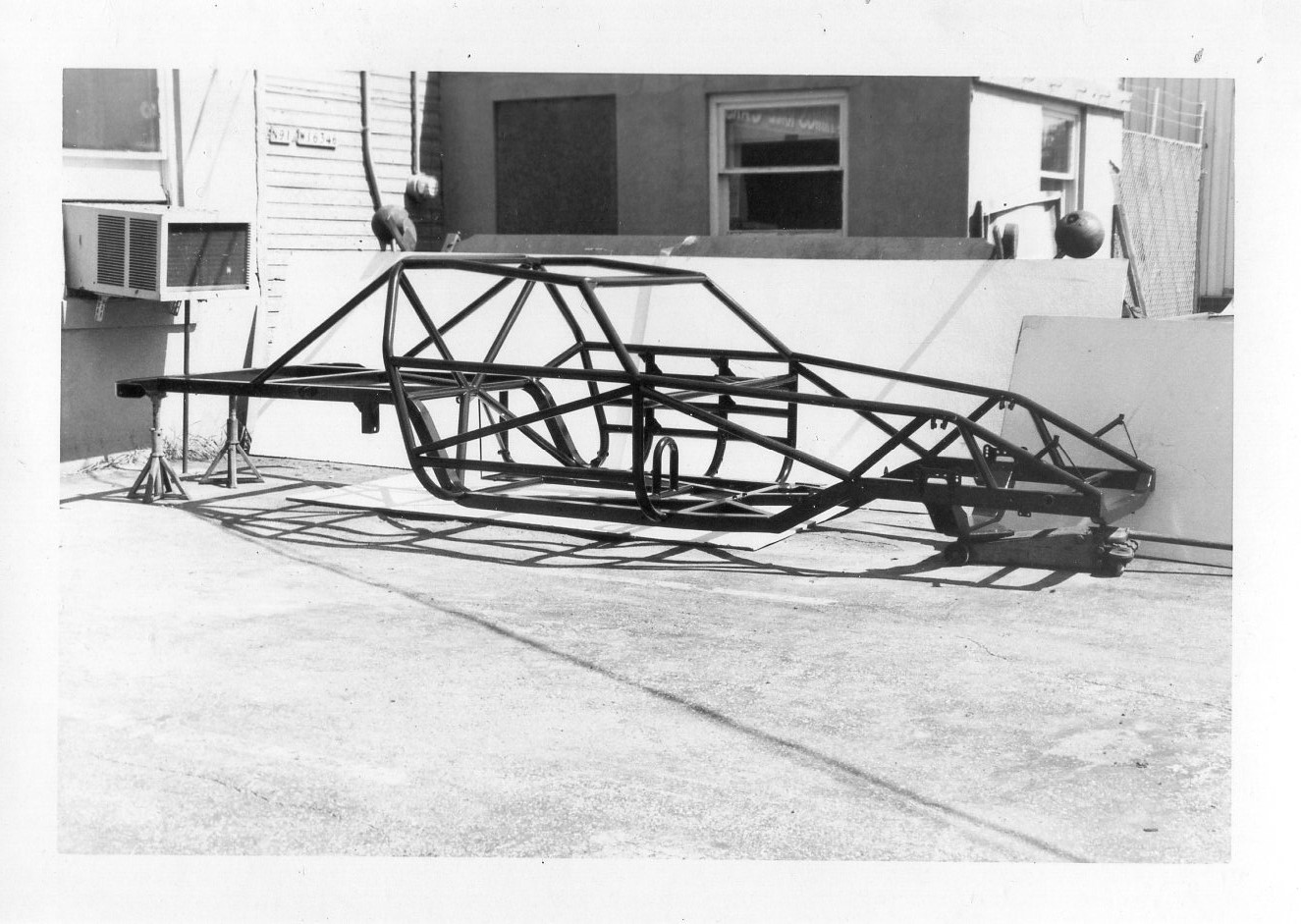

    And did you ever cross paths with Jim Langenback from up here in the northeast? Most of the tracks around here required car frames until the early 70s, Lebanon Valley allowing 2x4 tube frames in the modifieds in 73, and in the limited cl*** in 75.
    But Jim built the 54 coupe with a Tobias tube frame from plans. For 1974! And Paul, tech inspector, went to Jim's shop and okayed it i the building stage. Jim used a Ford station wagon frame, sort of.
    In reality he did just like you, and made a 2x4 frame, and added big gussets on the inside of the kickups to match the shape of the Ford frame. And welded arcs to make the rails look like they were factory formed and Jim added big gussets instead on the outside of the kickups for aded strength. And wlds simulating plugging the hole in real frame rails. All of that is to get around the rules just like you did. It evolved over a few seasons into a Gremlin bodied car, and is still running in vintage circles up here.

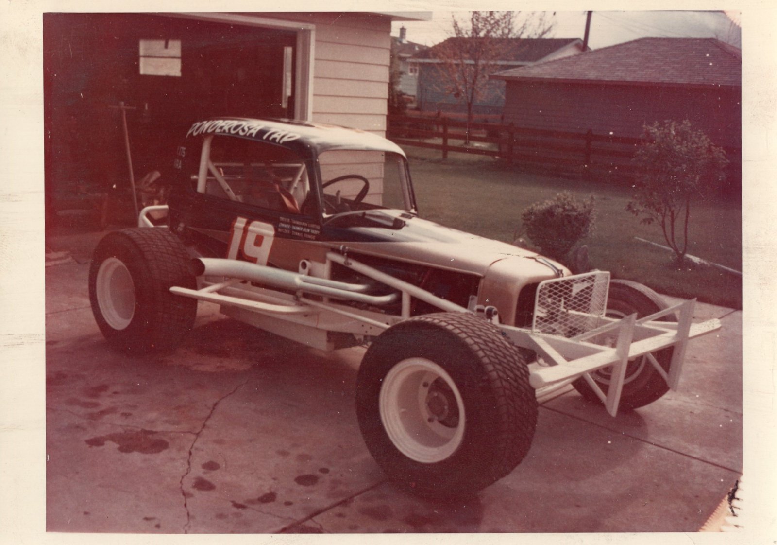

    Here's a picture of the thing opening night 1974, its first time out and its first win:
    IMG_20201013_0005.jpg Yes, you can see his feet. The engine ran hot with the side panels, so off they came. Good times!

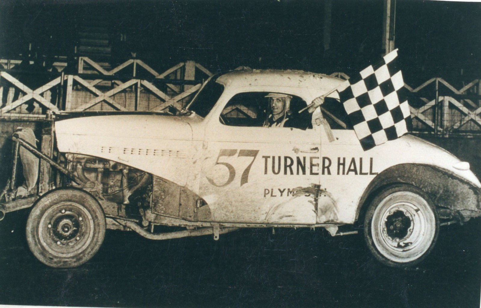

    Karl Kulow Plymouth Wisconsin 1953. This guy was so good and so smooth. Chevy coupe with Ford front suspension and a G M C engine running against flatheads. I joined the Air Force in 1954. I think Karl won the M S C championship [ 4 tracks ] img343.jpg img344.jpg in 1954 and he ran # 1 in 1955. The change over had begun from hard tops to modifieds. They thought the Henry J was smaller. # 1 now running an Olds V-8. Look at that camber . That's a hard top behind.
