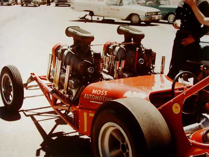

    And all this then begs the question of what am I going to do with two 327s and a peashooter 283? I'm thinking it's a tough decision ahead! I'm up for it however. Brother of WHATEVER maybe. I keep collecting parts, so who knows what the answer is...

    Widen
    or lengthen
    enloe, brEad, loudbang and 2 others like this.
  24. DDDenny
    Posts: 23,418
    Also gotta wonder how long that rearend lasted!
