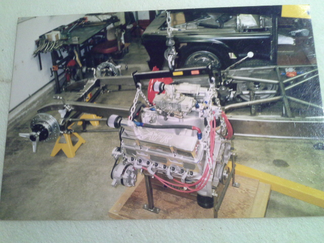

  3. DDDenny
    Posts: 23,426
    Dave
    Here's the 355 in my moms' garage about 1975.
    swade41 and Dave G in Gansevoort like this.
  4. Dave G in Gansevoort
    Joined: Mar 28, 2019
    Posts: 4,283
    from Upstate NY
    Here's mine, same timeframe
    20220529_212658.jpg Outside of my mom's garage. 492 angle plug heads ported by Mondello, Hilborns on methanol, Reed roller cam, Vertex magneto, and 14:1 compression ratio. No idea what it put out, it was compe***ive with the typical carbureted big block engines running a single 4 barrel on gasoline. Those engines ranged from 440 cid, to just around 500 cid. And on 12% nitro one night, it ran like the proverbial ****d ape, leading 33 laps of a 35 lap feature. Ran out of fuel with 2 laps to go. 40 gallon sprint car tail tank! Had maybe a quart left... too many cautions that night.

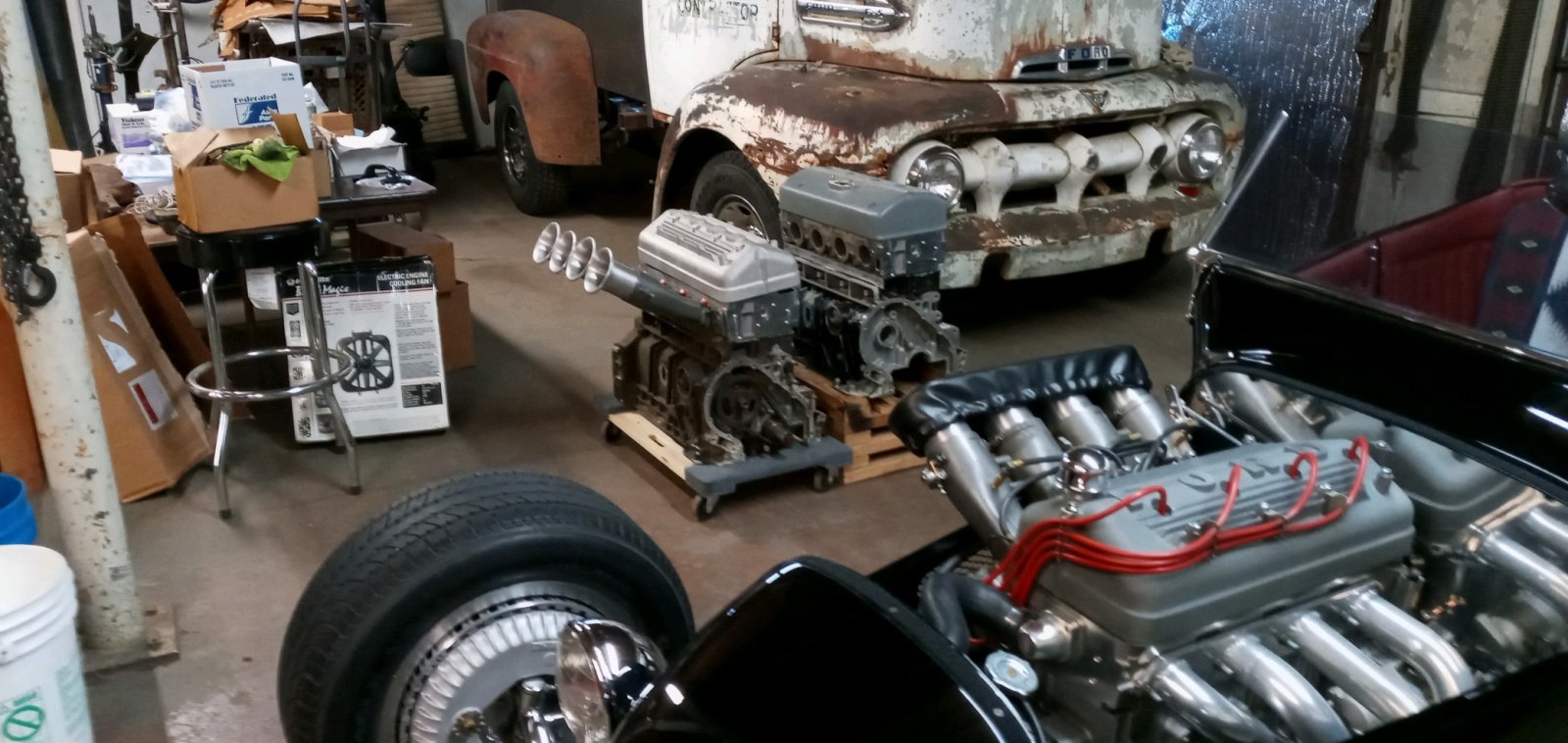

    And I could see flatrod17 using all 3 of those I4 engines. 2 in a streetable car has been done, why not 3? 12 cylinders, 3 engine management systems, side by side engined. I can see it in my head...
    On the Whatever front, the garage is essentially cleaned up, with only one small pile of stuff on a portable bench to get sorted and stored away.

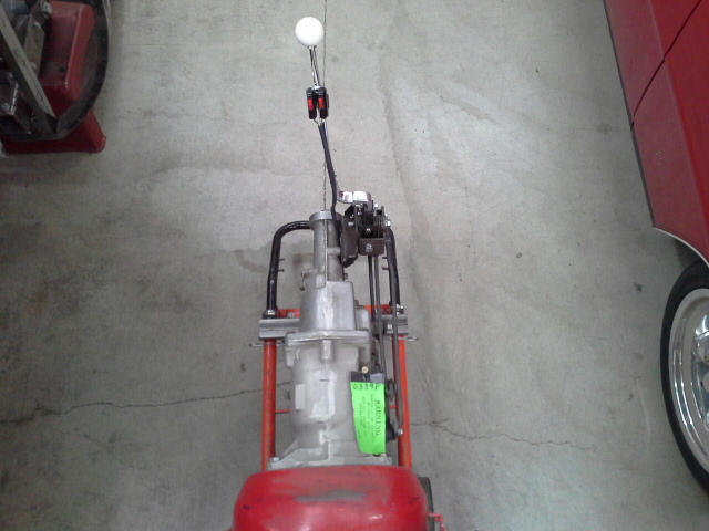

    DSCN1926.JPG Starting on the T10 transmission. That big shaft needs to go inside the transmission! One of the cases will be filled with gears, bearings syncros, bits and bobs, and all of the required stuff that makes a transmission transmit. I just need to get a rebuild kit for it. Got a few sources bookmarked and I'll be calling them tomorrow.

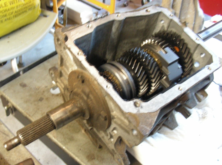

    Got the T10 apart today. Found a little surprise inside. You may remember the transmission was shortened for use in a dragster. It was also modified on the input shaft to bang into high gear... kind of like a poor man's dog ring transmission system. There's a custom machined thing welded to the input shaft where the synchro ring should be. Nicely machined and the welding looks like it belongs on an aeronautical object. But probably terrible on the street.
    So now I'm searching for sources for a new input shaft. 2.20 low gear close ratio T10. Anybody who has one that could be for sale, let me know.

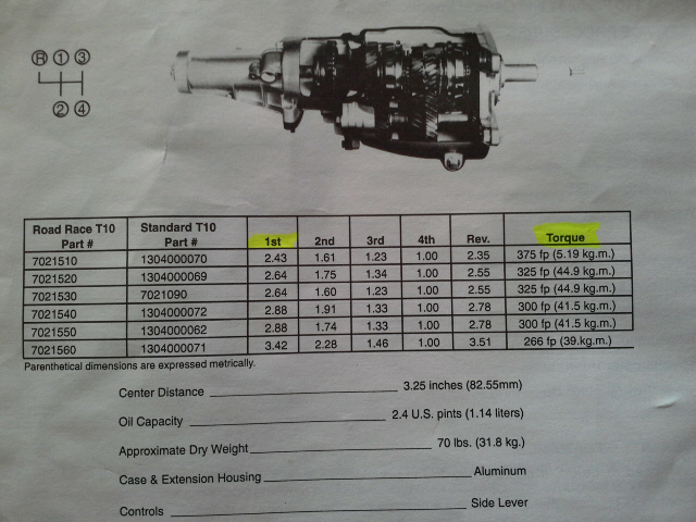

    Posts: 23,426
    I paid $1300.00 for my trans new from ? Summit ? but that was over 20 years ago.
    That price did not include the Hurst shifter.
    The neat thing about these is the availability of different first gear ratios, mine is the 2.43 version, note torque ratings.

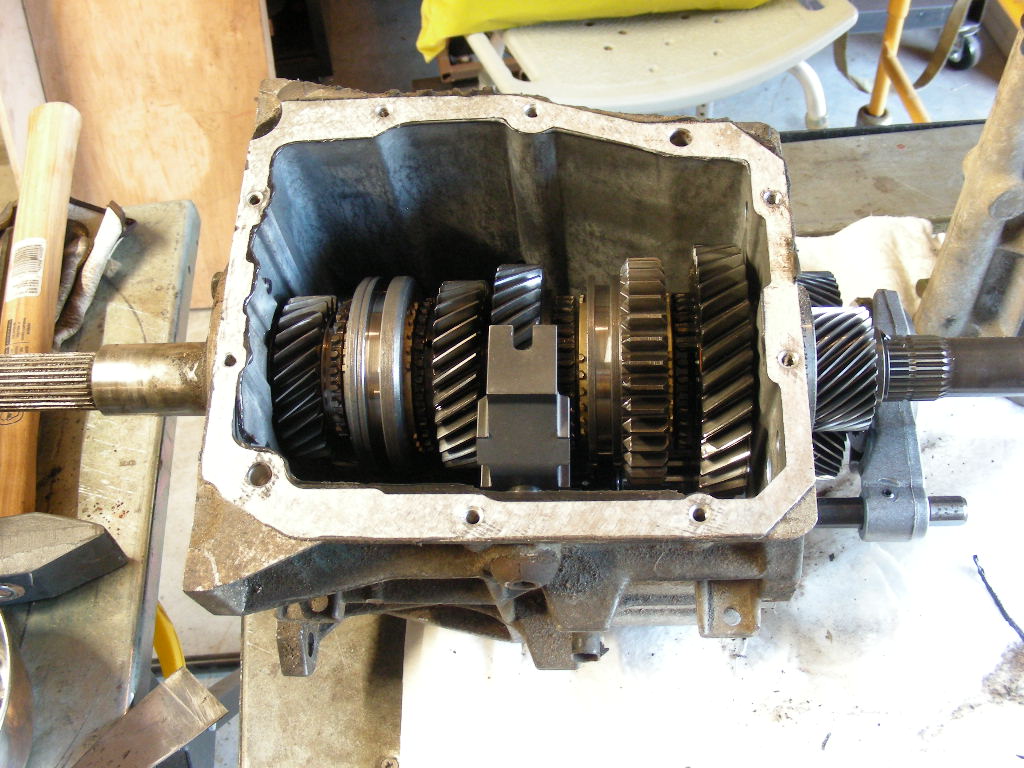

    Oh well... I tried! But instead I'll show you some pictures of the modifications done to the T10 transmission gears.
    The input shaft. Look at that thing welded on where a synchro ring would have been.
    20240423_175213.jpg And one of the sliders. 2 out of every 3 splines missing...
    2nd and 3rd modified the same way. And no synchro ring on 1st gear. It's otherwise not modified. So once I have replacement parts for it I'll get it back together. So now on to other things...

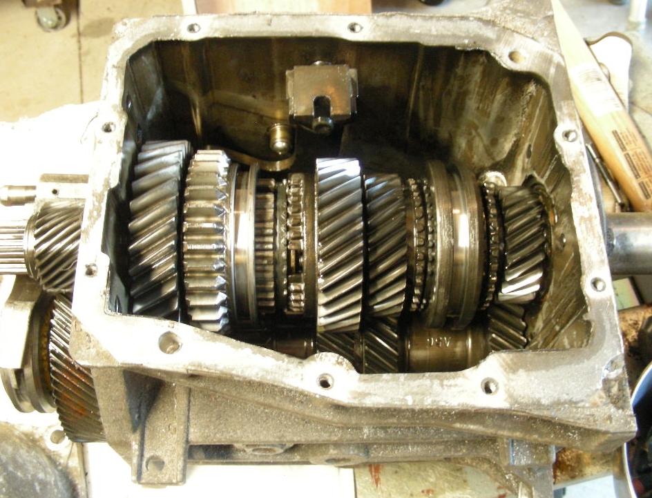

  29. Dave G in Gansevoort
    Posts: 4,283
    from Upstate NY

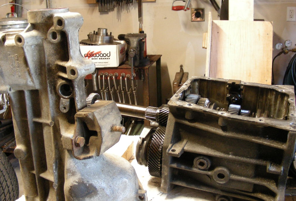

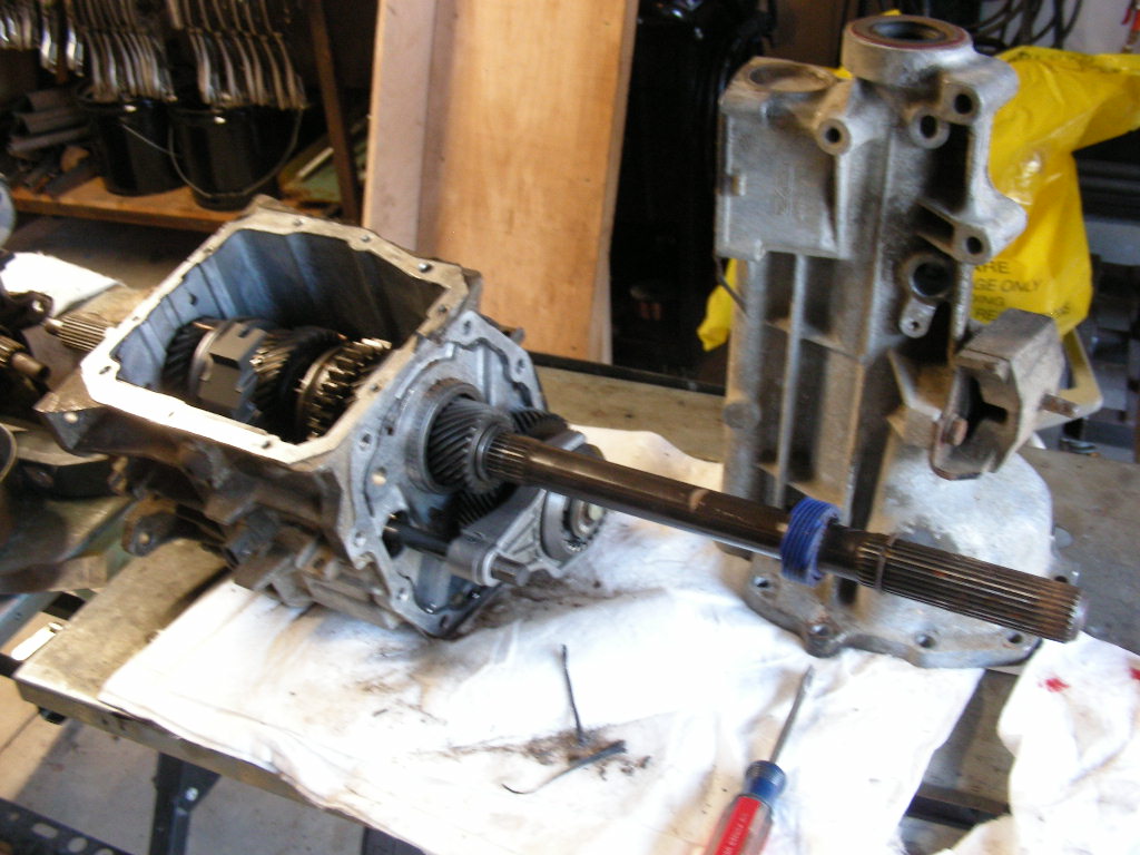

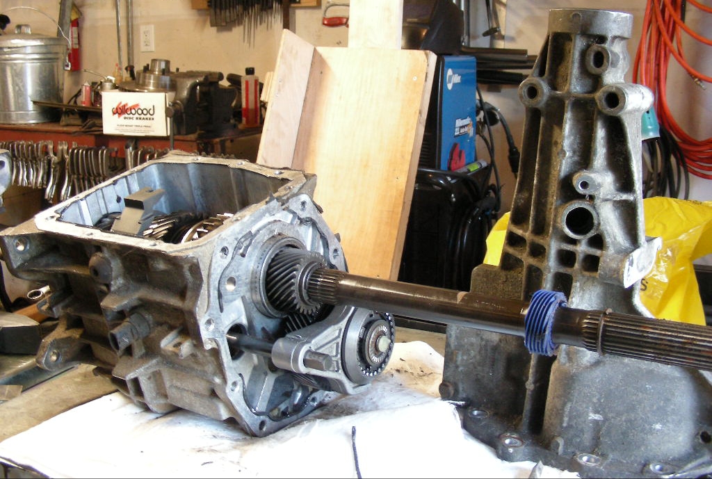

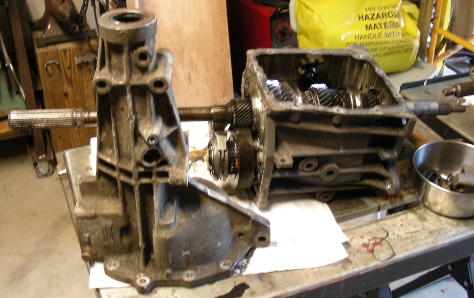

    Started working with the two T5 transmissions today. They came apart easily, and the insides of both look clean and in good condition.
    So in no particular order...
    S10 transmission with the Camaro tailhousing. Anyone need a good condition S10 4 banger T5, but with a camaro tailhousing, come and get it! I'm not going to put much effort into it, other than bolting it back together so it stays clean.
    This one is a V-8 Camaro T5. It looks like it either wasn't used much or someone had it rebuilt. It's a NWC T5 with br*** synchro rings. Mechanical speedometer drive.I
    Back to the S10 T5, but its original tailhousing sitting next to it.
    Here's the insides of the S10 T5. Nothing wrong by the looks of it.

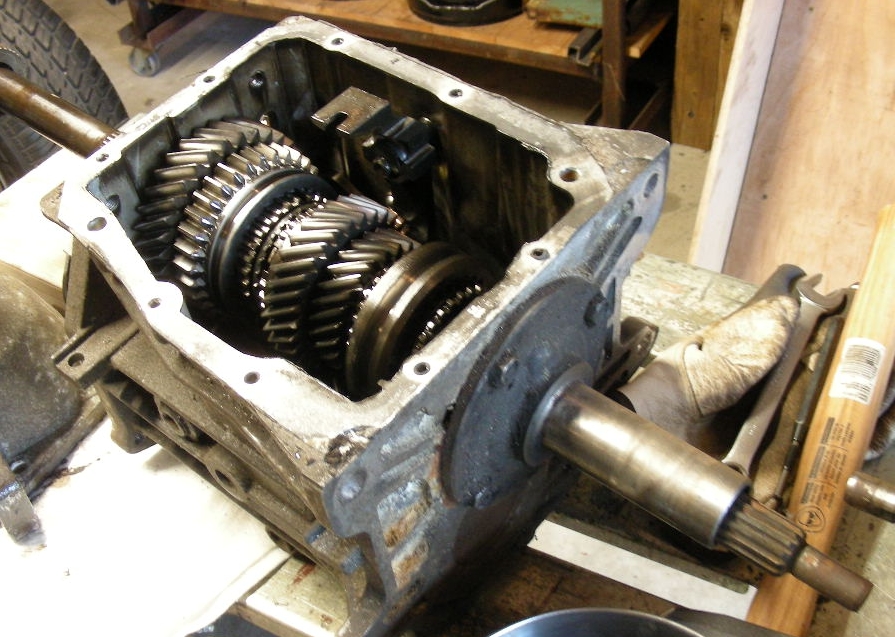

    Same
    Camaro V-8 T5.
    Same. Looking good inside also. Those br*** synchro rings are in good shape. Not going to do anything else inside, just bolt it all back together.
    See that plastic speedometer gear? And the other one has a metal tooth wheel for the electronic speedometer sensor. And people say there's various ways to make an adapter. Well, I've got an idea for an adapter. And a lathe now to make it. I'll attempt to make the electronic speedometer sensor wheel position where it needs to be. I can see it in my head, but can't explain it yet. I'll be working on the idea tomorrow. We'll see if it's a good idea or a nightmare...
    brEad, loudbang, X-cpe and 1 other person like this.
