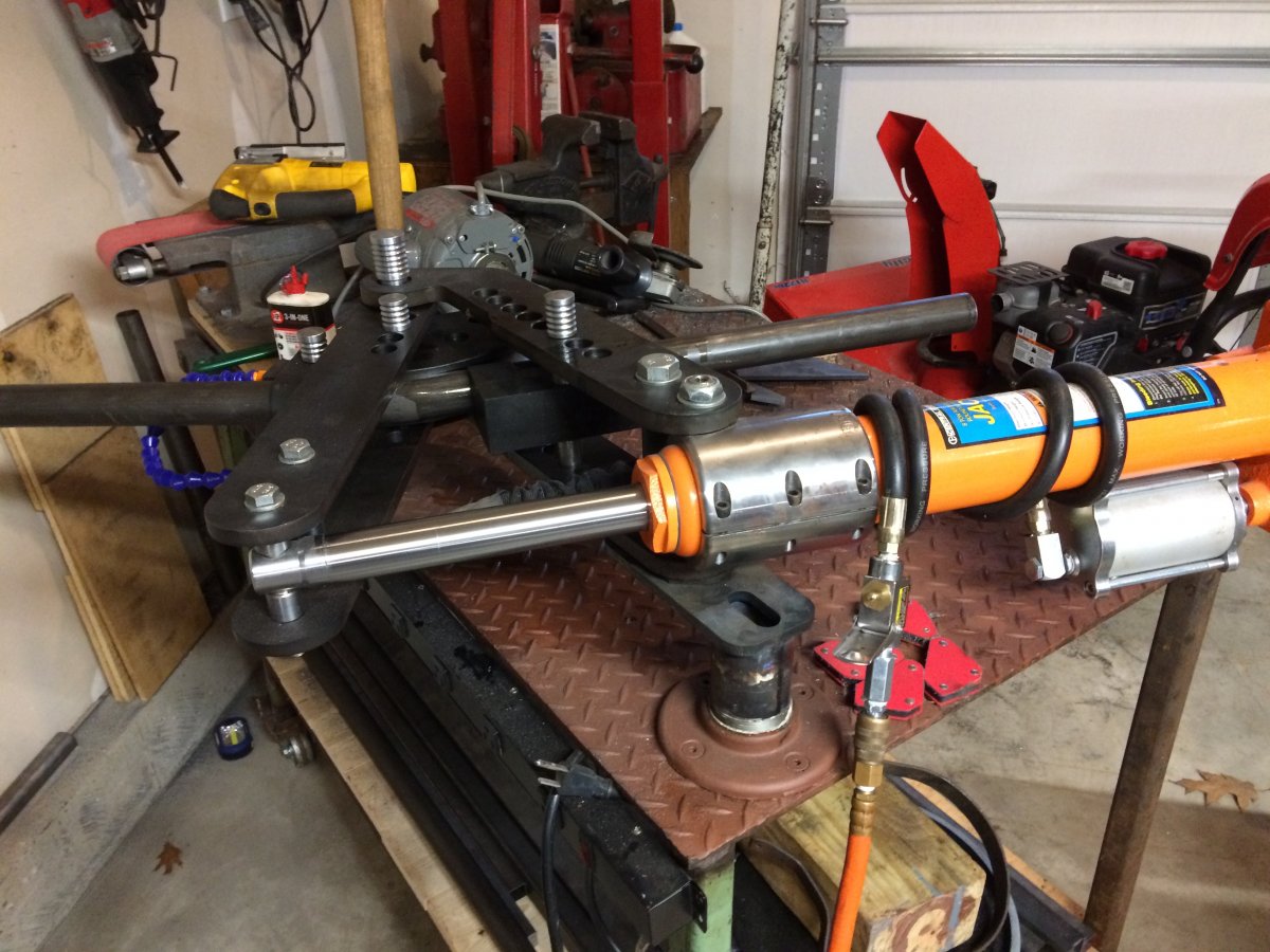

    I also started the under bars for the rear end of the frame today. I got new DOM tubing about a week and a half ago, and just cut the first section up and bent it: IMG_1195.JPG There are 2 of them. I have so far been learning how my new Eastwood tube bender works. I bought a kit from Swag Offroad that converts it to use an air over hydraulic cylinder, sourced from Harbor Fright. I have a small Harbor Fright ultra quiet air compressor that runs it just fine, in 10 degree increments between run cycles. I;m going to get a 2nd one and one of their aluminum tanks, to increase capacity, as the one I have is just so quiet. I have a large Craftsman compressor, that I hate, it buzzes when it runs, its an older oiless compressor. I bought it 22 years ago, and its practically brand new, I've used it so little. Now I mostly only run it for media blasting, as itruns just fine for that.
    So here's the bender: IMG_1194.JPG I only have dies for you, er that is I only have dies for 1.5 dia. tube so far. Maybe more this winter.

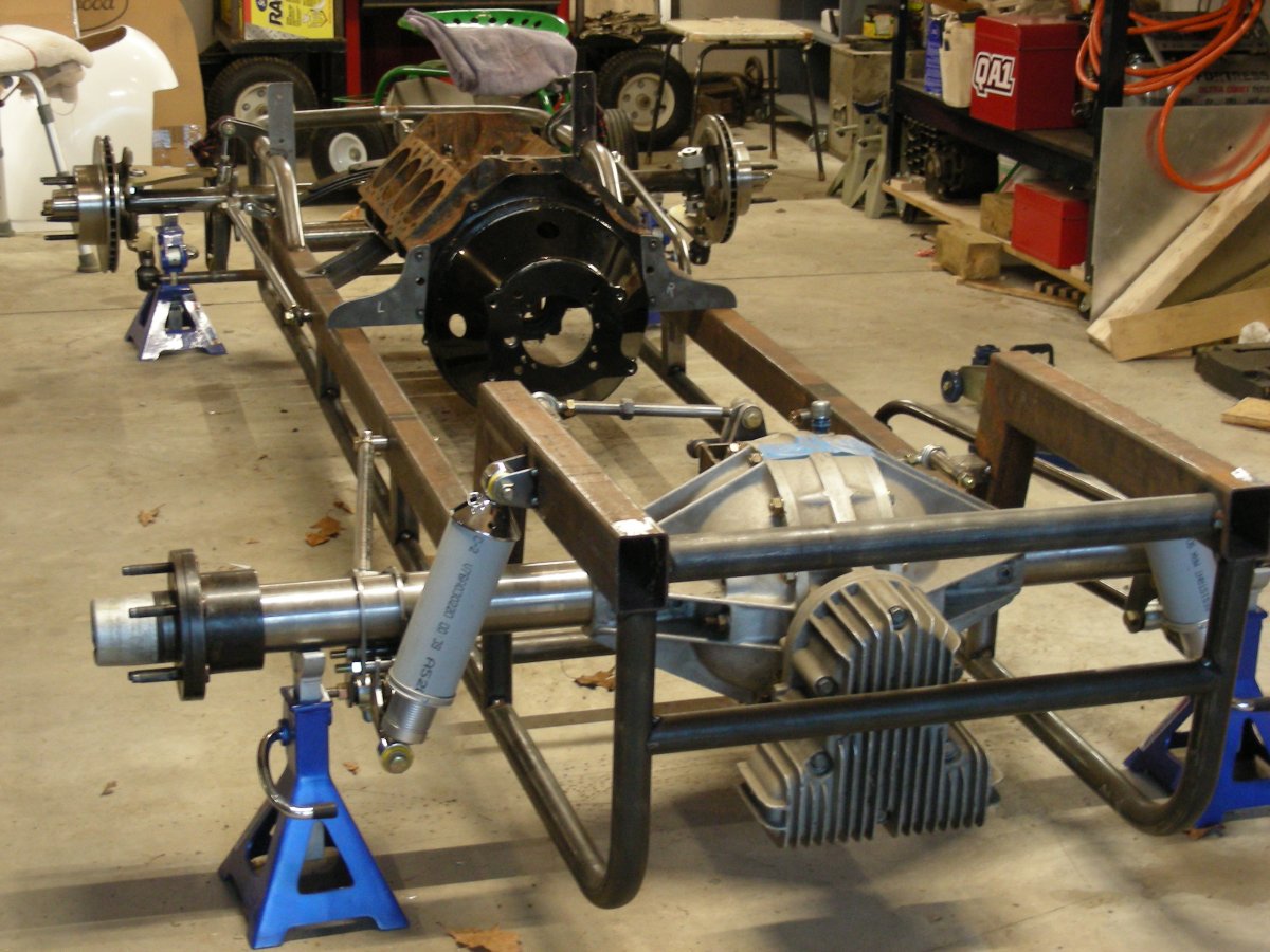

    Today I got most of the under structure fabricated and tacked into place. And my BIG brother told me that before I did the tack welding, I should show a picture or 2 of all the binder straps holding stuff in place. Kind of like you can never have too many clamps. But I just never seem to be able to clamp stuff when working with round stock. Binder straps given enough thought however, do the trick for me. DSCN1053.JPG And: DSCN1054.JPG So aftercutting, mitering, deburring, cleaning, taking a break to help the neighbor across the street make a hand rail for his wife's access ramp, I got back to tacking stuff, and here's the results so far: DSCN1059.JPG DSCN1059.JPG Now I need to get with it and get some wheels, 15 inch with a 5x5 bolt pattern. I'm thinking 10 inches for the rears and 8 inches for the front. Then a few diagonals, steering, a body! and so many things I don't want to think about right now... More after the weekend.

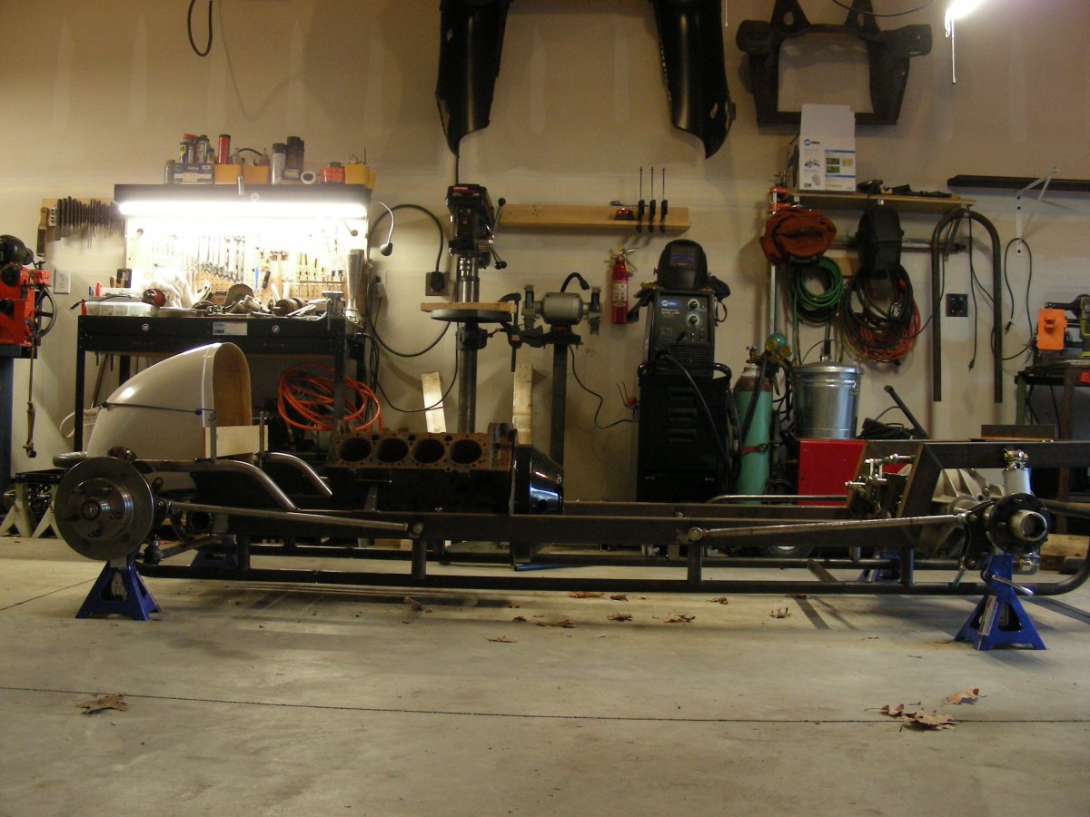

    DSCN1062.JPG Here is a side shot of the "Whatever" project ch***is. Hopefully someone who is computer graphic literate and has seen pictures of Greg Lazzerini's roadster, will come up with some ideas of what a similar idea would look like. I'm open to anybody's ideas.
    Oh and the wheelbase is 99 inches. Please help an old f@$# who has no artistic ability, let alone computer skills... Thanks
  7. Is that at ride height?

  8. Can you get the back cover off should you want to change gears.

    Re: Tman, no it's sitting a bit low. AsI've added stuff on the front the spring has compressed, and being lazy I have yet to use the built in height adjustment to raise it back up. The rear is about 1/2 inch or so low. Yeah I know, better set it right so I know if things will fit.
    Re: KiWinUS, yes, and it's close. But when jacked up the rear both drops down and because of the hairpin in the suspension, rotates also, so that the cover gains clearance. I have some concerns with it, and may make that 1 tube quick removeable like rollcage sidebars the drag racers do. Pivot on 1 side, latch on the other, swing to the back. Or look for an old Frankland 2-piece cover. They used to make 1 that had a removable back cover like a Halibrand, and had the gearcase as a separate piece. It was unique, and probably made just for those situations where idiots like me failed to plan. As Homer would say "DOH!"

    Oh and the engine is still loose. It can be moved forward another 2 inches max if need be. I could move it back, but then my fat @$$ would behard pressed to fit in there.

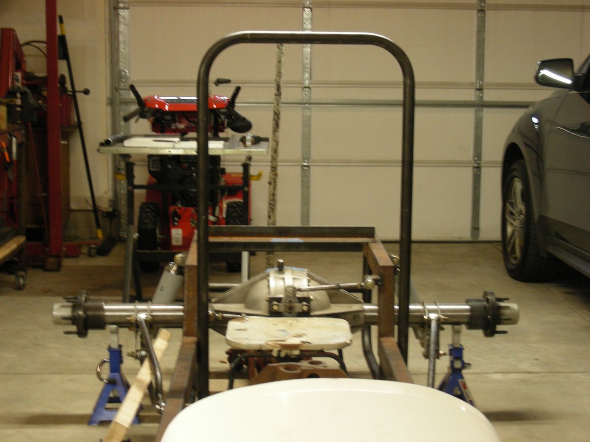

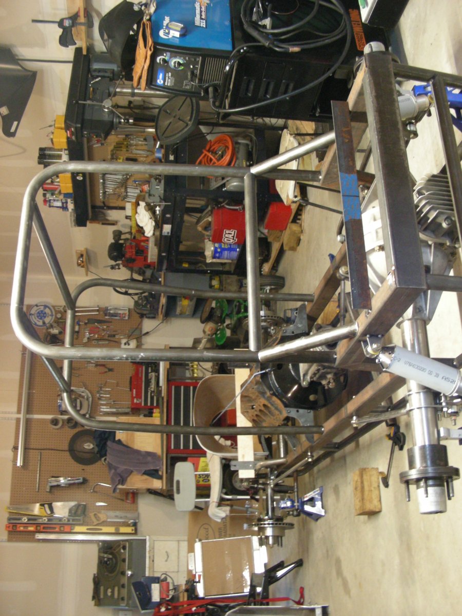

    And now for something entirely different! Help I don't know how to rotate pictures! I'm so 20th century. DSCN1073.JPG So here is the cage picture on it's side cause I'm computer illiterate. There will be quite a few more tubes added, like rear diagonals to just below the 90 degree bends from the rear framerails, an x behind the driver, some sidebars once I get the Vicky body so I know how wide the elbow bars can be, more cross bracing, bars to the front, some diagonals under the driver's seat, some small diameter tubing bracing ***needed, and on and on... But that's just fabrication. That's easy, just wait until I start on pedals, and steering mounts and seat mounts, and... Oh forget it, you all know the drill, for everything I have thought about there are 3 or more things each forgotten. I'll get better pics tomorrow when the daily driver is out of the garage and make sure they are oriented correctly on the camera
    chryslerfan55 and brEad like this.

    Tap on edit photo and it will come up in a edit screen where you will see a little ****on on the side or top of the screen and you tap it to rotate your picture then tap save. Easy Peasy
