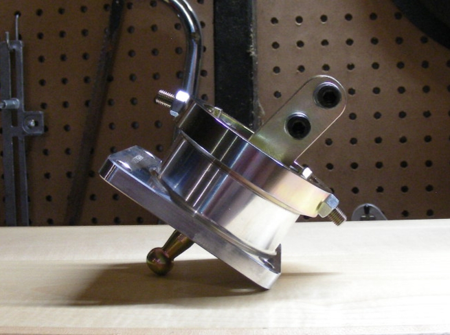

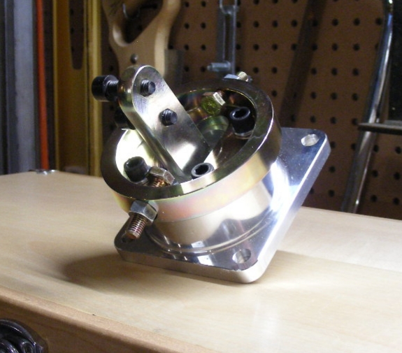

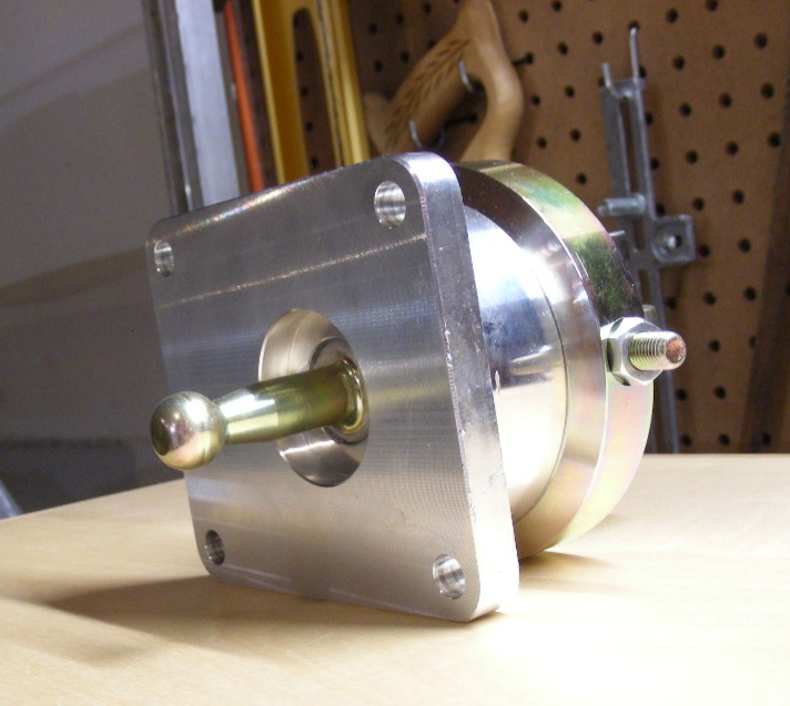

    Santa's been here today! Look what I found on the front porch.
    Hot Rod ****! This shifter looks very well made, and bolted on, with the supplied bolts, with no fettling! How many times have any of us purchased parts and then spent serious time getting it to fit? Hanlon Motorsports in Pennsylvania. And it's made by them! Under $200!

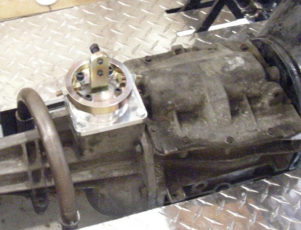

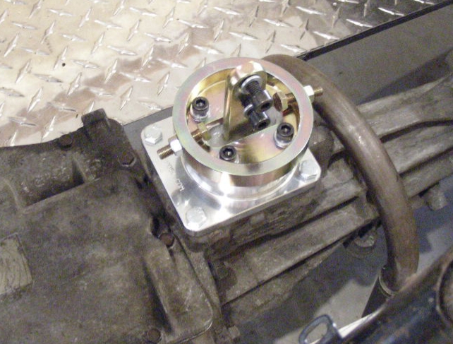

    Here it is bolted down to the transmission. It looks too good for the mangy grimy transmission. It won't need much of a lever to get the knob right where I want it. That's for another day...

    Don't forget to adjust the shifter over travel stops before it gets all closed in. :rolleyes:

    Remind me again in about 20 posts...hey I'm not a spring chicken any more. It's going to be taken off again for cleaning of the case. Like suggested, I've got to seal it up so nothing gets inside. Oh well...

    Dave could you blast it with walnut shells if you get it sealed up?

    You know, that's not a bad idea! An interesting aspect of walnut shell blast media is in its used state, it turns to mush in oil. It might not do damage if it gets inside.
    Baking soda might work also. And it dissolves in water, not that I want water inside of the transmission...
    So first I'll take your suggestion to seal it up, then decide on the cleaning regimen. But that's down the road a way. I'm thinking first finish up on the installation, then front end, and then hopefully take it all apart for some serious welding time. There's still a lot of little things that need to be done...

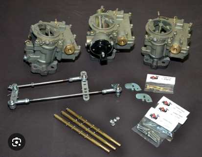

    Thanks Walt. I might take you up on the offer later this year. I've also got a question for you and Bruce. How many small flange Rochester 2 barrels do either of you have? I've got the 1 on the 283, and have been thinking about 3-2s on it. Only need 2 more...

    I used to build these back in the day, and you need about 6 to match up 3. Pay attention to venturi size, venturi/booster type, baseplate/throttle shaft width, and fuel inlet type. Those are the main things that you wanna look out for. GM made about 2 billion iterations of the small base 2 jet….

    I don’t have the best pictures - I’ll try to hunt for some tomorrow. For the venturi size and cluster type, those are evident after you take off the air horn. Visually, the clusters are different and take a different gasket, and the venturi size will be cast into the body between the two venturi.

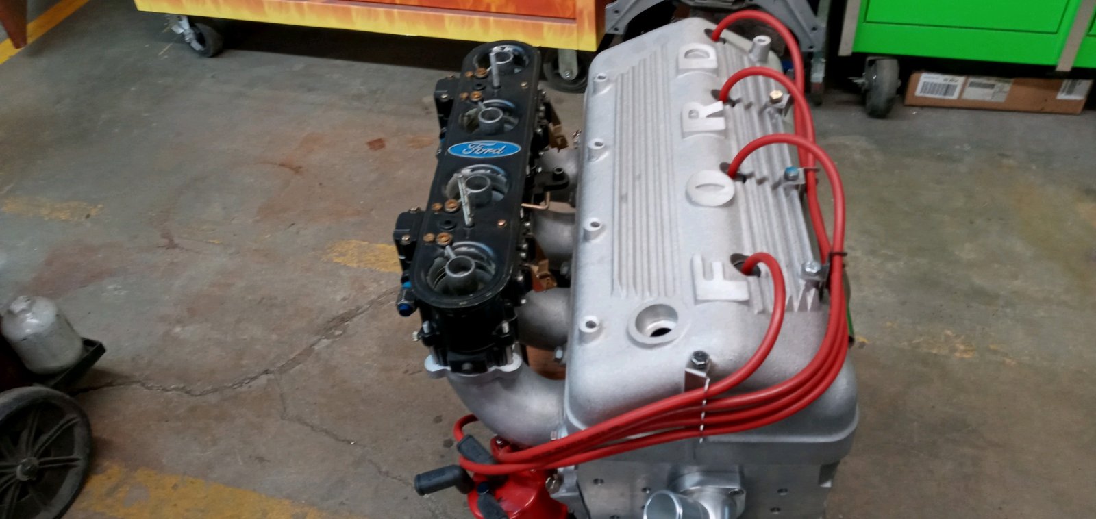

    Hilborn's would be my choice! But I have to say I have had an intake cast for one of my carbs..... but I still have 2 1/4 throttle bores!
    Good on you for that shifter as well. I need one of those for my brother's car.

    You know, either Tim or myself would be more than happy to give that engine a home in a T.
    I am very impressed with that shifter. It has an alloy lower body, and the upper body is steel. Those travel limiting screws are in the steel part. The centering springs are stiff, but not overly stiff or restrictive. I'm working on the shape of the lever I'm going to make or, if lucky, will be able to purchase. I'm betting on the former however. I'm going to have to get creative with the shifter boot. Unless I build a tunnel over the transmission, it will need to attach to the shifter base. I got some ideas...
    But then again I've always got ideas!

    They make many bolt up old flat Hurst type lever for that new type of shifter.
    A few samples when you get time

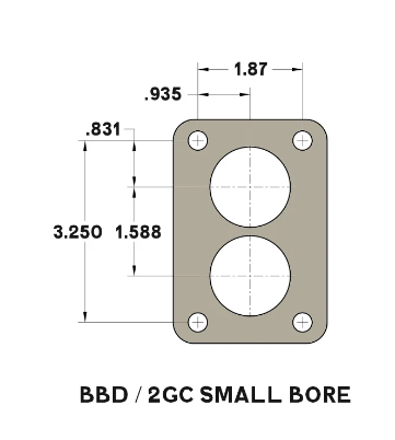

    If what I saw down below the choke plate is what Tim is talking about, I can just make out "16598" on one of the tubes in each of the 3 carbs. My ruler isn't in decimals, but I'd estimate the 1.87 called out below is consistent with what I've got. I didn't check the other dimensions, but they're only 1 flight of stairs away.

    The Venturi size will be cast right where the red circle is. It will say “1 5/32” or something like that

    Aha! Thanks for the visual. Back down to the ba*****t parts depot I go...

    The results are in! All three carbs are 1-3/32" venturis.
