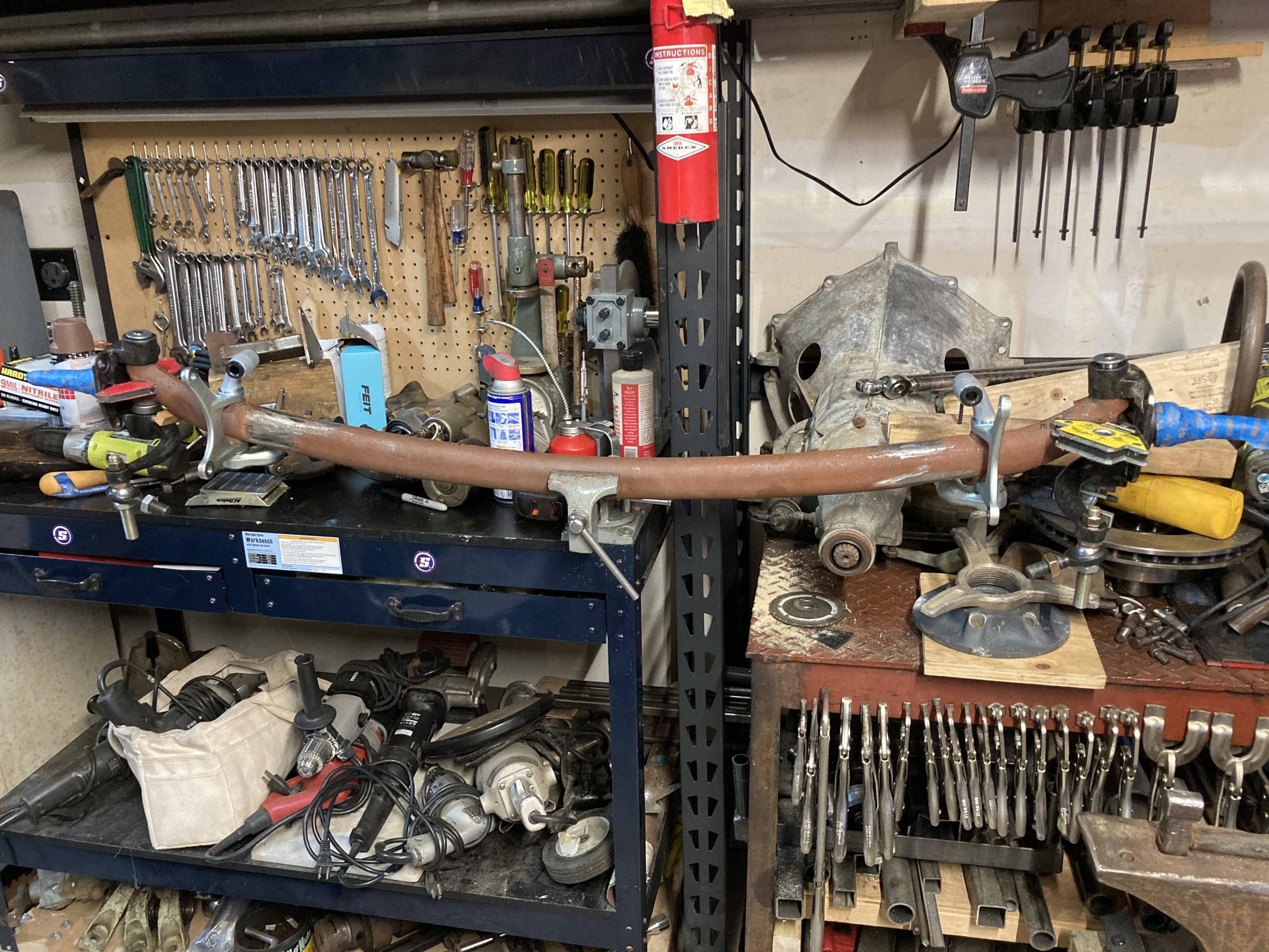

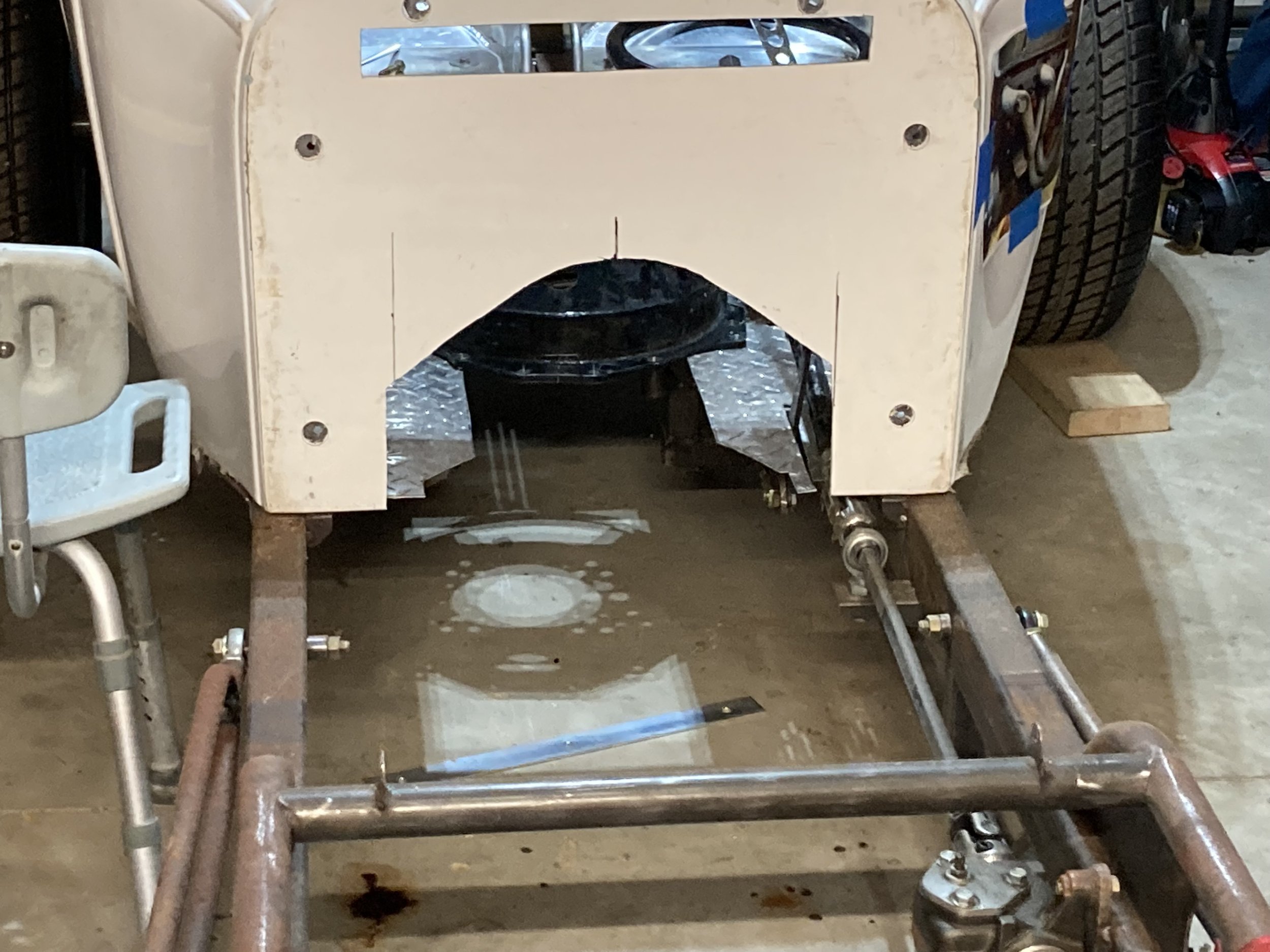

    A small amount of progress, with pictures. Pictures first.
    I pulled the engine out and took the firewall apart to modify the parts to fit the Turbo 350 in. The engine plate on the front side of the body does a couple of functions. It is the rear engine mount, and the outer firewall. It bolts between the engine and the transmission and attaches through the body’s firewall to a support hoop that is bolted to the frame in 4 places inside the body. Then the inner engine plate bolts to the outer plate, sandwiching the fibergl*** in between. When the system is fully bolted together the ***embly is very rigid. Next will be to hang a brake pedal and the master cylinder from the ***embly, which will place the master cylinder in the engine compartment, fortunately clearing the left side valve cover. The steering column also attaches to this structure. More pictures to follow once the new brake pedal and the steering column have been installed.

    Yea, I know. But I have a master cylinder that is sized for the disc brake system, and don’t want to buy another one… and it doesn’t fit under the cowl, but it fits just fine on the firewall! And I have a design for the pedal and its mounting bracket that will fit in with room to spare. Well it’ll fit.

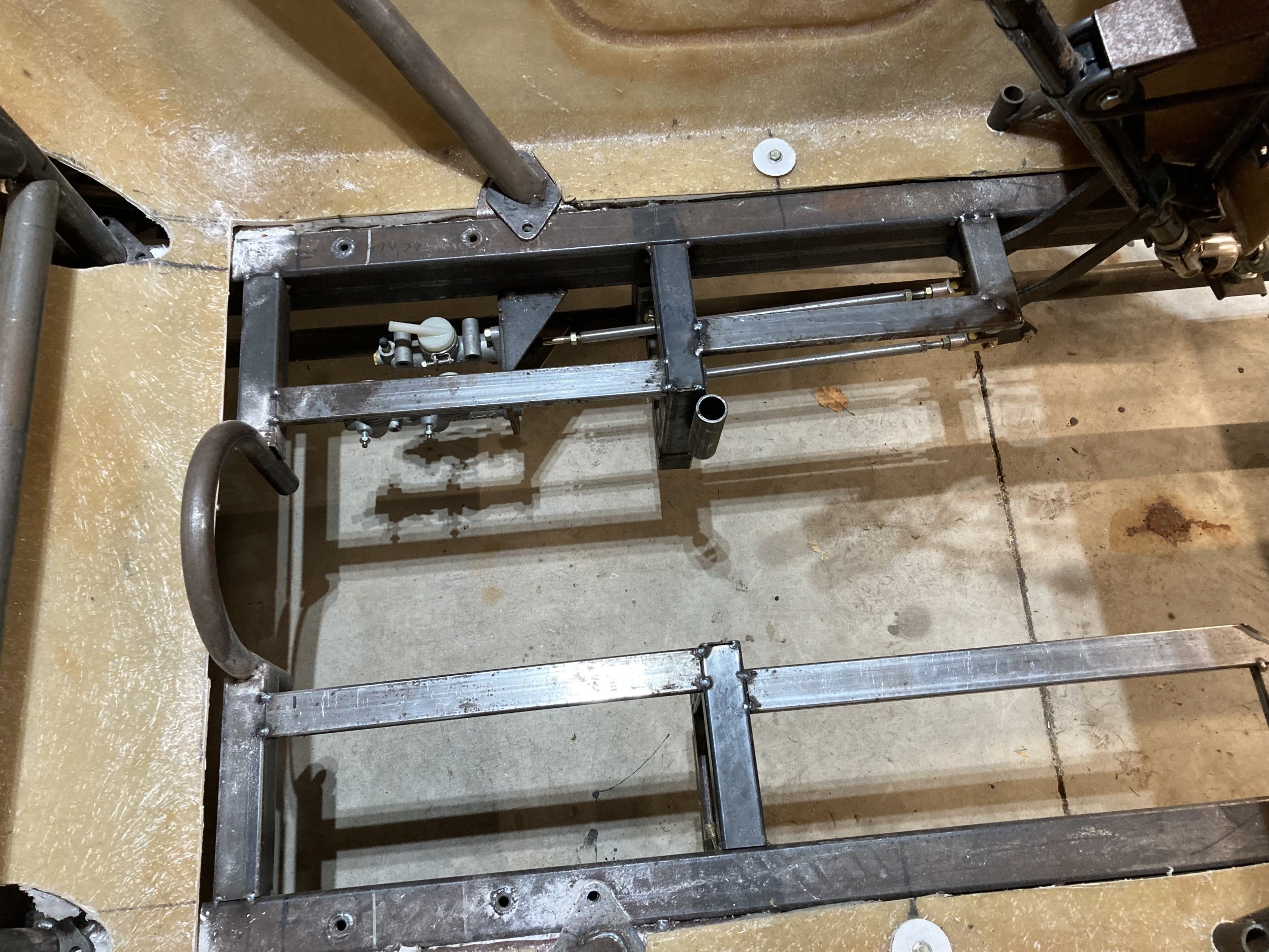

    Okay, so some discussions with a couple of people who have been helping me with my focus issues have been very positive and helpful. I’m back in the groove and getting some tasks done.
    It was mentioned quite a while back that the diamond plate floor was yuk! It’s gone. Now that I have seen how people have bonded plywood floors in, I think I can do that. Plus it should make the body even more rigid.
    Big open hole now…
    But look closely at that picture. See those master cylinders? One is going away, no clutch needed with the Turbo 350! Now I have very wide feet, so getting rid of one pedal will make a huge difference down there for my ducks feet. I haven’t decided which position to use yet, but it will only require a spacer to replace one or the other and also remove the clutch master cylinder. If I use the clutch side for the brake, I’ll move the brake master cylinder to the left side. Otherwise just X the clutch and put a spacer on the pedal pivot shaft.
    Worked on the V8-60 axle a little bit, and it is pretty much good to go. Kingpins are finished, the locks are made, but not installed yet, got the spring perches, shock mounts and hairpin brackets fitted, and measured for a new tie rod. Now I’m going to set it aside and put it in the ba*****t for the time being. I think it will look good on the next project. With Buick aluminum drums, but I need to minimize the distractions and focus on the whatever and get it back together.
    Next effort is to get the engine back in the ch***is and finish the mounting system. I have been working in parallel with the suspension, converting both ends to 4-bar style for better geometry that will free up the suspension from any binds. I have a couple of brackets to make and locate on the front of the ch***is. And some spacers for spherical rod ends to make. Or buy. But I have the stock and a lathe, it’s just my time, versus spending cold hard cash. Remember that I am half Scottish. We’re a thrifty bunch… And the Italian heritage has spent more than enough money recently on stuff!

    The bars just rest on top of the axle. I used a similar setup decades ago on the modified cars, and it worked great. The lengths are so close that the arcs are essentially the same. And remember, it’s a cantilever so the effective pivot point is out past the jack bolts. One car with that type of setup raced 3 seasons with the same bars and axle, with no failure and so little wear that we didn’t do anything other than check the wheel weights each week.
    I did, sort of, try to get the effective arcs the same. As some who know how **** I am with overthinking things, I will just say, that I have been thinking about this setup for a while now. I made the bar mounts about 16 years ago! And the 4 bars are more recent, maybe 6 or so years ago, although I only made 3 at that time, as I was thinking about the final iteration of front suspension we used on the modifieds. We copied what the sprint car people were doing, eliminating one bar to completely unbind the front suspension. But I used much bigger rod ends then, so I didn’t worry about them being able to support the brake torque on the front axle.
