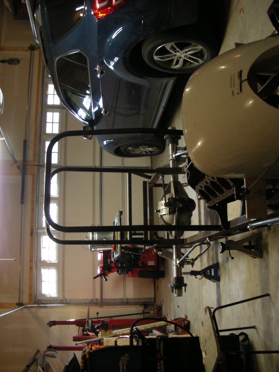

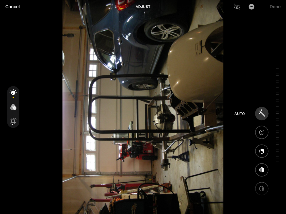

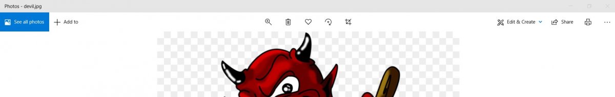

    I don't see the option to edit photo when I look for it. What am I doing wrong??? DSCN1072.JPG

    Yup, I'm an idiot when it comes to computers. Still can't figure out the rotate. Oh well...

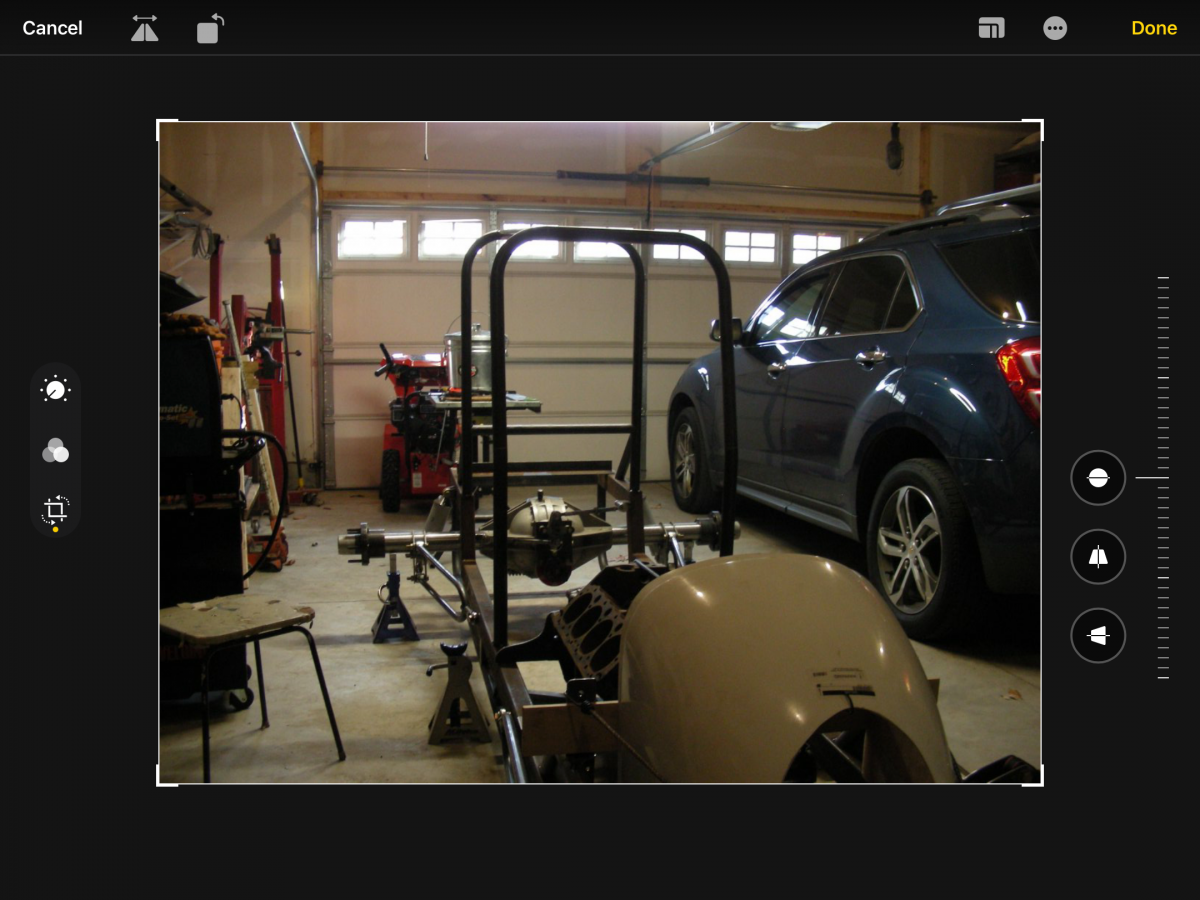

    2C278AF0-3116-4191-BC92-8485B1492633.png A3E3045A-8AC8-467F-8E45-97E8D816D740.png Go to photos and see edit ****on in top right hand corner it will take you to the second screen push the little square ****on with the arrows around it and it will rotate the picture then go to the left top of screen and press the rotate ****on for 1/4 turn each press of the ****on then when you have the orientation correct press the save ****on in the top right hand corner. Hopes this helps. Frank ECA6804A-1444-4353-AFEB-1B946DD37F7C.png 2C278AF0-3116-4191-BC92-8485B1492633.png A3E3045A-8AC8-467F-8E45-97E8D816D740.png 623729AC-27ED-4960-91E4-9C6F784BCD39.jpeg ECA6804A-1444-4353-AFEB-1B946DD37F7C.png

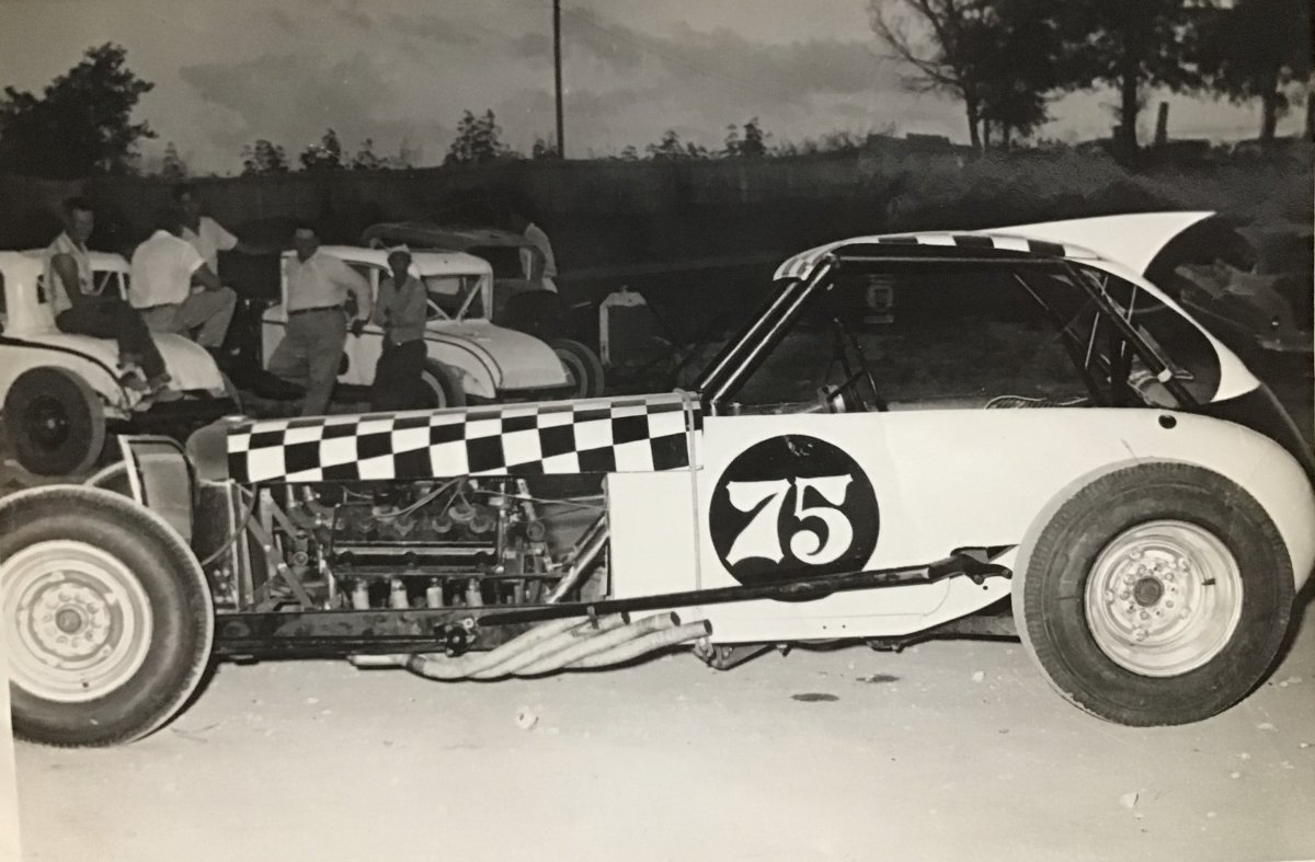

    Yep, I remember seeing your east coast Pinto and Gremlin bodied cars in the magazines. Cool looking, but I never thought about body maintenance. All that sheet metal way out there in harms way must have needed quite a bit of fixing. I don't recall ever doing any body maintenance on mine, other than painting it annually. I would guess the body weighed about 20 or 30 pounds, similar for the hood. Much thicker than the drag car fibergl*** bodies, but more severe duty.

    Typically as the season wore on, all of our cars started to show the wear and tear. We were lucky with the Pinto body. It actually made it thru 3 seasons with only paint touch ups. Rub rails, bumpers and wheelstook a beating but Jim was good at finding holes and not crashing. At the time of his induction in the New York State Stock Car Racing Hall of Fame, he was Lebanon Valley's 2nd most winning driver with over 100 wins across the different cl***es he raced in, 2nd to Kenny Tremont jr. However, he had the record for the most 2nd place finishes at around 250. And was recognized as one of the cleanest drivers at the track.
    That was the reason we didn't have to replace sheetmetal. Other teams cars not so much...

  8. loudbang
    Posts: 40,351
    Open the photo on your computer just like you were just looking at the photo. Most places like that have the curved arrow to rotate the photo like this at the top.

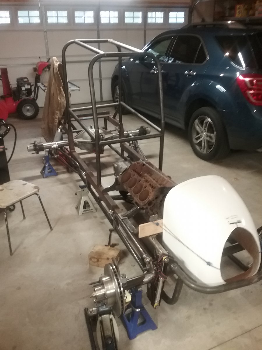

    Ok one more try: 20201121_145517.jpg Not a lot done, the OLD back is still giving me fits. I'm only good for an hour or so in the shop depending on what the chore of the day is.
    Some lower cage tubes cut and fish-mouthed. We'll see where this leads in a week or two. Hopefully I can spend more than an hour at a time by then. 20201121_145517.jpg

  10. Dave G in Gansevoort
    Joined: Mar 28, 2019
    Posts: 4,273
    from Upstate NY
    Hot damn! I got it correct this time. Thanks for the help. It seems you can teach old dogs new technology when you cross the bear bridge.
  11. loudbang
    Posts: 40,351
    Looks GOOD right side up. :)

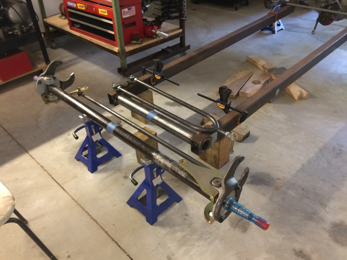

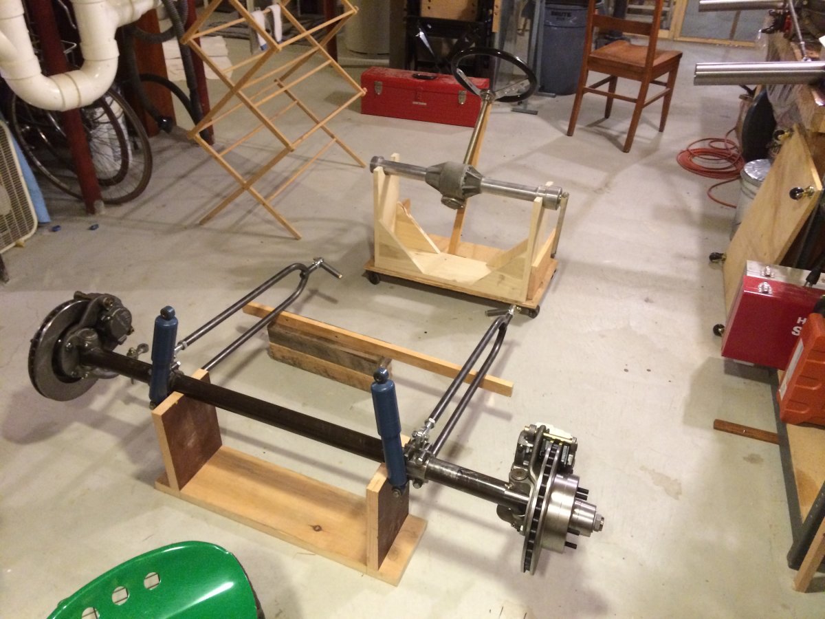

    Needs more triangles! [emoji6] As someone who didn’t do well in physics, what’s the engineering behind putting the small vertical connections between the upper and lower frames plumb, rather than slanted?
  14. jaracer
    Joined: Oct 4, 2008
    Posts: 3,298
    jaracer
    That's the same setup I had on my spring front car. A hairpin on one side and a single link on the other. That car also had single links on the rear, but they were short. Probably the same length as the torsion bar arm. It was kind of like a Watts link setup.

    jaracer, a question: when you ran the spring front, did you have a so called Hollywood spring, the one with a second main leaf only to the right side? It was a partial leaf that started under the spring clamp, and ran to the spring eye, wrapping around it to make 2 differing rates on the front spring. Of course the main plate was reversed to make it work.

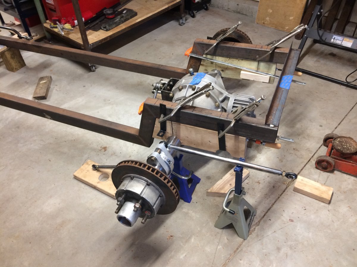

    I did have intentions of running a watts link in the rear: IMG_1112.JPG It's seen here in an early mock up. But seeing the Unser car, like your setup, was so much simpler, I plaigerized, er that is I paid a compliment to both of your cars...That's my story, and I'm sticking with it!

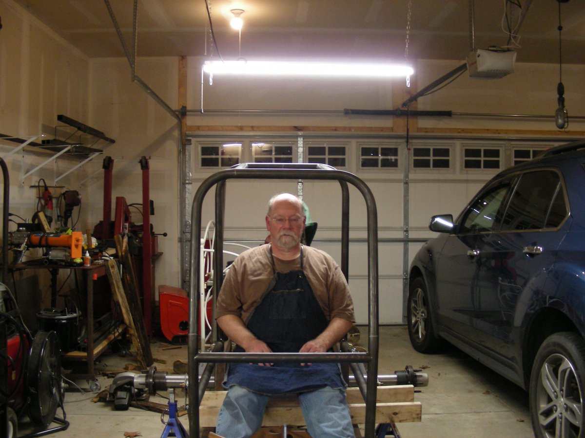

    Finally got back in the garage for a little bit today. I'm so embarased by allthe other builds here and how fast some people are at getting a complete vehicle done. But at least my back cooperated a little bit, and I got the cage mostly roughed in and attempted to establish seat height relative to the top of the cage and where a drive shaft will be inches from the family jewels...
    Here's a look at the pitiful progress froma poor procrastinator professing pain and poverty... DSCN1079.JPG Yeah old ugly is back in the ch***is.
    I have 4 1/2 + inches from my head to the bottom of the rear hoop (6+ inches to the top of the hoop), and over 4 inches below the seat at the height of a 2x4 (3 1/2 inches). So wanting 3 inches from the top of the cage to the top of a helmet on the old gord (add 1 inch to my head or ***ume 3 1/2 inches to the bottom of the rear hoop, 5 inches to the top) I can raise the seat another 2 inches to gain even more jewel relief if needed. As the rear axle is not at the correct ride height yet (the rear is sitting about 1 inch lowerthan ride height) and there is only a total of 3 inches in compression when at the correct ride height, I think I am safe.
    Oh BTW there will be a steel plate under the seat just in case welded to the seat frame, yet to be bent from 1 1/4x 0.120 DOM tubing attached to the frame and or/roll cage structure. Also a 1/8 inch drive shaft tunnel bolted in with numerous 3/8 bolts to keep the drive shaft from being able to get me. I expect it to extend from a couple inches in front of the front u-joint to under the seat plate. I'm too old to have a drive shaft alter my anatomy.
