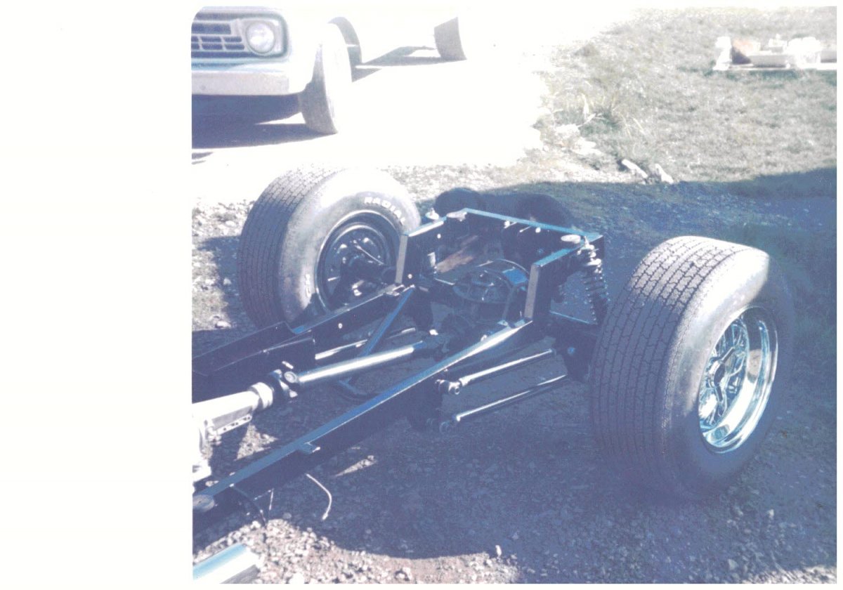

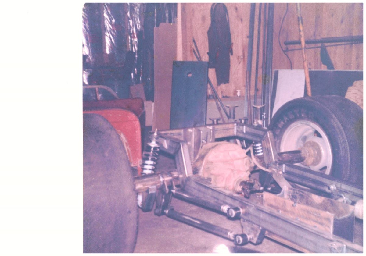

    Hey Dave, I don't have any pictures of the old modified available other than that one. My dad took a lot of slides, but I don't want to dig through all of those. I ran that car from 75 -79, then our open wheel cl*** switched to sprints.
  6. Fabber McGee
    Joined: Nov 22, 2013
    Posts: 1,523
    Fabber McGee
    I remembered a couple that were sent to me a couple years ago by a guy on my crew that has retired to Mexico and is now building and crashing R/C planes to occupy his time, haha. Gene West (Medium).JPG Mar12&35 (Medium).jpg

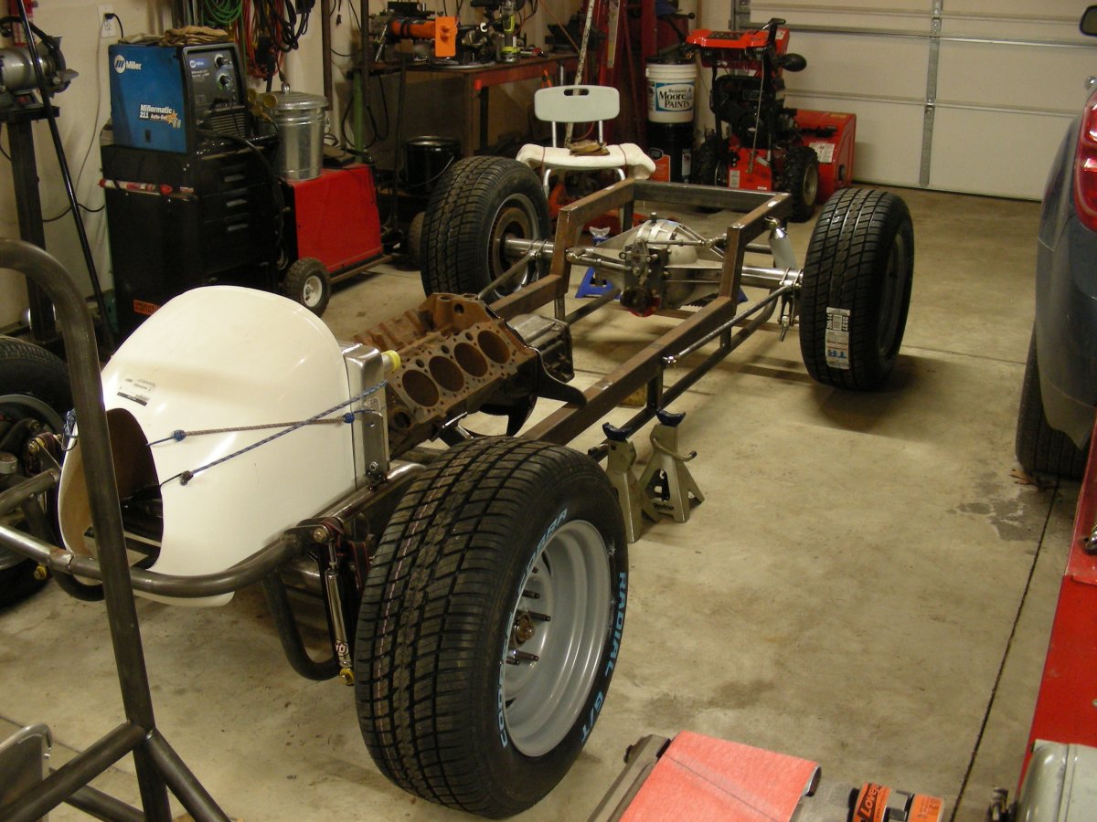

    Well the cage is off, and it's now a roller! A gl*** T body is next. Here's the "Whatever" with tires and wheels: DSCN1086.JPG So a Speedway body is next to be ordered, basic body and turtle deck. I'm going for the Marty Strode look for the body, but I like wider tires, so...
    Now the only problem is shipping. I don't know how that's going to work out. I live on a small cul-de-sac off of a small side street in a small town and can see an 18 wheeler with a long haul tractor and 53 foot trailer trying to get it to me. What does everybody think I need to ask regarding shipping? All the years I've played with cars, I've never had anything really large shipped to me.
    So comments, advice, suggestions. I'm open to any and all. Thanks guys...

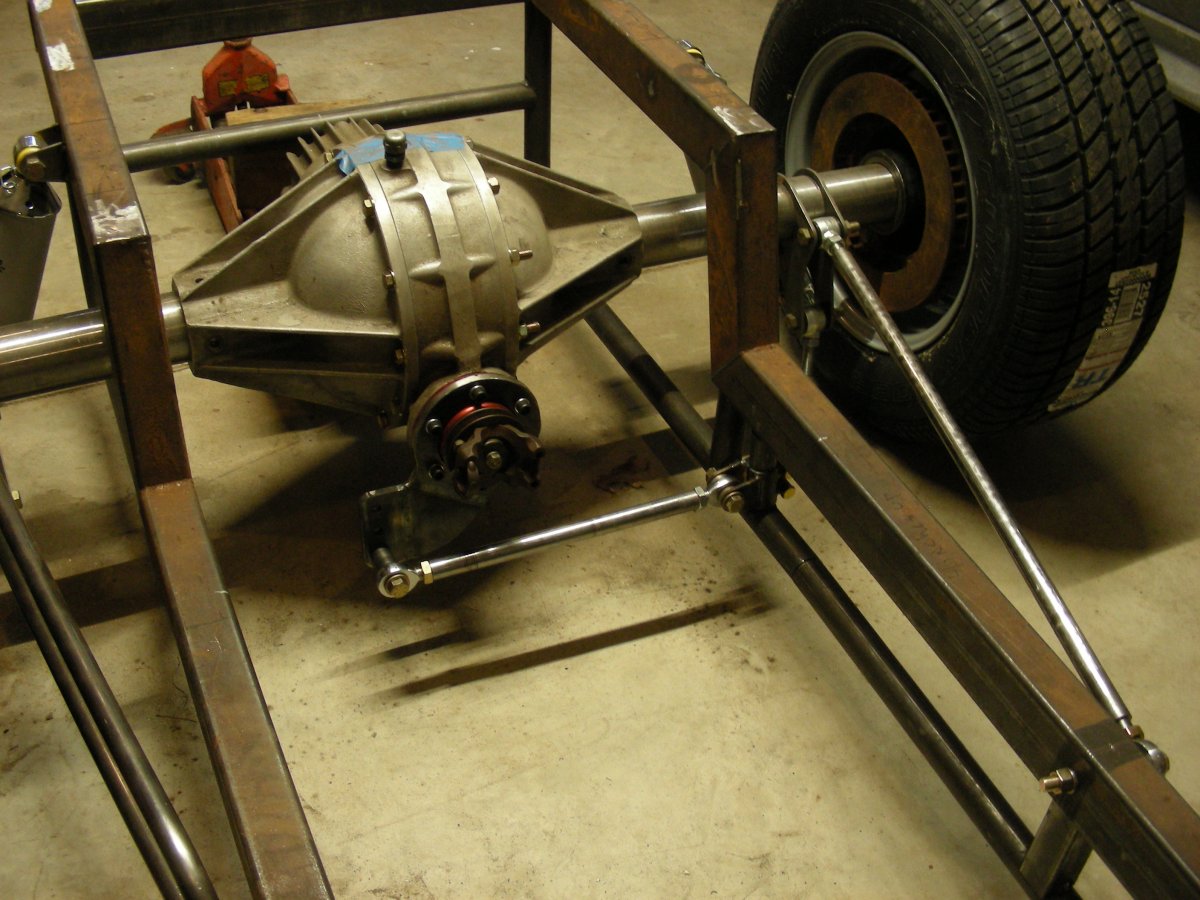

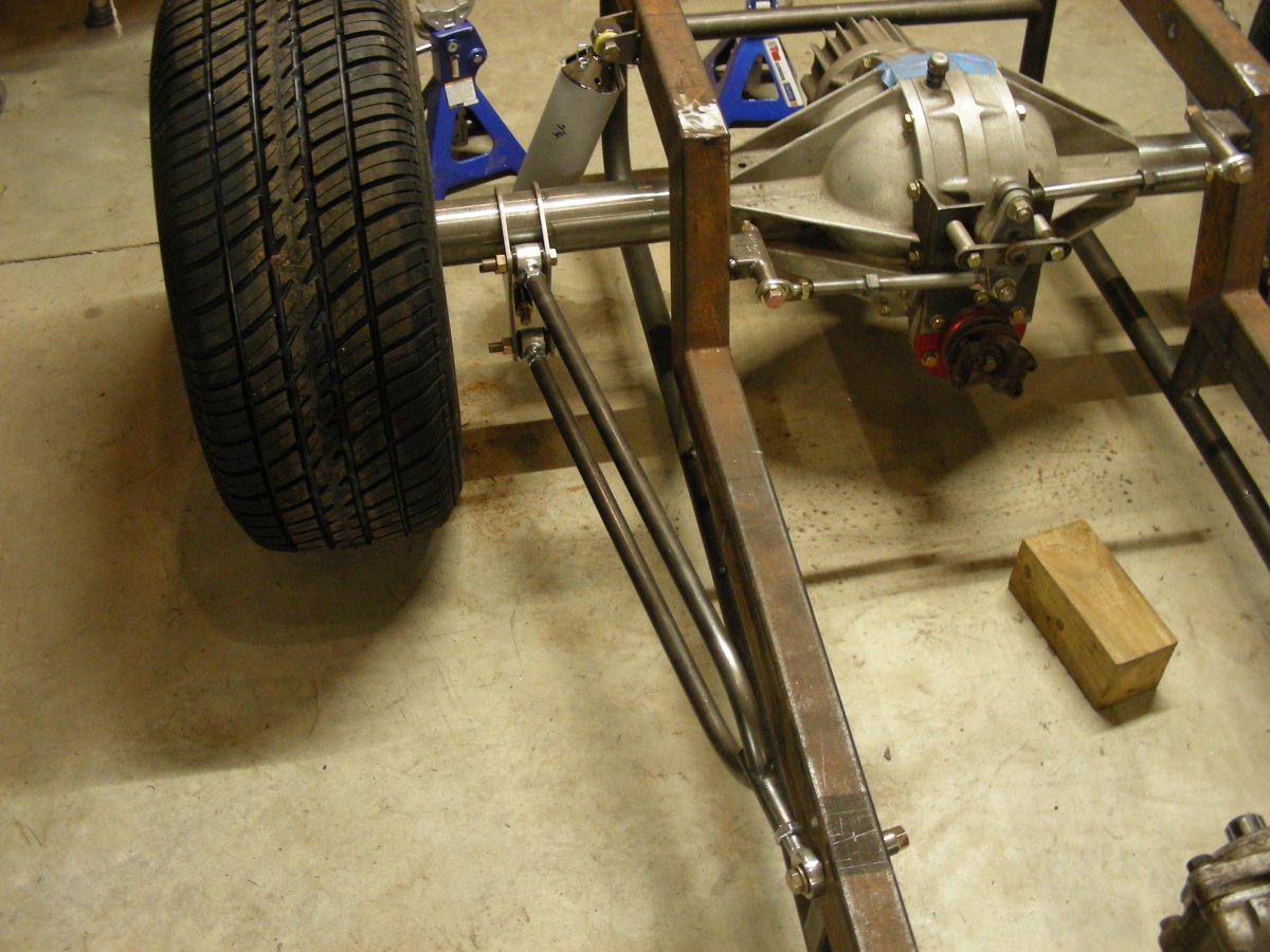

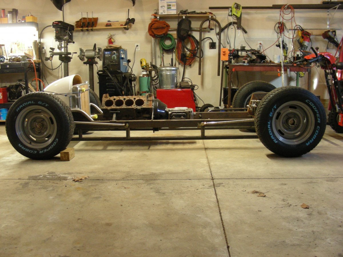

    Finally got something done on the "Whatever". Not much, but something.
    Did away with the complicated Watts link for the rear axle, and am going with a panhard bar. Yes it will be short, but much more room around the front of the QC. Giving more clearance to the bottom back of the body. DSCN1089.JPG From this, DSCN1093.JPG to this,well the bracket is in at least. Hey its cold up here in the northeast, and even tho the garage is heated, it takes the fun out of working in the garage for old arthritic guys.
    I'll be using a so called J-bar to go over or under the yolk and attach to the left side of the frame. I've got to get to my old place of employment to get to a bender to form the 7/8 heavy wall tube into the shape needed, and also to collect all of my left behind stuff I never got when I retired. This week maybe...
    And here's a side shot of the ch***is with tires: DSCN1090.JPG That's all folks!
  18. Marty Strode
    Joined: Apr 28, 2011
    Posts: 9,850
    Marty Strode
    Dave, you could fab a bracket to bolt to the center section, that holds a urethane wheel. Then fab a crossmember with a couple vertical angle runners. The rear axle would stay centered, without any bind. I did this one 43 years ago, mounting the wheel behind, yours would be in front. 2012-12-05 114339.jpg 2012-12-05 114412.jpg
    Atwater Mike, loudbang, brEad and 2 others like this.
  19. Dave G in Gansevoort
    Joined: Mar 28, 2019
    Posts: 4,277
    from Upstate NY
    Not bad, Marty. I could just rotate the bracket just made 90 degrees and do that. Kind of just like what the Cunninghams had to locate the front and rear axles. Hmmm...
  20. Marty Strode
    Posts: 9,850
    Marty Strode
    The thing I like about it is, keeping the rear centered. I learned it from a friend who helped build a sports car in the late 50's.
    loudbang and Tman like this.

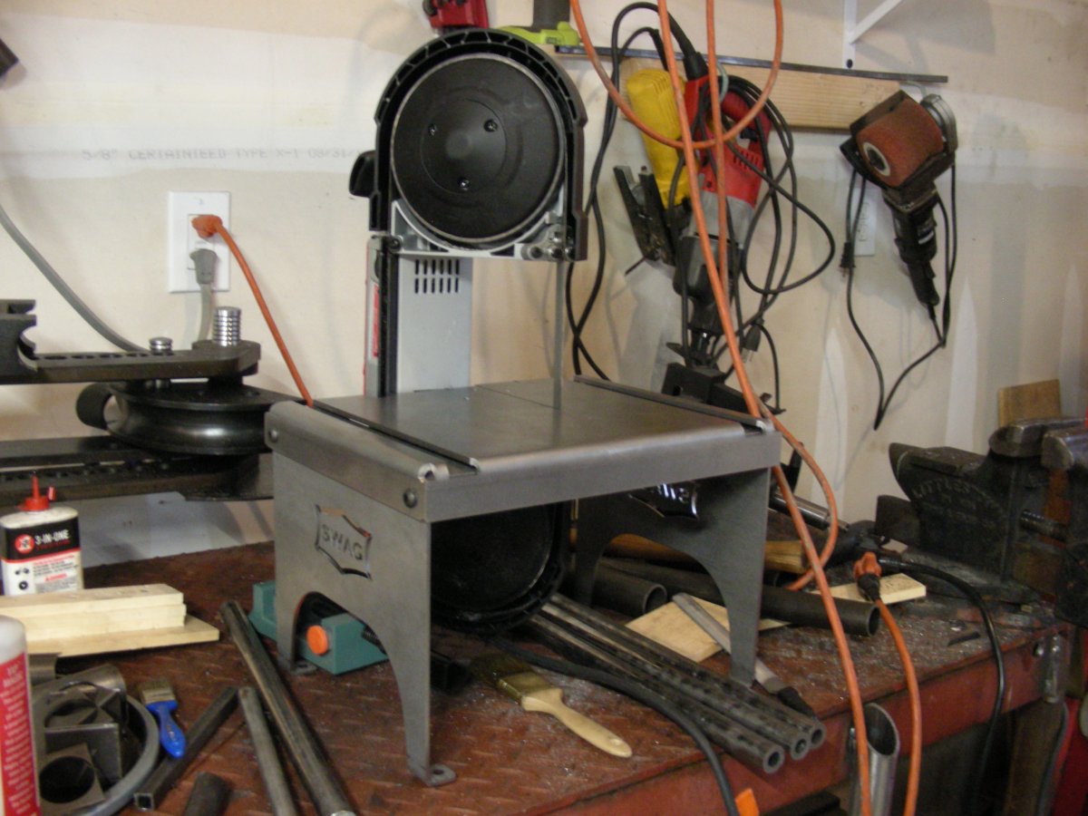

    Finally back at it in the garage. Turned the heat up, and made the rear panhard bar stuff. The bar is short, but with the limited travel built in there is only a maximum of 1/4 inch lateral travel at maximum droop or extension. I can live with that for the simplicity. I still have a slight change I may make, which will make the bar a little longer, which is always good. DSCN1095.JPG It looks close, but one thing I didn't think about, but happenstance helped out, is the wishbone makes the axle rotate as the suspension travels. The drive yolk rotates away from the bar in down travel, and doesn't get close on up travel.
    And I added some new stuff to my shop. I don't have a lot of extra space (who does???). I have wanted a band saw to cut brackets out with, but the price of new units is not something I can justify. Further, the room required is restrictive. So what to do? And finding a metal cutting bandsaw in decent shape and getting to it before someone else plops down the $$$, well I needed an alternative.
    For about a third the cost, I bought a new Milwaukee corded portable bandsaw, and then a bought a Swag Offroad compact table accessory for it. It's limited on cut size, probably no bigger than a 10 inch diameter part can be cut out on it, but since I don't make brackets that big, no problem. DSCN1096.JPG This thing is well made, altho I did make a couple of changes (hey I'm a retired engineer, it's what I did. I have the "Knack" after all).
    It doesn't take up much room, can be stored on a shelf when not needed, and the saw can be removed in 30 seconds or less for use to make long cutoffs.
    Since getting this I have been making a lot of bits and bobs for the Whatever, just not much to show.
    So now on to the body. With an estimated 8 to 10 week delivery for a t-bucket and turtle deck, if I order it now it should arrive around early April. Steering is coming along too.;
    brEad, Shadow Creek and loudbang like this.
  25. Marty Strode
    Posts: 9,850
    Marty Strode
    Dave, Troy at Swag Off Road builds some nice tool accessories at a reasonable price, very innovative guy. He used to be less than an hour from me, until he moved to the other side of the mountain (180 miles).
  26. Dave G in Gansevoort
    Posts: 4,277
    from Upstate NY
    I spoke with him when I bought the table. I asked him when he was going to make dies for the Eastwood tubing bender (just barely visible on the welding table),as I already bought the air/hydraulic kit he sells for it (great idea there too). Both kits are so well made, and cost effective for us seldom users. Really good stuff at reasonable prices. Back to the dies...
    He wouldn't say, but didn't deny it. Hopefully he will make dies at a reasonable price. I need a couple of different sizes, and while I am happy with the cost and quality of the Eastwood bender, I prefer to buy USA made stuff. Of course where the Eastwood bender came from and the salethey had when I bought it was the reason for that purchase 2 or 3 years before I needed it.
    So Marty, are you making progress on any of your projects? I keep forgetting to check. I keep practicing my welding as I haven't donea lot for a number of years. Maybe some day I'll get to the dime, dime, dime beads, but at least I have gotten away from the quarter, dime, dime, nickle, quarter... you get the idea. I still remember being taught the ABC's of welding: always be comfortable. In my space limited shop, sometimes that's a tall order.

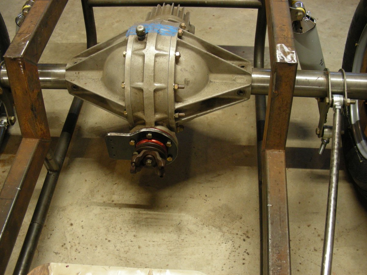

    It's not too clear here, but the bracket is basically dropped and straightened so all 3 holes for the rod end are now vertical. When I next take it off, it will get some gusseting to resist flex and bending. The bar is not long, but it clears the u-joint by a lot in the bottom hole, adequately in the middle hole, and if I need to use the upper hole, I will make a J-bar to clear the u-joint.

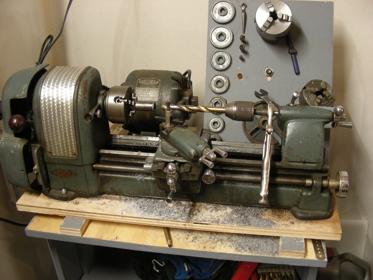

    Back in the garage today, making rod end spacers. Used my Sears Craftsman late 40's lathe inherited from a great uncle: DSCN1114.JPG I feel sorry for you if you have experience with one of these... Oh well, it's what I have, and being 1/2 Scotts, well free is good. Used 3/4 heavy wall tube s****s from the short bin (otherwise known as the junk bucket), drilled to 1/2 inch id, and bevelled a chamfer on one end. Part off to length, and viola, a rod end spacer. Only takes 20 or so minutes each using this fine piece of engineering. Just think Ratrodder, some day it will be yours...
    Made a few today, more tomorrow. Thank god I use 1/2 inch fasteners mostly for suspension, it save time when making this kind of stuff. And yes using quality fasteners this size for most locations is safe from a strength aspect. After all, how many of us use 5/8 clevises. Haveyou giventhought to the 3/8 bolt holding them on?
    Or ever considered the cross section of a Ford rod end when using it for a split wishbone attachment? The 11/16 thread old Ford ends are actually rather skinny where the shearforce acts. And remember they were designed to connect the spindles to each other and act in a push-pull fashion. When we use them for split bones they now have a bending component as well to resist as they keep the axle from spinning on the spindle's axis. The old time racers used the heavier 3/4 thread Ford Truck ends as it gave them a little more margin of safety.
    Okay, I've said all I'm going to say about that...
  29. ssffnomad
    Joined: Jul 23, 2008
    Posts: 964
    ssffnomad
    Dad being a 37 year Machinist, And one of my best friends who apprenticeship under my Dad would truly appreciate your Olde vintage machinery getting it done .
