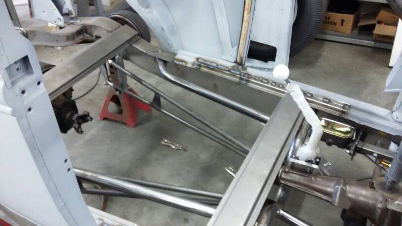

  6. Getting the body mounted and all the subrails layed out for the 32' ch***is. We decided to relocate the stock seat riser back about 5" and making new cross braces and inner subrail flanges. I also took the original rear brace and moved it forward so it's sitting on the end of the frame.

  18. Got the subrails all layed out and the seat riser moved back as far as it would go. Back of the body is shaping up.

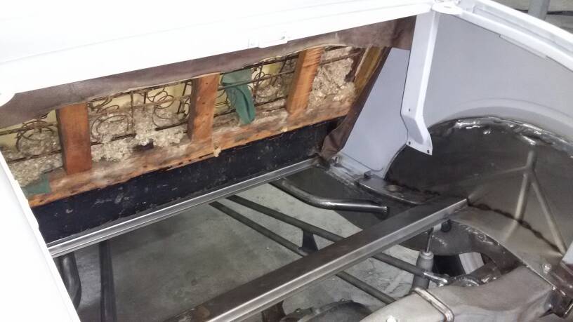

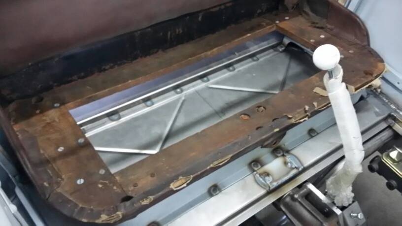

  20. Seat box is all welded in and the rear wheel wells are getting welded up. This car should have plenty of room with the stock seat thinned out.

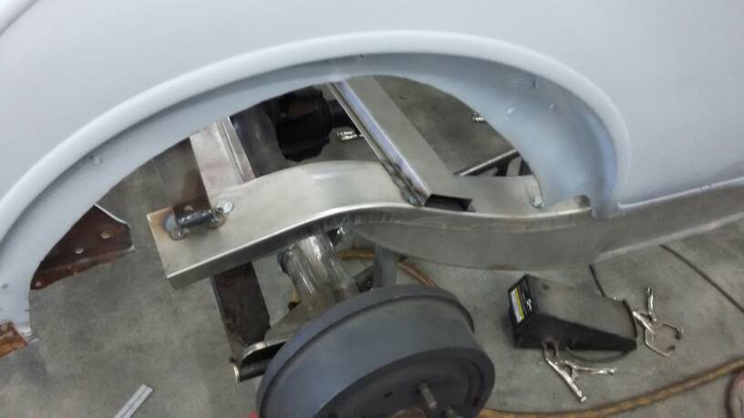

    Progress has resumed on the Y-BROCK Coupe. Jim fabricated a new firewall and rolled out a really cool bubble to clear the distributor ,and Mike replaced the rear lower panel, lower body cross member, and new wheel well panels with the bottom formed to follow the curve of the frame. . 20151202_163802.jpg 20151202_163816.jpg 20151201_173300.jpg 20151201_174919.jpg
