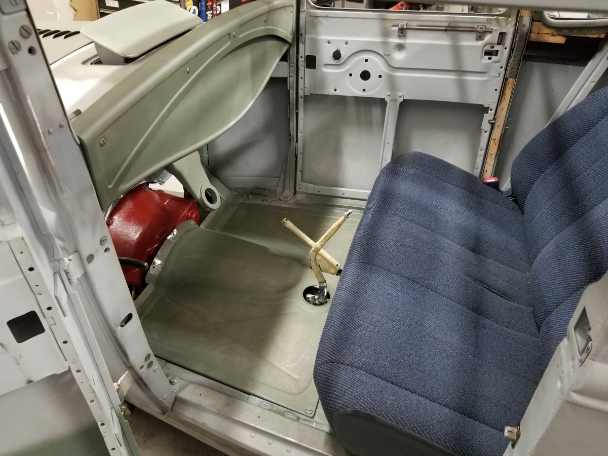

    Received and mounted the 682 C headlights I will be using today. Also Jim B fabricated and installed the seat brackets for the seat today, and yes the cloth will be replaced with leather and a different pattern. The seat is a center unit from a mini van complete with adjustable track and back angle from the local Pull A Part for the princely sum of 35 bucks. 20180108_181531.jpg 20180108_162632.jpg Also thought I would share a couple of pics of two of the car also under construction at Barillaro's 20180108_163538.jpg 20180108_163522.jpg

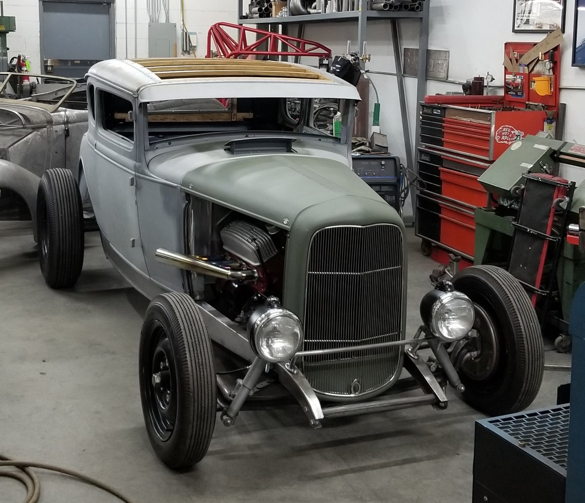

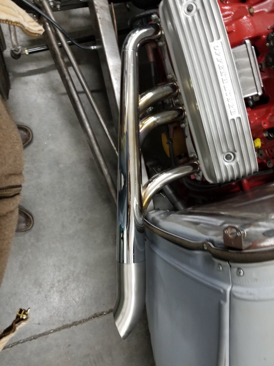

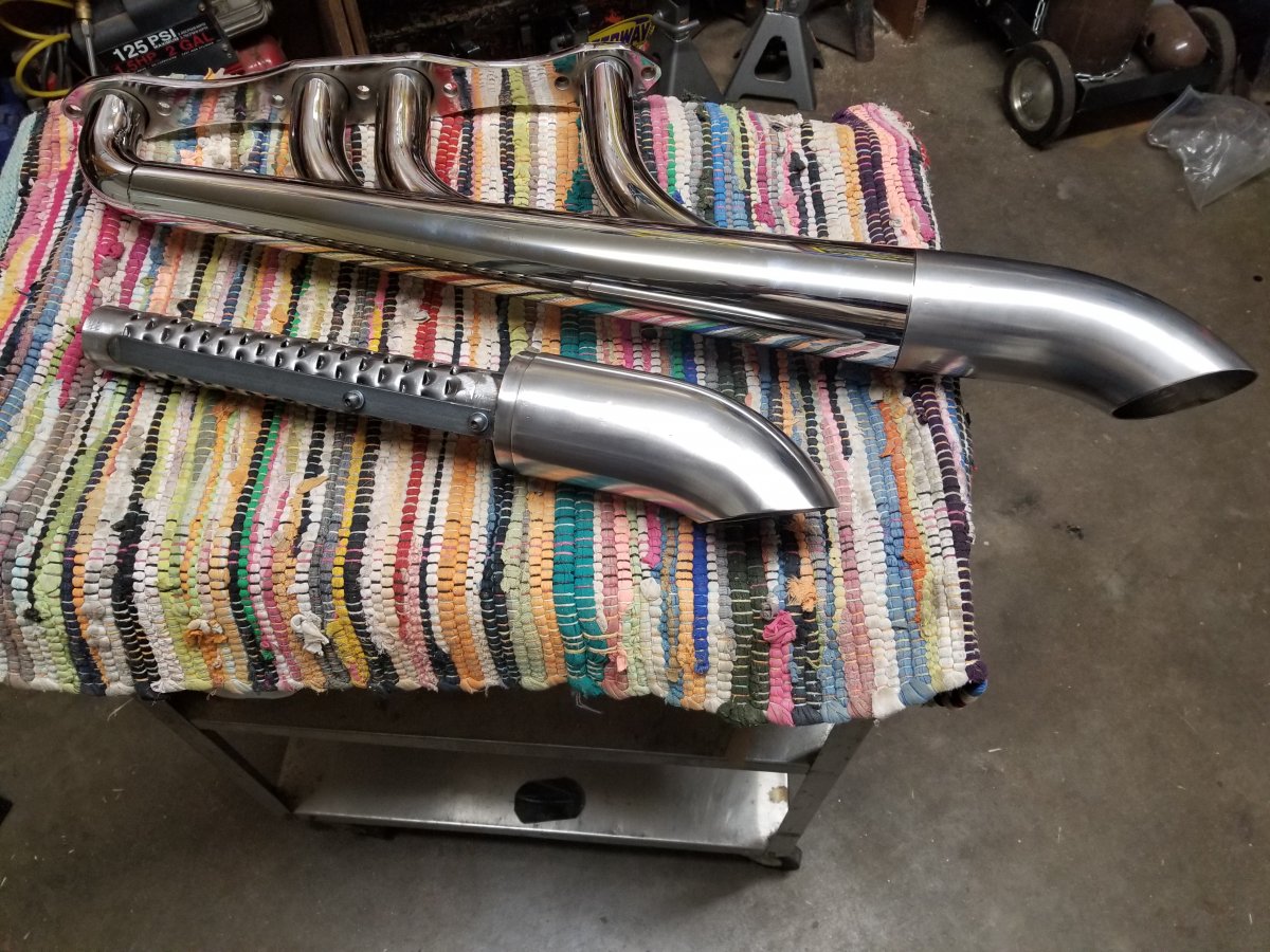

    Getting closer to blowing it apart for paint. Got the OTB Gear headlights mounted, windshield is installed operates smoothly, Mikey B fabbed some cool header extensions and modified the baffles to fit, can't wait to hear what that Y block sounds like through them it was super loud unbaffled. The seat and steering column are in and fit me pretty well. The seat and rest of the interior will be given the black leather treatment. Shift lever has been cut off to rework it to clear seat bottom in 2nd and 4th. 20180117_142934.jpg 20180108_181531.jpg 20180108_154624.jpg

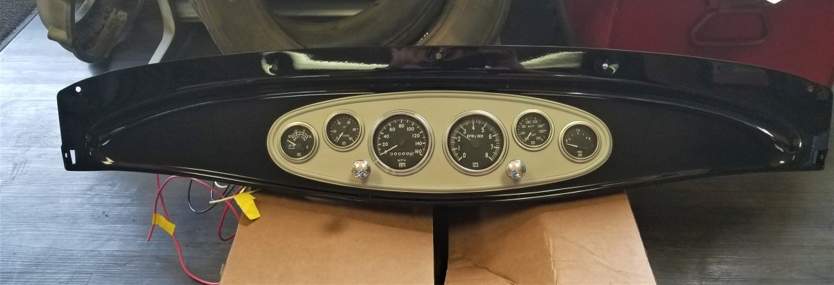

    I could not find a ready made dash insert that I liked so this morning Jim picks up a sheet of aluminum and a couple of hours later he has fabricated a simple insert that adds just the right amount of bling around the SW gauges. The raised edge will be polished and the flat surface will either be engine turned or scotch bright pad rubbed to a nice satin finish. IMG951531.jpg IMG951530.jpg We rolled it out the shop for one last full view before taking it apart for paint, looking forward to seeing it in an evil shiny black topcoat! 20180124_171836.jpg 20180124_165627.jpg 20180124_163107.jpg The turnouts Mike made for the Geardrive headers look great and keep the baffles in place.

    The baffle was modified to fit then welded to the stainless extension and the unit is held in place on the header with two set screws out of sight on the bottom side. . 20180202_160532.jpg

    Like the extra length!!!!

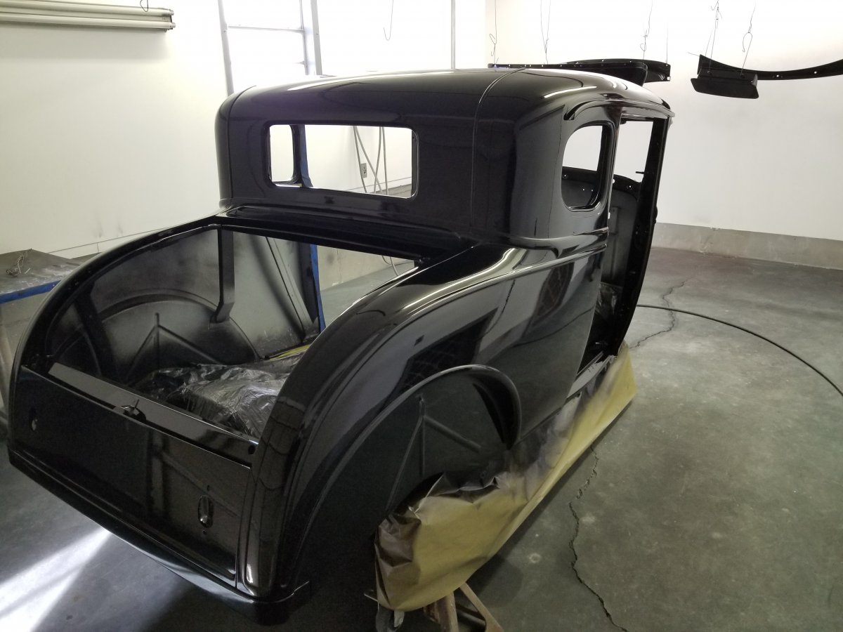

    The body received some paint yesterday. 20180412_175303.jpg 20180412_175312.jpg 20180412_175346.jpg

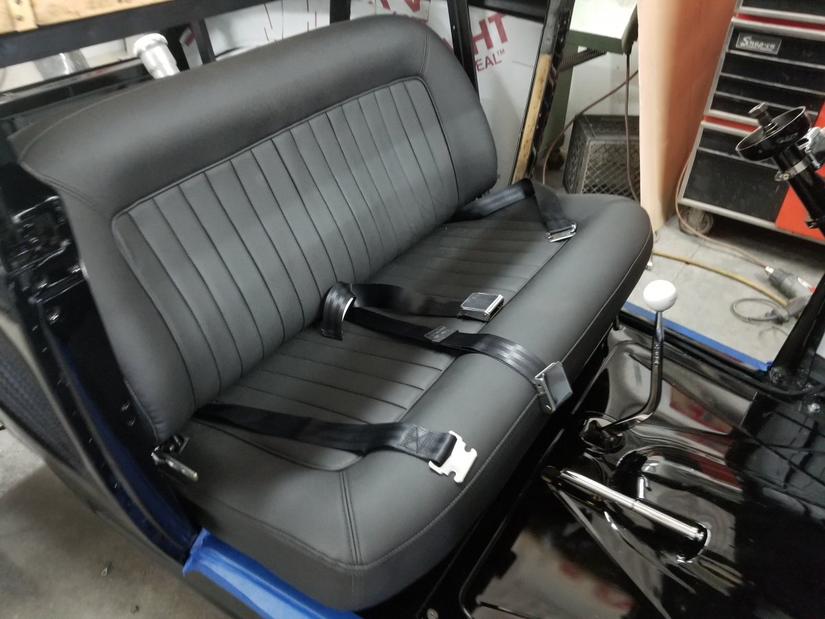

    Got the seat back from the upholsterer today. It looks grey in the photo but it's actually black. 20180502_162753.jpg 20180502_165002.jpg

    Yes it was done locally by Kirk's Kustom Upholstery. High quality, fair price, quick turn around.
