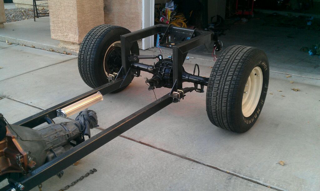

    Here's mine...2100 miles ,so far...handles better than I thought..
    I do agree somewhat with all the spring -twist theories...but, I'm not running the Baja and I do go slowly when entering a driveway at a slant...

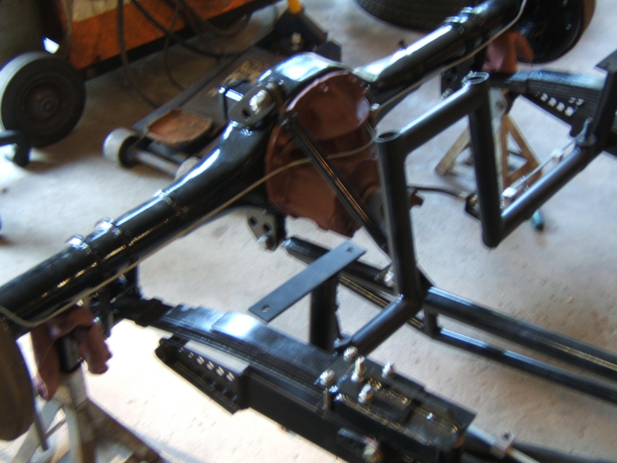

    Here is where I'm going with mine. I already have some changes to make like tear shackles and maybe verdure mounts.

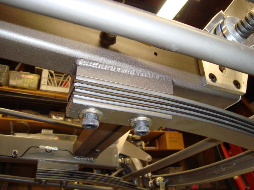

    Here's mine, Henry's springs are bent with suspension travel. Henry's cross leaf is quarter eliptic spring turned sideways.

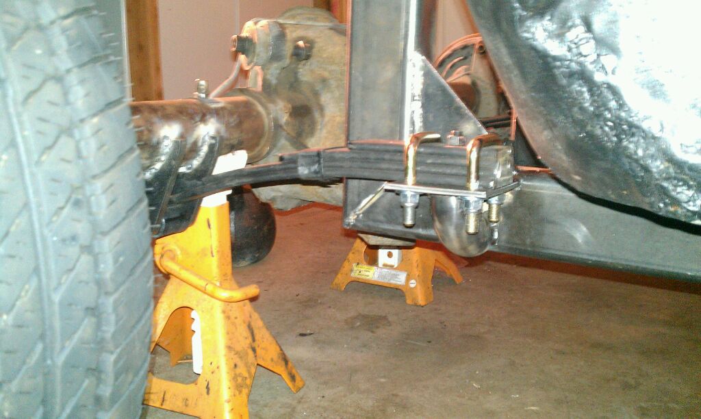

    I know you said front, but I've got them in the rear of my '31 coupe. Currently, they are set up as the lower link in a 4 link style.. very similar to the picture above but not triangulated. They have been this way since 2006 when the car hit the street, and worked pretty well both on the street and at the track - rides ok, adjustable height, and cut a 1.55 60' and pulls the left front.
    Well, it's getting changed because they wrapped up - pushing the entire driveline forward 3 or 4 inches and tearing up quite a bit* in the process. (This was in my quest for 11's with my lil' 289) Perhaps making it more robust would solve the issue, but I'm just going to switch to a torque arm and put the quarter eliptics on shackles.
