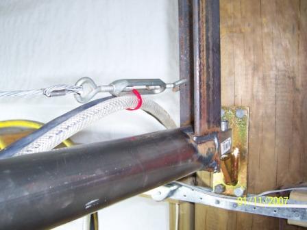

  1. I got totally sick and tired of haulin my MIG welder round my shop on its trolley. You know, leads all over the floor, can't reach both sides of the car without draggin the damn thing right to the other side of shop.
    So I was at the steel supplier yesterday getting a load of steel for another job and decided to grab some exhaust tubing and do something about it.
    So this is what I came up with!
  2. While I was in town, I stopped by the fencing store and picked up some ready made hinges to swing it on and some small pulleys to run the gas hose and power lead onto the washing line steel wire. The wire is tensioned with a turn buckle.

    your roller wheels make my butthole pucker. i'm picturing that thing falling on my head in the middle of a nice bead and screwing up my stack of coins! the idea is good, the material just doesn't seem strong enough. 3/16 or 1/4 would have been my min. thickness on that part.
    BTW, how is that thing swinging over your head, less of a pain in the neck than the 6' wires running on the ground?? I think I'd rather step on stuff than smack my head, and I KNOW I would.

  21. Thanks for your comments guys.
    The reason for the size/gauge of materials I used on the "car" is to minimise weight hanging off the end of the swing arm. I have been swinging off the car to make sure its safe, and I aint no midget, if you know what I mean!
    As for the comments a bout hitting your head, I have set the machines lowest point above my head height and the dials are all still qute easy to reach.

    I'd make some safety chains for it (loop around the boom) just in case the trolley fails.

    Ignore the "why bother" comments. Every damn "shop thingy" I ever made saved me time or effort was worth it TO ME. For thsoe who say "why bother" - well THEY shouldn't bother - the rest of us will enjoy your inventiveness.
    I do share that "not so fuzzy" feeling on the trolley though. Sure it's probably fine, but the "what if" factor wouldn't cut it for me. However I have a simple "fix" (I know it's not "broke") but what if instead of using the bolts with the overhung load you instead used longer fasteners and tied them together. You could weld 2 of them into a 90 degree angle or even take a piece of all thread and bend it into a 90. Or maybe just take a small square of metal and tap it for two holes 90 degrees apart. It'd strengthen it and become your "safety catch" at the same time. Just thinking out loud.

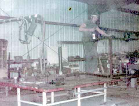

  29. I did a similar thing back in the seventies, but didn't hang the welder because it was 5 ft. tall. Ran the wiring over the steel fabrication table.
    I also had the cutting torch hoses overhead.
    Here is a picture and that was a frame I was making for a 40 Ford sedan delivery. The table was used during work hours to make trailer signs.
    Never thought about hanging the welder.
    To answer the critics, if keeps you from tripping over cords, and takes the weight of gravity off of your work.
