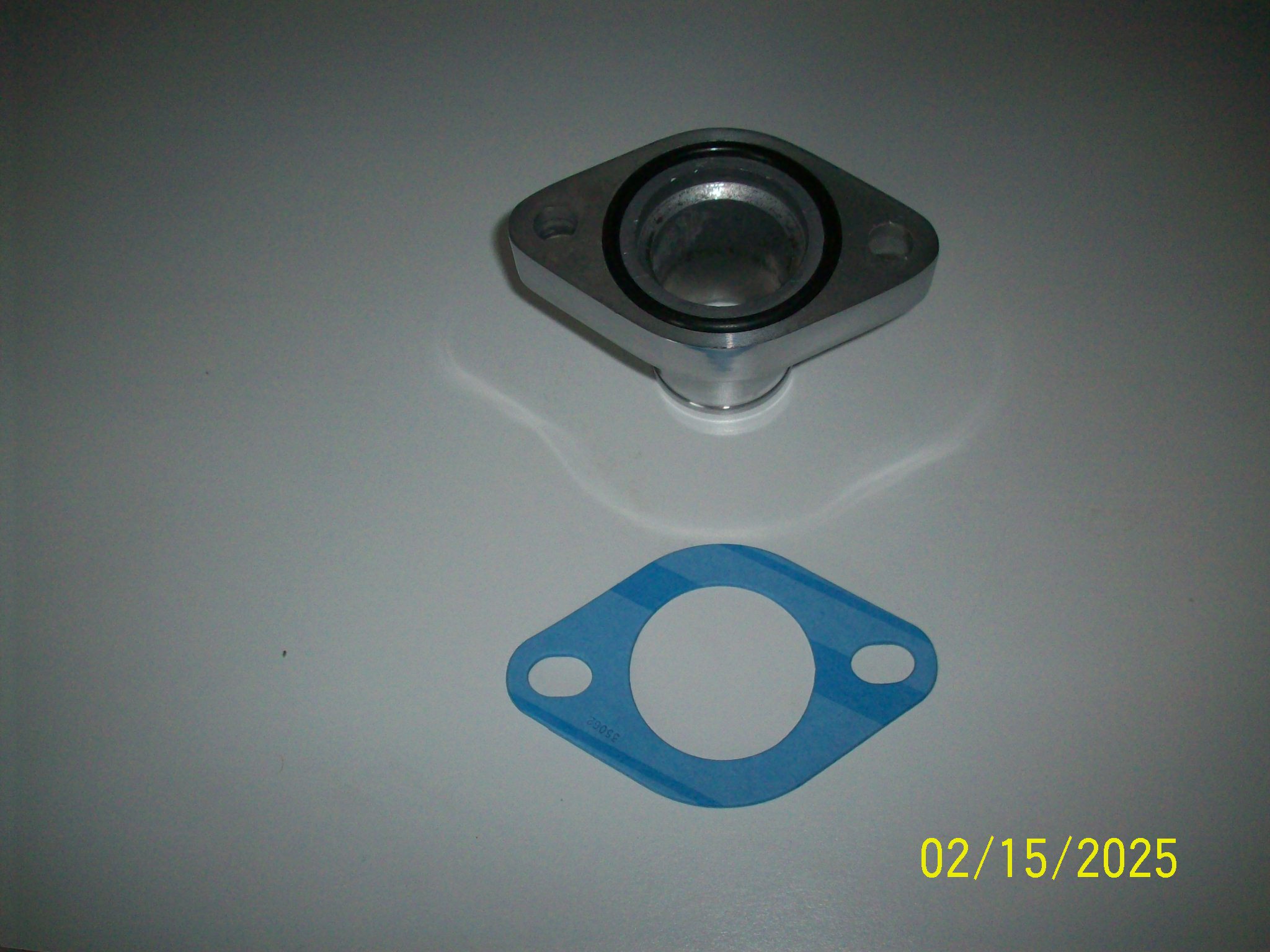

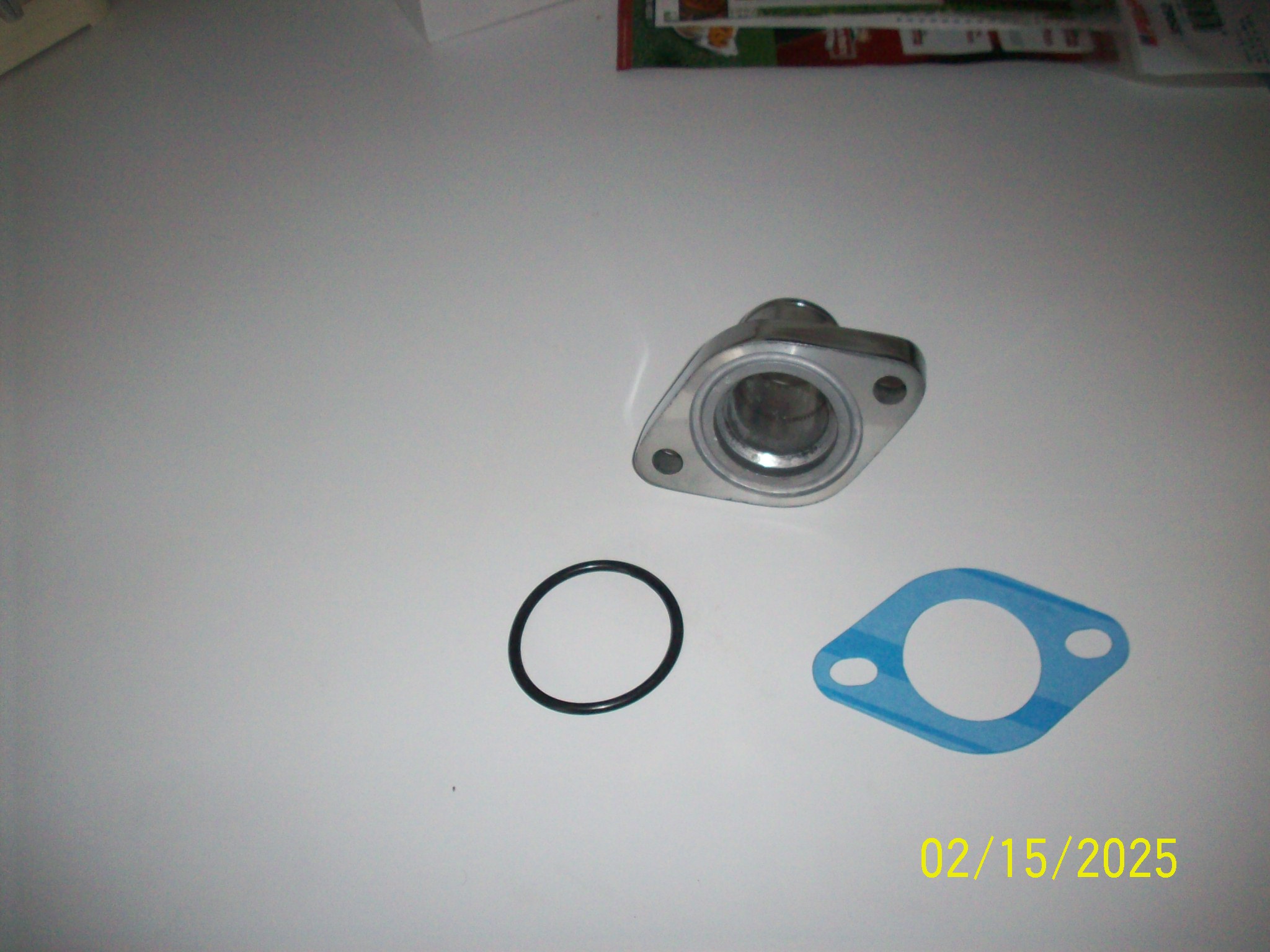

    Question on thermostat housing gasket. (pictures)
    Should I use the rubber O-Ring only (with or without gasket sealer?)
    I have never used an O-Ring before.
    Use the Fel-Pro gasket only?
    Should gasket sealer be used?
    Any input would be welcome.
    jeff

    The gasket with the O ring will keep the O ring from compressing. So no gasket with the O ring.
    chevy57dude and CSPIDY like this.

    Have to have good clean mating surfaces for oring . Dry no sealer . I have seen where is no mating surface on the intake to mate to oring
    Sharpone likes this.

    If it came with an o ring, it’s designed to seal with an o ring. Use that, not the gasket.
    chevy57dude and 2OLD2FAST like this.

    Use some Oring grease, if you're really conscientious...

    get rid of that housing, get one that's like the original, one piece of cast iron or aluminum, designed to use only a gasket.

    Yup, squirrel is right. Those chrome O ring housings are junk. They warp when you tighten them. Get a normal one and use a gasket

    2/16/25 If your thermostat is warping, your probably over tightening it. You might want to try installing it using both the O-ring and paper gasket together along with some non-hardening Permatex Gasket Sealer.

    It is easy to say to use an "original" when the "original" will point it the correct direction. That is not always the case and I don't have the equipment nor expertise to fabricate one from scratch. I don't like the O ring style and always fight them to not leak but in my case that is the only way to get the coolant to the radiator. I use "just a dab" of silicone gasket to the o ring after running a flat file on the mating surface.

    I'd say the key to success is having a perfectly smooth flat mating surface on the manifold, having a thermostat that the shell isn't too thick on and sticks up above that surface on the manifold and the housing is in perfect shape and not one you got at a swap meet for three dollars that had already been on someone else's engine. Plus the correct O ring and not just an out of the O ring selection box one.
