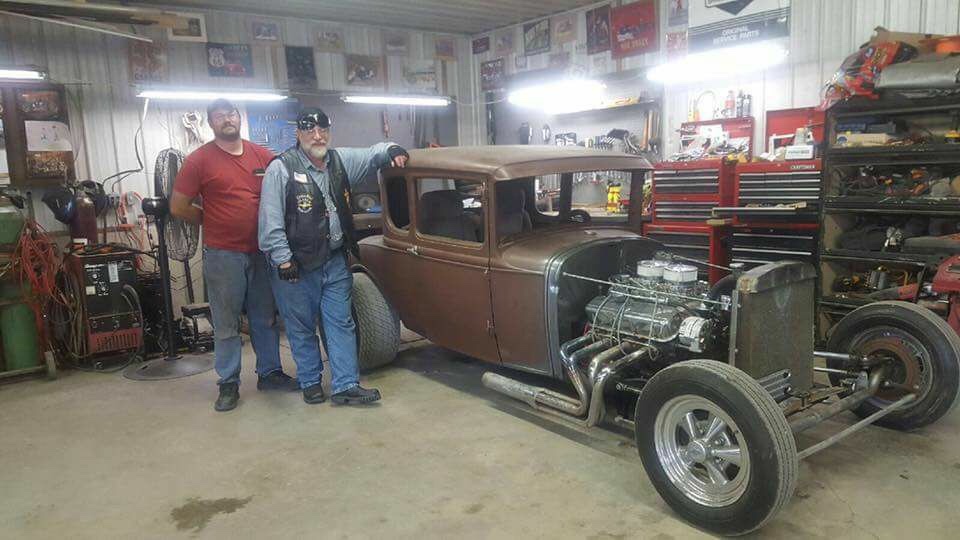

    Here's a pic of the radiator that Dan posted in his other thread. Appears that it might be a '55-'57 Chevy Harrison model with filler neck modified so a radiator shell could be used. Dan, you need to figure that fan arrangement out or put a house fan in front of the car while you do more testing of the thermostat situation. Others may correct me on the origin of the radiator. f0dd8f7c1ce3b1fd4ff2b60c48f8c007.jpg

    Had my buddy sent a couple pics he took before we got it mounted. [​IMG][​IMG][​IMG][​IMG][​IMG]

    Looks like about half of your air p***ages are closed off from the photos.
    Nailhead Jason likes this.

    That radiator appears to me to be likely a Mopar, as I notice it doesn't have tubes and fins like an old Ford. Can't recall the technical name for that type radiator construction and it's a method I don't think is used anymore.
    I agree a strong house fan placed so that it will blow thru the radiator will help. I usually use one in addition to fan on engine for the initial startup on an engine when I build and first start, helps keep things cooler while you're setting timing and otherwise getting the tune correct.
    Strongly suggest not using a flex fan, as they quite often don't do the job. Use the biggest diameter steel blade fan you can fit with as many blades as you can find. A shroud will help, especially if the fan blades are more than 3/4" from radiator core.
    Electric fans come in all sizes, shapes, prices and efficiency and effectiveness, and as far as aftermarket goes, you get about what you pay for. By far the most effective electric OEM is the '93 thru '98 Lincoln Mark VIII. All the Fox body Mustang purpose built drag racers run them if they are savvy. But on a hot rod? I'll be honest, IMO if you aren't running a hood, you need to 'cause they look like ****:eek:
