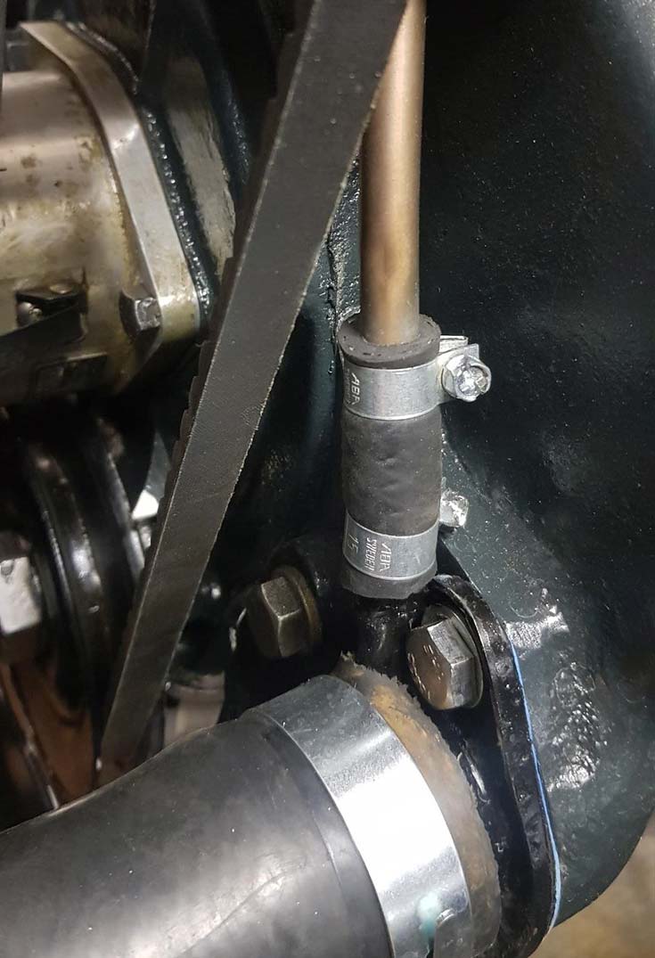

    gretaa
    No thermostats on model 18. However big improvement with these in-line vintage Dole housings, fitted with modern 180° Ford Mustang V8 2011+ thermostats. Smaller br*** tube is for byp*** down to water inlet, bigger one is for better cylinder head cooling (water extraction from back of head). Works just perfect.
