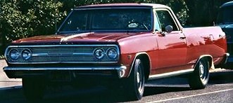

    We had driven our red 1965 327 powered El Camino for 120k miles with no repairs or problems. When we were getting ready to sell the El Camino for a station wagon, it must have heard what we were planning. Ha! At 120k miles, the temperature was getting hot when we stopped in our carport. It was driven normally and to get to our house, we had to go up a steep hill and winding road. So, that did put on some strain as we drove.
    But, it had been doing that for several years, along with normal highway cruises to the local surf spots and coastal areas. We did not have any problems with anything. So, I changed the thermostat. That seemed to take care of the problem temporarily. It was the first repair I had to do to this long running 327 motor. Soon, it started to do the same thing and finally, the water pump started making some odd noises. So, the local Chevy mechanic told me I might need a new water pump. Overheats, thermostat replace, then check the water pump was his idea, too.
    Now after buying it new in 1964 and driving it over 120k miles, a major take apart repair was now necessary. So, it all came apart and our garage/carport was a repair station. Once installed, the motor started up right away and we were able to drive it anywhere again. It worked as planned, it was just a lot of work taking everything apart and putting it back together, again.
