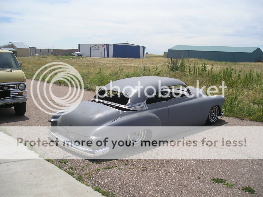

    how i spent the last week:
    sunday the 15th, i went to do some bodywork on my car, finish the fenders, rocker panels and rear wheel openings, etc. to get ready for this weeks trip to salina for the leadsled spectacular. i look at the car for ten minutes, then tell myself, it's the Leadsled spectacular, not the mild custom spectacular! gotta chop that mutha****er!:D an hour later the gl*** was stripped and the top was down about 4". by the end of the day i had it all tacked together, first pics of the chop would have been monday or tuesday.
    here it is sunday morning:
    tacked into place:
    rolled outside for the first time, much better!
    rear tulip panel tacked into place. i did something a bit different here, i wanted to use stock stainless beltline trim, but not lay the rear window down. the way things lined up, the decklid was about an inch higher than the beltline at the window, no good. i cut the body next to the trunk lip all the way back to the taillights, and dropped it down an inch. it now flows nicely, now the decklid is parallel to the tops of the rear quarter panels.
    the last of these pics were taken saturday, no new pics, but all the filler pieces are in, unfortunately i couldn't get new gl*** here on such short notice, so i'm running lexan windows for the time being.:eek: ratrodarriffic! :D
    you may notice a piece of s**** lexan i c-clamped into place for a few days, i just HAD to drive it while working on it!

    damn Ray that rocks! but the stock roofline is so nice on those cars ...all they really need is a mild lowering and some nice paint....hahaahaa **** that,I'm glad to see someone step up and cut the hell outta something! I like the trunk area too...nice solution. How much chop on the truck?

    I dig shoebox Ford tail lights on '49-'52 Chevys... and the chop is looking proper as well. Chopped sedans generally look WAY better than coupes... more pics please!

    i can't claim the truck, wish i could call it mine! it belongs to gilbert, rad****'s friend. they both drove up from albuquerque for a small colorado show and stayed at my place.
    the van though, yeah, that's my parts hauler! my girlfriend won't let me paint "free candy" on the side.:confused:
    brewsir, i THOUGHT i liked the stock roofline! i kept telling myself, Watsons g****vine looks sooo good with a stock roof...then like you said, **** THAT!:D once you go whacked, you never go back.

    What's the plan for the b-pillars? Slant 'em? Trash 'em?
    Looks pretty cool so far! Do you have any pics from a more front view?
    I like the taillight treatment, and the wheels/tires/stance are a great combo.

    it's now a hardtop!
    i was just noticing i had posted no front pics...

  15. **** yes....dramatic difference!
    I like the lexan pirate-patch...roll it to the show like that and next year you'll see 10 cars with the same look.

    The Chop top looks great!! You took the right amount off of the top.

    That looks really good. I think most chop's would look better with the back window remaining upright.

    what is the plan for side windows?

    how do yo plan to handle the back window????? or do they make laminated gl*** for it?

    i'm veeeery slowly working on side gl***, i made some br*** channel that i still need to make into frames, it'll have slide in rear quarter gl***. just too many projects, and it's my daily driver. right now i have some half-***ed lexan side windows to keep the weather out.
    thanks!
    yes, laminated gl*** is available. i bought one, and broke one so far. FWIW the tile saw method doesn't work on the new repop gl***.:D it worked fine on old gl*** though. this winter i'll probably sandblast one.
    yup, there it is. i let the LBCC board have the scoop on this one, and never got around to posting the updates here. i banged the body out a little better than it was the week before this years leadsled spectacular, and slapped some tinted primer on it. snapped these pics in Salina.
