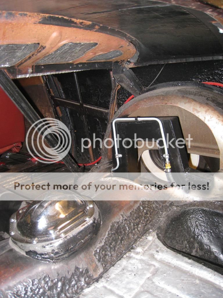

    ridiculously long over due update.
    After driving it stock hieght for way too long I raised the drive shaft tunnel in preparation to lower it.
    I installed a Gambino notch ( I might install air bags one day )
    FatMan dropped uprights and Areostar coil springs,
    A new stance and some hub caps.
    Papas Sin Sal.

    Looks great! Are you just running blocks in the rear now?

    thanks guys, much appreciated.
    DBF, YES.
    In the back I have air shocks, 4 inch blocks and I removed 2 leafs out of the spring pack. the top of my axle rides just up inside of the notch and with my fat butt inside it goes up another inch. Driving it with 2 passengers and that notch is really necessary.
  29. Diff cover notch bubble..... New one on me. I dig it!! I hadn't seen this "find" thread before, so my congrats on the score is also long over due... So, CONGRATS!!!
