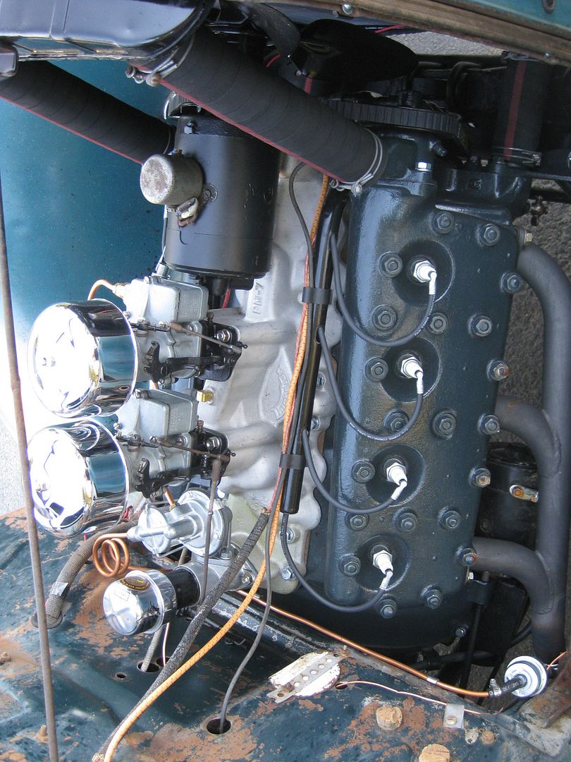

  16. Rob Paul
    Joined: Nov 11, 2005
    Posts: 1,273
    Rob Paul
    No spacers needed, you can run a generator on the lowrise pM-7.
    Heres a picture of mine showing the clerance with a 36 generator. I measured it and its about 1/2" shorter front to back than the later generators.
    Here is the early style on left with the cut out switch and the later style with studs and external regulator.
    Here is the early style mounted up. Not much room between the rear bolt and the carb, but it fits.
    The cut out switch was removed and the rebuilder shop made it work with an external regulator. 12 volts. Charges great.
