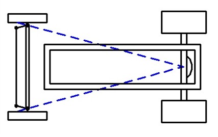

    __________________Fix your Ackerman if it's wrong!;
    Tierod out front of axle can be a prob ,but dosen't have to be [you can bend or replace arm on the spindels],when turning spindel around backword that have built on arms like Ford,stock arms behind axle are designed for good steering behind axle with engineering called Ackerman,this makes the out side tire turn less then the inside tire. The good part of that is that front tires work together to help turn the car in a corner.
    But if you use the spindels backword with stock arms ,tierod out front,your front tires do not work together,now the out side tire is trying to turn a sharper couner then the inside tires is going for,this makes for super poor steering in wet , drit or panic braking in a turn=this when you would feel it the most,but your front tires are in some what of a skid in any turn with backword Ackerman,you just don't feel it on dry good road,tell it's too late and your frontend dose not steer when you need it the most and can be a crash wating to happen!
    Drawing to the left of post is wrong backword Ackerman and not good,Drawing to right shows how spindel arms line up with a engineering line from center of your rear end up though the kingpin on out to tierod outer ball joint=make front tire again work for each other vs aginst eack other in a turn. ****
    You don't need to be super exact with that engineering line but close is good,even strait out beats backword*.
    Funny things about ever talking about ackerman on hotrod site,is some rodders will call it BS cuz they been driving like forever with it wrong and had no probs,= fact is they been lucky as hell, and cuz you can not feel it being wrong driving in a striat line,they think it must be OK=wrong,it's not that they are lieing,they just don't know any better and so far got away with out a crash. It is not Trationel to be stupid,so fix it. Not fixing it is the same thing as driving around a corner with about 1/2 of only one tire steering the car.
    [ ] < the drawing have been added at very BTM of post.

    Added missing drawings for ackerman at BTM,sorry they got lost from older
      18.6 KB
      470
      18.5 KB
      523
