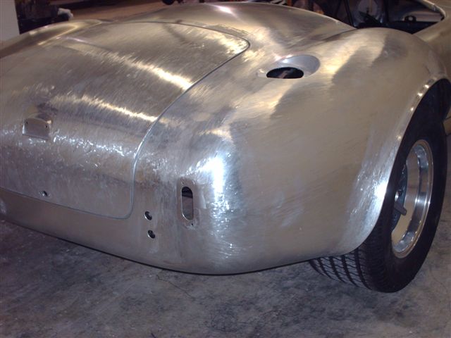

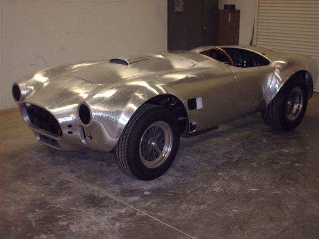

    I know for sure that there are Polish, English and American built Cobra bodies because I have had them in my shop. There is probably more than one place in the States making them because some bodies need LOTS more work before they are painted.
    The A.C. bodies from England are very nice and I understand the buyer pays a premium price for the body.
    He will save some money in paint prep work because they are nice.
    The #1 A.C. body rolled thru my booth and was the easiest Cobra I have done.
    The polish bodies are decent, but need quite a bit of prep work. The photos are of a Polish built car. I was told the old Mig factory story too.

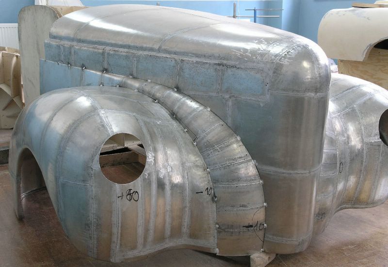

    hi guys ,
    i followed the auction for the aluminim 40 they sold on e-bay and kirkham (the importer ) is from utah.
    they posted build pics (i have them saved on the other computer) which showed these cars are made in tiny pieces and welded together, lots of pieces in seemingly no random order.
    after asking some questions to kirkham and on metalmeet the conclusion was that the polish factory had a bunch of skilled welders and very little metalshaping experience. they went with their strengths , which is welding.
    however they got there, they got there. i don`t see how we can so easily dimiss their accomplishments.
    how many of us are skratch building bodies???

    Many of the Italian coachbuilders of the 40s and 50s used the
    many small shaped panels welded together method, to build
    their bodies. No large press tooling existed for one-off or
    short series run bodies, and thus many patch work-like panels
    served well. I'm told the inner sides or these bodies were kinda
    rough, but the outsides were beatin and filed to perfection.

    hi guys,
    found the pics. the amount of welding is just incredible.
    enjoy,
    gary
